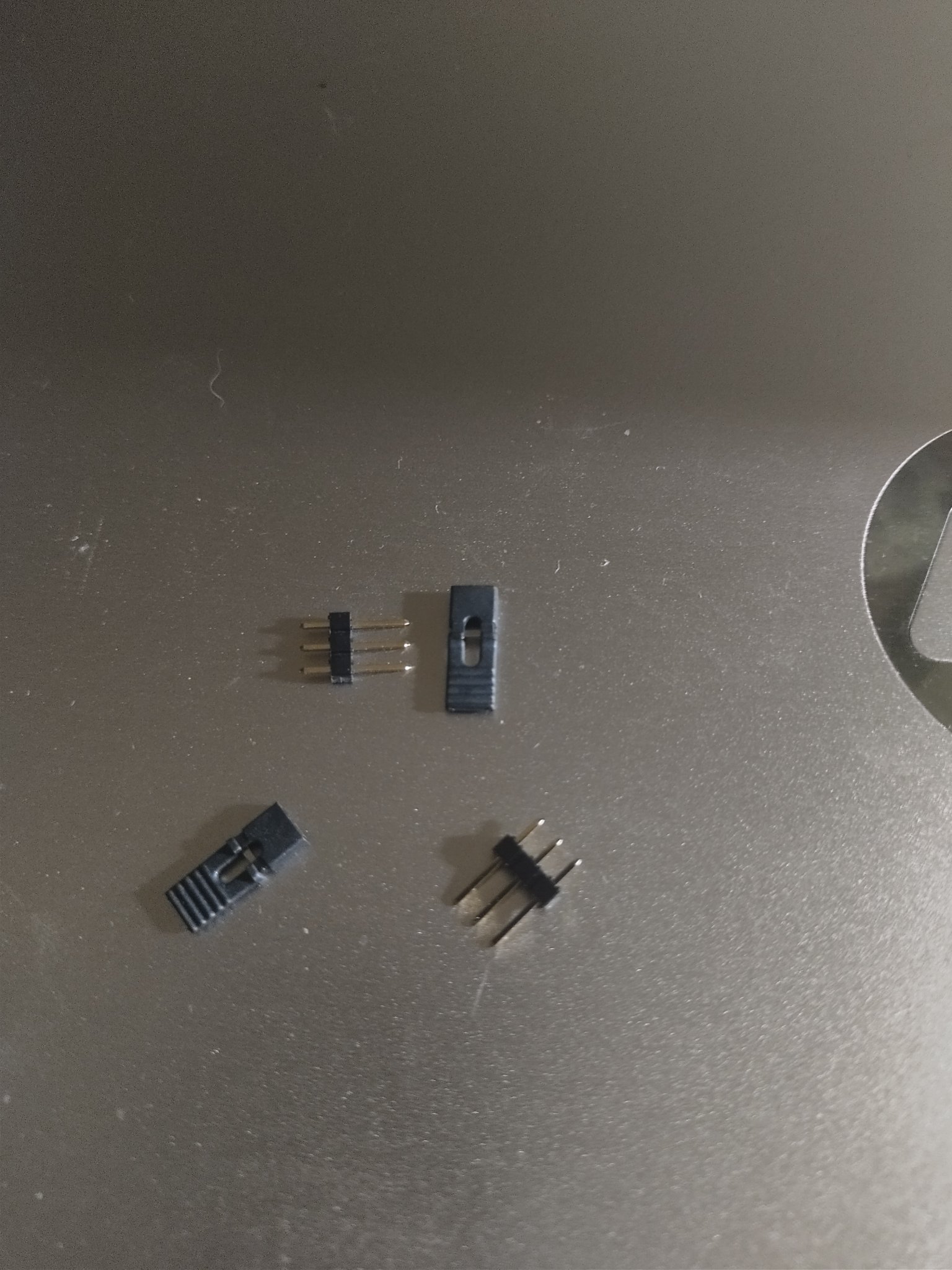

Stumped again with minutia. The jumper, comprised of 3 legs fused in plastic, and a small plastic handle piece. Legs are isolated, so handle piece must also short 2 legs together?
Obviously handle piece must short 2 legs, but I think I have fit this thing only way I can see it going. It is very loose, so I'm likely doing something wrong? No good pics here to help either.
Are the three legs soldered in place on board, then the shorting cap on top to short two legs to pick gain? Here's a pic of my parts. Altogether different from XA 252 jumpers. It appears that inside the handle part I can see two metal contacts that line up with the width of two pins,
but it is super loose. I didn't want to force anything, it is very fragile There is also a slot opening in the center with a metal cross piece, but didn't come up with any arrangement plausible.
The best pics don't hold up under magnification to see other than a blob.
Build guide didn't show it either, so I have to ask! 😔

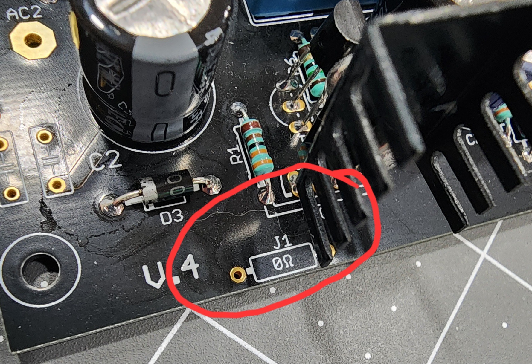

This is the jumper "J1" that I had missed
You make a wire jumper from a cut off resistor lead, or similar.

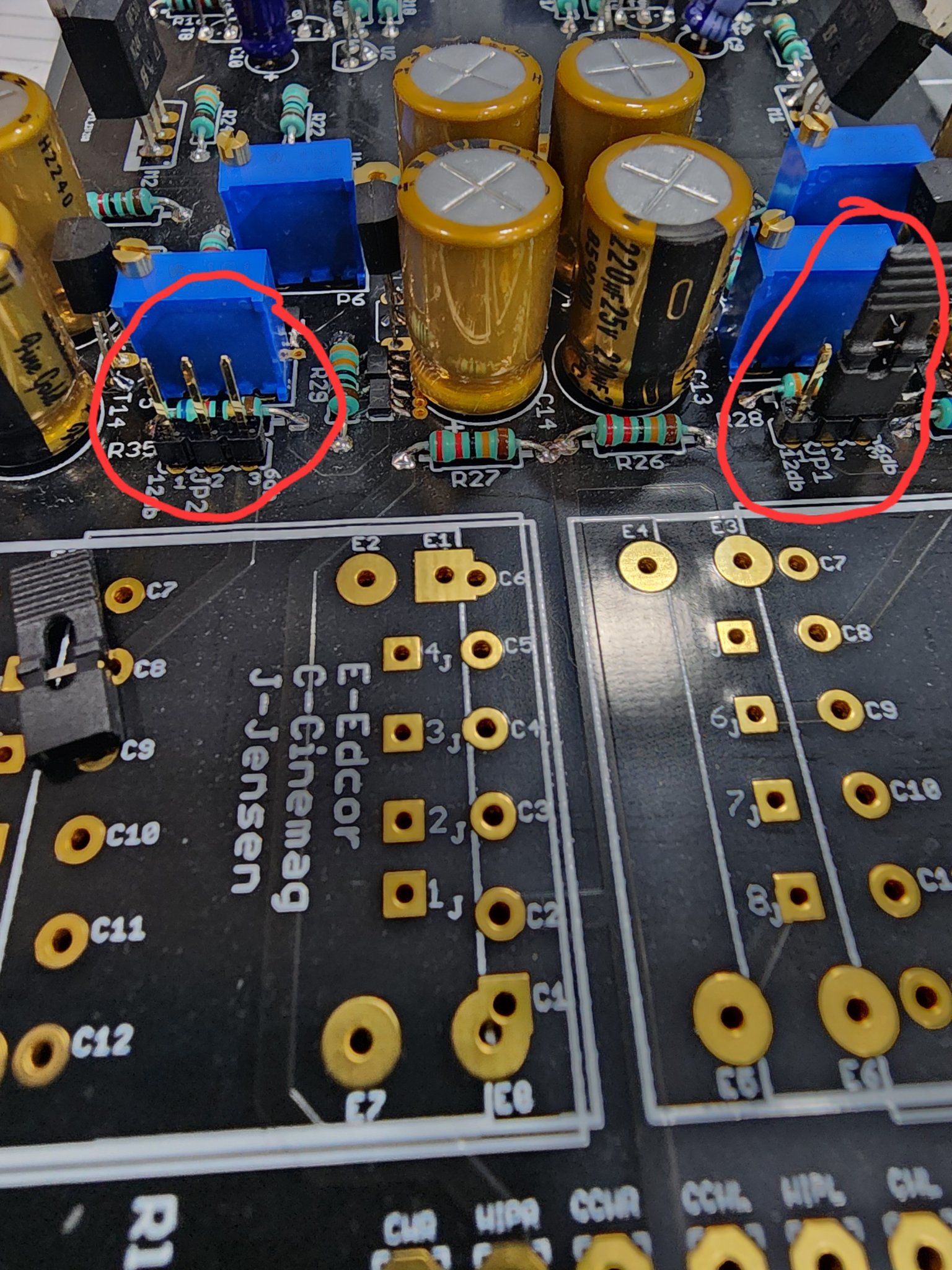

This is the jumpers you are referring to.
You need to hold with tape, then solder pins to pads on bottom of board.
You could hold the jumper in place on top of pcb with your finger and solder the bottom pin(s), but I'll let you know tape was less painful. 🔥

I don't have those boards. That is the extra jumper refered to in build guide, only on 2023 versions. Mine are 2021 boards with only two main jumpers. However, you show the same jumper piece I have! Yes! I guess it's just a very loose fit or do I just need to press harder?This is the jumper "J1" that I had missed.

No, I mean the way the handle part fits on the three pins, maybe I need to push harder?It's loose, use blue tape (or similar) to hold it while you solder.

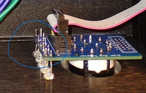

With jumpers in place, I hear relays clicking, but no LEDs lighting up. Time to disassemble the twister LEDs, ugh. Oh well, could be worse.

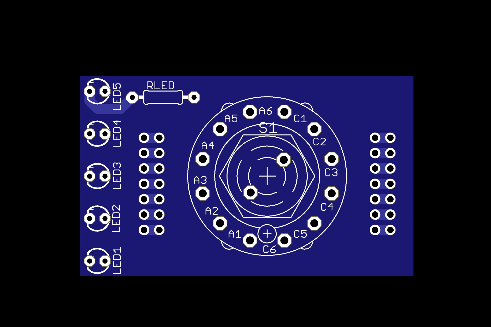

If you have 2021 boards, you twister board should look like this on the side that matters...
The flat side of the LEDs (the cathode / negative / short leg) goes to the outside of the board.
From this pic... since you didn't trim the legs (that I can tell) just look down the line and check.
One looks suspect, and if one's wrong... the entire thing will act funky.
It's hard to tell from the picture.
I did trim the legs off even, just left some length. I oriented the short wires just like the picture in the guide. Not at home right now,Good news is relays are clicking...
Mine were all oriented the same way, and while difficult to tell on silk screen, one side the circular lines seemed to go behind the hole,
other one seems to hit it in the middle, I assumed that was flat side. Let me get some good pics, and post before I remove them all....that said I'm pretty sure they are backwards. Its a simple circuit with not much else to go wrong!
