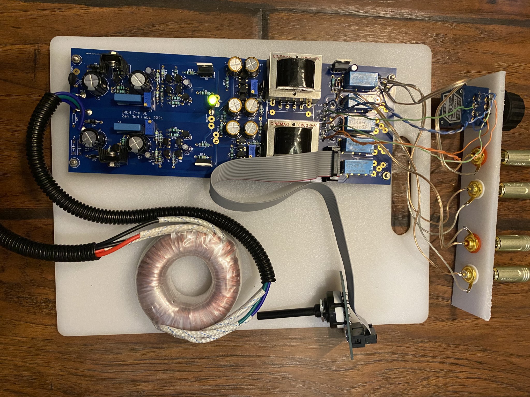

^ If I'm picking up what you're putting down... you tried to go by the silkscreen and some looked different to you by your recollection...
If that's accurate, then sadly, yep... you'll have one or more backwards. They should all face the same way.

Wait, I will recheck but I believe I did have short leg out? will recheck, even though legs are now even, there is still the internal structure of the led
to look at, and the silk screen. Is there anything else that could prevent them from lighting? I must have reversed them darn it. But if I followed the pic, they should be correct? No more wonderment until I get home in an hour or two. At least I figured out the silk screen flat spot correctly!

Maybe I'm wrong thinking, but if, and I mean if problem is reversed led, wouldnt voltage to it still be there? Also I would like to eliminate possibility
of taking that fitting apart until absolutely necessary, I will break it. Then de solder, resolder. Will diode test tell if in backwards? I dont know...I suppose I could measure at leg of led, instead of disassembly of the connector?

Just poking at you, but if you're going to use the build guide... you must also read the build guide. Better to just use a DMM as ZM mentioned.
Below is from step 14, which if I recall... I wrote.
  • Image 1 - This is the side facing the front of the chassis for the 2021 Twister board
  • Image 2 - This is the side facing the front of the chassis for the 2023 Twister board.
  • Note the differences in how the LEDs are marked on the silkscreen. Pay particular attention to the 'C' and the flat side of the LEDs on the silkscreens noting the cathode of the LED. The orientation of the LEDs is opposing for the two boards. Be sure you triple check before soldering.

Where? But ... yes... if the switch is in the proper place, and if you're measuring it in the correct place.
Yes...

Not a worry. I was just poking at you. Heck, I had to do a double / triple take on it. I just remember like (I think) everything that long leg is positive.
With the DMM set to diode - The LED should light up when the red probe is on the anode (toward the middle), and the black probe is on the cathode (toward the outside). It should also provide the forward voltage of the LED. If they light up / read a forward voltage with the probes reversed.... then they're in backwards.

FWIW - Russellc - I also have now added (as of two days ago) to check the LED before installation with a DMM. I bought a gazillion 5mm and 3mm LEDs off one of those websites when I started building ... two of them have been DOA over the last few years. If I killed them, then no one has proof.
