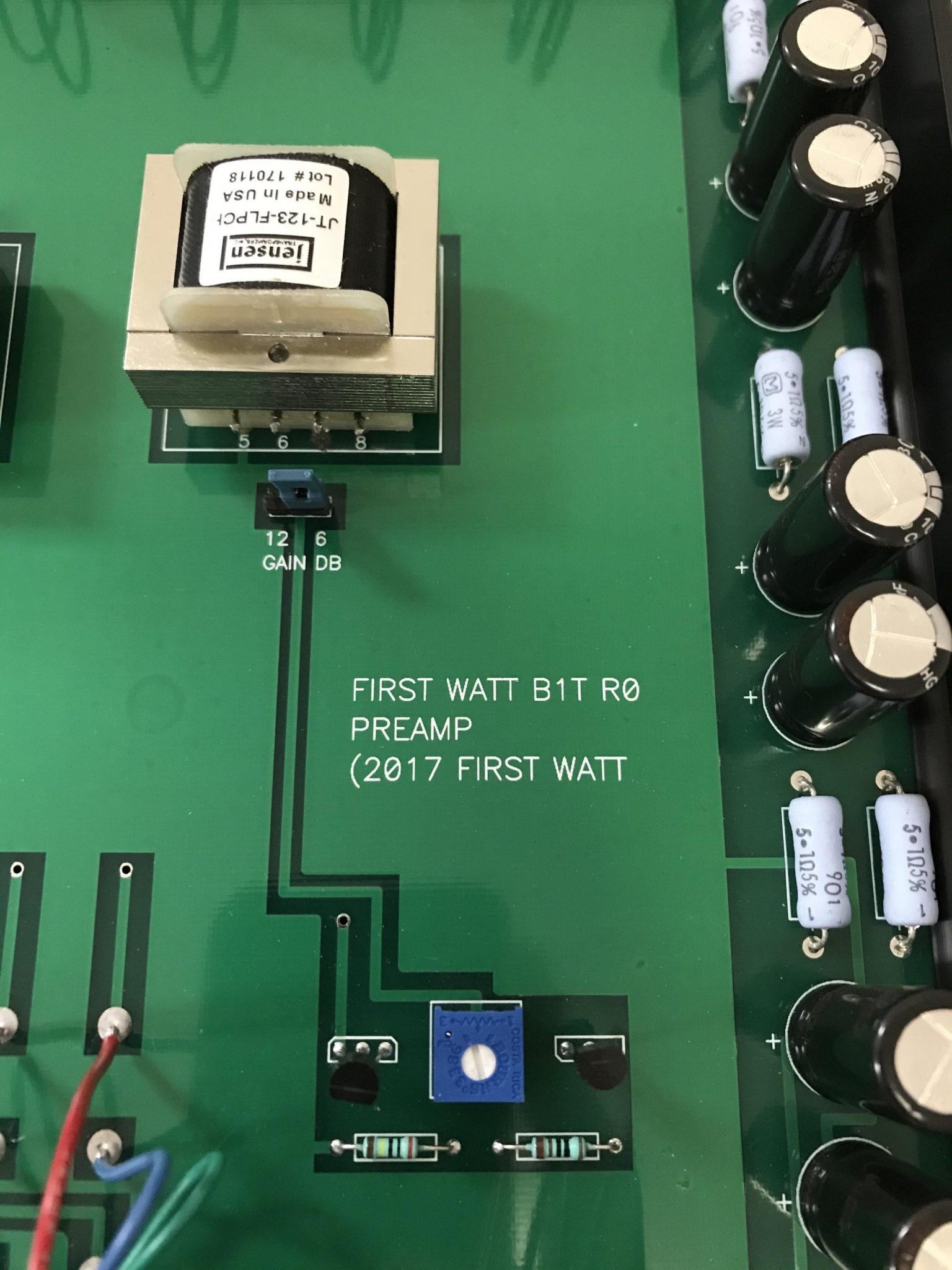

What do we know about the original B1T?
If the buffer a pair of 2SK/2SJ?
Is the pot there to adjust DC-offset like on Iron Pre. Do we know the value (depends of how "tight" the pair is matched?)?
The two resistors:
If the wide brown band at the left is the tolerance (1%) then the left resistor is a very large value and it goes to the ground plane of PCB.
Is that resistor connected to the wiper of the pot to ensure a reference to ground even if "wiper slips"?
Then the resistor to the right is the gate resistor?
The two resistors:
we know everything
pretty much B1 R.2 (complementary JFet buffer) and logic sez - no (idiotproof part) 1K in series with buffer output

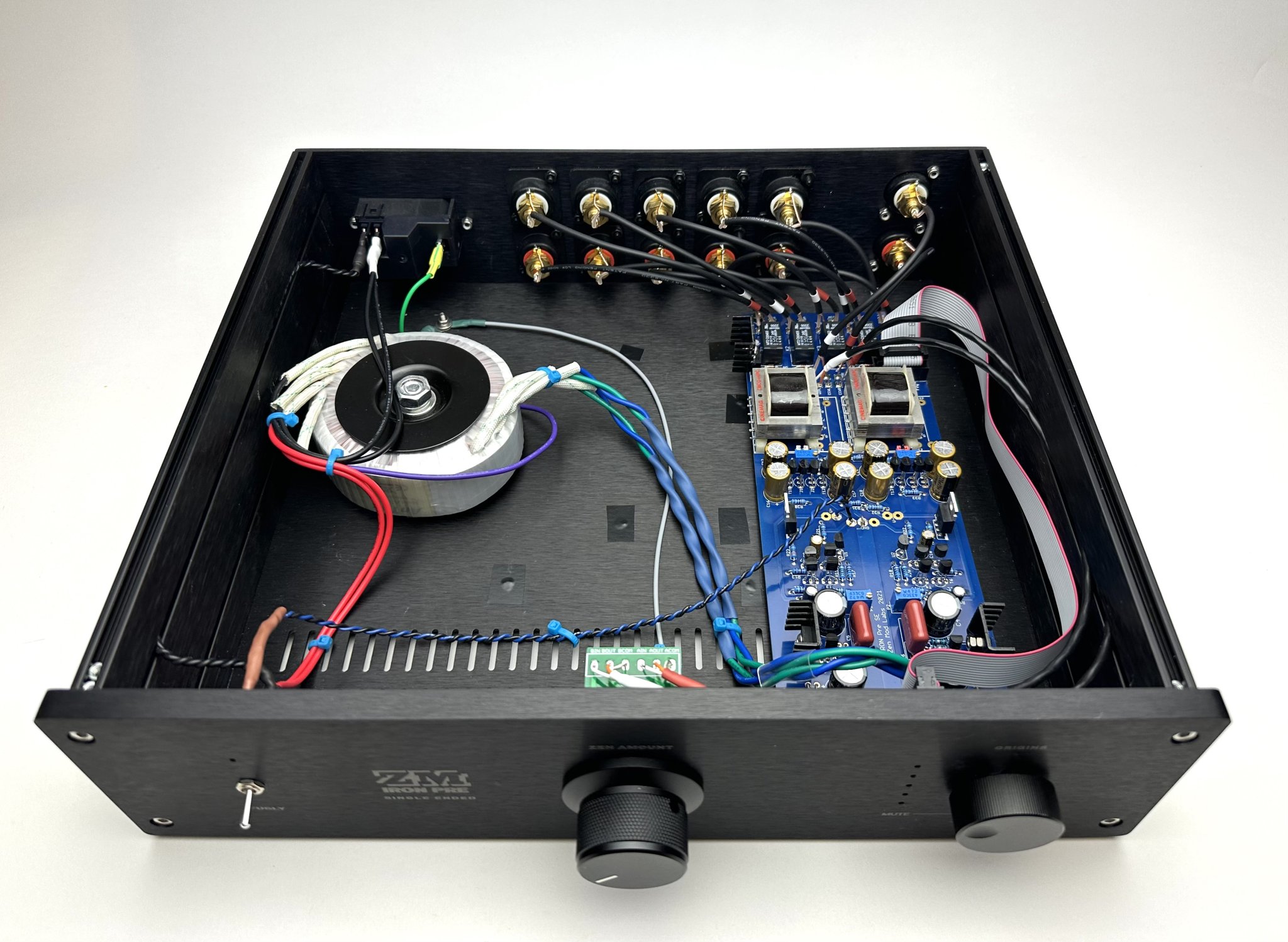

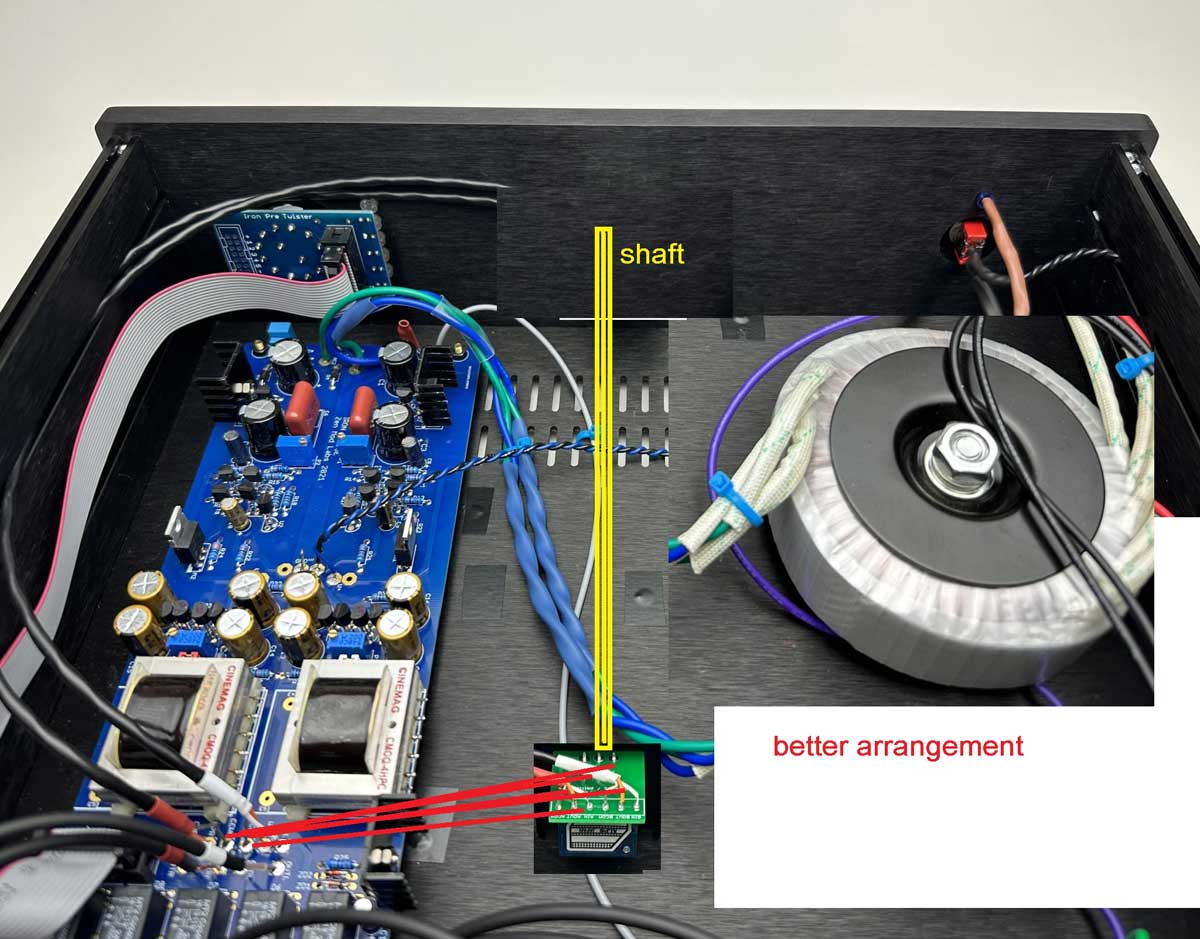

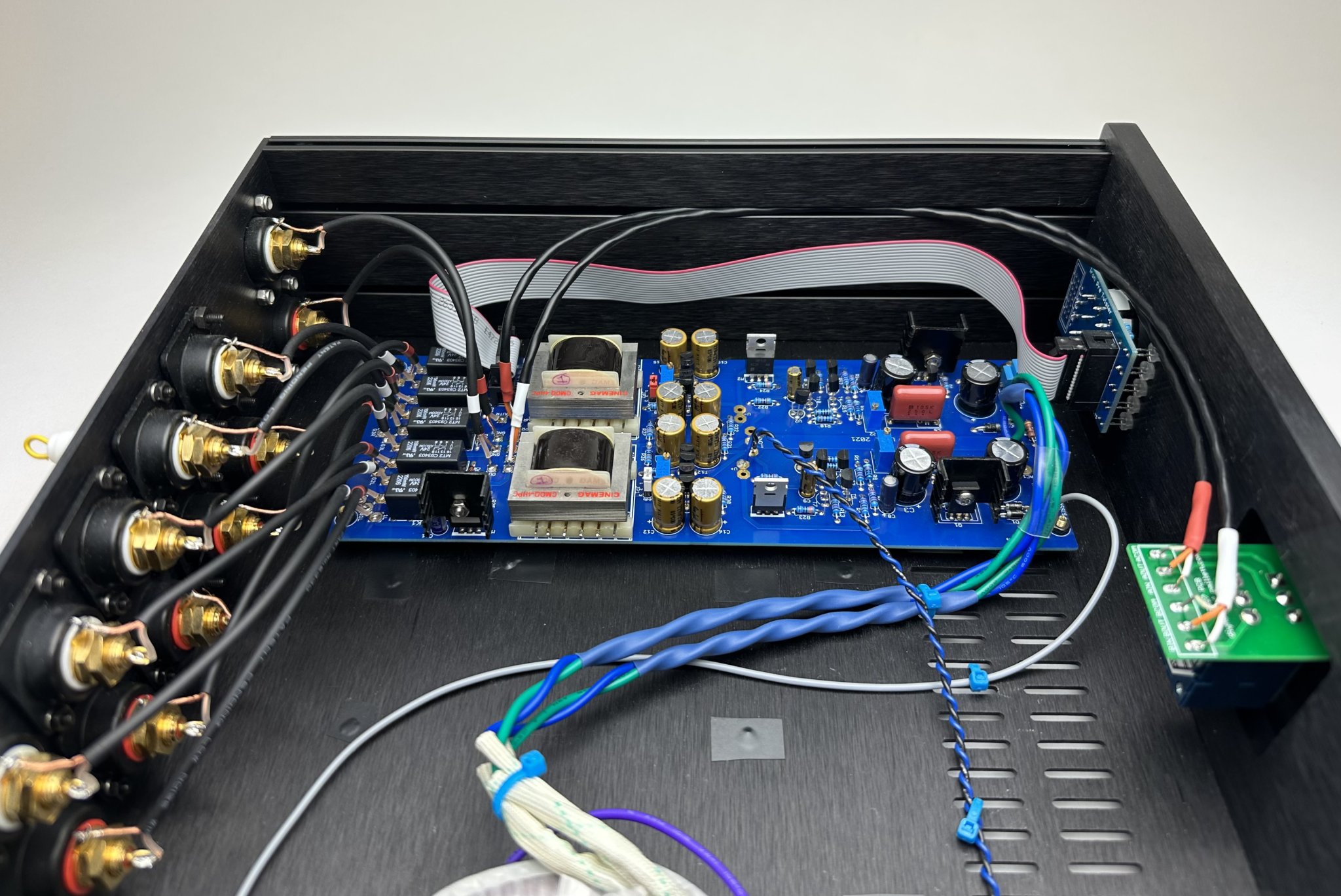

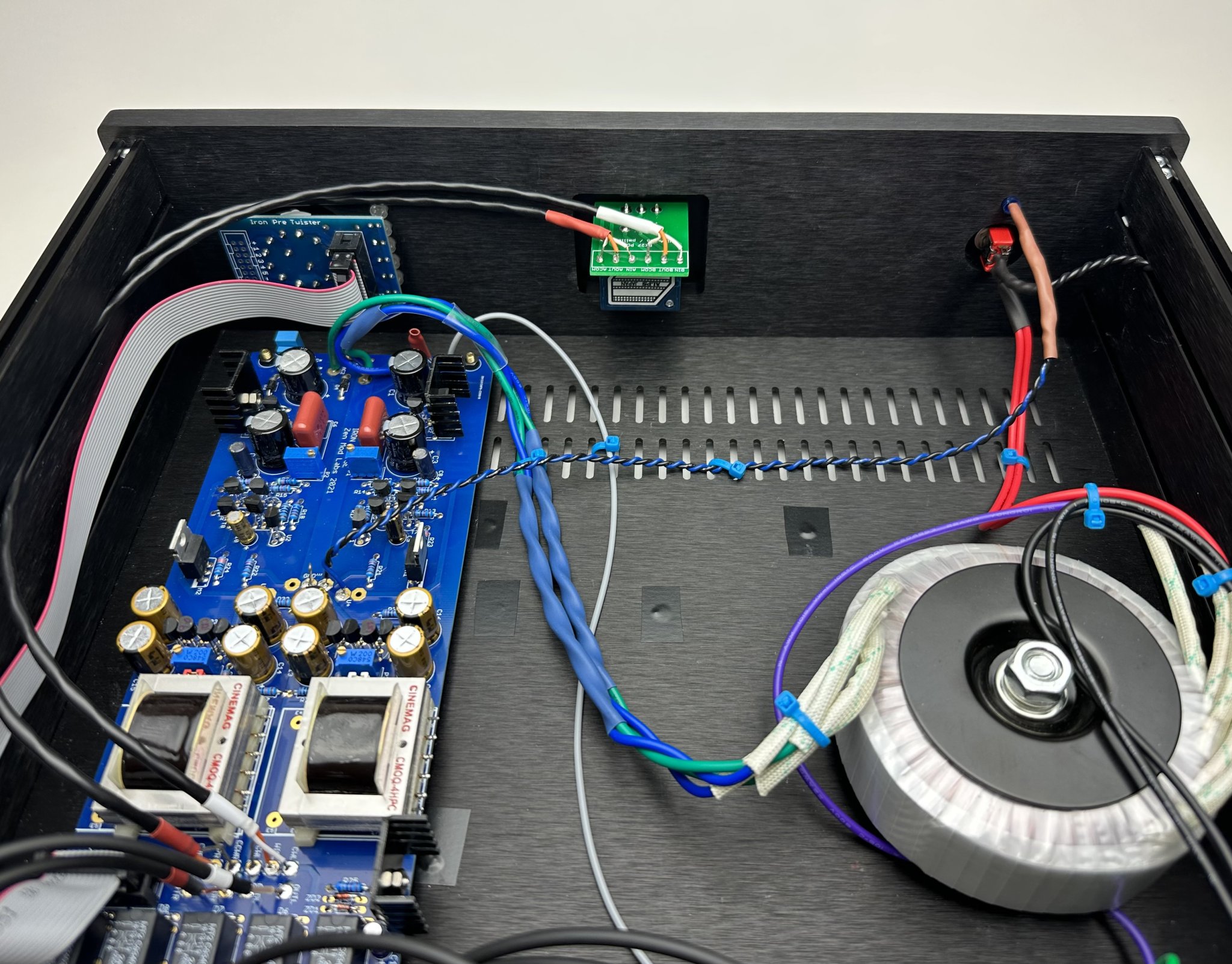

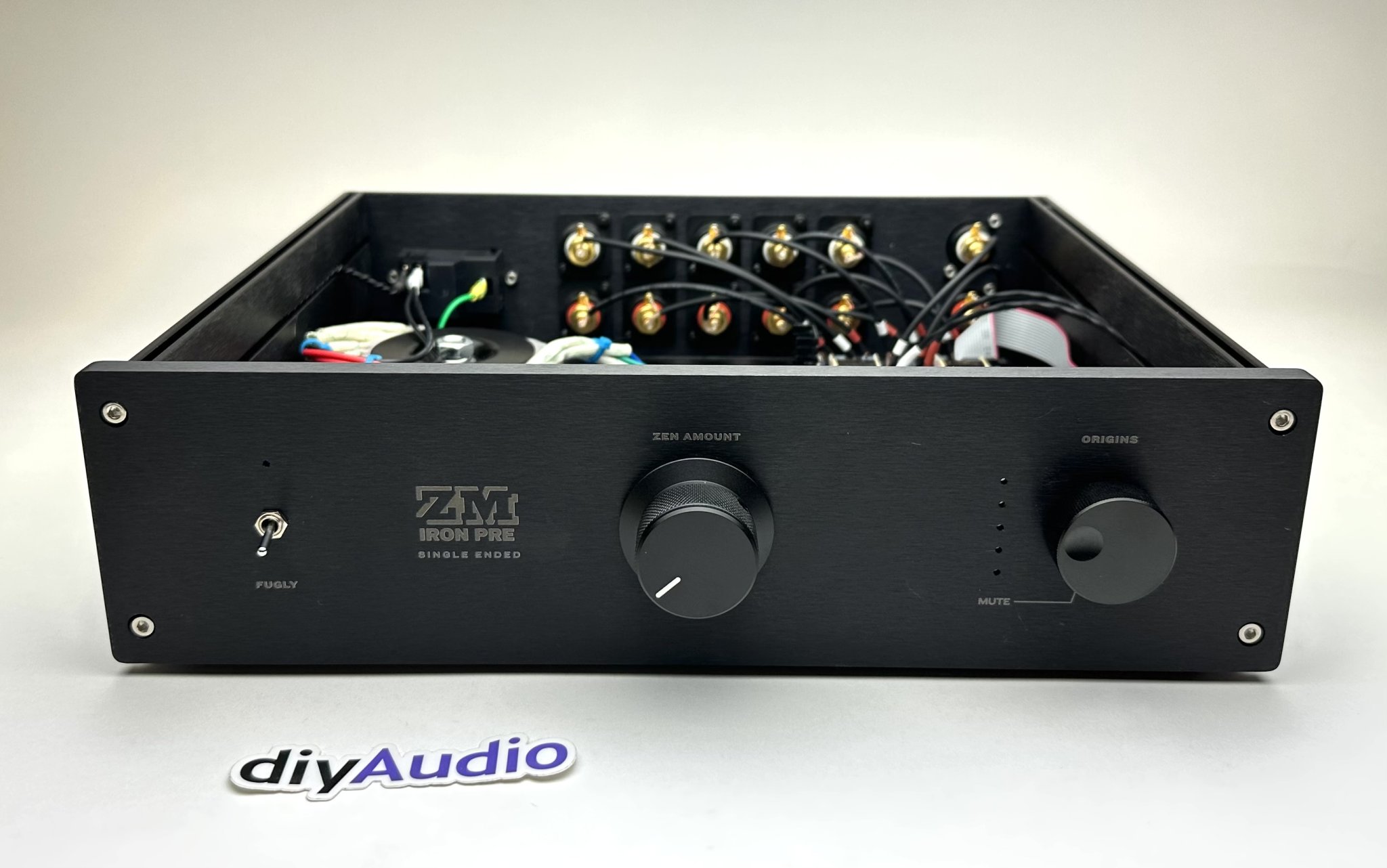

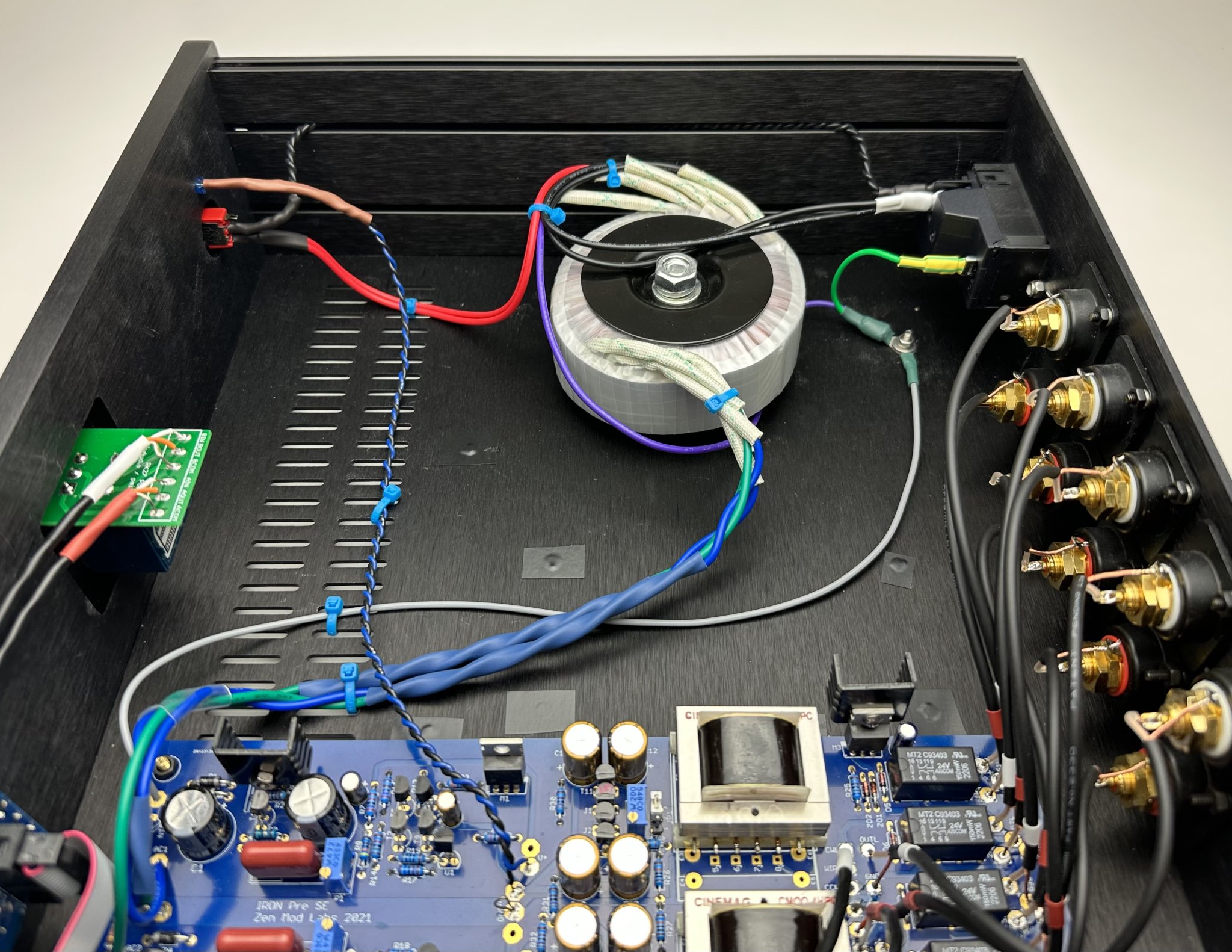

Sneak preview 🎥
There's not really too much to say about this build, things are extremely straightforward, it works great, and as the other builders already know, it sounds absolutely fantastic!
A few notes before people ask -
I didn't use a remote volume shaft as I didn't have one. Use one of you want, it's a great idea. The wires from PCB to the volume pot are mic cable, and it's wonderfully quiet.
I used a fused and switched IEC. It makes the wiring so much simpler.
In North American wiring convention black is Live (as that's what color it will turn your finger if you touch it), white is Neutral, green is Earth/Ground. Please note the heat shrink on the IEC, and also that the IEC has L and N labeled. (hard to see in these photos).
Live is sent to the front panel switch (which is AC rated, of course) and then to the lead windings of the transformer primary, which being an Antek happen to be red. The trail winding of the primary attaches directly to neutral. These winding leads are unfortunately black, but oh well.
Safety Earth/Ground is bolted directly to chassis through the green wire.
If it's not immediately obvious, the grey wire is connected from the pad on the PCB marked "Chassis" to the chassis earth.
The power on/off LED steals power from the pads on the PCB, and has an inline resistor under the heatshrink. I used a blue, and about 33K as modern LED are amazingly bright.
Cable from the PCB to Volume is Canare L-282AT https://www.redco.com/Canare-L-2B2AT.html
The little PCB on the Alps volume pot isn't necessary, but it sure does make things easy to solder.
The rest of the signal wiring is Mogami 2330 https://www.redco.com/Mogami-W2330.html
No idea where I got the knobs... probably Amazon, I had a bunch in my box and these looked pretty cool.
