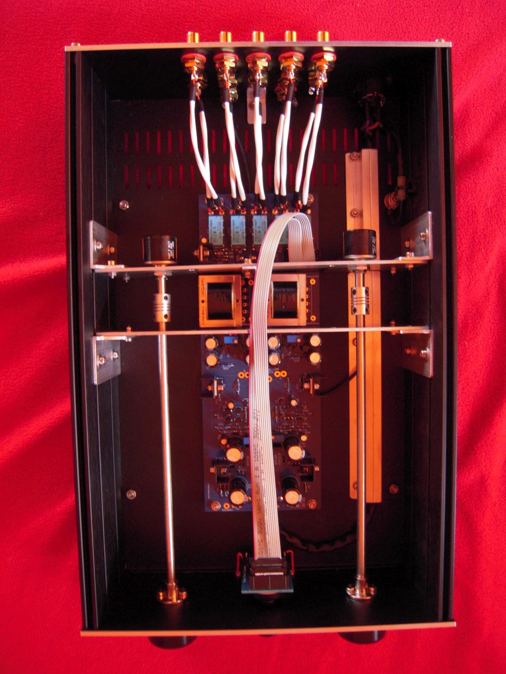

Honestly, there really isn't much hum with cables routed as 6L6 did. Turning the knob full clockwise with an open source selected and I can't hardly hear a thing through 89dB speakers. It's a tempest in a teapot imo. Don't kill yourself if you can't find a shaft-type solution that's easy for you.
small L bracket drilled with stepped drill, 6mm Dia bar or M6 threaded bar - both from hardware store; cut with angle grinder or hand saw or nail cutter
if there is no 6mm couple element, one can connect extending shaft with pot shaft with piece of petrol/rubber hose of 5mm ID
as proper 6mm guide for front hole - one can use disassembled front of bad pot

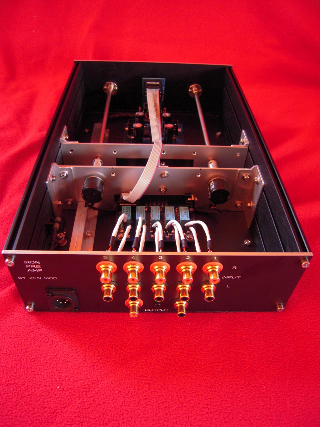

Hi DirkGood morning IPA- builders,
my backplate arrived yesterday. Made a little nightshift. The story continues slowly, but constant....

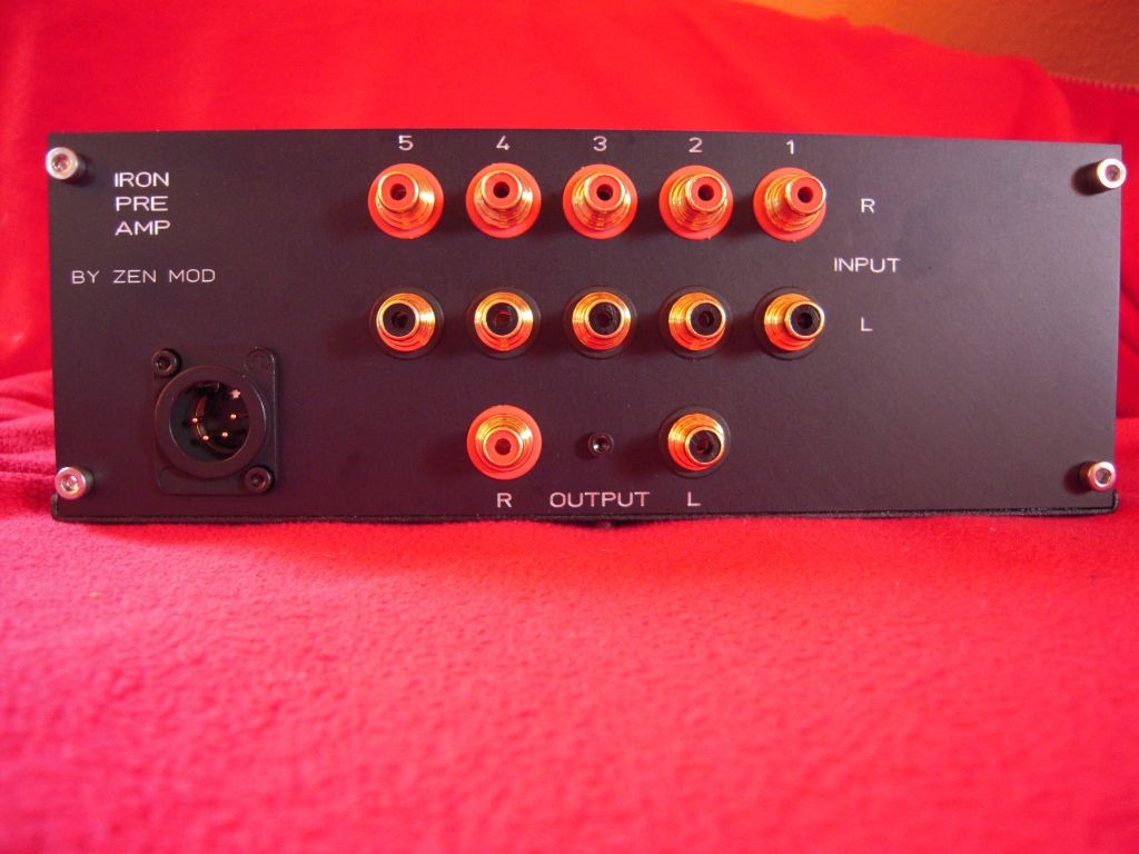

Nice build.
Which kind of connector do you use for the DC-power?
obviously Neutrik 4 pin, male, chassis mount

Yes, Neutrik was also my guess but I could not find the exact "version"......a 4-pin XLR type?
Hello Meper,
it is a Neutrik XLR 4-pin.
NEUTRIk NC4 MD-LX-B, 4-pole XLR male (input AC at preamp).

Thank you I found it!
They make up to 7-pin types......
https://www.neutrik.com/en/neutrik/products/xlr-connectors/xlr-chassis-connectors/dl-series
And yes everything is at PCB......just need the AC from transformer and the current is not so high.
