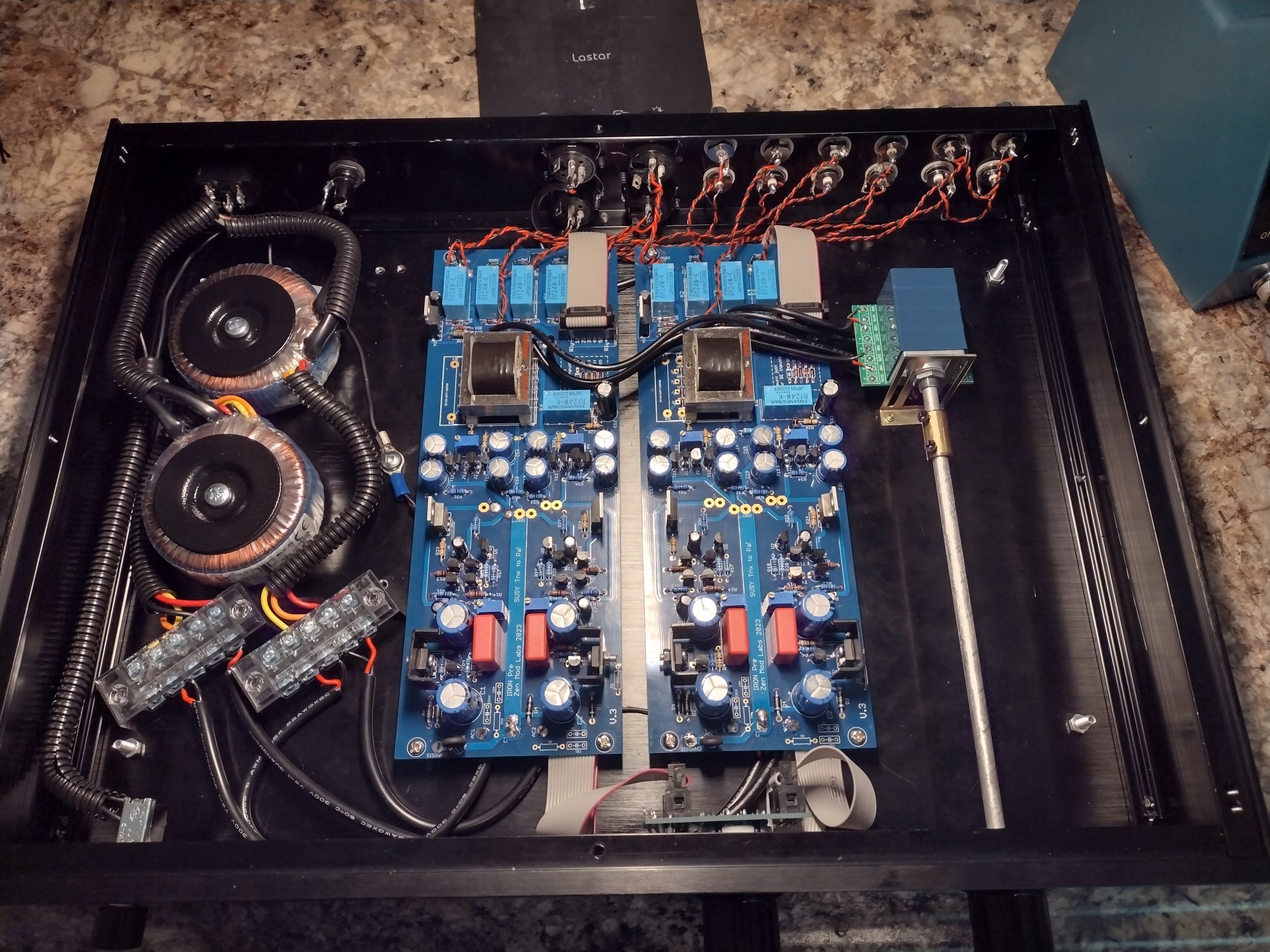

The attenuators arrived yesterday so I was able to finish the balanced Iron Pre today. The Eizz controls are very nice. The build quality looks great. The rotation is smooth, and there are no glitches in the make before break all through the range.
I had ordered the chassis from Hifi 2000, and I had to bore out the front panel cutouts a little because the main shaft is slightly thicker than what was specified for the chassis VCs, although if you follow ZM's suggestion of using an extension, this won't be an issue.

Well it was a fun build. I am a total beginner and somehow managed to make this preamp sing. Most of my parts came from Newark electronics and Ebay so I was waiting for awhile for all the parts from China to show up. Toroidal transformers are 15v secondaries. Using with a F6 and a M2, goes plenty loud.
Areas of learning for me include,
- Not jumpering J5
- Flipping a Jfet
- mixing up the wires for the XLRS
- mixing up the 12 volume control wires
- jumpers from - to Gnd for the SE inputs
