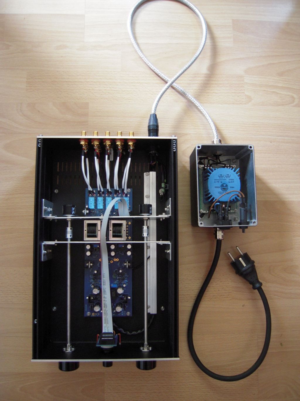

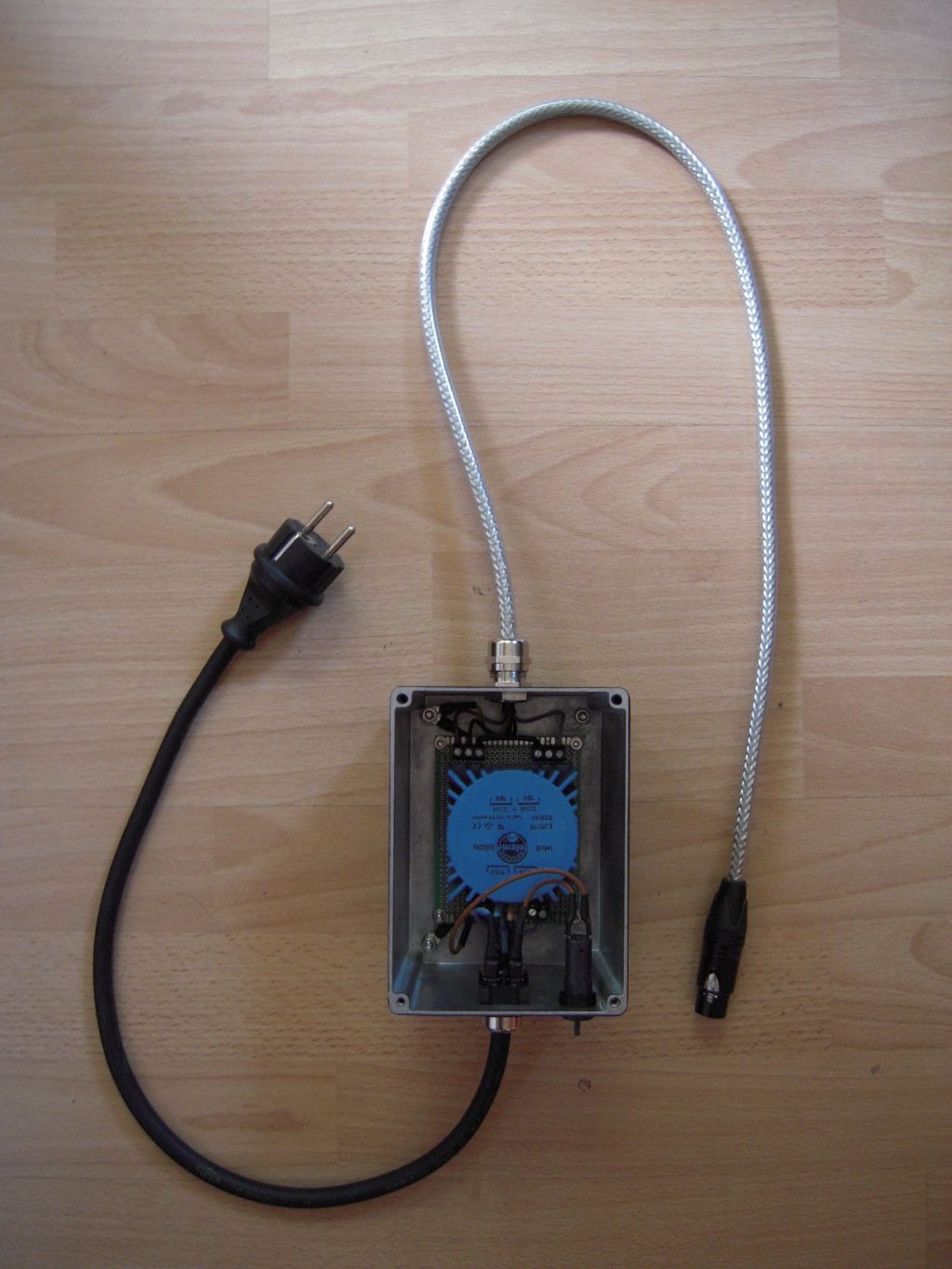

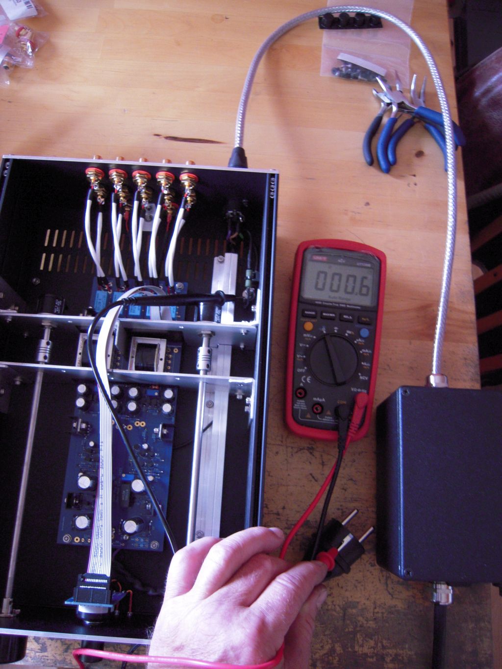

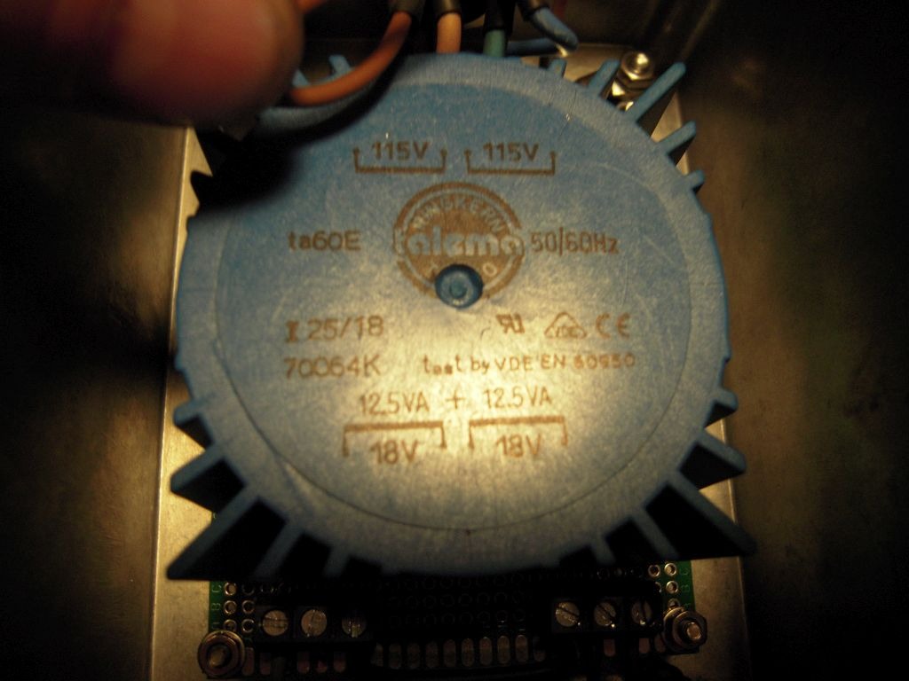

Hello IPA-builders,
another step forward: finished my external - transformer-case today. Did some measurements - especially how low-ohmic is my earthground-connection between AC-powerplug and the preamp (below 0,6 Ohm).
Still some metal-work left. Cage for the cinemags....
Cheers
Dirk 😉
