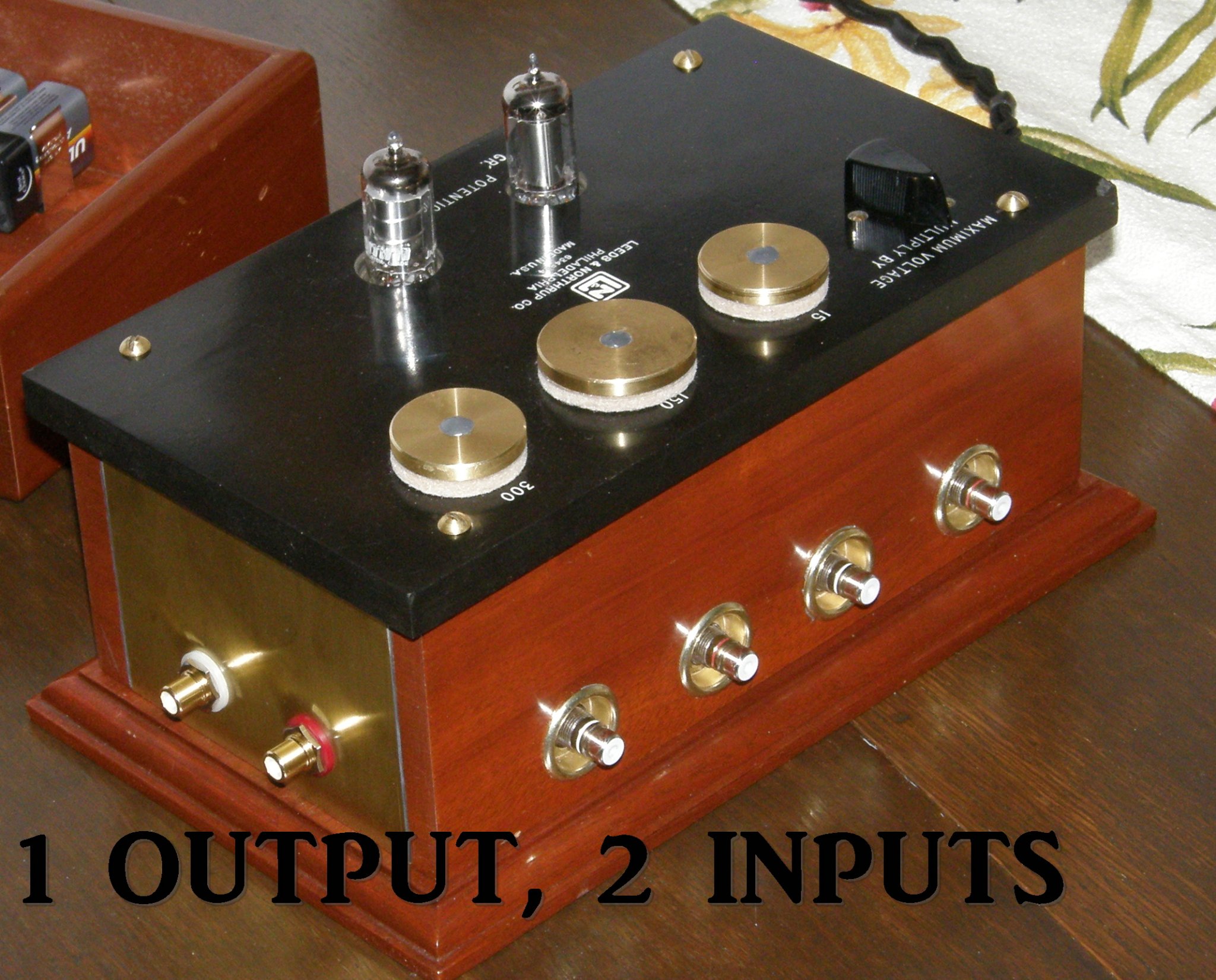

Way back when, I built a DHT pre and used a field test box for the chassis. Maybe paid 50 bucks for it. The hard part was disassembling one of the most beautifully made antique circuits that I have ever seen. You name it. The switches, the cable contacts, just everything at a level unknown today when compared to the average test meter that we can get at Home Depot.
I ended up with this, after drilling holes for tubes and other stuff.

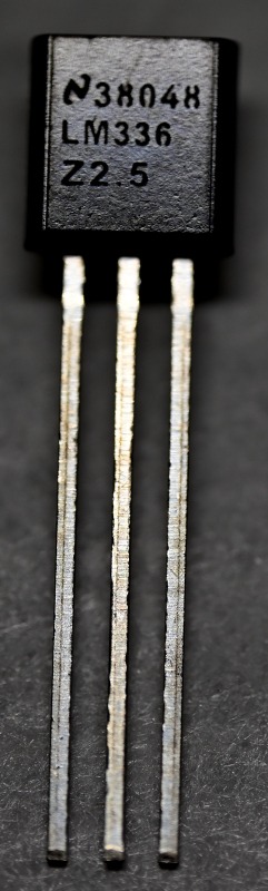

I have acquired some of these National Semiconductor 2.5V references (LM336).
Is it the correct one to be used for IronPre?
Do we trust the brand National Semiconductor to be used for IP or audio in general?
The datasheet is attached which was linked to the device as documentation.
proper one
though, if you pony up for TI or SIgnetics, it'll result in half Rout of buffer and you'll have better bass
