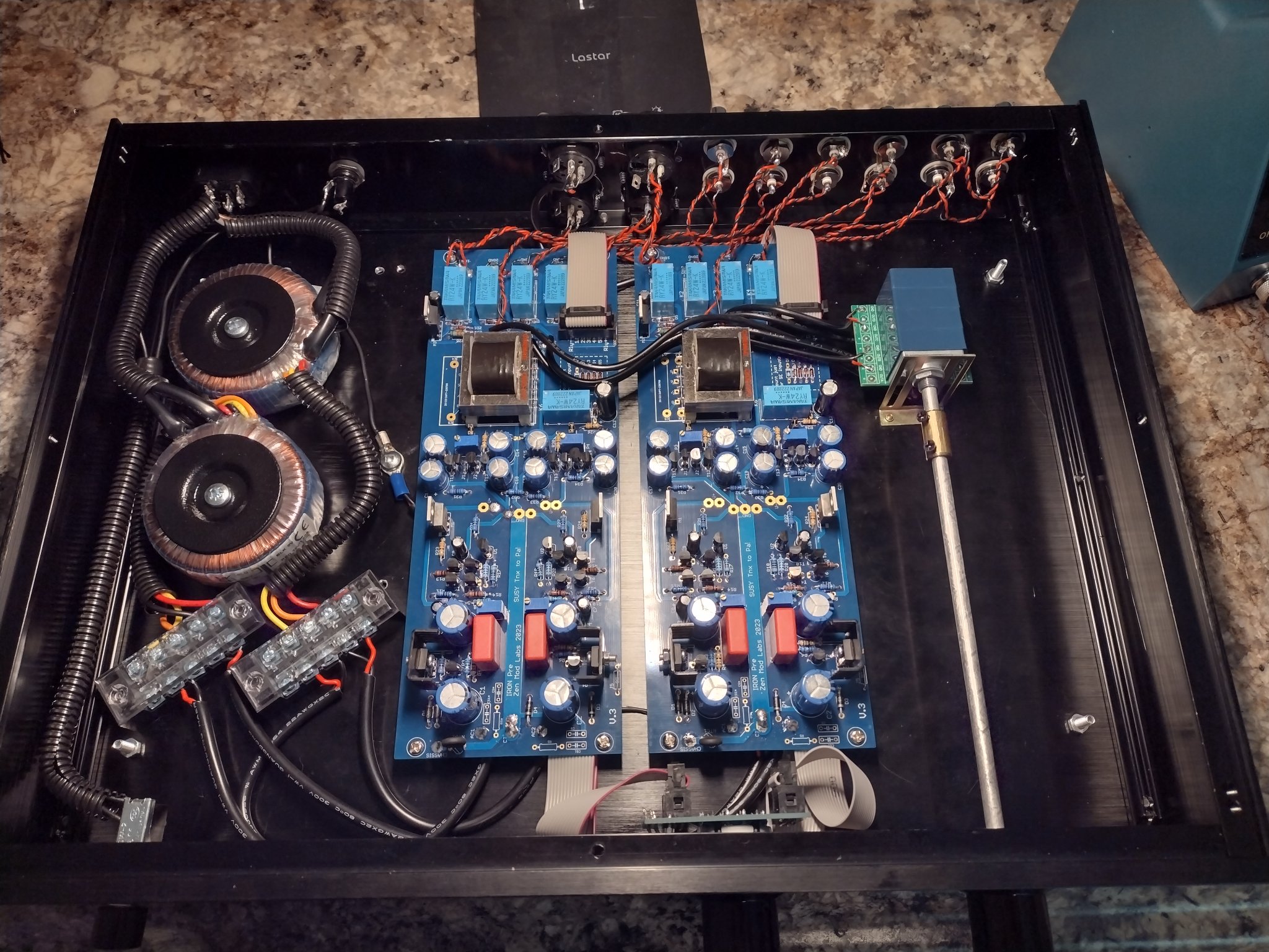

What does schematic say for recommended VA rating? SE or Bal... using one or two transformers if bal?
Edited to add - someone did 15V previously, I believe. If you don't need the voltage swing, then that's your choice. ZM can confirm. Oh... and be sure about your relay operating voltage if applicable. That's all I can come up with, but MZM is master of all.
we can count that xformers will have slightly higher secondary voltage than specced
try
you need at least 20Vdc rails after diodes to have steady 15Vdc after reg
that being worst case scenario, if having prolonged -10% voltage from the wall
try
Will i get away with using a 25va with 2 sec of 15v as i already have one.

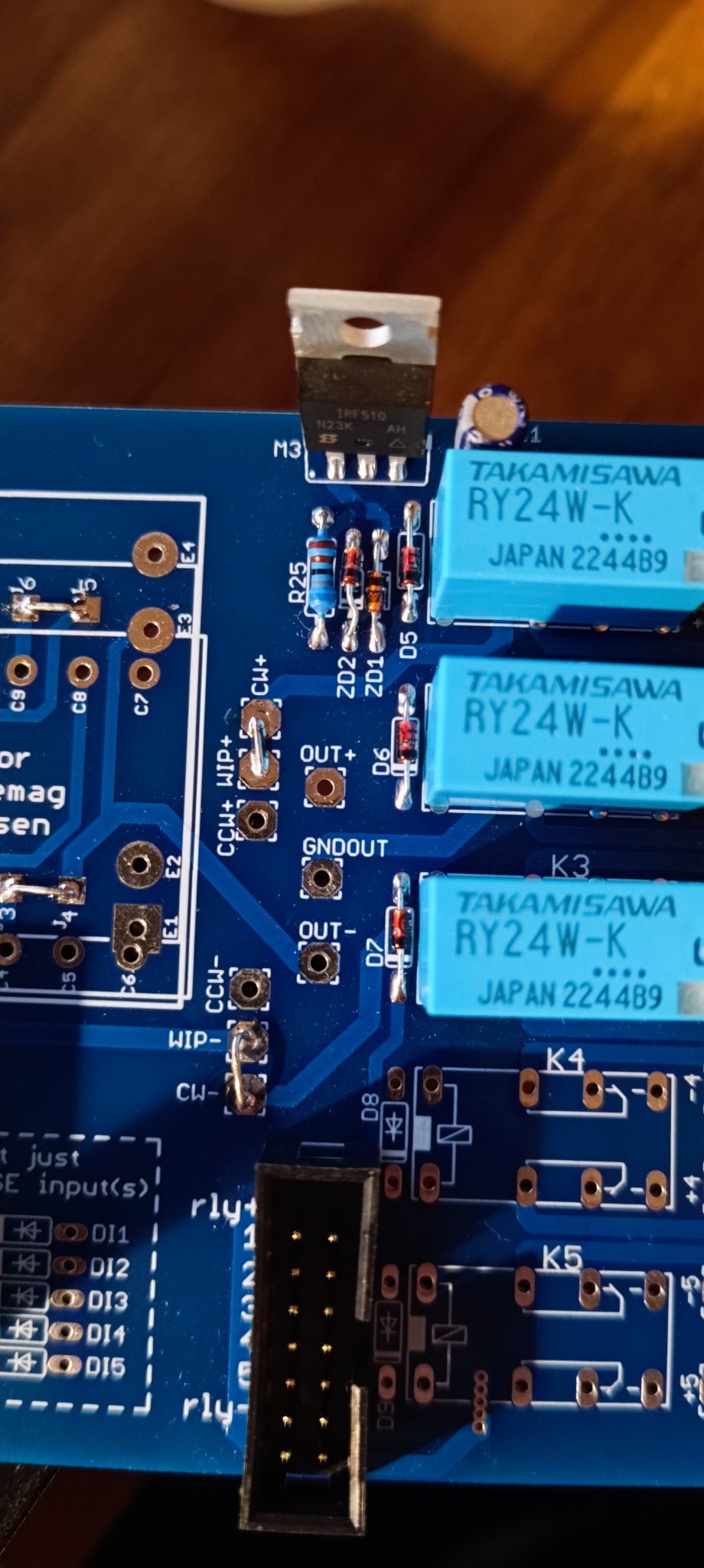

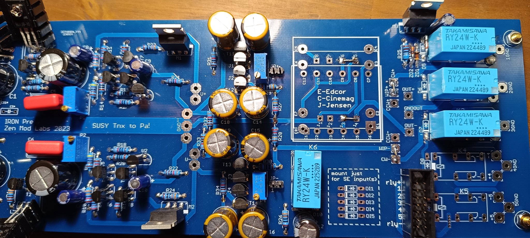

So with a sore back I'm able to sit half an hour at a time and figured something out why my relays (channel relays) were not clicking:
I believe silkscreen orientation, and thus diode orientation of D5 to D9 is incorrect on my boards. So I will change orientation of diodes in place.

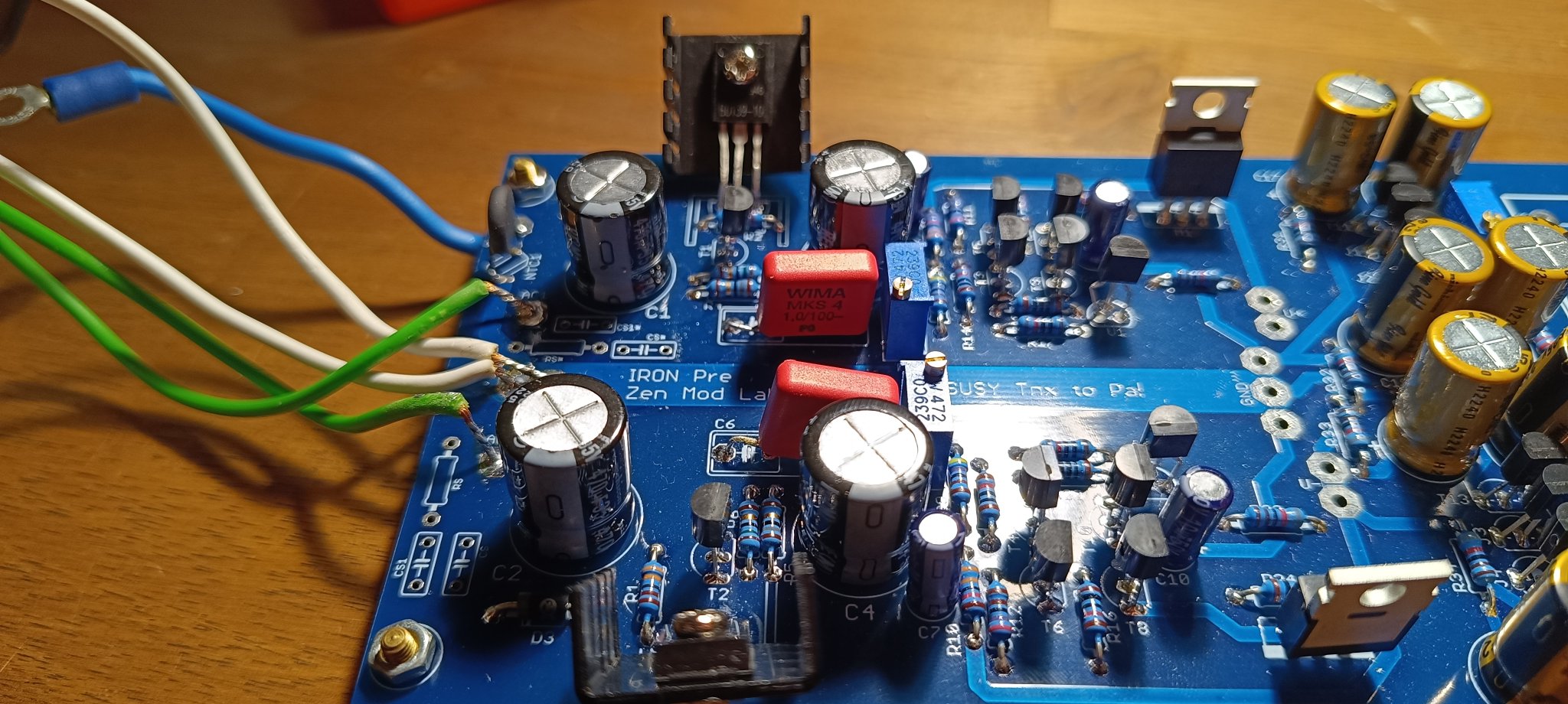

I have been able to reflow the boards, did not see anything weird. Are there points I can measure and compare with other half with regards to still persisting P3 offset at -28mv issue?
Should I try to swap the j74 between pos and neg half to see the behaviour persists?

you have initial run boards, where negative is common for relay circuit
so, as not first one trying to assemble it, maybe really just your boards are having parts overlay all messed
now - I can bet that you misplaced ZD1 and ZD2
ZD1 - for your relays - must be 27V
ZD2 - gate protective - can be anything from 5V6 to 20V
check these
fastest way - 14pin header - as on your picture - 2 upper pins are Rly+, two lowest pins are Rly-
take DVM, you need to have 23 to 24Vdc between those

24.4 dc between relay + and-, check.you have initial run boards, where negative is common for relay circuit
check these
Now, taking board out of chassis PSU lines show now plus 9vdc with no change to P1 and -0.8v on negative rail. Guess I screwed the good Gemini. For ease of troubleshooting why don't I populate a new board with fresh parts? Measuring the parts in the meantime😉

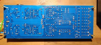

if repair is to commence - why not starting with proper pics of both upper and lower side of pcb?
(last 20 years living with exact problem, but still outa Op stage, luckily)

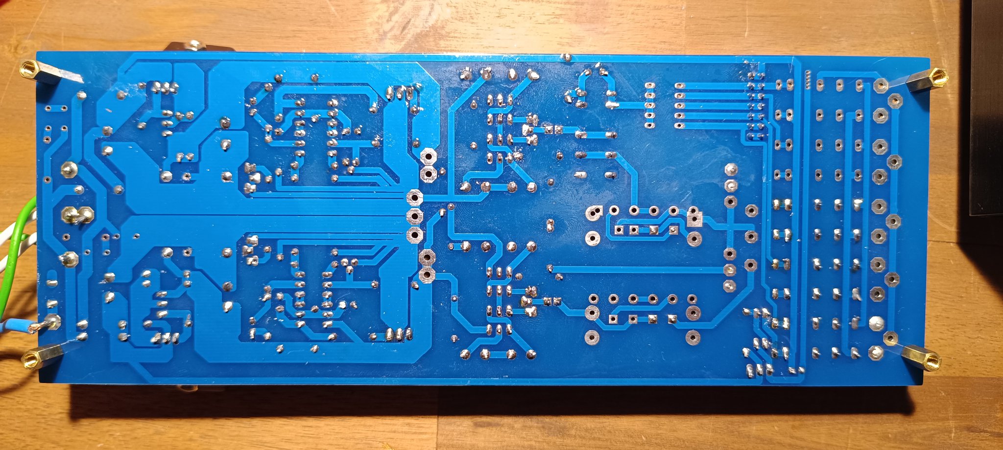

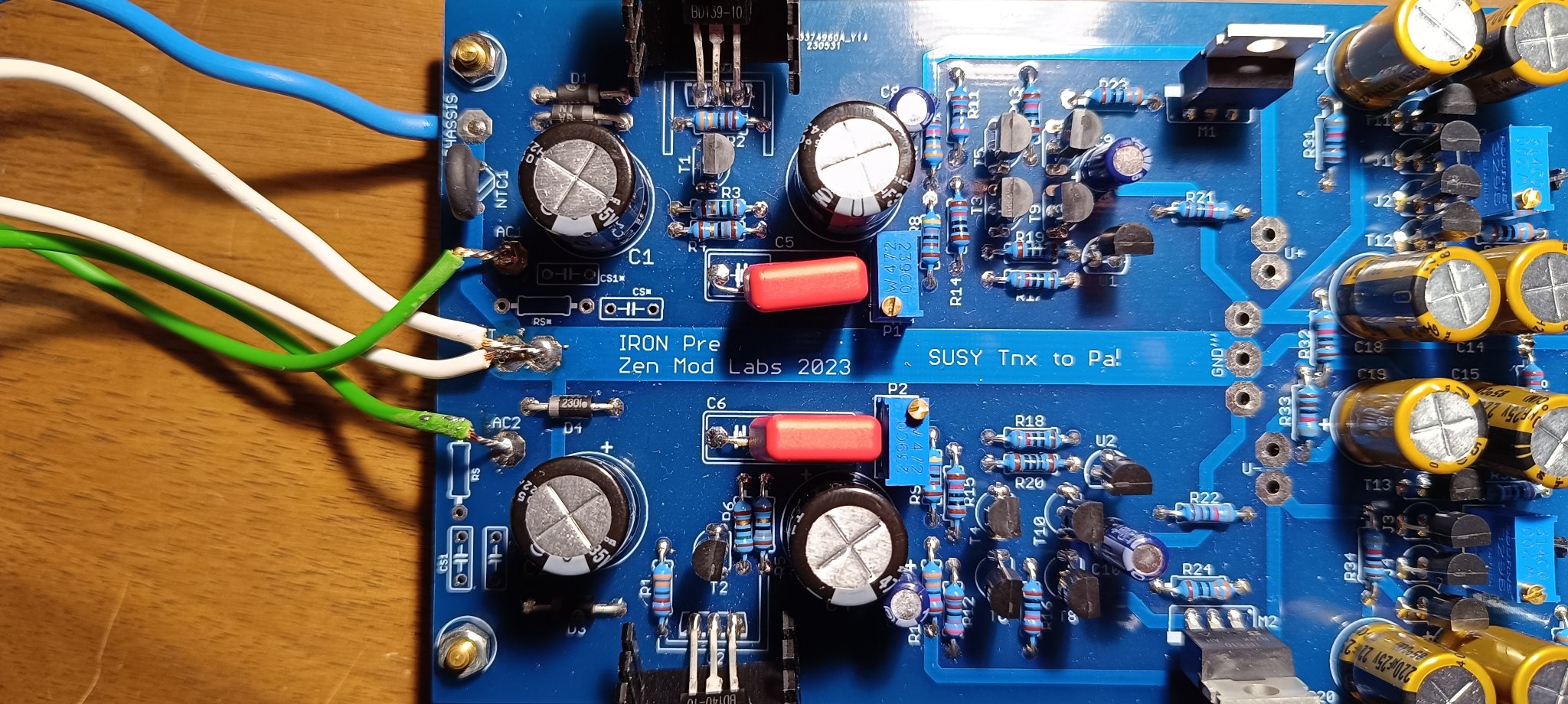

So upper side:
Gemini
Buffer
Lower side
Oh and I heard relay 1 clicking after reorienting d5. D6 and d7 will follow but first things first.
Edit: closup bottom side:
Hope you can keep it that way with practice!
So upper side:
Gemini
Buffer
Lower side
can't see anything else in this moment, but I can say that D5 to D9 must be oriented as per overlayOh and I heard relay 1 clicking after reorienting d5. D6 and d7 will follow but first things first.
if you don't believe me - test it - when you establish proper relay PSU voltage ( in range of 23Vdc), put red probe on IDC connector Rly+ pins, and black probe to (any) diode Anode ( non stripe end) and you'll see that anodes are on neg Rly leg
if you want that diode conducts current ( shortly before dying) instead of relay, feel free to orient them by your wish
now - "my relay is not clicking" .......
how exactly you tried energizing each relay?
if not with enclosed rotary switch and p[roper flat cable, you can do that connecting Rly+ pins with apropriate pins on IDC connector; +1 for Rly1, +2 for Rly 2 etc.
triple check positioning of all active and passive parts
most common mistakes are not following this simple logic:
all BJTs in positive rail are NPN, while mosfet is Pchannel (IRF9510)
all BJTs in negative rail are PNP, while mosfet is Nchannel (IRF510)
@Robin De Wolf - Of course Omnipowerful ZM is correct.how exactly you tried energizing each relay?

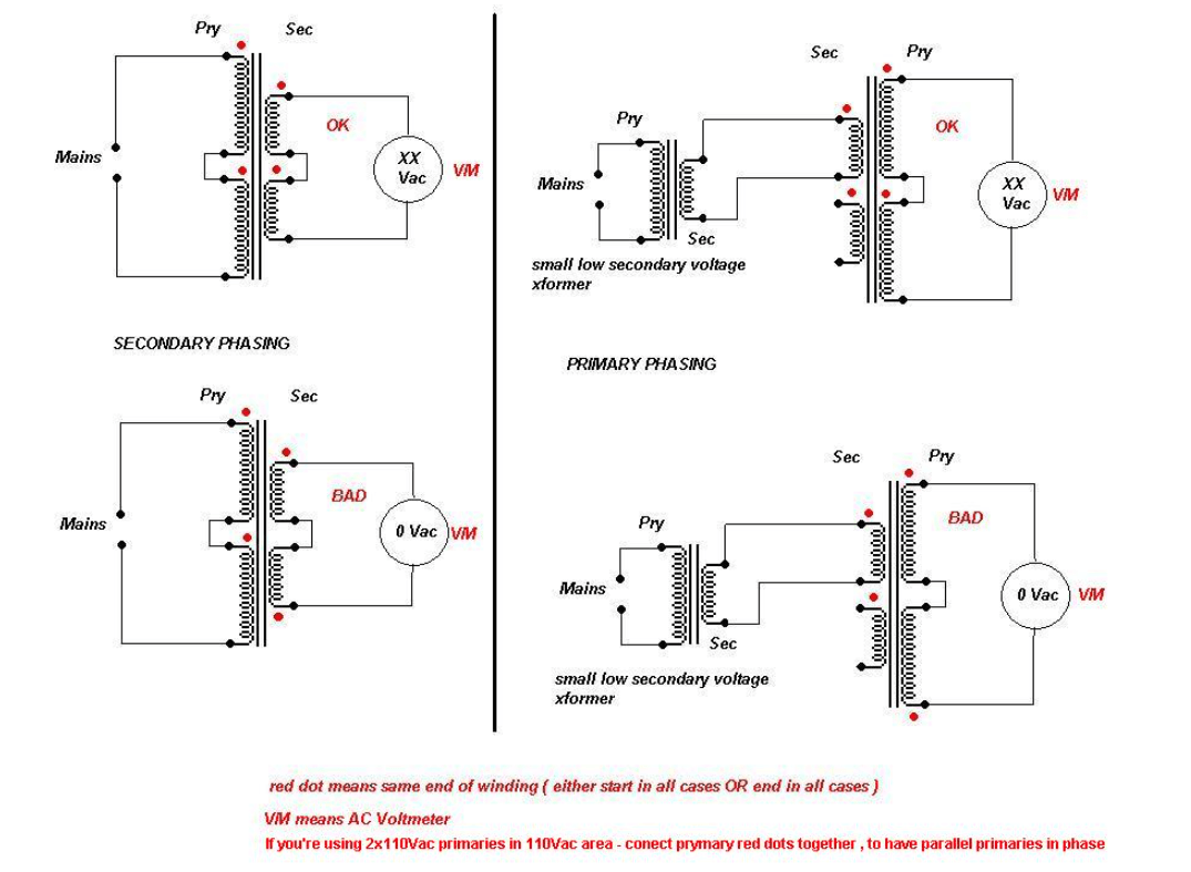

Measurement between AC1 and AC2 should be 36 vac with my dual secondaries (2x15v) transformers? or 0VAC?
