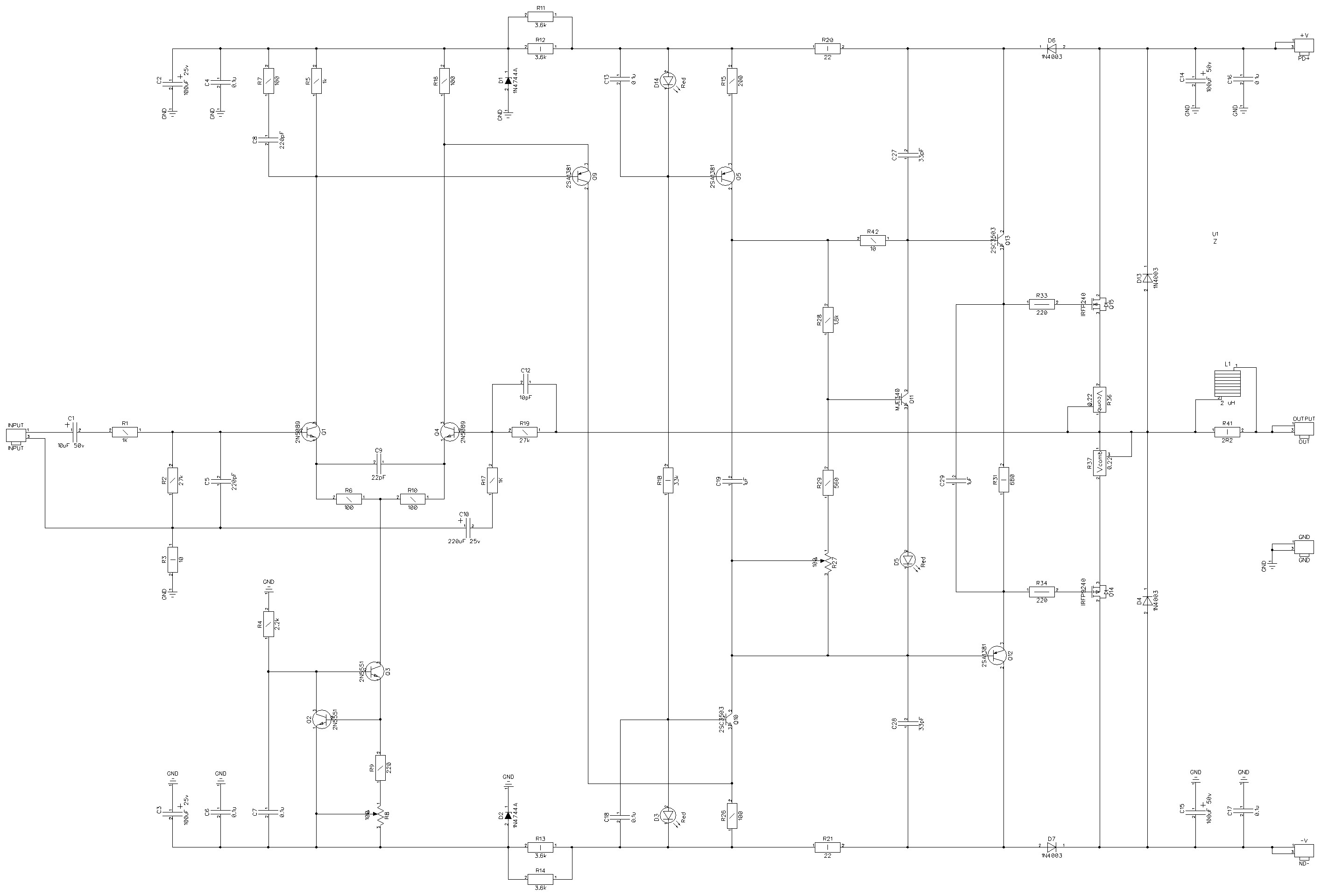

IRFP240/9240 Amplifier (simulated on TINA)

Thanks, nice design by the way, curious to hear what you find.
Is your clever drive to the VAS used in any OP amps or is it completely original?

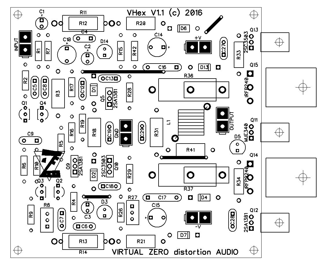

I made the input lay-out as farthest from any current sources, so that it won't catch any possible sources of contamination and produce the cleanest input signal possible 😉
100x100mm
My version of the layout 😉
Squeezed it to 100x100mm square board.
Etching-friendly - single-sided, 4 jumper wires.

I also noticed you have not included the zobel network, are they supposed to be installed offboard?

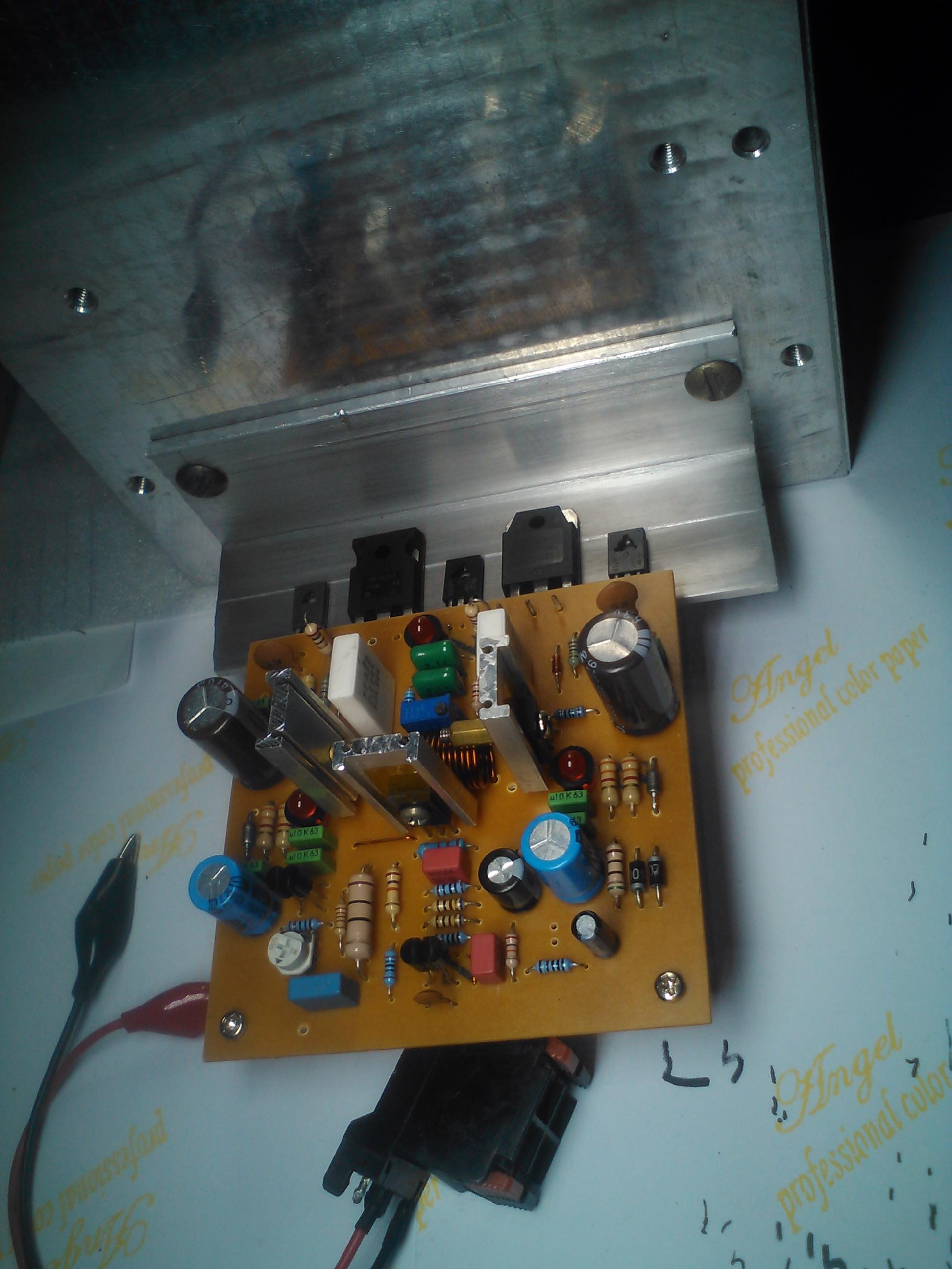

.....one channel populated, a few work on drilling holes and ready for the test. 😉 Not as good lookin as Terrys.

Zobel - this amp has got stability margins really high, so I just omit it. Although, the inductor is still important for the case of the highly capacitive load.
Looking good, cool local heatsinks. Just ... that TO-264 package looks odd - that's not IRFP one, right? 🙄
It is an IRFP240A with the "f" logo in its case. Possibly a Fairchild device or a "fake" one. 😕
The TO-126 heatsink are actually for Class D amp use. I installed them just for a test, I like the angular DIY made (like that of Terrys build).
It is good to know that the design does not need the zobel, this makes the pcb lay-out to be more compact. When I think of "speed" in a design I believe pcb trace distance width and copper zone plays an important role at nanosecond travel rate of voltage/current. 😉

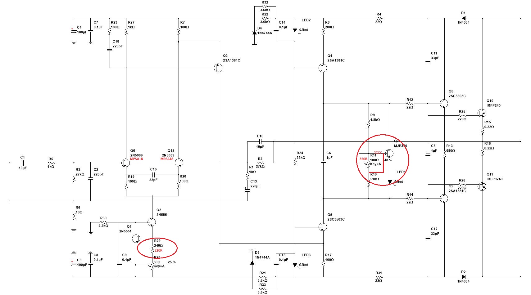

I have a question I was not ablte to get the VBE to work as drawn. Thinking the linking was wrong, I changed it so the trimmer was inline with the 1k8 resistor and changed the trimmer to a 500R. Now I can set the bias but obviously this is not wired correctly. Here is what I have. With the trimmer attached between the 1k8 resistor it is set to 350R. This give a bias of 80mA. What would need to be changed in order for the trimmer to be in the correct location? I'm attaching a schematic with what I have now.

As soon as you wire it correctly, the bias is going to decrease. Try to increase it with the trimmer. If it does not reach the desired value, slightly decrease R10 and try again. The lower R10+R11 - the higher the bias.

Terribly sorry, I do have it hooked up properly. I did have to change the way that Albert had it wired in his sprint file. After inspecting it more closely the 510 resistor is in series with the trimmer. I just remeasured and the trimmer is set to 230R on one channel and 220R on the other. Is there any advantage to using higher value for R110 and low value for the trimmer?
Terry, Valery,
The Vbe multiplier on any amp is incredibly tetchy and this one is special because of the red LED, which modifies the tempco so it doesn't over compensate on the warming outputs.
I'm very impressed with it, Valery, in my amps I reduce the tempco by using a simple Vbe multiplier in series with a zero tempco 4.7V zener. On hexfets the gate to gate voltage is around 8.25V for AB operation and only 3.5V across the BD139 Vbe multiplier is needed to effect precise quiescent current. The idea of a 1.6V led, which is almost zero tempco, reduces the tempco to less than 30% (2.25/0.65) compared to a full Vbe multiplier across the gate to gate 8.25V.

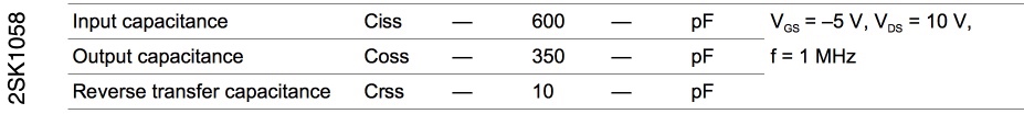

With regards to "no drivers" approach - HexFETs have got rather high and non-linear input capacitance (depends on Vgs), noticeably influencing VAS performance. Live measurements just confirm the theory - spectrums contain higher number of odd harmonics with higher levels. That's why I always add the follower - as soon as you drive the HexFETs with low impedance drivers, capacitance issue does not hurt any more.
Lateral FETs - completely different story. Those ones are designed for audio applications, capacitances are not that high and rather linear. Unfortunately I've got no graph for them, but again - live measurements show good results with them, being driven directly from the VAS, just a bit higher VAS quiescent current is recommended (8-10mA is good). All this beauty is also not given for free - lateral FETs are prone to local oscillation at very high frequencies (can exceed 100MHz), especially if more than one output pair is used. Well, not a show stopper - just needs to be addressed properly 😎
Valery
P.S. And you're right - removing the charge is more important. As usual, they close slower than they open. Well, 0.1-1uF cap between the emitters of the drivers works well enough.

How did you managed to make your amp working....mine, at power-on bias LED lit up momentarily then goes out. The other CCS LEDs are totally off. I can only get around 10vdc at drain pins and at the collector of drivers. I have also measured a small voltage at zener of +rail, but 0volt on the - rail. I suspect that fake looking IRFP240 device is faulty but the bias circuit seemed to be working properly because adjusting the trimmer, both fets gets much warmer...
I have corrected the missing ground ref trace in my board and the bias LED orientation. Also the mains 100w bulb tester is lit dimly, I am tempted to remove the thing because I was suspecting the fets does not get enough current to work properly..😕
