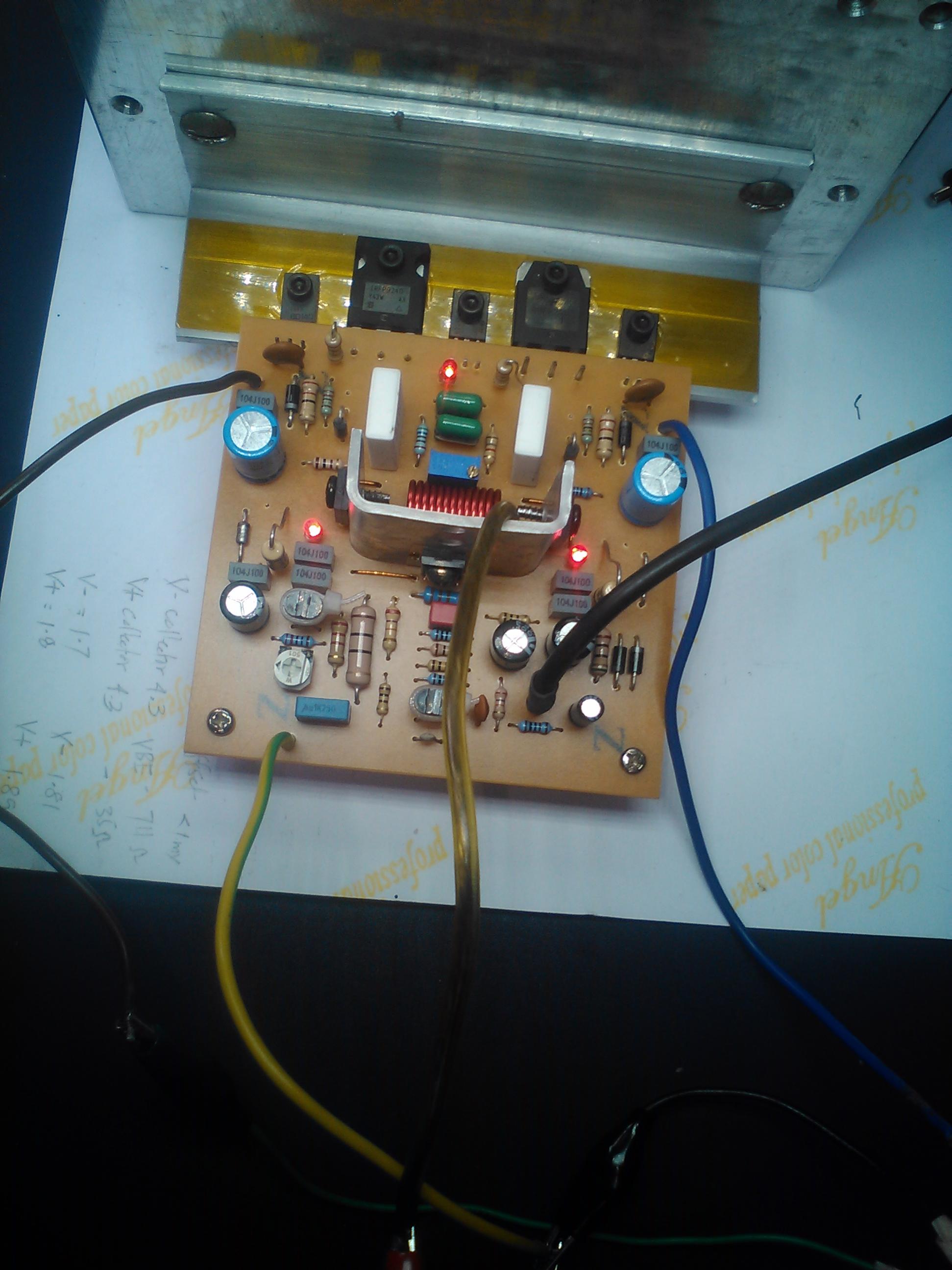

Here is my 2nd channel, all LEDs brightly shines. 🙂
I used 2sd669/b649 for Q3,4 & 5. It worked fine but I thought the superfast CRT vertical deflection transistor sounds much better here. VAS sink is DIY made , I just hammered the thing into shape just to have it made quickly.😀

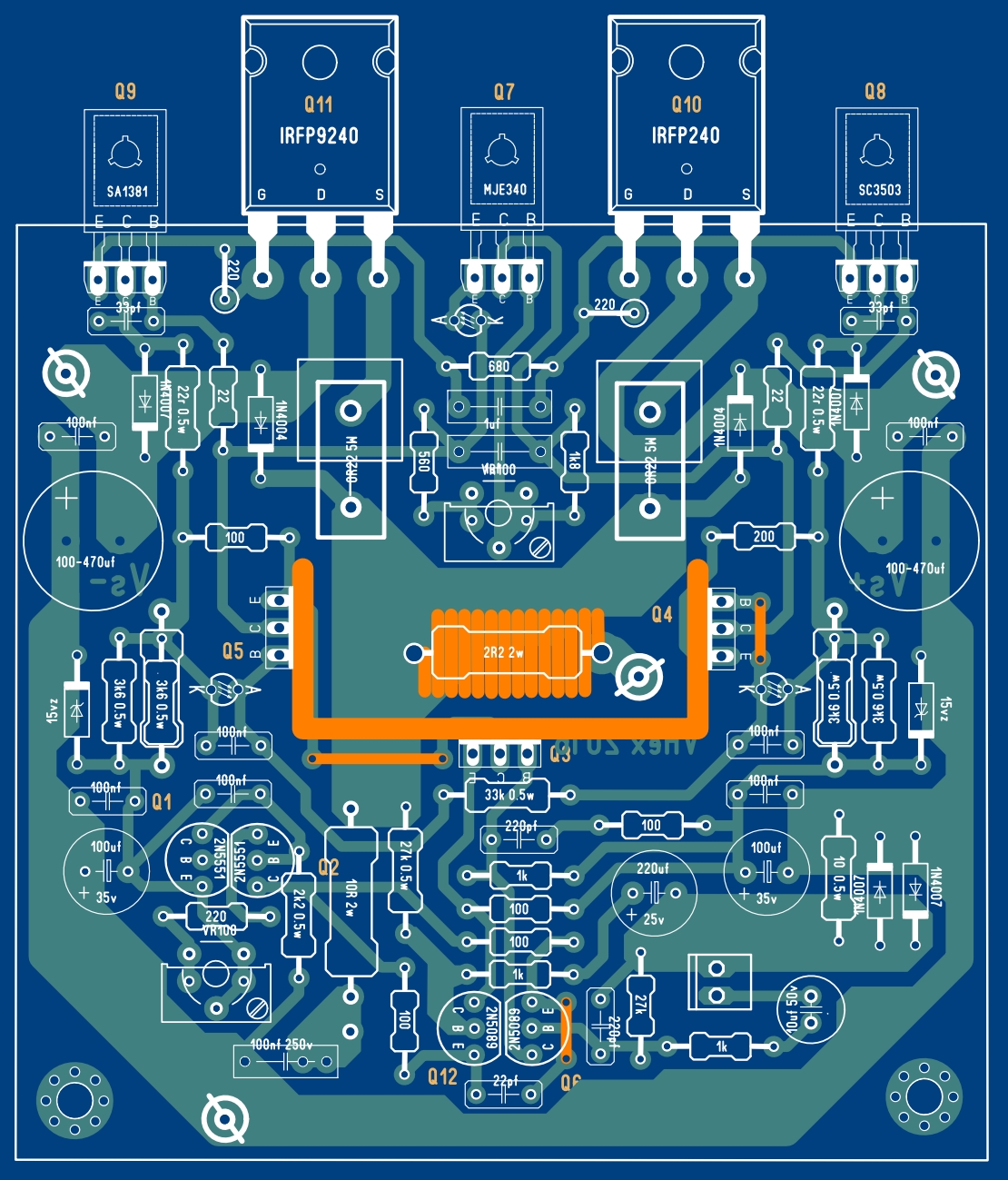

I am reposting here my PCB lay-out , now with the corrected traces and parts orientation and an option to install a single 1watter 1.8k for the input supply. My parts implementation is a combination of both the first VHex schematic (post #93) and the later VHex v1.1 (post #164)
Cheers!
Albert

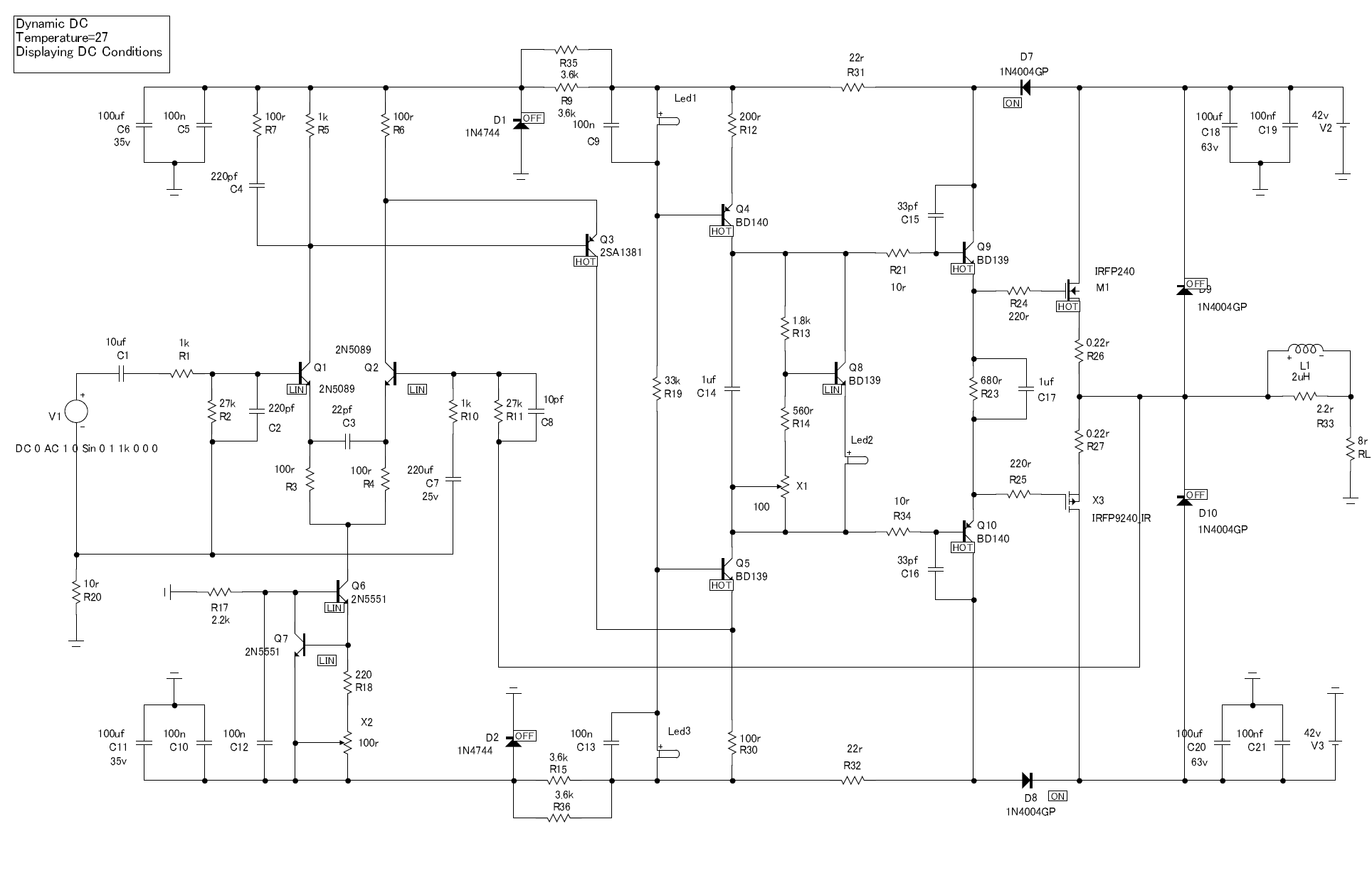

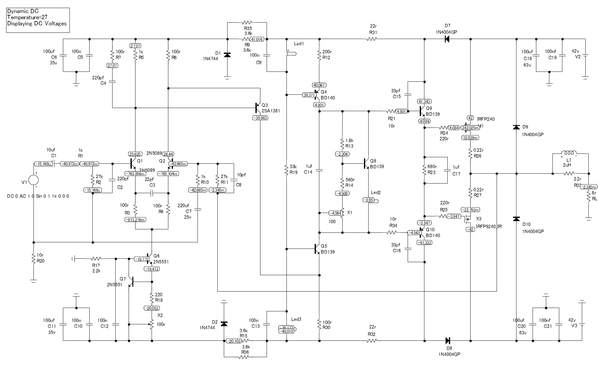

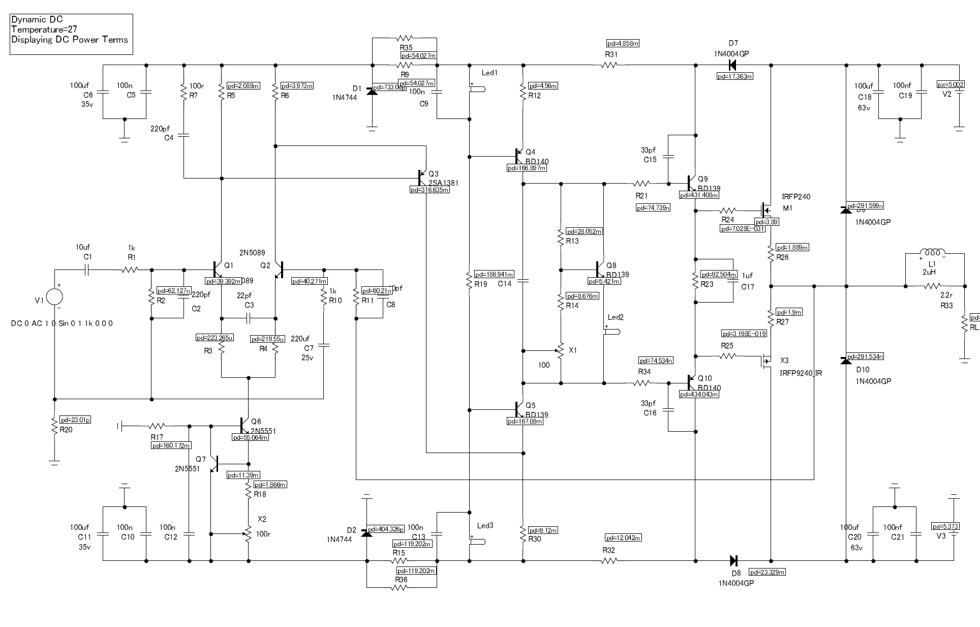

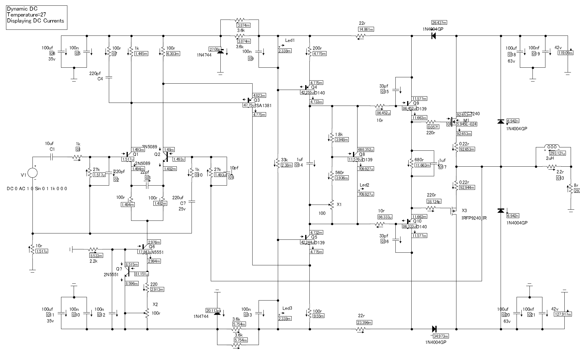

This all BDs TO-126 simulation is an answer to Peter Basel's query on post # 158 and Terry's query on my LED currents at post # 202 (excepting Q3 which is ideally 2SC1381).
I just thought it is worth noticing as a reference as BD devices is one of the more popular parts used by DIYers in the forum. Schematic follows the latest v1.1 at post # 164 Simulation is 1v amplitude at 1KHz freq. You may notice DC offset is negative as it displays more closer equal current dissipation of the input pair and the output ballast resistors than on having a positive dc offset. IRFP240 is a generic model this explains why it shows a different symbol than the IR 9240 model.
Cheers!
Albert
