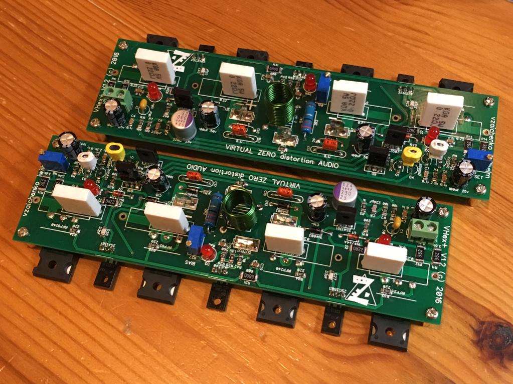

Here is a conpact SMD layout for the LetFET option - good for thin compartments or multi-channel builds.
Both VHex+ and VLatFET+ boards are available.
P.S. Rails decoupling is improved, AndrewT - thank you for raising this point earlier in the thread.

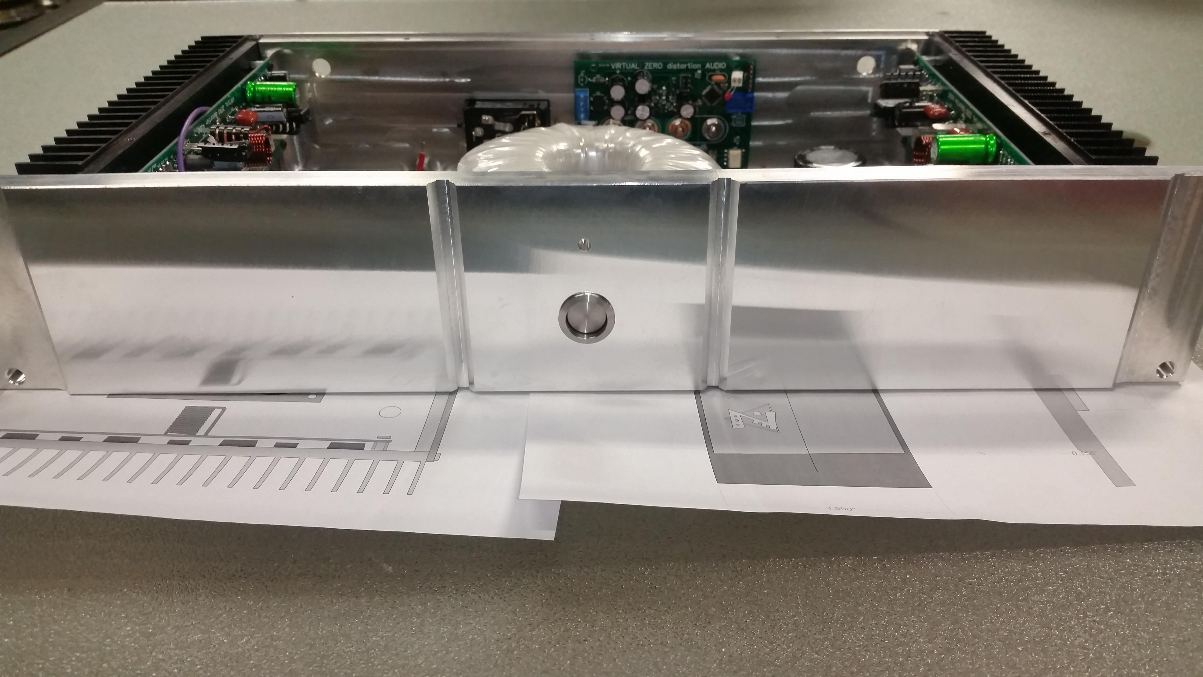

I've got mine up and running. It's a nice sounding little amplifier! Now I just need to design some speaker protection for it and finish the chassis.

Excellent! Very cool snap-on local heatsinks.

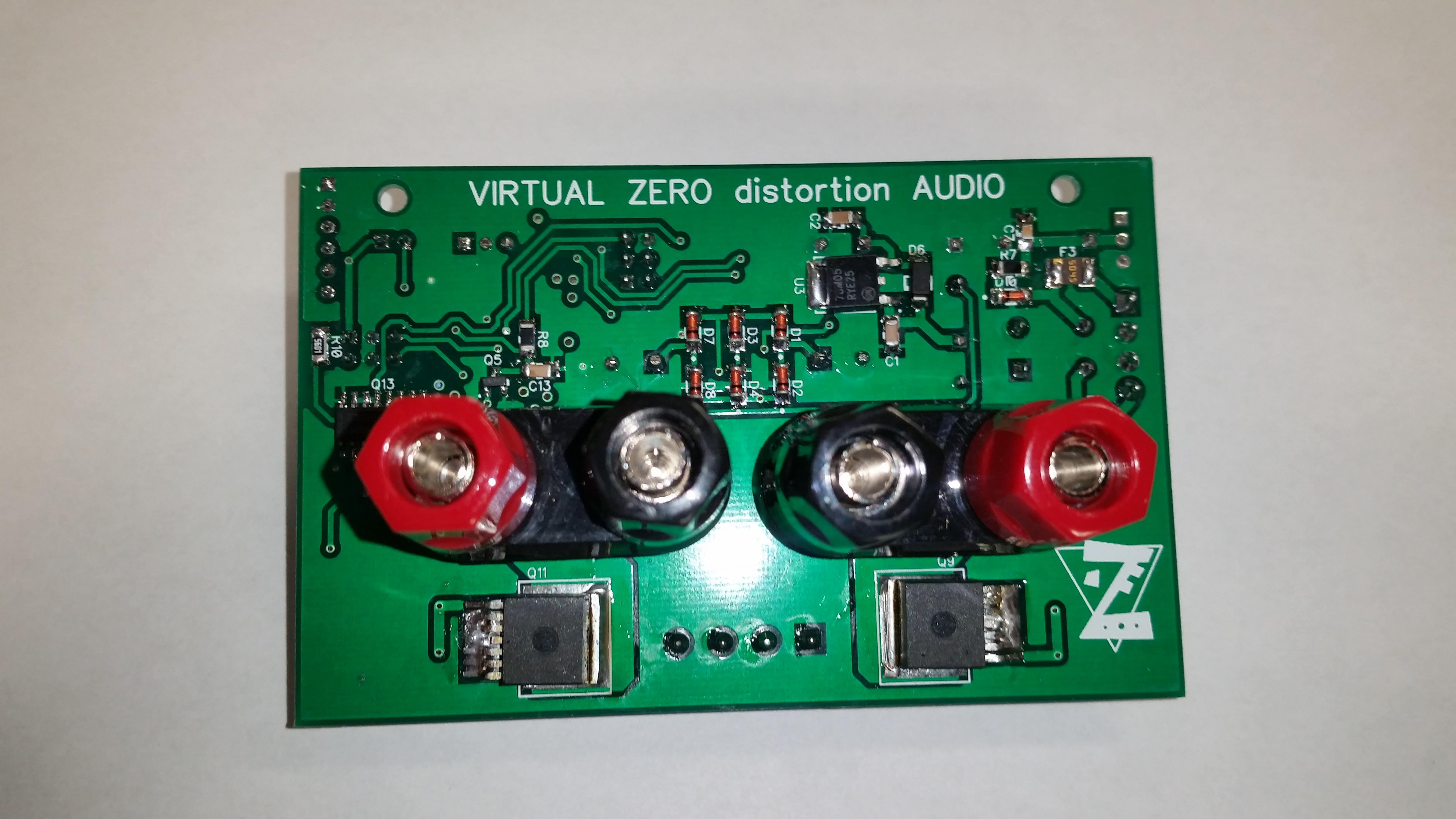

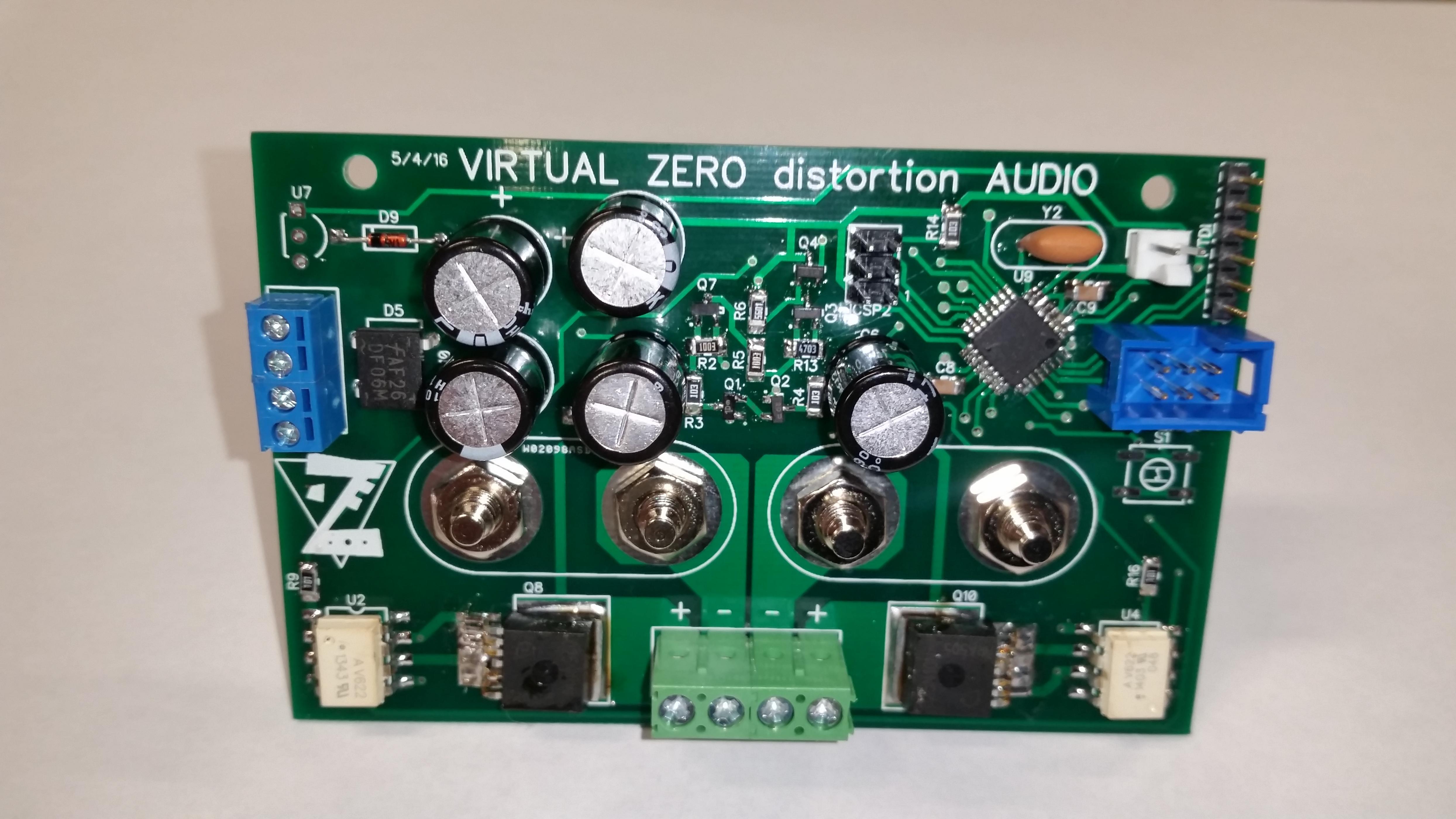

Jeff, I think a light version of 21-st century board on a single pcb would be nice. We don't need inrush at this power rating - only time delay and dc protection for the speakers. Standby transformer is also not required.
I've got one half layed out. Both outputs on one board. My main transformer has 15V outputs that will work great to power it.
I'm also adding provisions to monitor temperature (I2C). It might be nice to have a temperature warning and remove the output load on overheat.
It's a solid state speaker relay design using mosfets. There's a standard analog DC detection on board connected to a microcontroller. The DC detection directly switches the mosfets off on fault and signals the microcontroller. The microcontroller then will signal a fault warning with the front panel LED. The microcontroller manages on delay and shut down. It also monitors temperature, and will disconnect a speaker if the amplifier is overheating. The board is expandable to do almost anything via I2C or SPI as well. I've got supplies with rail shutdowns for larger power designs. I'm also starting to experiment with current monitoring over I2C.

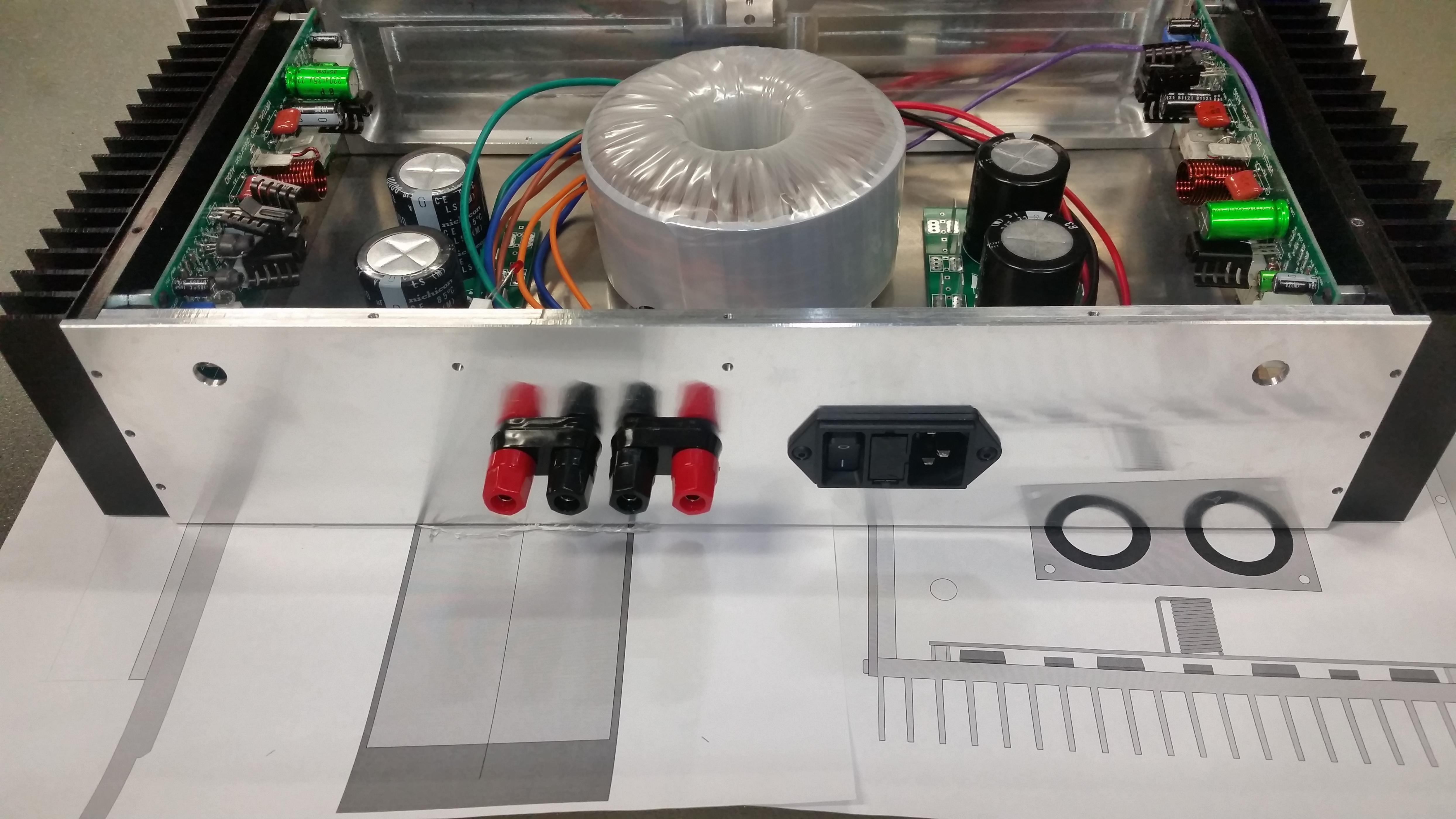

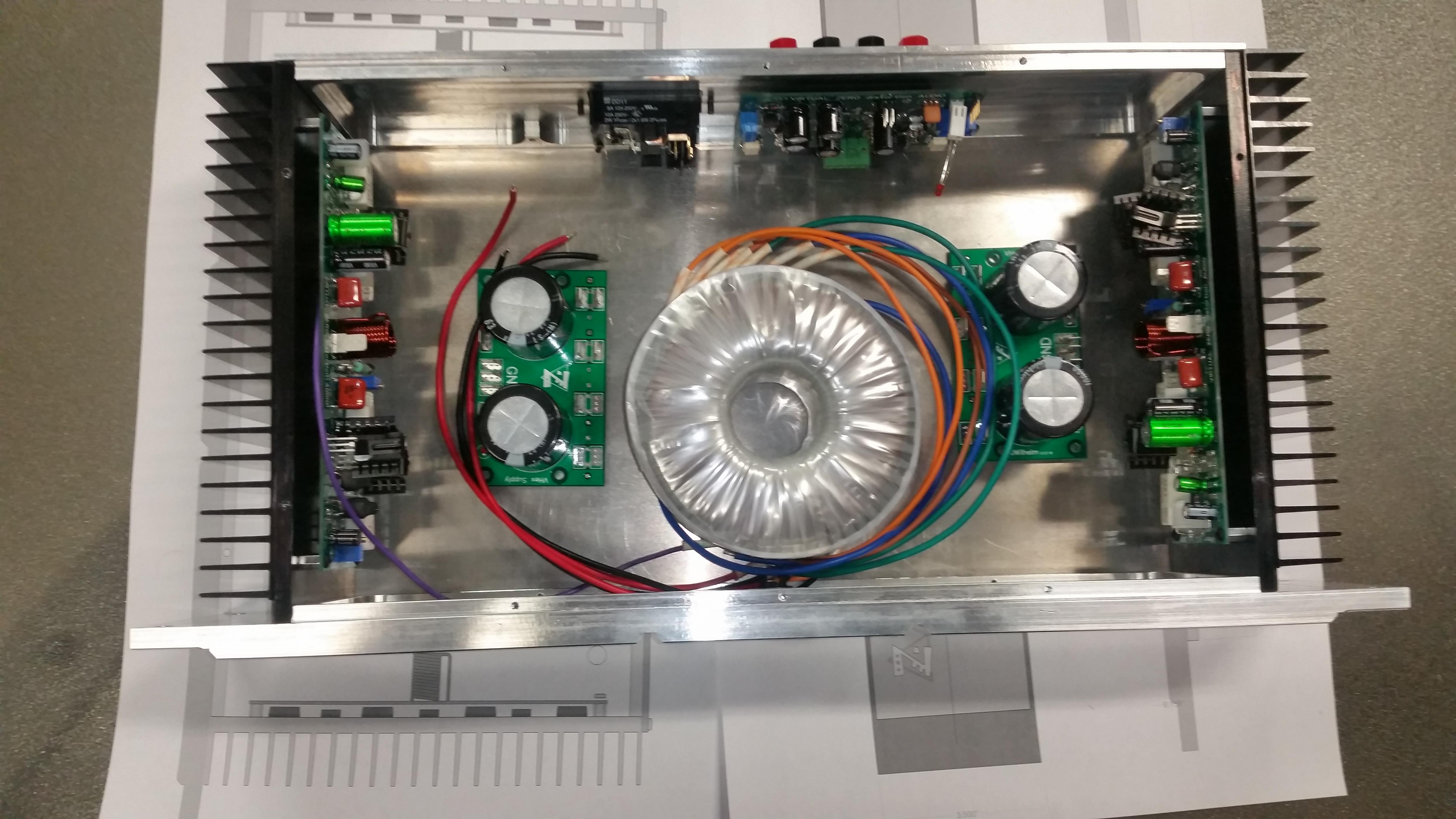

I'm making some more progress on my build! If all goes well it should be a finished product by next weekend.
:Olympic::superman:
You deserve to start a VHex build thread, I was thinking of updating the first post but the thread title is misleading.

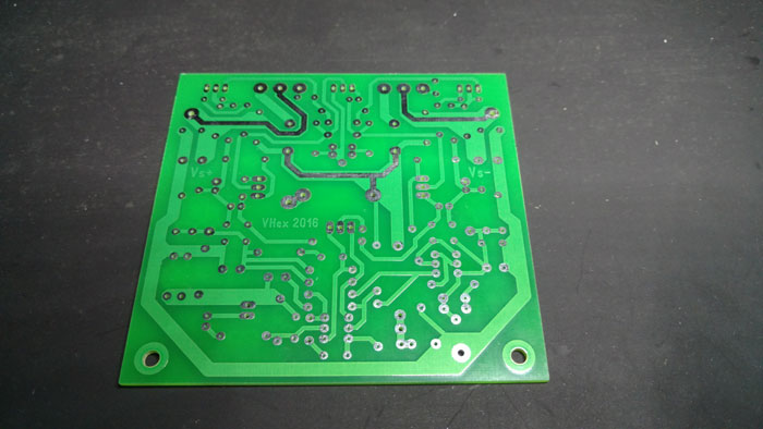

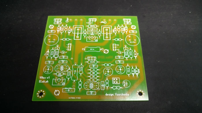

A group of fellow countrymen based in china who are also in the industry managed to fabricate my board design. The prototype will be subjected to hardware testing but the final build will be brought here in my country.
:cheers:
Albert
