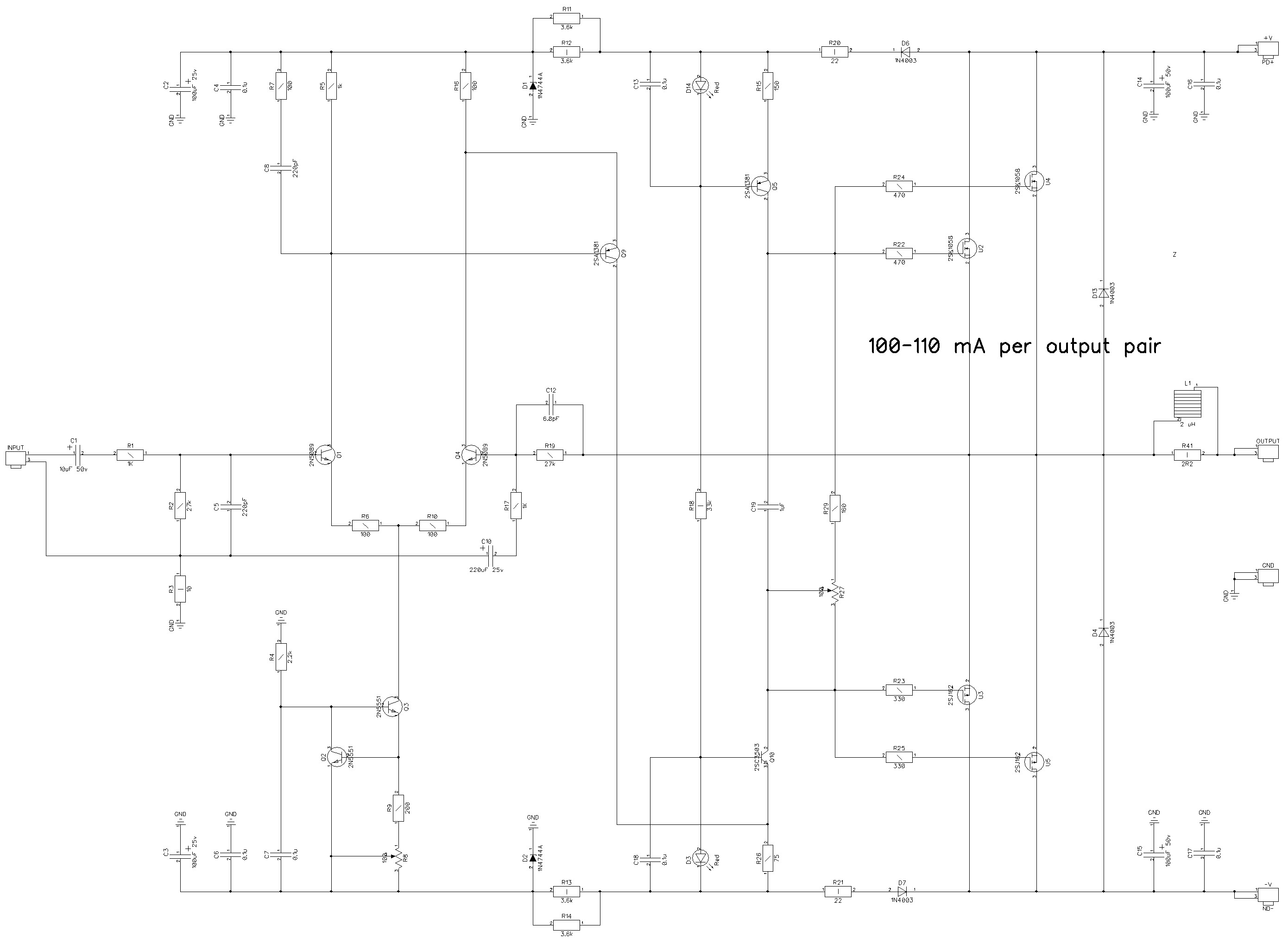

VLatFET+
Albert and all,

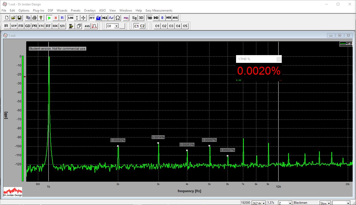

I have just tested the similar front-end configuration together with Renesas lateral MOSFETs at the output, directly driven from the VAS stage (its quiescent current is increased up to 7mA for that purpose).
One or two pairs may be used (I have tested with 2 pairs and +/-52V DC rails).
Runs very smoothly, nicely sounding, thermally stable, no issues identified.
The whole thing is pretty fast, despite its overall simplicity 😉
Optimal quiescent current for the outputs is 100-110mA per pair (lowest distortion).
PCB may become even smaller now 🙂
Valery

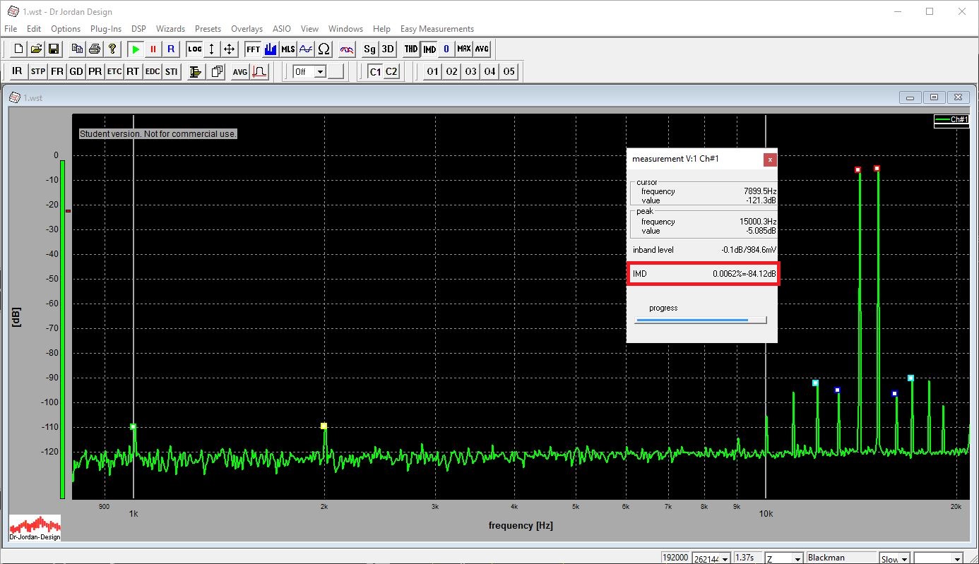

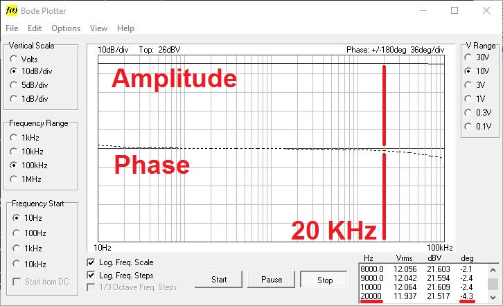

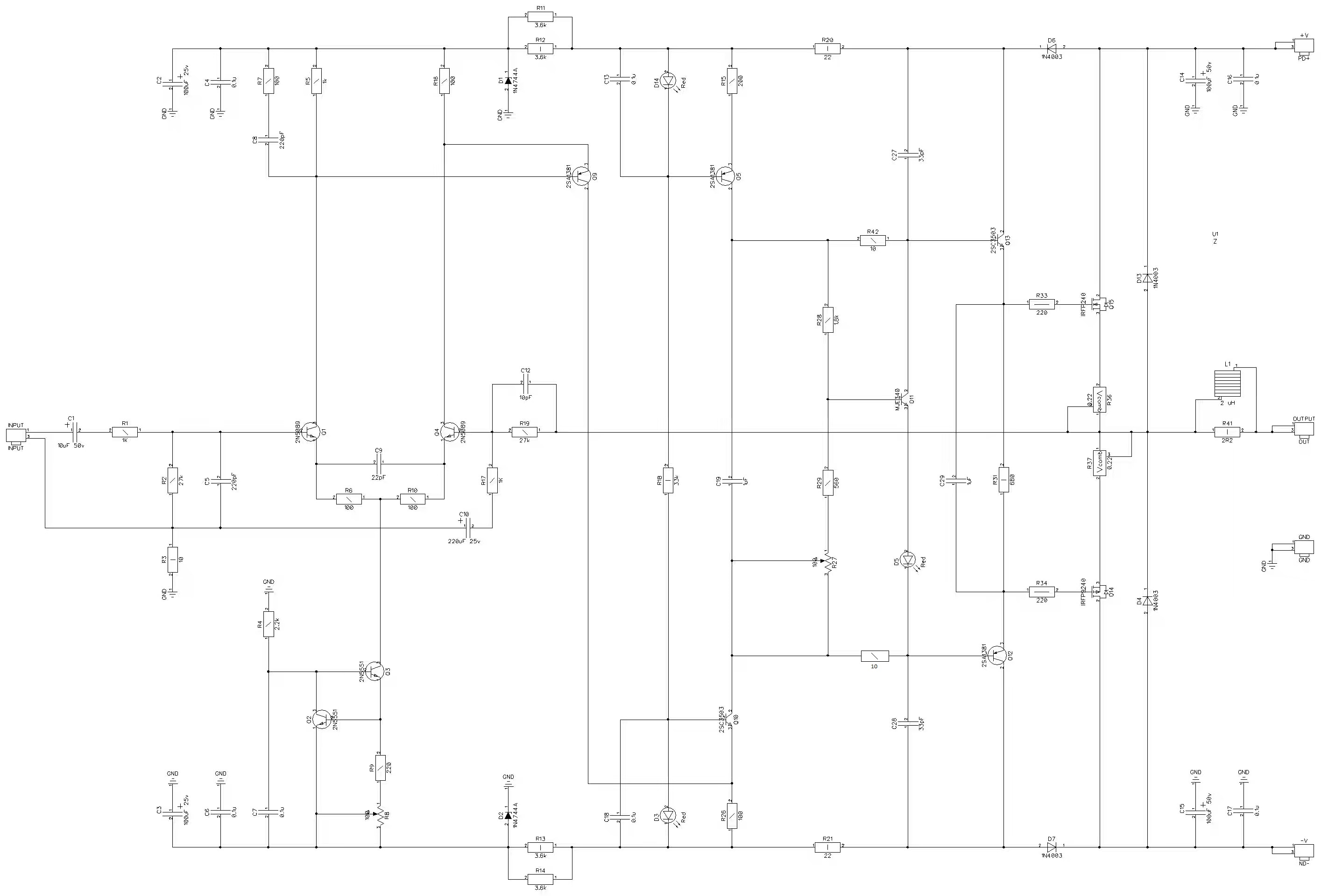

Is R15 (150r) intended to be different from R26 (75r)?
There is no capacitance after R20 & 21. Intended?
Yes, this is correct - Q5 and Q10 are the current sources, pulling the same current, but half of the current through R26 is taken by the collector of Q9, so R26 has to be half of R15 in order to keep the thing balanced.
Capacitance - yes, actually a couple of electrolytics can be added. Or C14-C17 can be moved after R20 & R21. In fact, this circuit has got rather high PSRR by design, so... I ran it the way it is - no ripple issues observed. Also - it's dead quiet, same as VHex one.

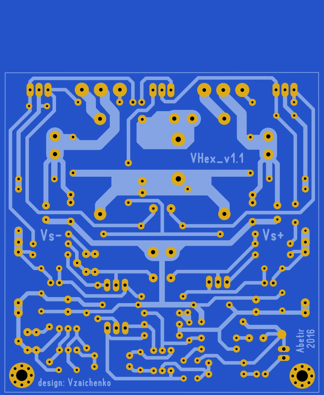

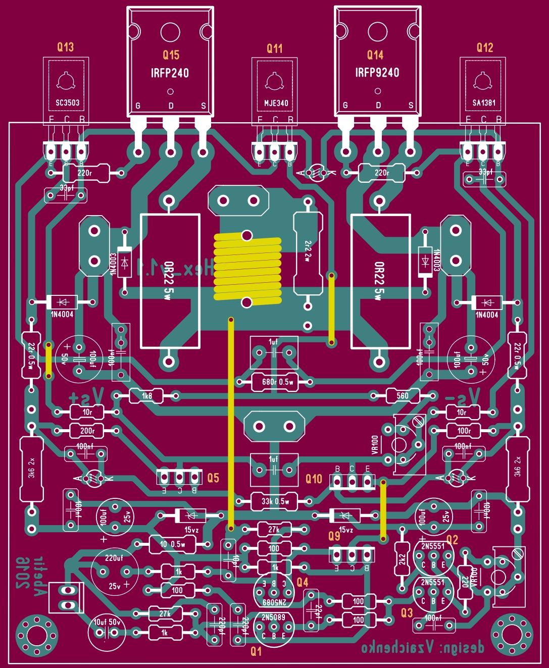

My take on VHex v1.1 (originally designed by Valery) I am only retaining the bigger horizontal mounted wirewound about the length of a Dale black wirewound resistor, so that both can be utilized.
I just thought it needs a rework 😉
Cheers!

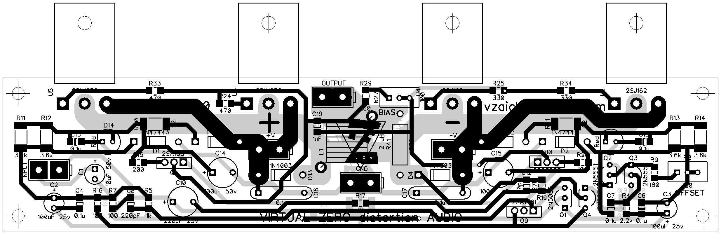

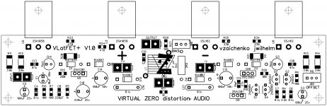

VLatFET+ (1 or 2 pairs of output devices) 7" x 1.5" inch layout
Here is a conpact SMD layout for the LetFET option - good for thin compartments or multi-channel builds.
Both VHex+ and VLatFET+ boards are available.
P.S. Rails decoupling is improved, AndrewT - thank you for raising this point earlier in the thread.

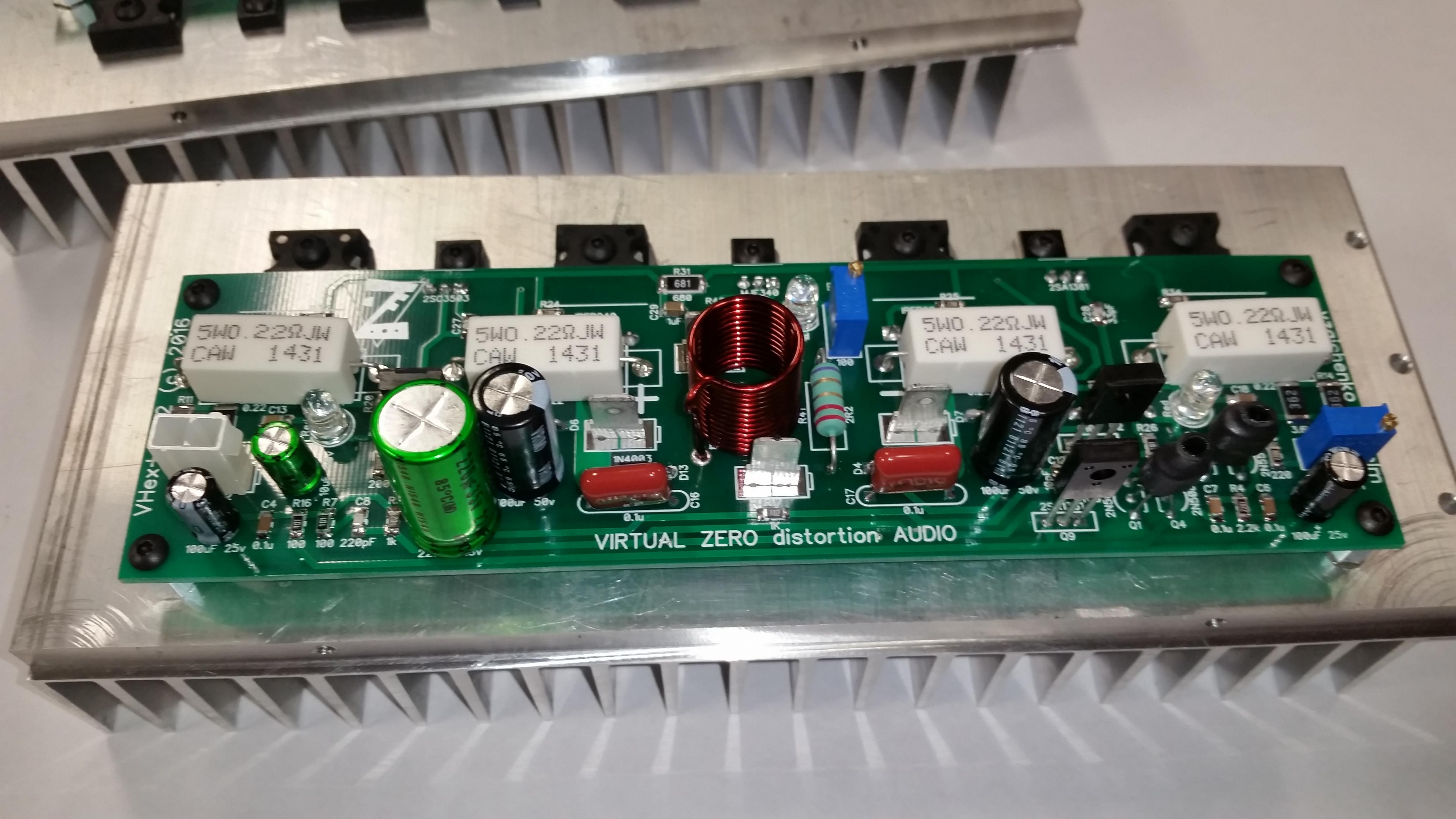

I have two V-Hex channels ready for testing, but I want to anodize the heat sinks before I crap them up with thermal compound.
Wow! Nice kit 😉

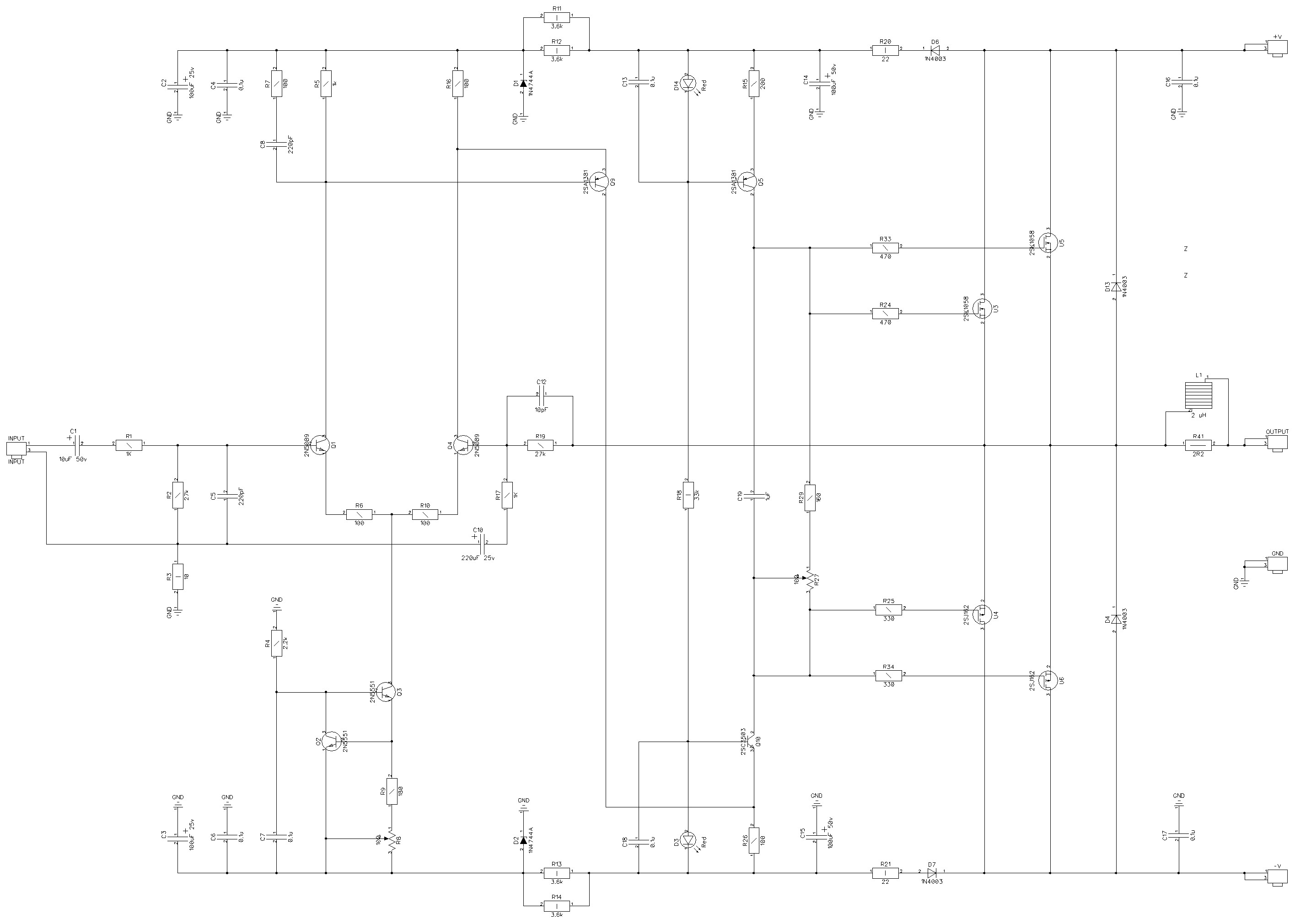

The exact schematic is not published here, although it's very similar to this one - >VHex with 1 pair of output devices< - but having 2 pairs of HexFETs at the output.

Vzachenko did this layout. I don't think he ever posted the schematic, but it's the same as this with an extra set of output devices and associated parts.
