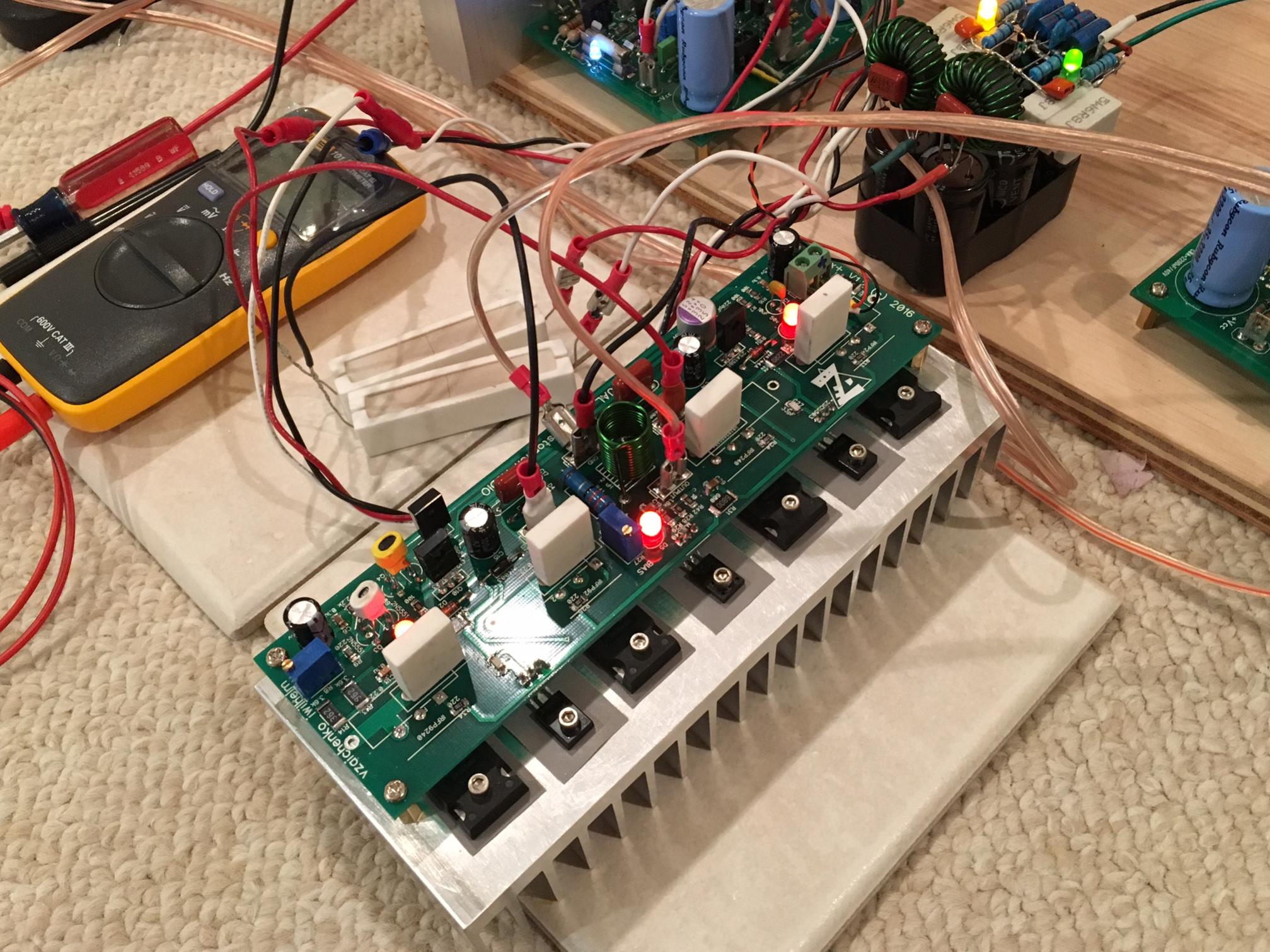

I received the heatsinks today (heatsinksusa.com) - these are really thick and heavy. A great value at $2.63/inch (3 inch long extrusion). After some drilling and tapping, I hooked it up with some 10R safety resistors. It fired right up. I set bias to recommended 80mA and offset is 0mV super stable.
It sounds very very nice. It's late at night so I can't crank it up but no audible sign of distortion. I am using it with a 35v PSU at the moment but will build a 49v PSU soon.

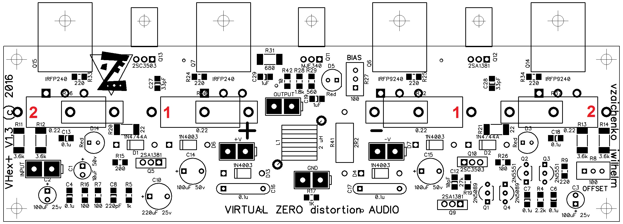

It was very late last night and I now realize the bias was set thinking my old ways of a single transistor output stage. I set 80mA based on 0.80v across the 10R external resistor so that is global idle current (which is probably less than 20mA since there are 4 transistors?). I probably need to take measurement across 0.22R resistor to get actual bias current. But that is one transistor - do you have recommend test point for voltage probe to set bias for both transistors or do one by one and add up?
OK, that's what I suspected 😉
The best way to measure - use the empty holes near each 0.22R resistor - see attached. This way you measure the voltage over 2 resistors in series at once.
Measure the voltage between 1 and 1 first, then - just to check - between 2 and 2. Divide the voltage by 0.44R (as you've got 2 resistors there) - get the current. For 80mA per pair it should be 35-36mV.

Ok, thanks - will do that tonight. I suspected those empty holes would come in handy just exactly for this purpose. I should have known sooner but this was my first use of such a large heatsink so kept thinking maybe it was drawing heat away better.
That's fine, you just ran it at roughly half the idle current. But even at nominal one the heatsinks will be just moderately warm. You'got very good ones!

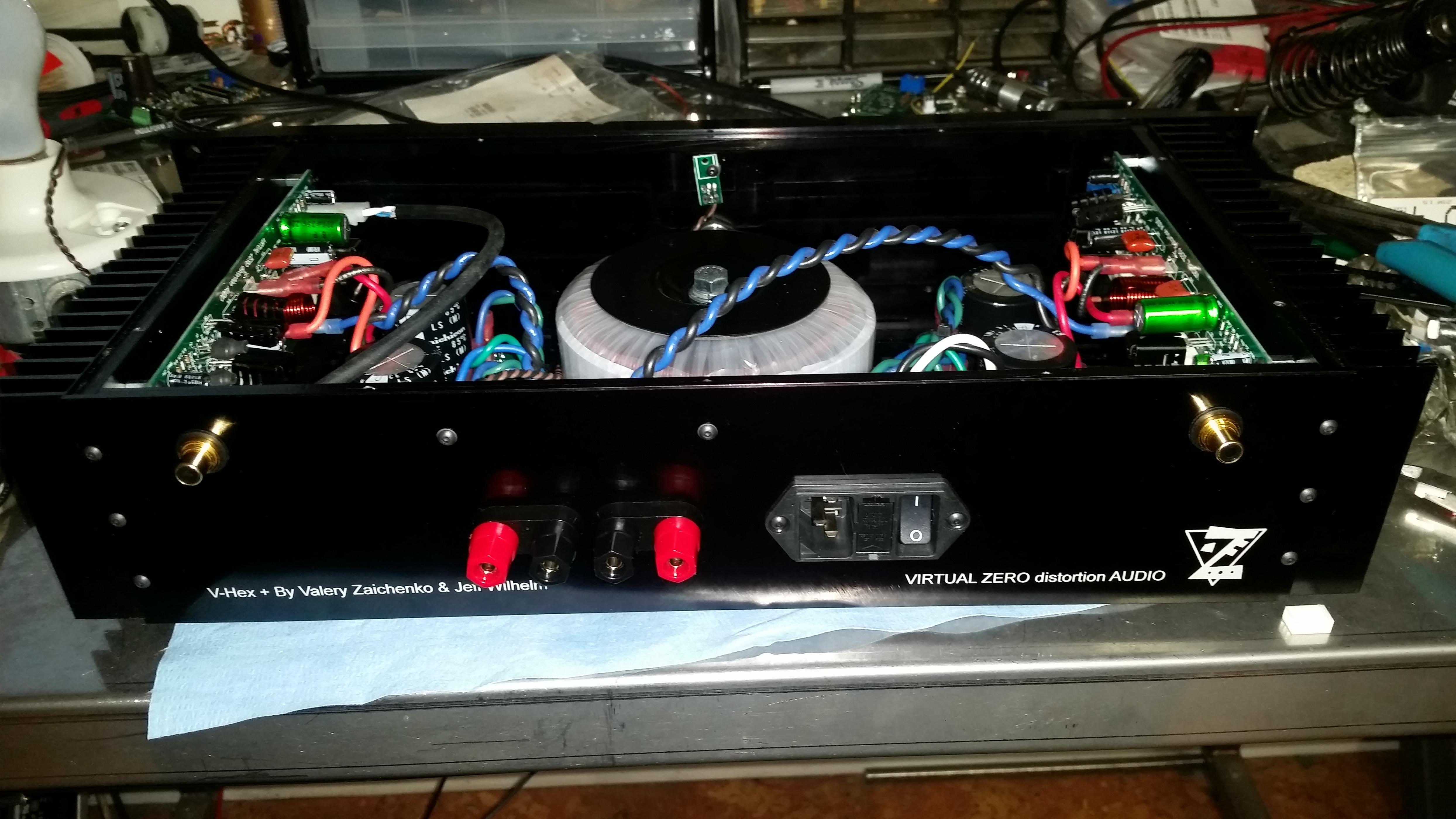

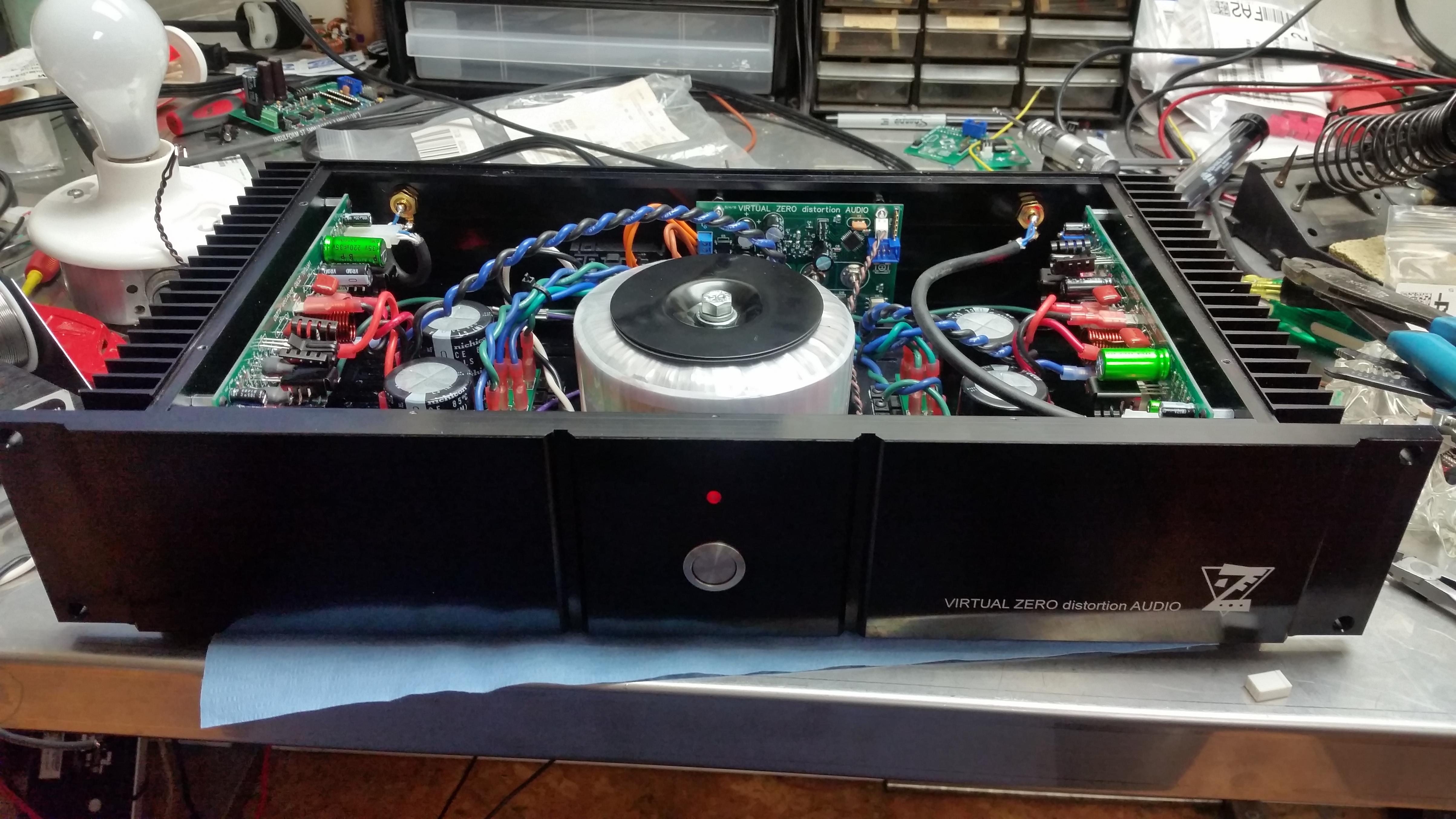

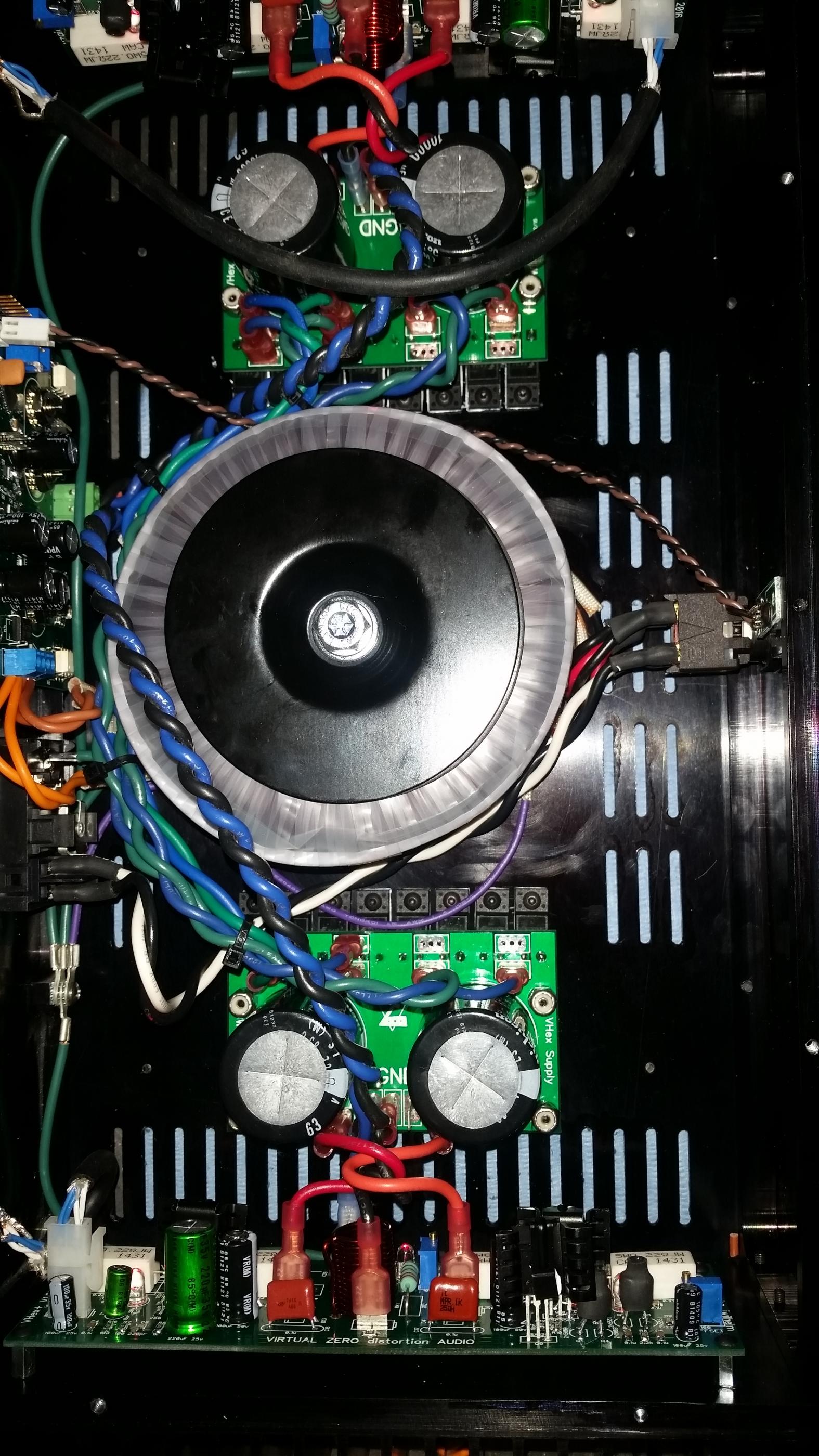

It's Alive!
The laser shop was really quick with my covers. I've got it together and powered up. Tomorrow morning I'll find my bench top again and begin testing.
