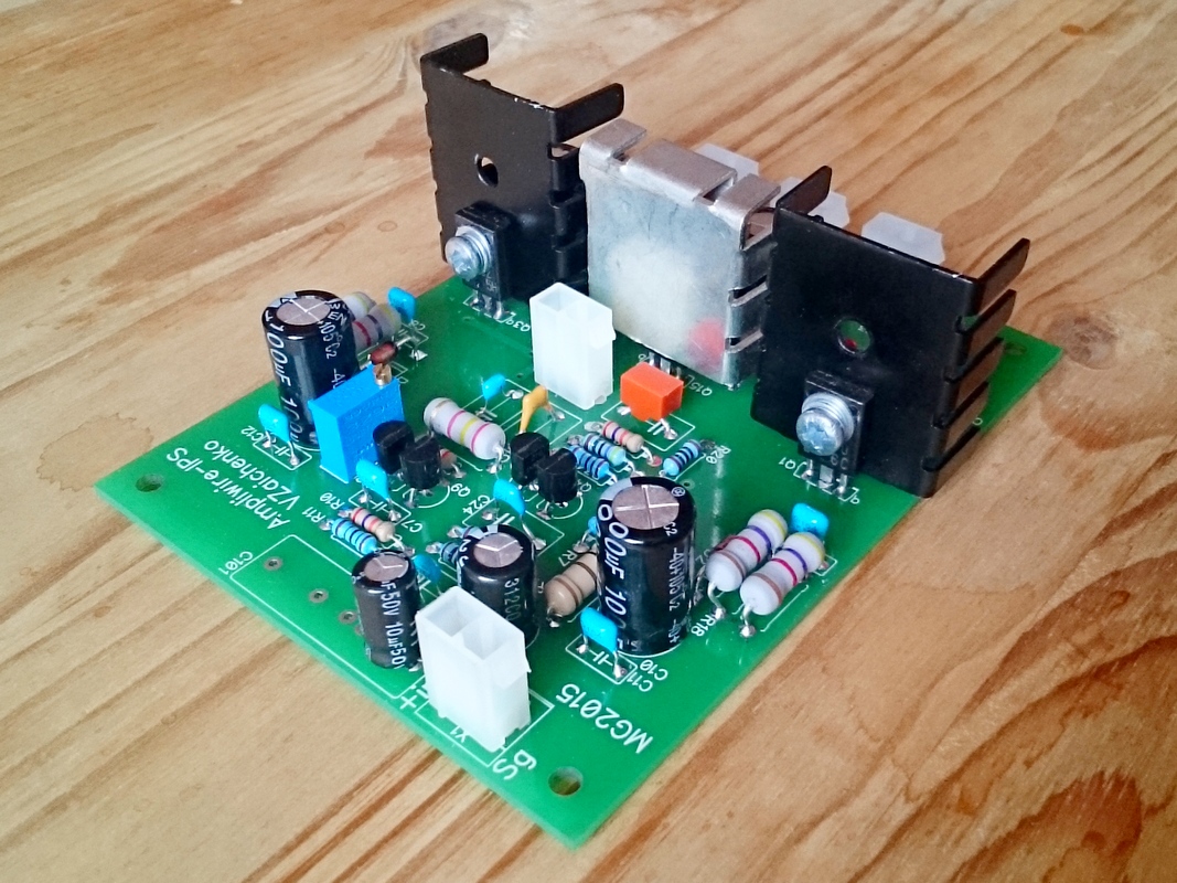

Hi Bangla,
In fact, I think Terry has already tested this IPS with Baby Slew - it works fine.
Let me check later today - I think I've got a couple of standalone IPS boards left in my stock - I will let you know.
Valery
P.S. It looks like the attached one when populated.

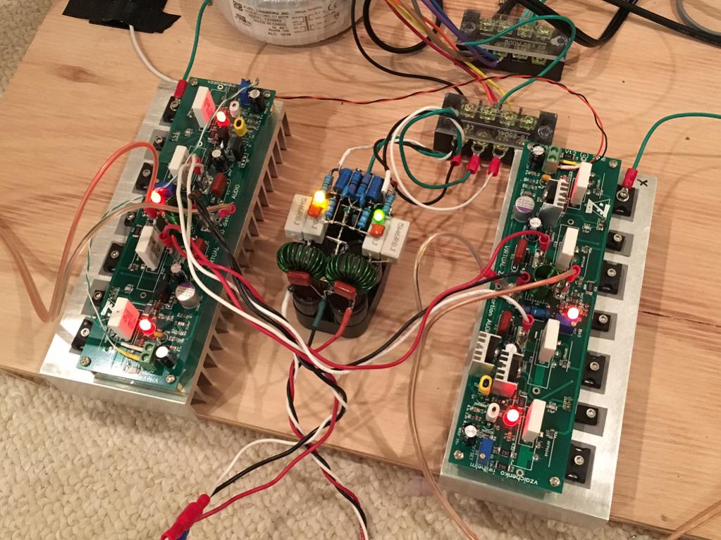

vHEX 1.1 in stereo
I finally finished the second one and now playing in stereo. I had some problems with the second one due to some cold solder joints. My thanks go out to Valery and Jeff for helping me diagnose and debug the amp.
Sounds fantastic - super bass, smooth and clear mids and sparkling highs.
I need to build a second PSU, right now running both off the same one until some more 4700uF 50v caps come in.
I am running 80mA bias and offset is now 0mV and stable. The matched input LTP's really helps.
