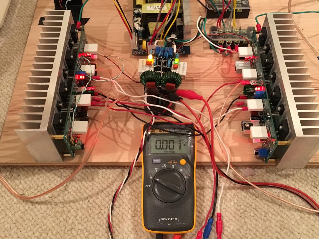

Using the Abletec SMPS, I swapped out the Dx PSU with my custom CRCLC and I now get only 1mV of ripple! That's 20x better than the last one. There is absolutely no sound from the speakers with ear pressed to the tweeter or woofer. Dead silent, no hiss, no hum, no nothing (well maybe barely audible in the lower than room background noise category)... 😎

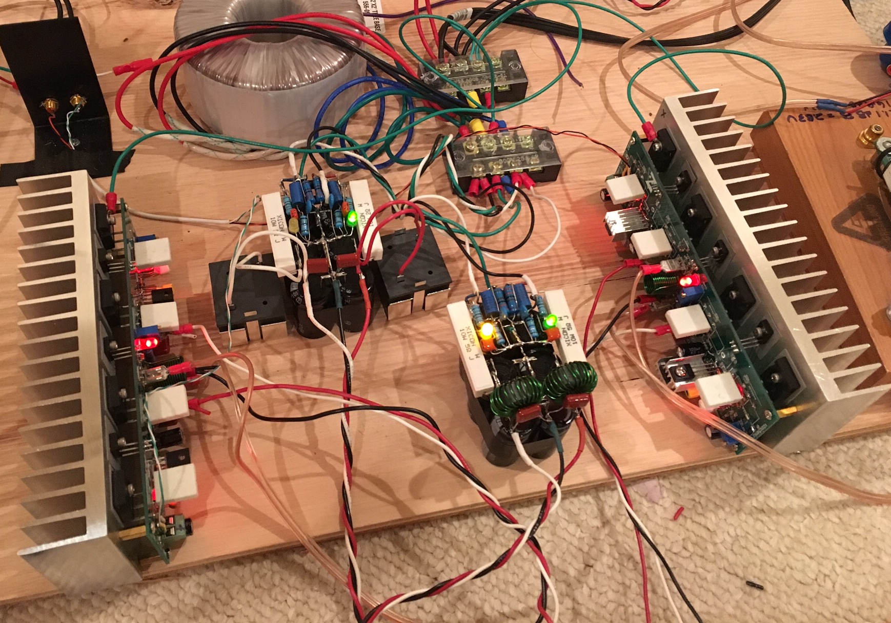

More 4700uF caps finally came in so I made up a second CRCLC PSU. Now running dual PSU's true dual monoblock operation but single 300VA transformer with 45v rails. Bass on each channel now has even more headroom and ease of play.
