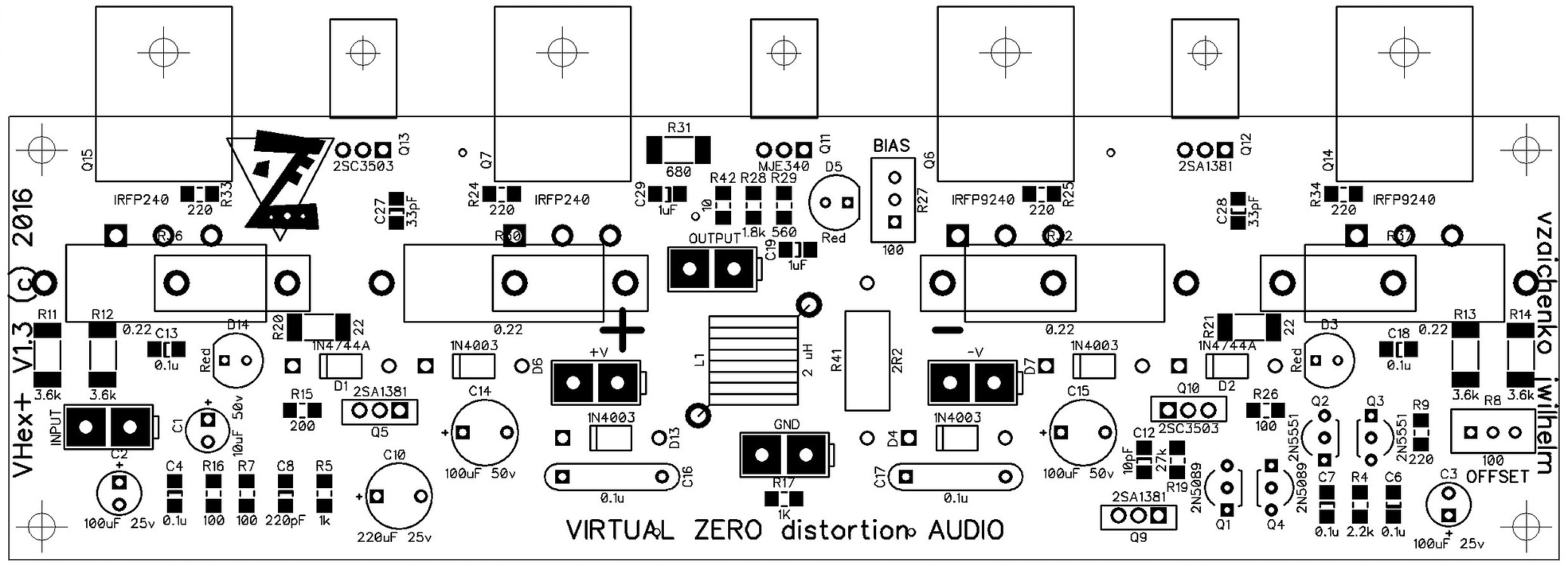

IRFP240/9240 Amplifier (simulated on TINA)
The ones we have available are 7 x 2 inch (177.8 x 50.8 mm).

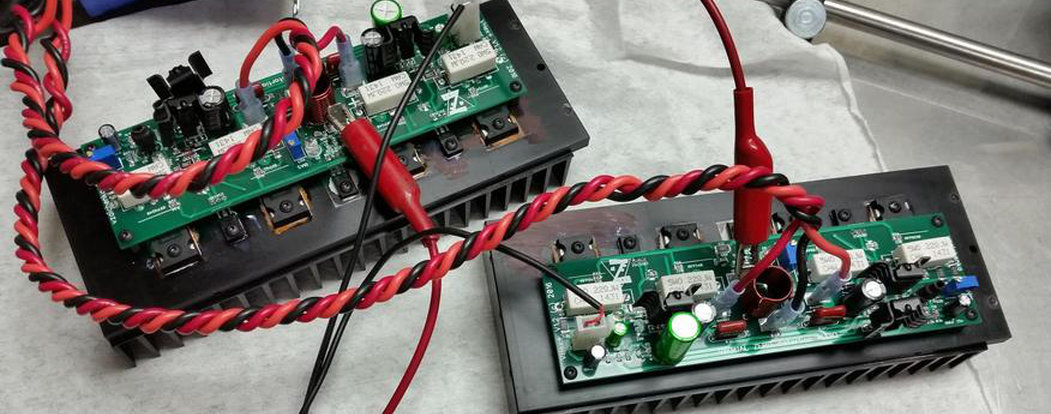

The amp pcb. That's perfect i have some 8x2.5" heatsinks and a transformer in a old amp enclosure.
xrk971, would you mind sharing more specifics of your power supply, maybe a schematic?
Sure, it's here (I actually used 10A1 diodes not 1N4003):
http://www.diyaudio.com/forums/clas...ual-rail-450w-supply-20-a-12.html#post4733565
It's a CRCLC with some snubbers, bleed off resistors and bypass caps. Basic 4700uF 50v caps X 6 and some power resistors and a hand rolled inductor. For the second time I did this I got a nice Coilcraft inductor with a split core so that it doesn't saturate. They are huge though (use flat copper wire). But I find the cheap hand made ones work just as well from ripple standpoint.
Back when I used a single PSU. Changing to dual PSU is one the best things you can do for sound quality. Soundstage is huge. Immediately noticeable improvements.
The supply rails to a power amplifier do not supply current along both rails at the same time as the music comes out of the speaker.
The ground rail passes no current or virtually no current when the amplifier is quiescent, i.e. no output current = no ground rail current.
The supplies, +ve & -ve, send and return the same current when the amplifier output is zero.
When the amp output is an AC signal, the supply rails alternately supply current on +ve half and -ve half of the AC waveform.
The supplies do not send current at the same time !!!!!!!!!!
A common mode inductor with an iron, or ferrite, core REQUIRES the two currents to match, to cancel the core flux. If one half of the inductor wiring sees unbalanced current, then it will saturate at some current.
You have to use an inductor rated for the unbalanced supply rail current.
