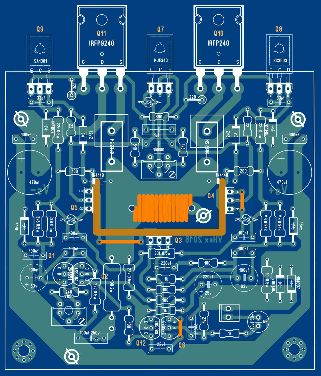

Hi Guys,
Abetir asked me about building his design so I etched a pair of boards and populated them. It wasn't working so I went over the layout and found some errors. It still isn't working so I'm thinking I am still missing something. Can you guys take a look and see if there is still something else I don't see. I'm posting the original layout along with the corrections I have made.
Thanks, Terry

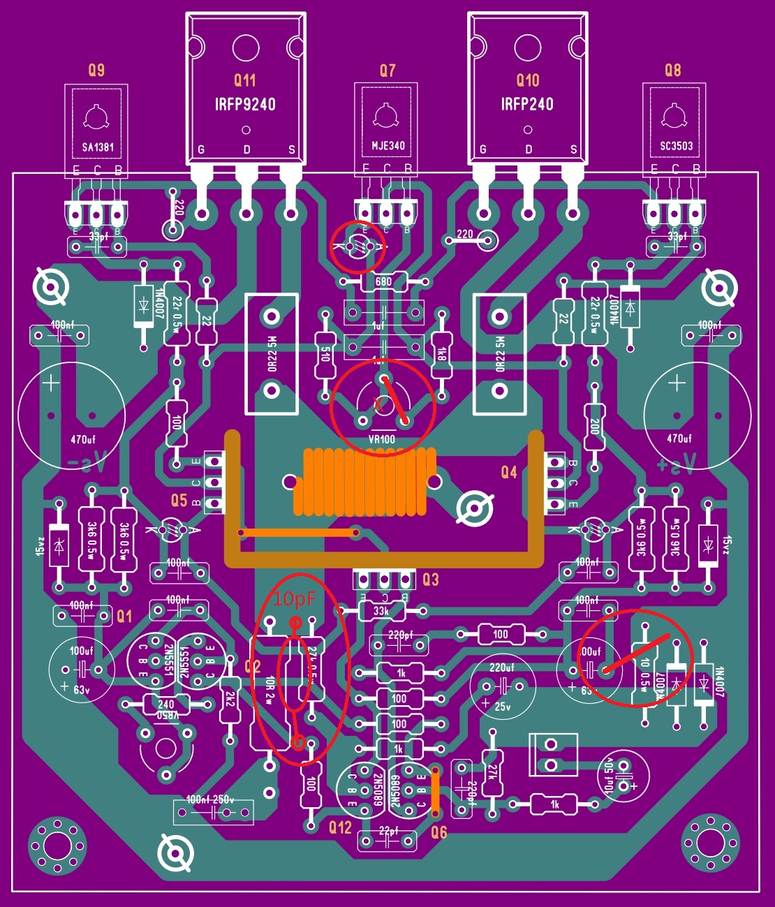

One thing I didn't mention is that I used MPSA18 for Q6/12. However I did use those in my Ampwire IPS and they work flawlessly. All I can think is that I still have something wrong. I'm hopeful one of you with fresh eyes can see what I have wrong.
Thanks again, Terry
EDIT; I noticed that I was missing a couple of connections on the pic above that are not missing on the amp. They are at the base of Q12. I have corrected them on this pic.
Thanks again, Terry

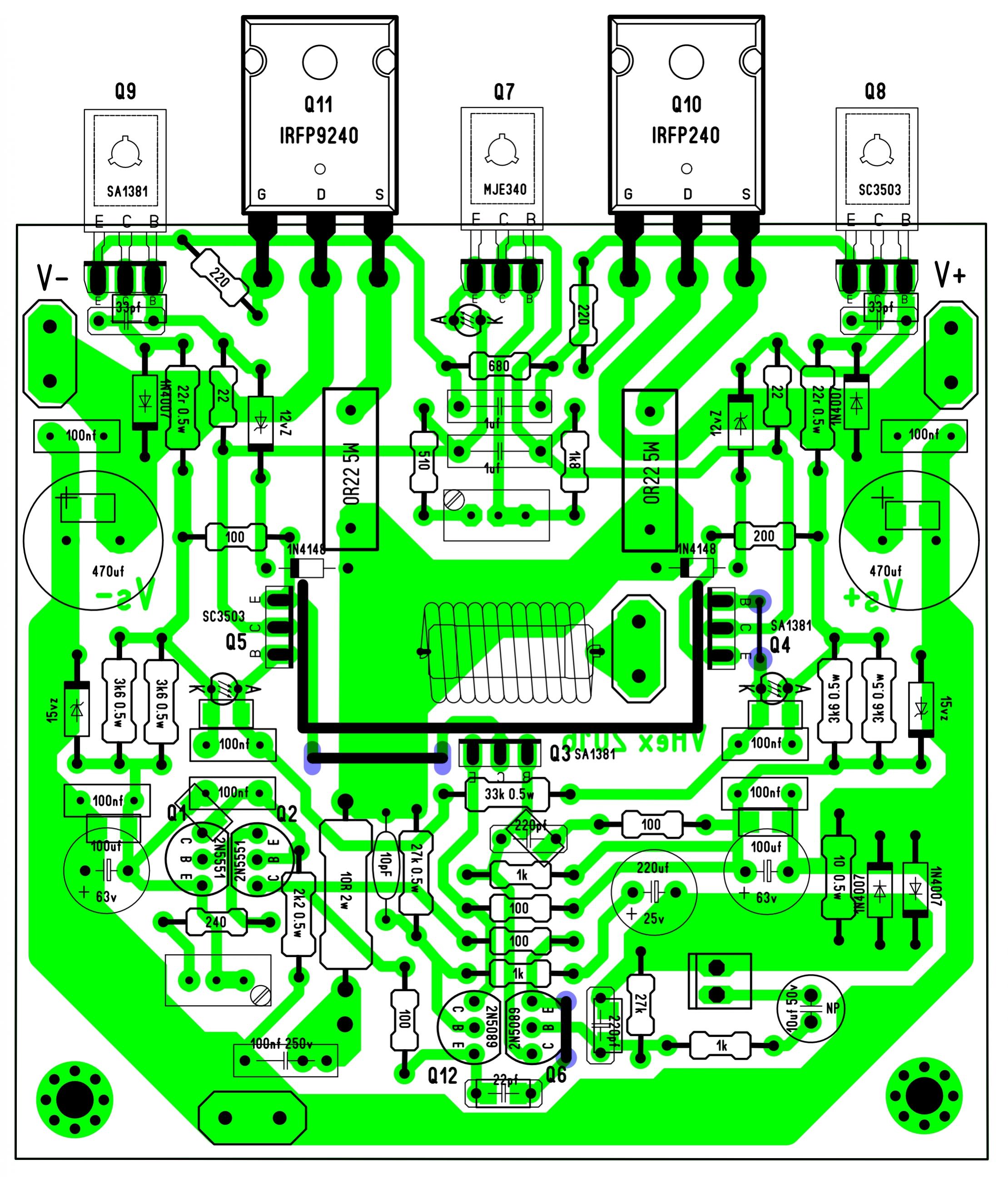

I did not actually check the layout in terms of correc connections - only reviewed the trace width.
Albert, is it possible to check the layour automatically?
I use Diptrace and it's very easy there.
Sprint has a continuity test but it only lights up the connected traces. I have been all morning with a highlighter and the schematic checking for errors but haven't found any more errors. If there aren't any them it is possible I have a solder bridge that I have missed but I didn't want to chase ghosts that aren't there.

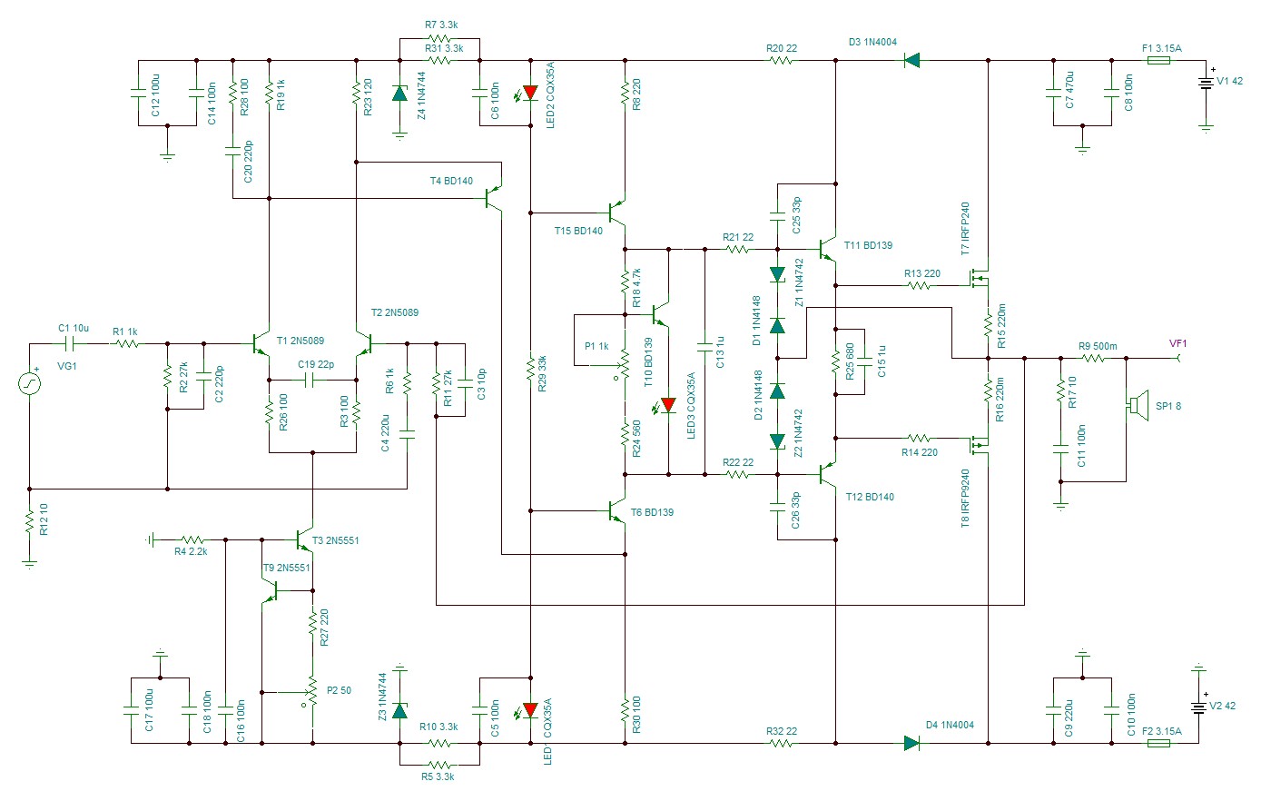

I actually re-simulated the original schematic in TINA, because I could not make the VBE Led to light up, and output idle current is way too low. (supposed to be 75-100ma) even full wiper adjustment is done.
Don't exactly know why.
Valery, attached here is my re work of the schematic some values are adjusted (to avoid the precision types e.g. 3.6k, 240r, 510r. I currently don't have these types).

Also I simulated, the schematic in Mikro-Cap to see the "on condition" of the devices. Say's VBE bias generator is in off state.

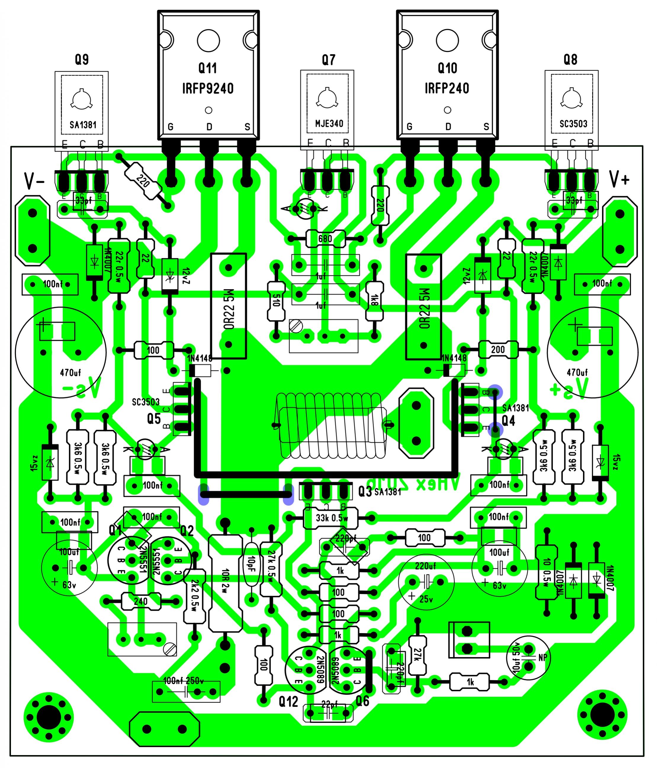

I have one channel working. On your latest drawing you changed the values around the VBE multiplier. I used the values from Valery's schematic. I had to change the trimmer to 200R and even that is a little too small. With it maxed out, I still have 48mV across the pair of 0.22R emitter resistors which is 102mA bias. Probably alright but I like to have a little wiggle room. Maybe the 1k8 or the 510 can me adjusted to make the 100R trimmer work. I did play some sine and square waves through it and they look very good. I'll wait until I have both channels working before I play any music through it.

^that is good news Terry, do not use my bias circuit values above, it cannot be trusted yet, if one resistor there gets shorted it could blow the rail fuses. I'm just playing with some values there. I was too late to realize that I named the schematic with a "final" extension. (my bad).

^i will change the 4.7k R18 to 5.6 or even 6.2k....

Terry, if you'd like to move the range of quiescent current to the lower values, you can increase 510R. 620R will be just about right, I think.
The higher overall resistors' value below the spreader's base - the lower the outputs' quiescent current is.
