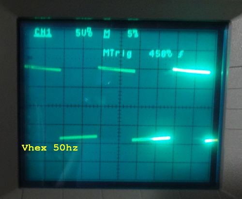

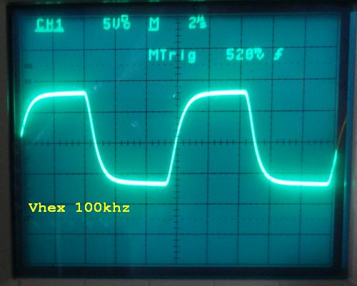

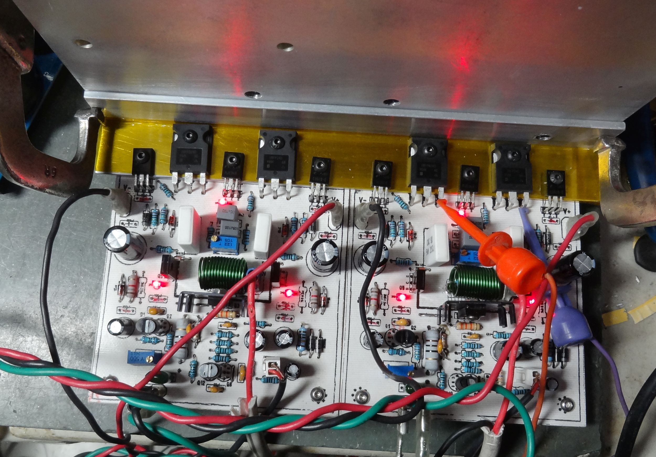

Hi Valery,
Thanks for that. I already installed 500R trimmers and they are about perfect. They end up pretty much centered at about 90mA.

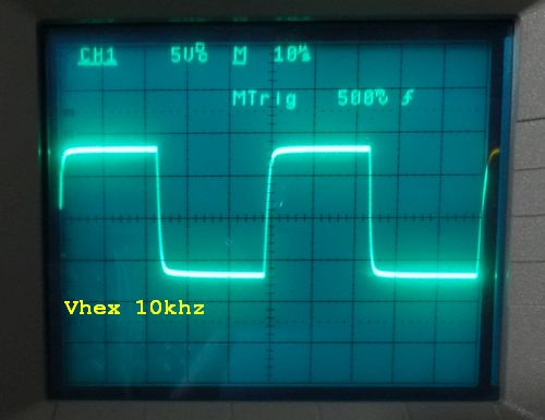

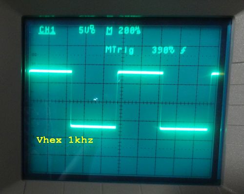

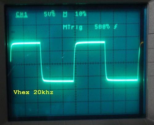

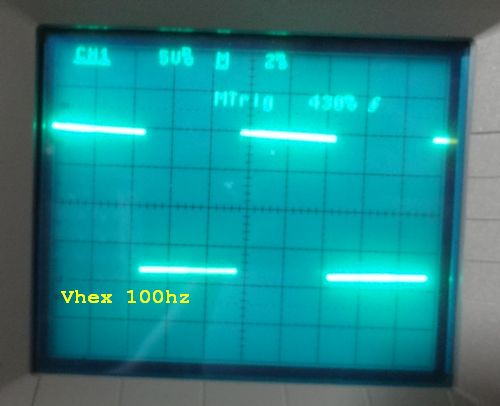

I have it singing and listened to it for about an hour. Very nice as expected. Here's some pics.
EDIT: I forgot to mention that the offset trimmer is maxed out on both channels. It does achieve 2mV but you might want a little more room.

Hi Valery,
Looks nice and clean!
The offset - you can slightly increase 240R (sitting in series with offset trimmer) - this will move the threshold in the right direction.

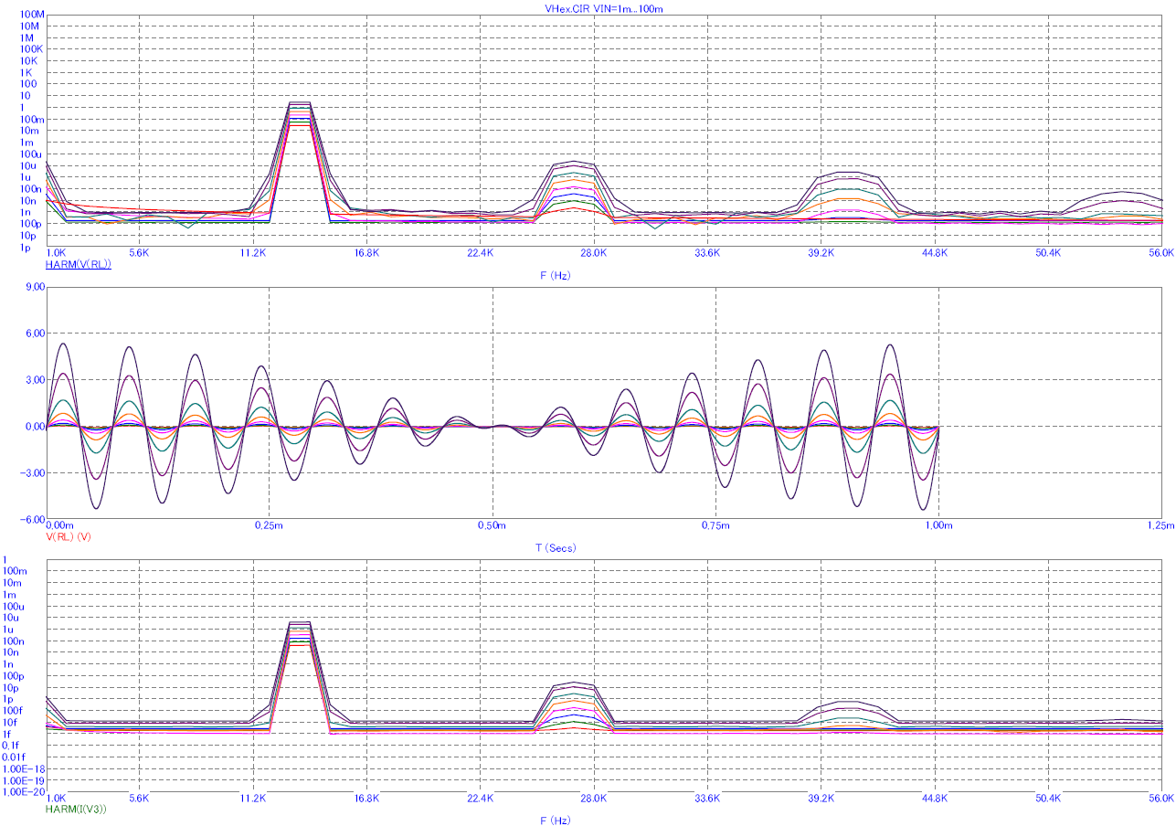

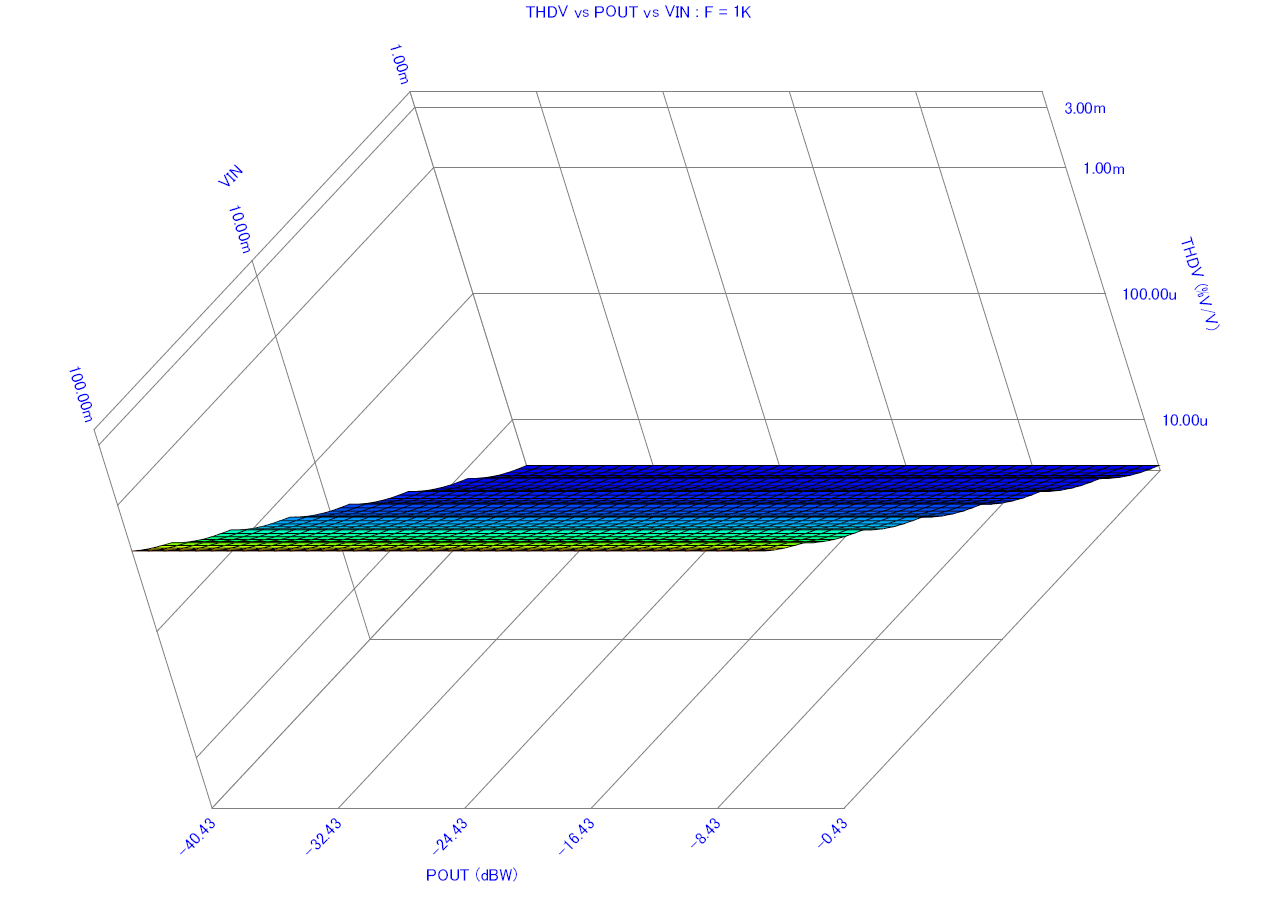

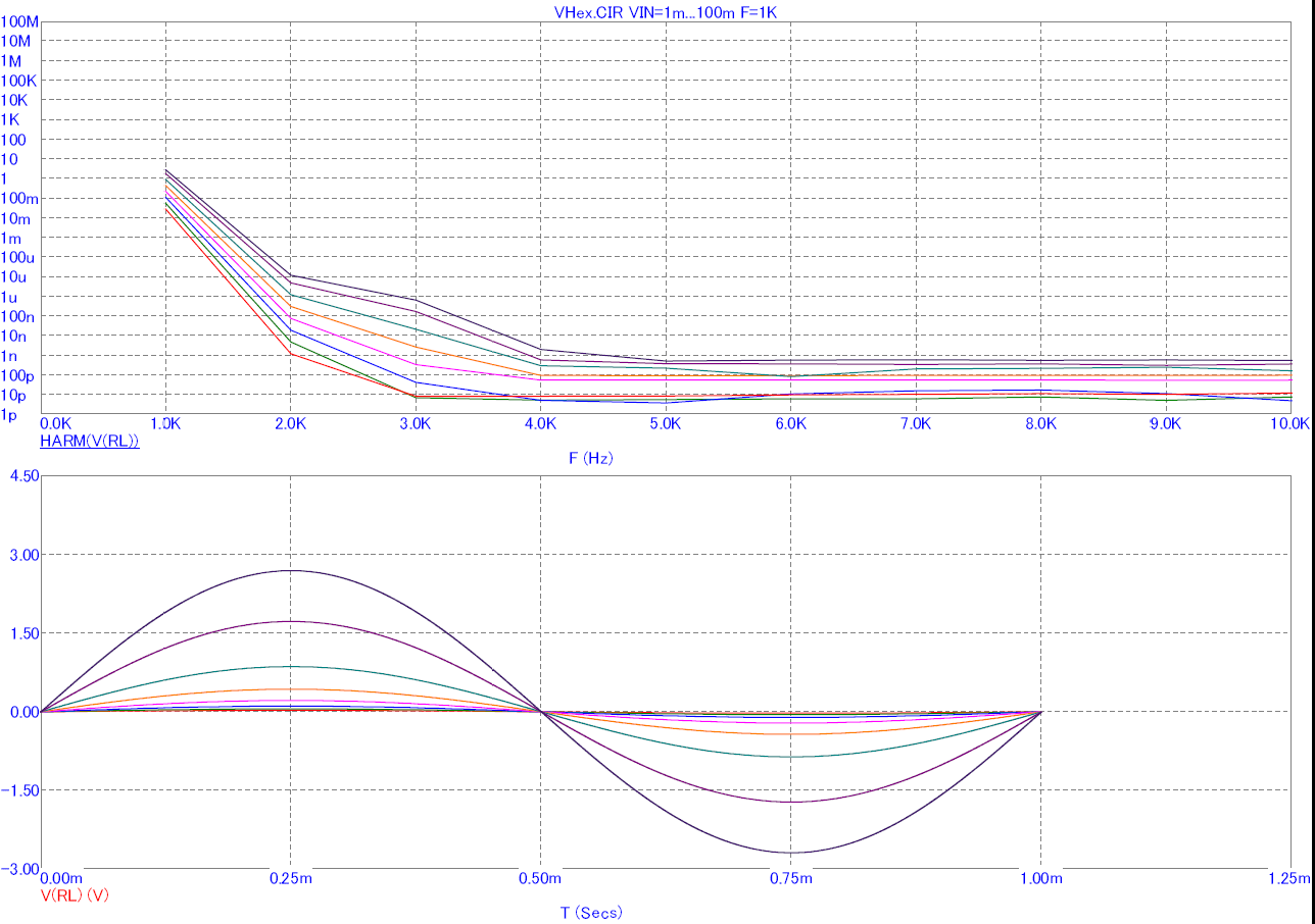

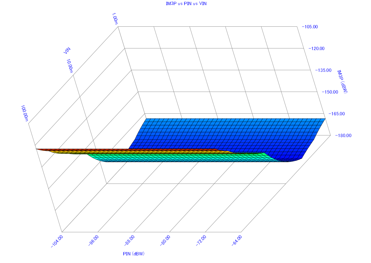

Meanwhile I just learned how to extract these datas in Mikro Cap, using the original schematic (Valery's). 😉
Intermodulation Distortion Analysis and THD in 3D.

A new member in amplifiers family.

I must apologize. I was trying to tidy my spint file today and I realized that I had misread the schematic. The VBE multiplier was correct as Albert had it. That is probably why I couldn't adjust the bias. It's Easter today so I will correct the layout tomorrow and report my findings. BTW, I changed the 240R to 220R and now there is some lee-way for offset adjustment.
