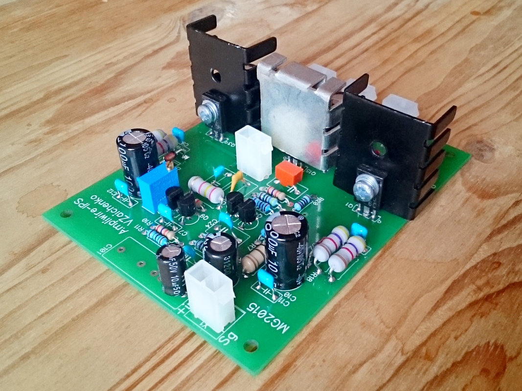

Abetir, that is very interesting. The one you drive one end of two complementary CCSs to drive a 2EF is quite novel, I have not seen this before and I expect it would be very, very fast as effectively the VAS is grounded base. I noticed you have avoided lag compensation; this is innovative design. Yours, or someone elses? It's clever....... and the pcb is beautiful!

Hi Hugh,
It's actually mine 😉
You can see more details, as well as some live measurements in combination with my non-switching OPS here:
My Ampliwire front-end live test
This kind of current-driven VAS came out pretty cool - it's simple, fast, linear and very stable even with no lag (Miller) compensation at all.
Valery

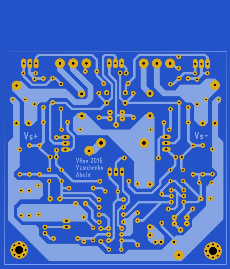

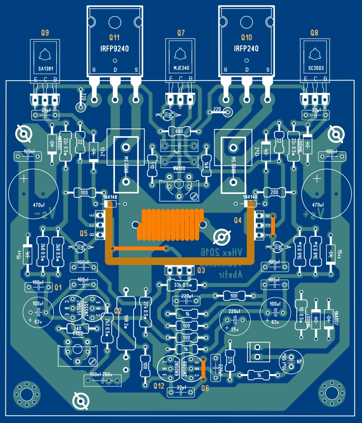

Valery,
I am working on the final retouch of the PCB lay out, will it be OK to include the gate protection diodes?

The best place to add them - bases of the drivers. Zener + diode, looking at each other (cathode to cathode or anode to anode).
ok, but if it stretches the pcb far larger than the violet lay out, It's a no go.
Yes, no real value from them in such a topology, so you can actually drop them - leave it "as-is".
Done! 🙂
PDF for home etching, by default printer paper size is A4.PCB size is 88x91mm (approx 3x4").
I have included options to use the commonly used rectangular white wirewounds for ballast
resistor, vertical mount. Also option to use Bourns multiturn type for the trimmer adjust.
Gate protection diodes are also included.
Cheers! 🙂

The looks....😉
Hi Albert,
Great job! The only final refinement I would do - set the coil leads off the center (diagonal - start top left, end bottom right). This will give some space to make the trace between the 0R22 source resistors wider (as wide as possible - this is a high-currents area).
Valery
Ok, yet the part with the thinner tracks may look frail, one can only solder a heavy fill of lead into the traces, smps style. 🙂
Filling all the traces with a few leads does help in sealing the copper from corrosion. 😉
I will do a rework when it's possible, uploads in my network is painstakingly slow again

.Looks good, come on lets see it with the heatsink 😀
mosfet54 burn in the mosfet 😉 give it a go...🙂🙄
you are very much welcome. 🙂
This would be my last DIY amp build, so my build is a slow one still lots of things to do. Now where is the fastest DIYer in the planet? ....still4? 😉 😀
