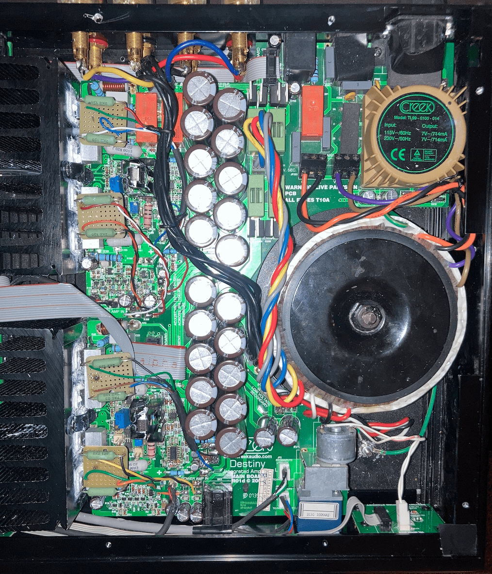

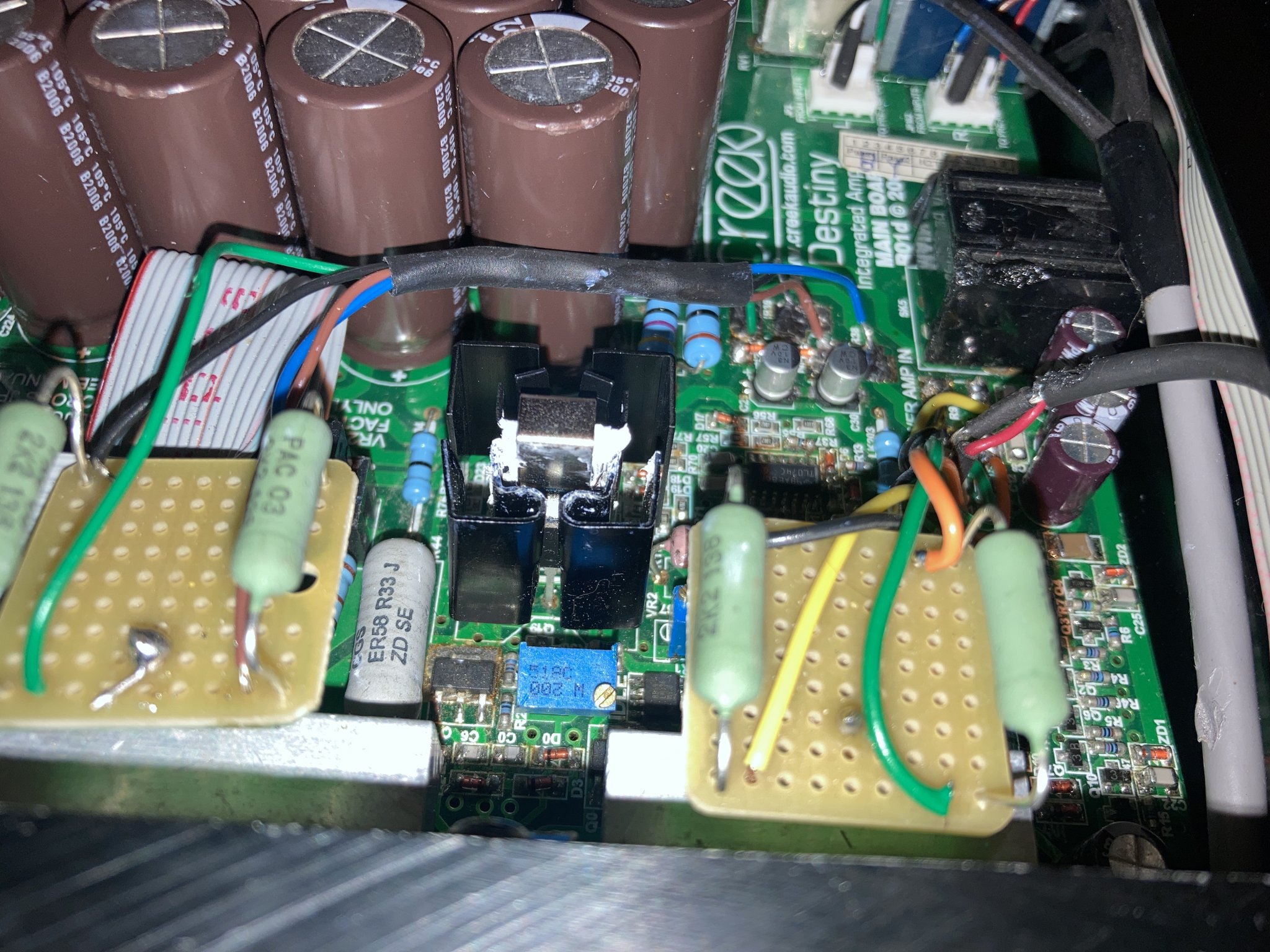

It has the regulators connected to the main power rails thereby dropping much voltage converted to useless heat. If I recall correctly the device drops 50V to 15 V and such times 4 while actually having a separate +/- 15V PSU for the phono stage*............................... A trainwreck of a design but it can partly be solved by placing an external +/- 15V 100 mA miniature PSU for the DC servo and current sense opamps which is a simple and adequate solution. The other possibility was to connect the DC servo and current sensing opamps to the phono PSU as it has LM317/LM337 that won't blink an eye with extra 20 to 40 mA load. There the voltage drop is 25 to 15V times 4. Environment less hot = IRF9610 less hot.
A self made aluminium bracket connecting the IRF to the main heatsink with an M3 bolt is also possible. The IRF needs surface for getting rid of the heat and should of course itself be bolted to the bracket/heatsink for optimal heat transfer.

Yes, I think I uploaded photos of the mounted THT resistors in another post however - Done 🙂 The resistors are quite hot and mounted next to the output device heatsinks. The first thing I noticed was dc offset in both channels is more stable after heating up - I was measuring random 5mV spikes in the right channel. I reopened this thread because I was able to measure voltage across R26 and have been curious about how well the IRF9610 heatsinks are working given a known power usage.Already got the feeling the heat issue was discussed partly elsewhere. The device has more than 1 design imperfection as heat is generated very nearby too.

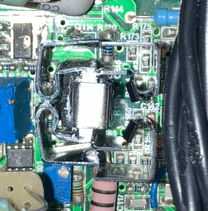

I've also added better heatsinks to the IRF9610s. I removed the top and bottom of an 8oz aluminum can, folded 4 times and then used pliers to make fin shapes. This adds about 7-8 grams of aluminum to the installed heatsink. I think it is a solid contraption with the heatsink clips.

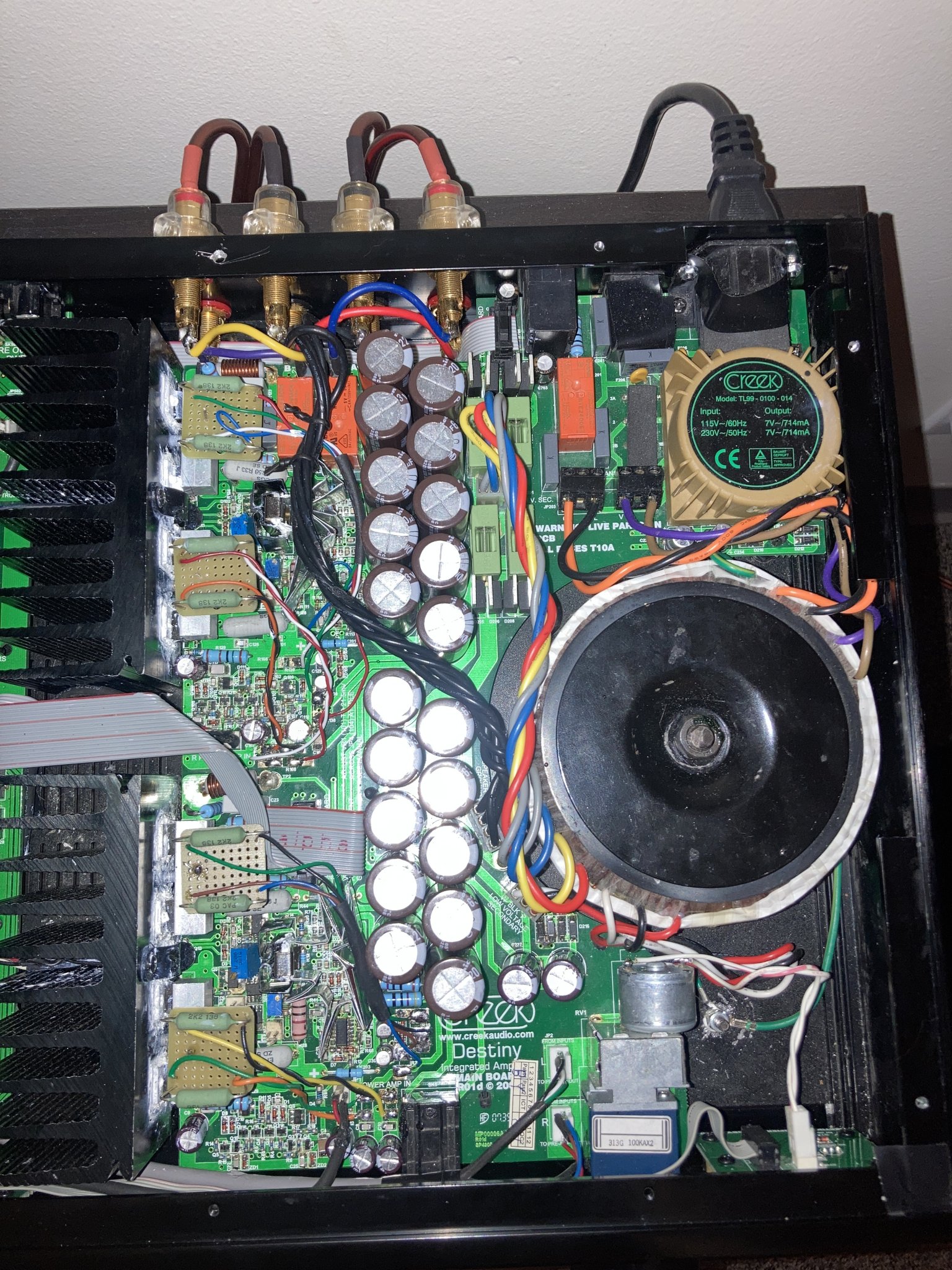

Here is the final solution to the heat management issues. I added a duplicate heatsink to the IRF9610s, and mounted those with a proper 7mm heatsink clip:

Hopefully this preventative maintenance will add longevity to the amp. I also found a speaker ground connection issues at the MOLEX PCB connectors, probably caused by myself from reconnection wear and tear. After the amp warmed up there was a noticeable channel imbalance sometimes. This was verified by measuring the AC voltage (80mV L vs 60mV R - that is 2.5dB) at the speakers from a 120 Hz sine wave source. After soldering the speaker ground wires to the PCB the channel unbalance is less than 1mV. I've uploaded a photo the final modifications. Thanks again for the help and feedback.

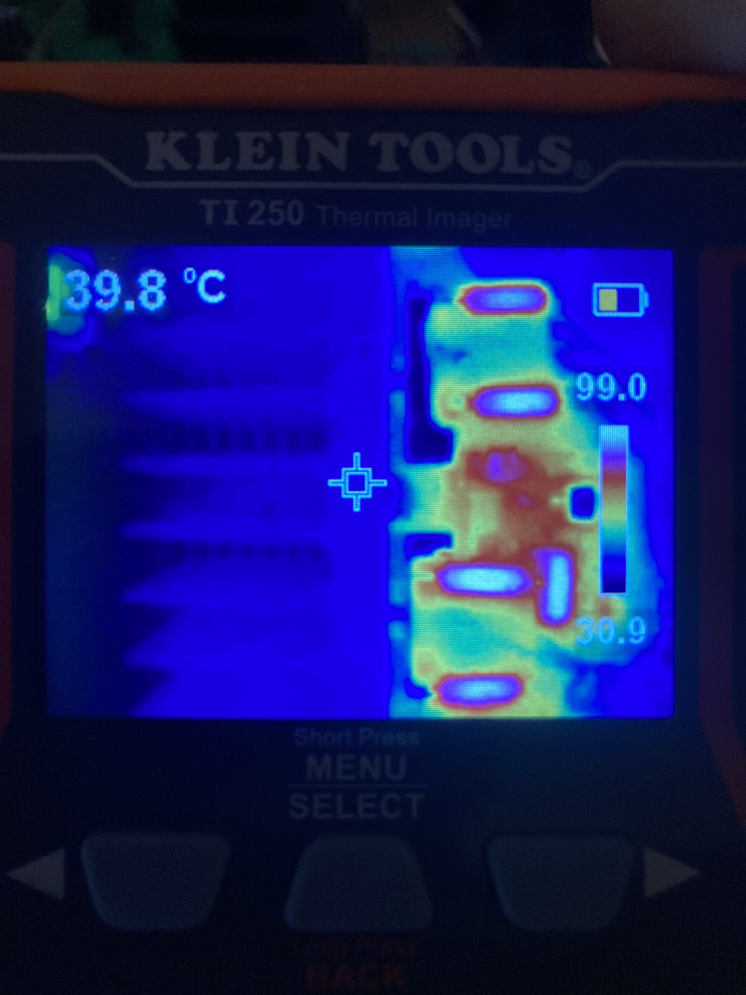

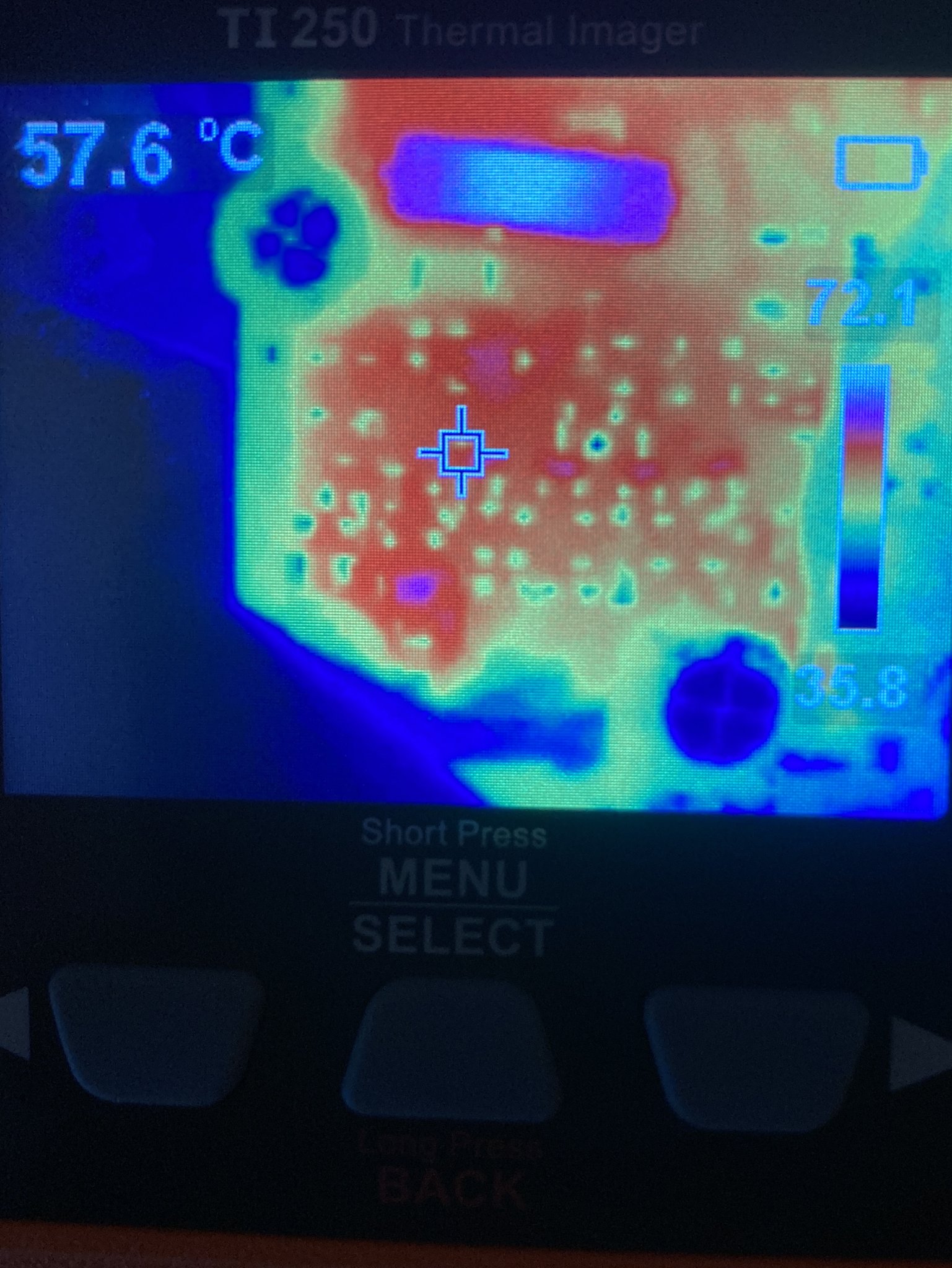

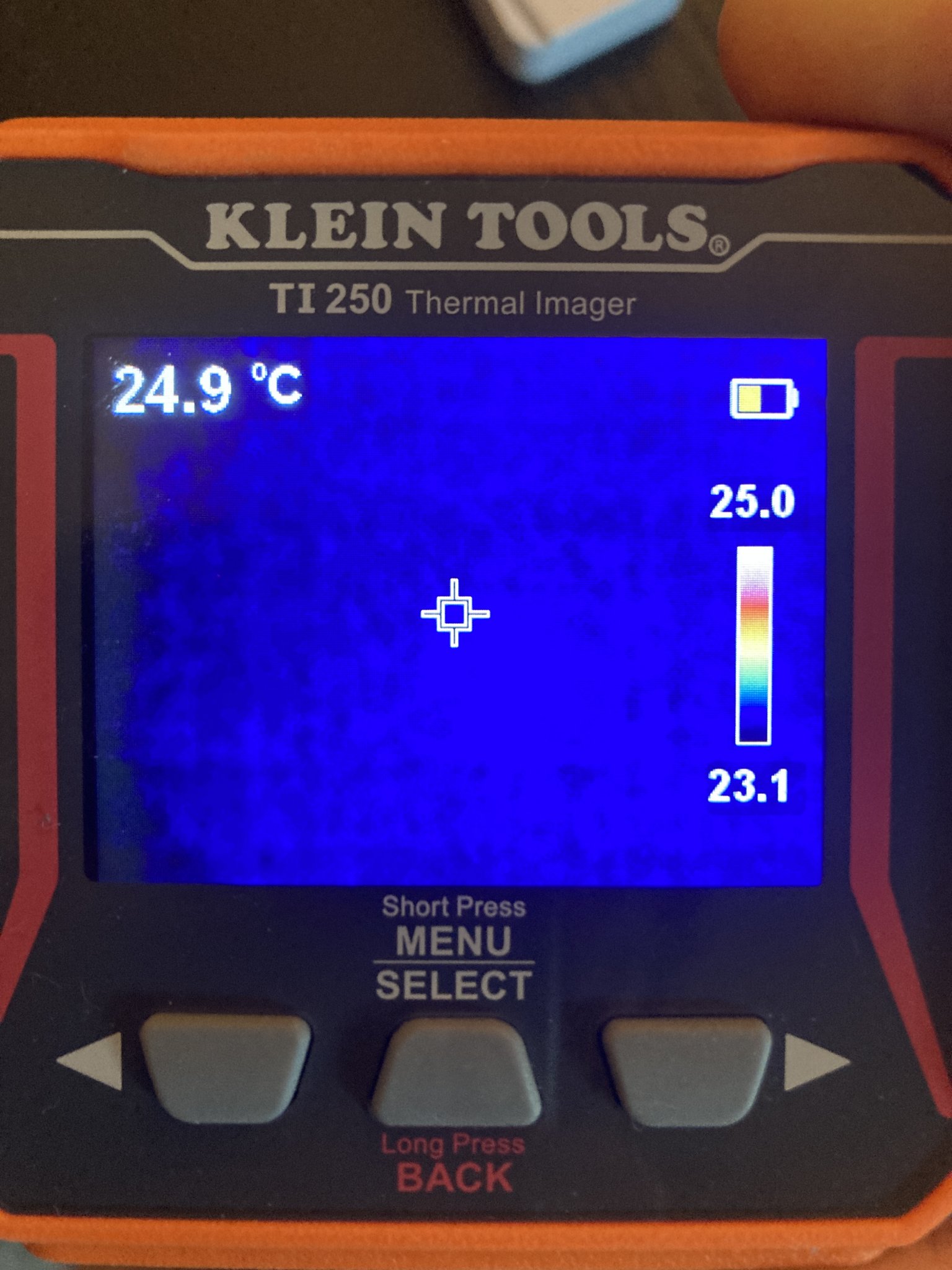

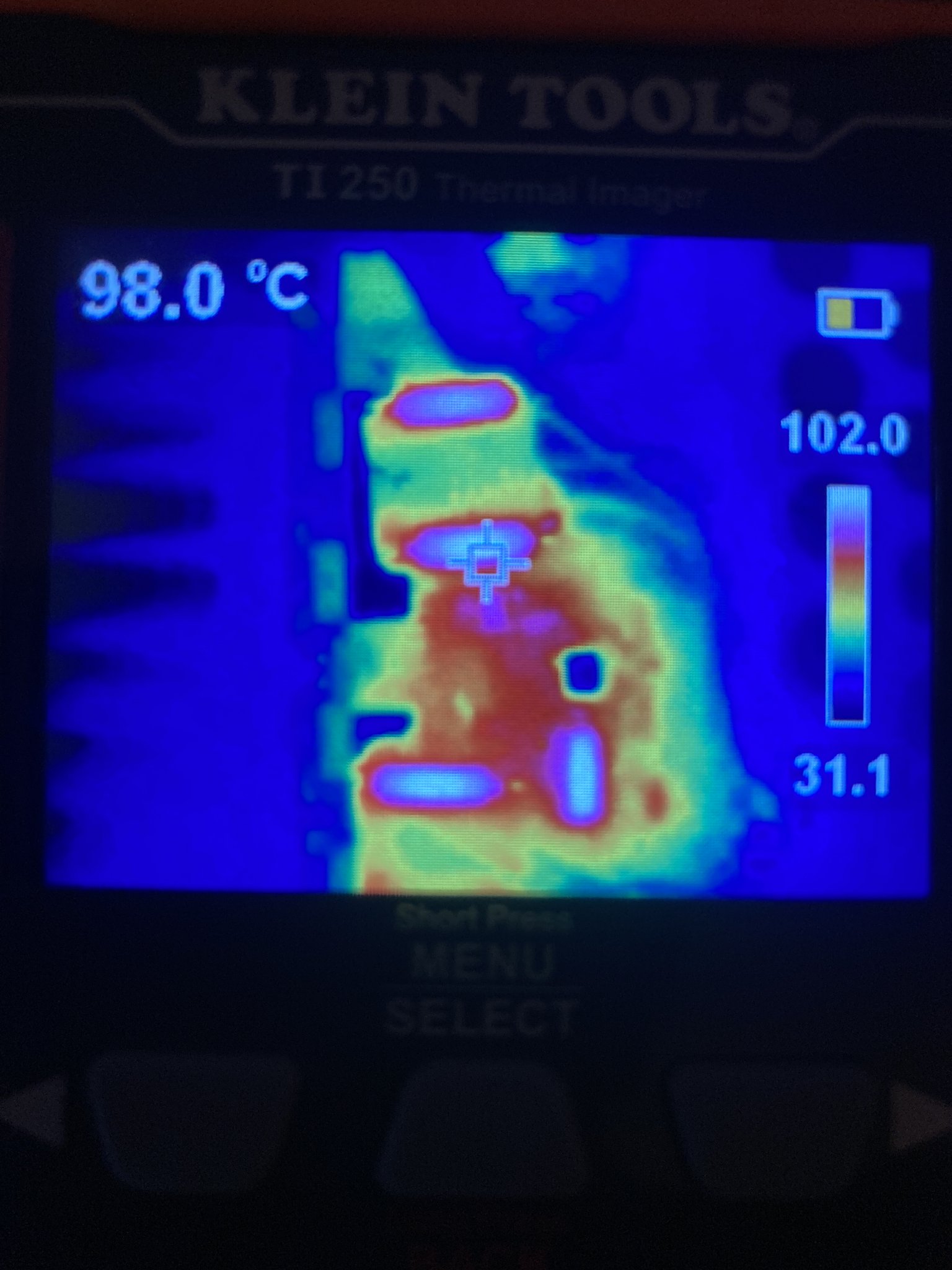

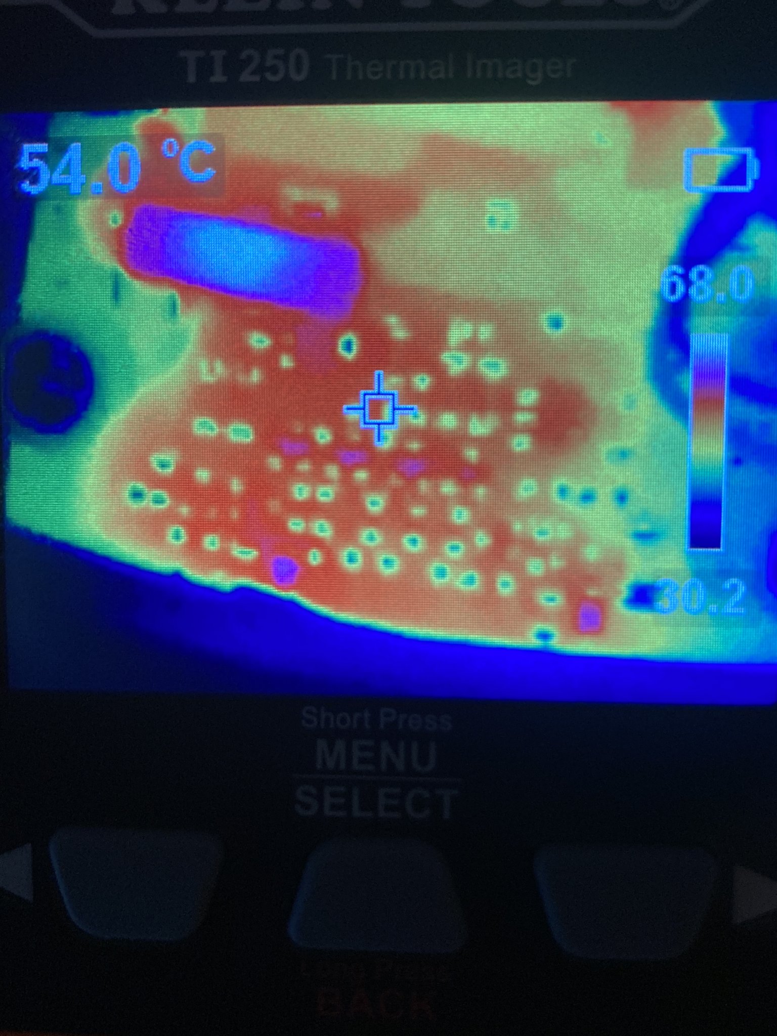

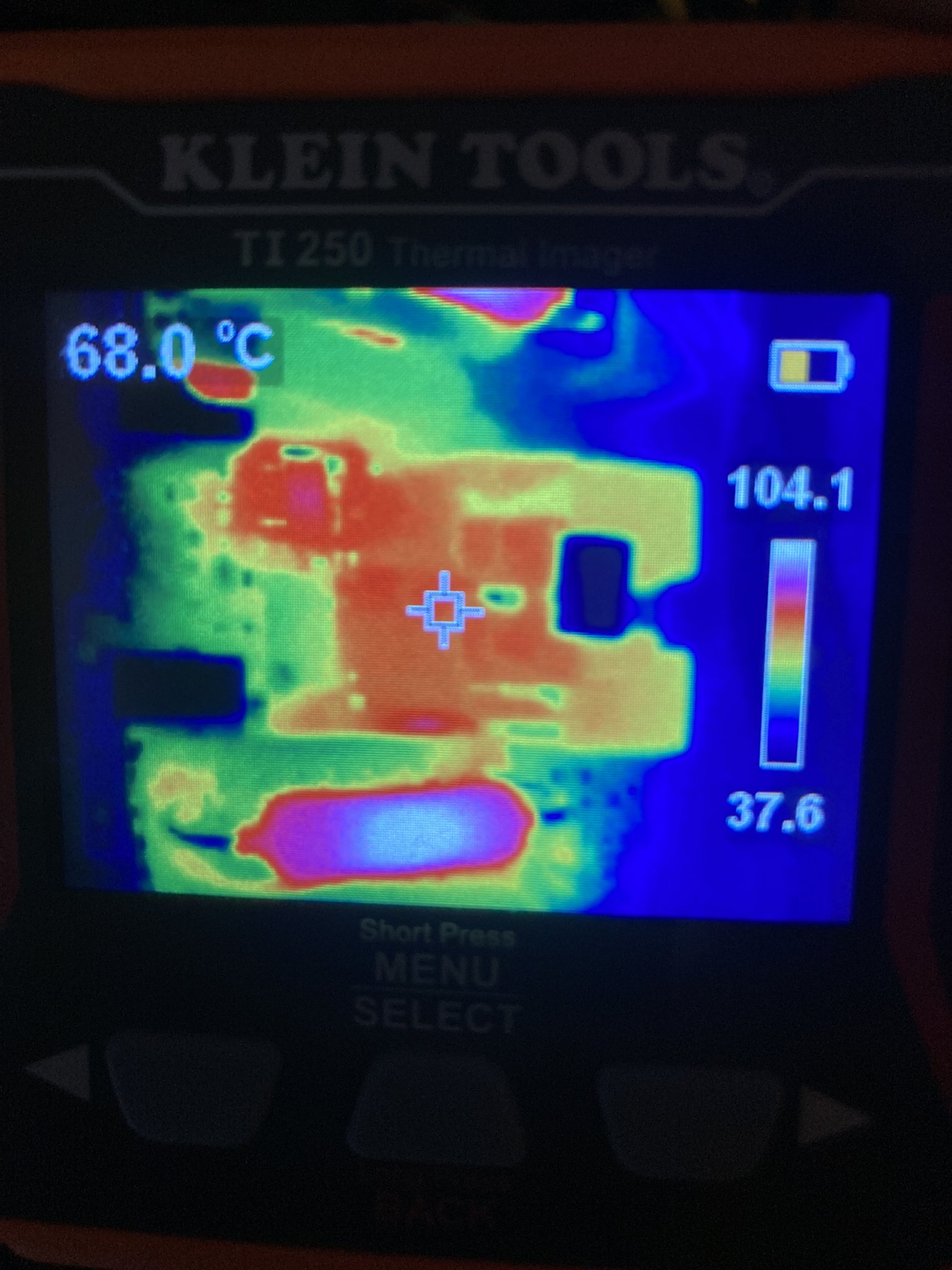

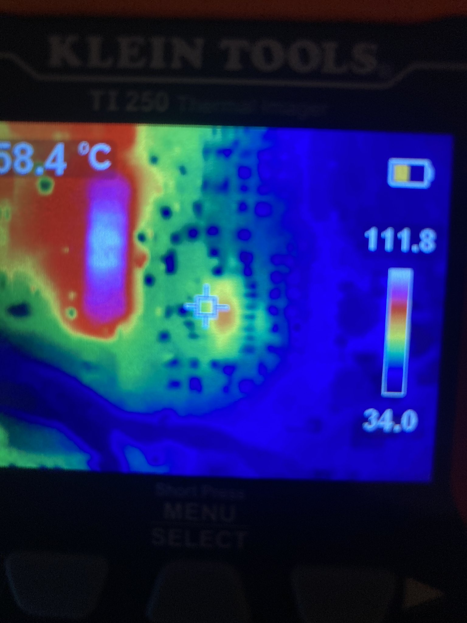

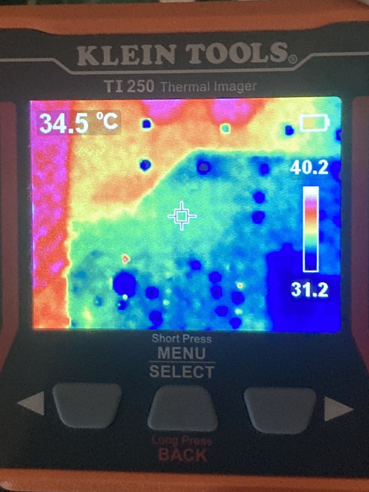

It turns out my local tool library has a thermal imager… 🙂 FWIW, the proof is in the pudding…
Unfortunately, I do not have readings before replacing and moving the power resistors to a few mm under the lid, and adding another heatsink to the IRF9610s.
Measurements were taken after warming the amp up for 2 hours with the lid on.
Room temperature - 25C
Input board PCB temperature - 35C
L and R Main heatsink (for IRL2910s) temperature - 40C
L and R Power Amplifier Section taken at the input stage - 55C. I took multiple readings outside of hot spots and can conclude the ambient temperature of the PAS is closer 50C. Readings drop to 40C near the volume control far away from heat sources.
DC Servo IC U1/101 (TL074CDR) - 60C
L and R heatsinks for IRF9610 temperature - 70C
Power supply resistors (R38/39/8/9) mounted a few mm under the lid - 100C
It appears there is not much wiggle room especially at much warmer room temperatures around 30-40C.

Fans are a "solution" that brings problems (not even for free) and they're simply a plain nuisance in audio so they are not a solution but a bandaid.
As explained earlier in post #44: please think of solving the issues at the root. Take away the cause and you'll need no bandaid.
The main issue is 4 resistors that drop 50V to 15V at a certain current. Even after replacement and slight improvement they become 100 degrees Celsius effectively heating up the device internally like a built in oven. This means the solution is not adequate. Assuming a current of only 20 mA you have (50 - 15) x 0.02 and this times 4. So there is at least 3W of power converted to heat! It would not surprise me if it is double that value. This is a plain design error. Taking away the voltage dropping times 4 will solve that issue once and for all.
After lower ambient temperature in the device is realized remeasuring the IRFs will tell if further work is needed. Like it is now you have class A temperatures in a class AB amplifier and that at the wrong spots. All the fiddling around eventually will lead to the demise of this device, either because of too much reworking or because of too much heat for a too long time.

If you look carefully you'll notice a 2 x 7V toroid in the device. Now imagine a 15 Euro costing 5VA 2 x 15V Talema 70023K mini toroid upside down on top of that 2 x 7V toroid preferably with a small PCB to make wiring easier and safer. Check clearance between the new toroid and the casings cover and use plastic sheet in any case!! You'll need 30 mm at least between the 2 x 7V toroid and cover.
Measuring the current of the 2 channels combined beforehand is advisable though. Recalculate the power resistors to there Zener diodes and/or combine with new rectifiers, filter caps and regulators 7815/7915.
