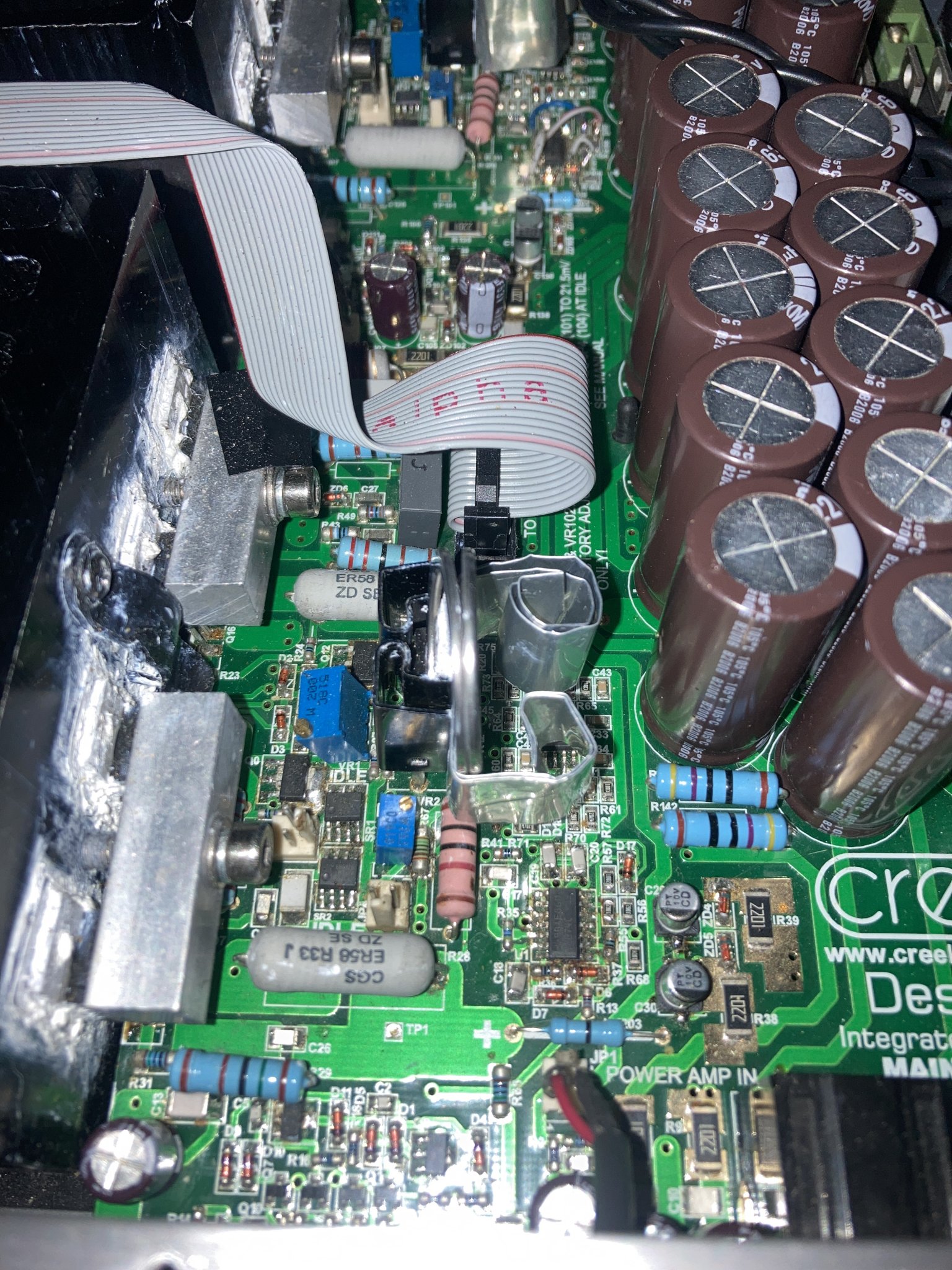

Ok good to know! Thanks thats crazy the IRF740 fell out of the board. I think I've improved the heatsinking with the added diy heatsink out of aluminum. Thanks. Good to know these MOSFETs are rugged.If it blows up, it's too hot.

Thanks for everyones help and input. The amp had been working for a year with the manufactured heatsinks before I checked the temperatures. This is a good indicator, and now with the added diy heatsinks made out of aluminum (which are also getting hot) I feel more confident the IRF9610s are not running too hot.

PS FWIW the Creek Audio 5350SE has a very similar amp section and those IRF9610 heatsinks seem to have more surface area... Sorry I couldn't find a higher resolution photo.

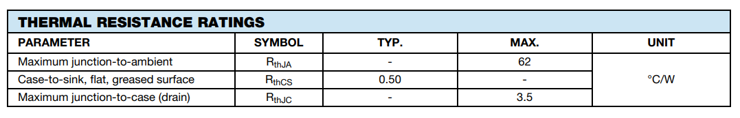

Looking at the data sheet, you see the attached. The thermal resistance between junction and case is 3.5C/W. So for every watt the FET dissipates, the junction is 3.5C hotter than the case. Then there's a small thermal resistance between the case and the heatsink, here estimated at 0.5C/W. Total 4C/W.
Let us estimate the current through the FET at 50mA, I don't know how close that is but just for the discussion. With 56V across it, that's a dissipation of 0.05 x 56 = 2.8W. That means that the junction will be 2.8 x 4 = 11.2C hotter than the heatsink. With a heatsink of 70C, that makes the junction about 81.2C which is totally safe for the FET.
Measuring the voltage across R26 will allow accurate calculation of the FET current.

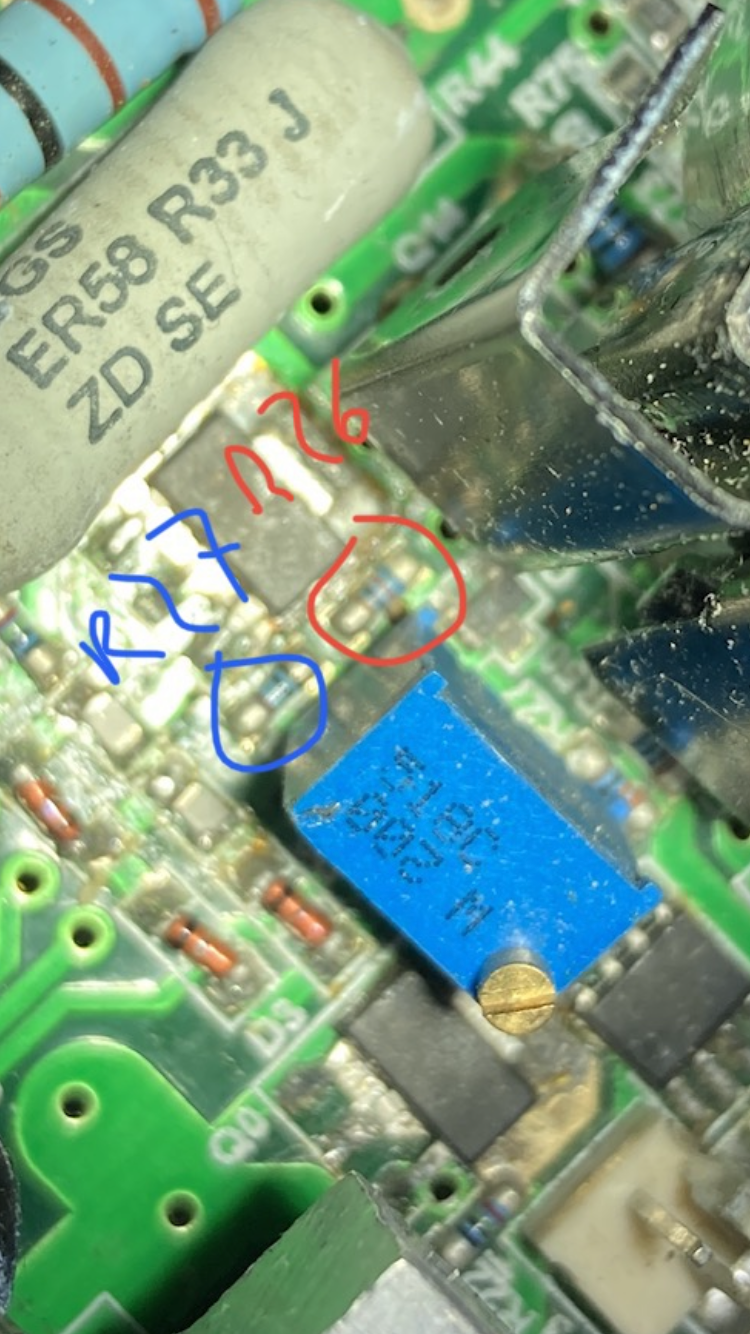

Thanks for the explanation and showing the math. It’s reassuring that the MOSFET junction temperature is in the safe zone. I’ve attached a zoomed in photo of R26. This is what I up against. I can’t risk shorting R26 with R27. I managed to briefly measure .02V across R26. R26 is 62 Ohms. .02V/62 Ohms That yields 0.3 milliamps?! Does not sound right. Again I wasn’t able to firmly connect the probes to ends of R26 which is 3 mm in length for scale. It’s dicy.Looking at the data sheet, you see the attached. The thermal resistance between junction and case is 3.5C/W. So for every watt the FET dissipates, the junction is 3.5C hotter than the case. Then there's a small thermal resistance between the case and the heatsink, here estimated at 0.5C/W. Total 4C/W.

Then it's OK.I can touch the heatsinks for about 5 seconds before recoil. No screams 🙂
Still, a better solution is to find a way to attach the MOSFet to the big heatsink nearby. Of course, it's a lot more work: electrically insulate the device, and add a gate stopper resistor to be soldered directly to the pin.

As the thermal resistance of the original heatsink is known, there is another way to do the calculation for the original heatsink, without measuring any currents:
Heatsink temperature: 80 degrees Celsius (opening post)
Ambient temperature: 20 degrees Celsius (guess)
Thermal resistance heatsink-ambient: 20 K/W (opening post)
Thermal resistance junction-heatsink: 6.4 K/W + 0.5 K/W = 6.9 K/W (datasheet https://nl.mouser.com/datasheet/2/427/91080-1768447.pdf , inconsistent with Jan's post #29)
Maximum allowable junction temperature: 150 degrees C (datasheet)
Temperature drop heatsink-ambient: 80 degrees Celsius - 20 degrees Celsius = 60 K
Temperature drop junction-ambient: proportional to the thermal resistance, so (20 K/W + 6.9 K/W)/(20 K/W) times 60 K = 80.7 K
(You can also explicitly calculate the power dissipation of about 60 K/(20 K/W) = 3 W and take it from there.)
The junction then stays below 150 degrees Celsius up to 69.3 degrees Celsius ambient temperature. At 20 degrees Celsius ambient temperature, it will be around 100.7 degrees Celsius.

I was able to measure the voltage across R26 (62 Ohms)! By looking closer at the schematic I found an easier spot to place one of the probes (the base of q13). Anyway, it’s 1 Volt across R26 and R126, so that’s 1/62 Amps. Given Vds=48 volts and voltage across R26, can you show me how to calculate the power for IRF9610?
1/62 * 48 = 0.77W
With total thermal resistance juncion to heatsink 4-5 K/W, the junction appears to be only 5 degree hotter.
Are you sure R26 is 62ohm?
1/62 * 48 = 0.77W
Thanks. Yes, I measured 62 Ohms on R26 and R126. I also calculated the same wattage which seems too low considering the amount of heat. The schematic shows a transistor (Q19) in between R26 and the source of Q14(IRF9610). How do you know the source current ‘Is’ is equal to the current going through R26? It seems there’s something missing in the equation given the amount of heat. The heat sinks for Q14 are around 70c after reaching thermal equilibrium on idle, which takes a good hour. The ambient temperature is probably no more than 40c. I base that figure on readings and the heat sink temperature for the output devices, also round 40c.
