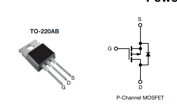

IRF9610 Heatsink Measures 70-80 Celsius: Is this too hot?

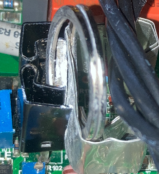

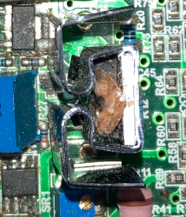

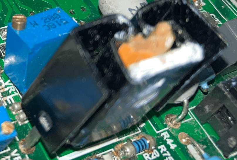

After more poking around I found another few hot spots. The temperature of Q12/112 a SMD MOSFET is 80C! , and very close to Q14/Q114, and a few other THT resistors at board leavel measuring 100C +. I think it’s safe to conclude again that the main amp section is over crowded with components with inadequate thermal management. Seems like a whack-a-mole scenario and I need to learn more about its design and circuits in general before using an alternative psu for the dc servo and current sensor. Can anyone refer me to a solid intro book to electrical circuits that might provide insight into the techniques used in the design of this amp? For now I’m going to use a pair of quiet $15 fans. I really love the sound of the Destiny. Thanks again for the insight and advice @jean-paul. Yes stick with the thick and be happy.

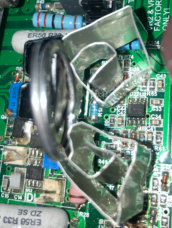

Update: Properly installed new (taller) heatsinks for Q14/Q114. Thermal camera measures hottest spot on heatsinks at 67C 🙂
Added a surface mount heatsink to Q12/Q112. Thermal camera measures heatsinks at 71C 🙂. I tried to move Q12/112 above board using a TO-252 breakout board w/ heatsink but ran out of space after constructing a device that was electrically insulated and could mount to the main heatsinks. Overall, these changes have improved thermal management and should add more life to the PCB and close by components (also replaced) that were swamped in the excess heat.

60C (140F) is the standard maximum temperature in regulations - hotter than that a guard screen should be fitted, and even below that a warning sticker is a good idea - "caution hot surface". 60C can be touched for a few seconds without a burn, giving time to retract your hand. A guard screen can help ensure adequate space around the heatsink for ventilation too (like the wall stand-offs on the back of fridges).
Thanks for your response. This area is not user accessible and photos show what’s under the lid. I am not sure if adding a guard screen would help in an already cramped area. The the temperature of the lid itself maxed out around 45C.
