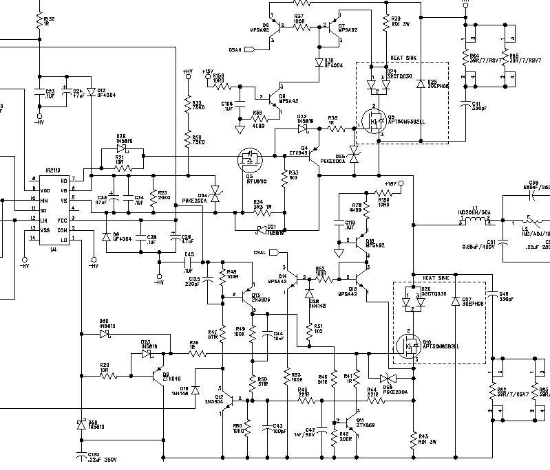

The new Crest CD3000 Class-D amp output stage
Current steering schottkys used in series with output mosfets to prevent the mosfet body diode issues during high dv/dt && di/dt..
Current sensing is done on both upper and lower rails of mosfet half bridge.....
High Side features a p-channel mosfet to prevent the failure of IR2110 in case of negative transients and also in case of mosfet failure...

What are the output devices .... kant make it out in this resolution ..... APT50 ..... something?

Baldin said:Wow ... thats a big MosFet .... and fast too 😎 😎 😎 😎 😎

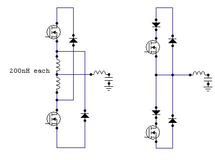

Meanwhile, Does any body know how to take care of Mosfet Body Diode issues apart from using Series Schottkys....
I have seen on older crest schematics, they use centre tapped inductors [200nH]in series with mosfets, in order to ADD a little offset and thus enable the additional fast recovery diode to deal with free-wheeling current...
Which one is better way.....Series Schottkys or series Inductors
imho,Which one is better way.....Series Schottkys or series Inductors
if body diode is very fast, no problem;
if body diode is causing some current peaks, coil (magnetic snubber) helps...
if body diode is big + very slow, it never should be active, so ser.+par. diodes needed
btw the APT50M65B2LL is fast, 19ns turn on, but diode is 680ns turn off !!!!!
so no way for fast switching, if diode becomes active...
