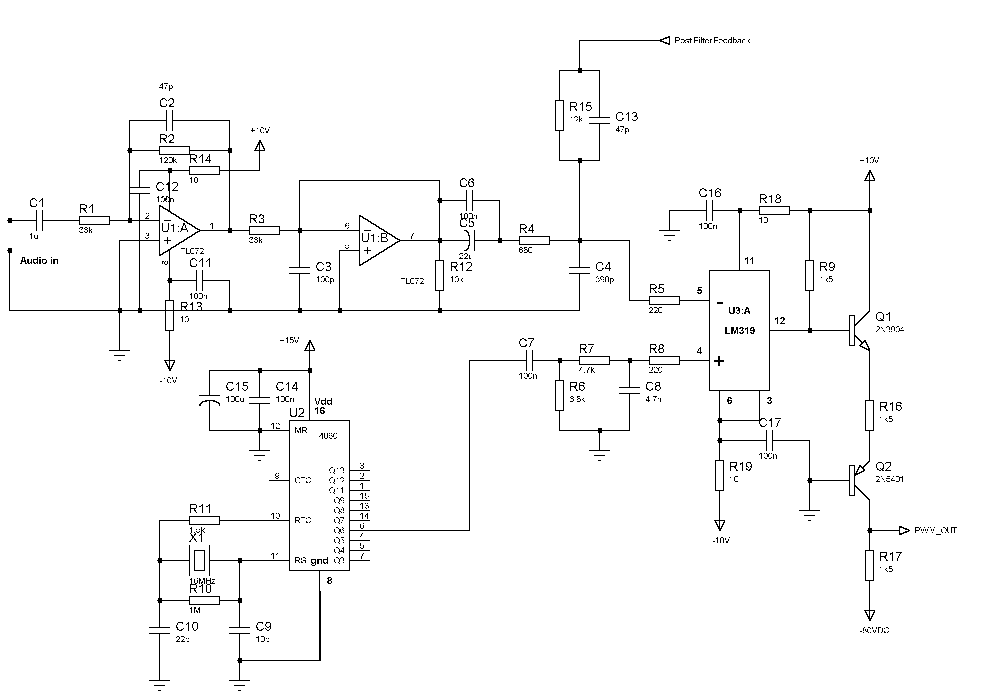

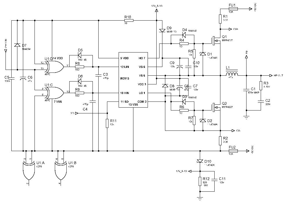

alexclaire said:Hi Lindomar,
Amp works fine, got 600 WRMS with 4 ohms load (+-80VDC 1KVA power supply).
I'll send Schematics as soon as i draw it ;-)
thanks for your interest...
Alexis.
Front end is Fredos D1200
and power stage is based on Crest LT amp series (4070+IR2113)

The image this a little quality...
Does have as sending with more quality?
You this developing the overload protection in level DC also?

Hello Alex..
I think has something wrong in the schematic.
In the picture of your amplifier has 6 circuits integrated.
And in the schematic only has 5 circuits integrated.
The components are illegible.
Front end:
1-TL072 - > Operational Amplifier
1-CD4060 - > Oscilator
1-LM319 - > Comparator
Power Stage:
1-CD4070
1-IR2113
Lindomar.

Hi lindomar,
you're right !
NE555 for the overload protection isn't shown in the schematics (5s timer when overcurrent is detected)...
Components values are from Fredos have a look in the forums you'll find them
for the power stage have a look at LT crest series schematics.
overload protection schematics is coming...

Lindomar,
Overload detection is onboard and I developped another board with start delay, DC protection, Temperature sensor and fast shutdown to avoid noises in loudspeakers when powering off the amp...
+/-10V, +15V and 12v referenced to -80VDC are also on another board to avoid temperature rising with resistors and zeners...

Hi
be careful,
2 mistakes detected in my schematics:
1) 4060 output signal must be taken on pin 4 (16 MHz divided by 64) (instead of pin 6)
2) R3,C3 must be connected to U1:B in+
in+ mustn't be connected to ground (U1:B mounted as follower)
