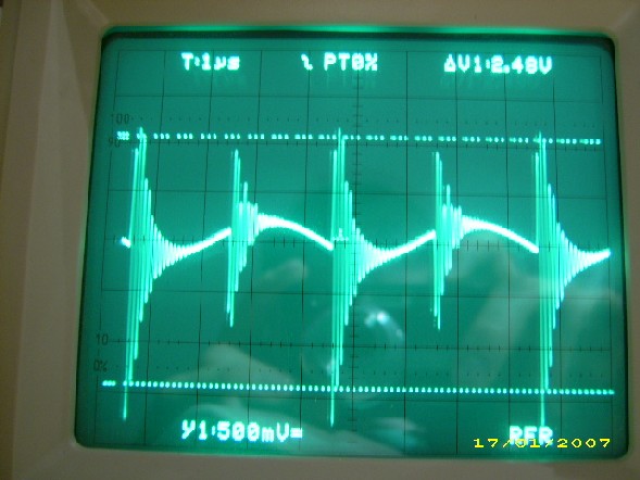

hi Fredos,
Still experimenting on my class d amp based on your D1200 front end design...
Changed the fets for IRFP240 (IRFP 4227 before) : no change
placed ground plane under output inductor: no change
at idle output signal is 250kHz sinus 3Vpp with ringing at 12Mhz (20Vpp) every half period, how could I get rid of theses oscillations ?
My filter is 54uH T106-2 core and 470nF MKP
otherwise sound is great but LF output sinus signal is polluted by these ringings...not audible ;-)
still testing the unit at 580WRMS@1kHz (4 ohms load)
thanks.

If you play too much with gate resistor, you will slow down the rise and fall time of you waveform. If you cant reduce deadtime trought the gate resistor, go at the input of the 2113. A good first attempt for dead time is to measure the current at idle with a load, no signal. Optimum point will be the lowest current. Booth gate may not be the same value due to difference in the 2113 delay!
Fredos

thanks a lot Fredos,
gonna check this and try...
do you think dead time is a bit much or not enough ?

Not enought and too much can do the same effect...

Amplifier prototype is ready for final module ;-)
just need 2 modules clock synchronised.
Sound is very great ! no more problem at clipping !
144Vpp @1kHz (4 ohms load) !
Mosfet temp rise very low !!
Thanks for all Fredos and long life to D-AMP
don't worry for the critics just go ahead...
Alexis.

Hi alexclaire
Could you show us schematic?
I would like to know how/if you did increased dead time of IR.
How did you solved the ringing?

Hi luka,
clock generator and pwm modulator are from d amp 1200 (Fredos) and output stage is from Crest LT series schematics available on the net...
output ripple 1,6vpp was normal (+-80V square wave @250kHz filtered with LC with f0=25kHz means -40dB so near (1/100)*80 sinus wave ripple)
30Vpp ringing were generated at each switching, I lowered them by increasing gate resistors to 65 ohms same resistor for each side.this setting was made with adjustable resistor till ringing felt to a minimum that is 3Vpp.
I couldn't get much better I think...
I don't have drawn schematics yet so have a look at fredos's and Crest's ones ;-)
