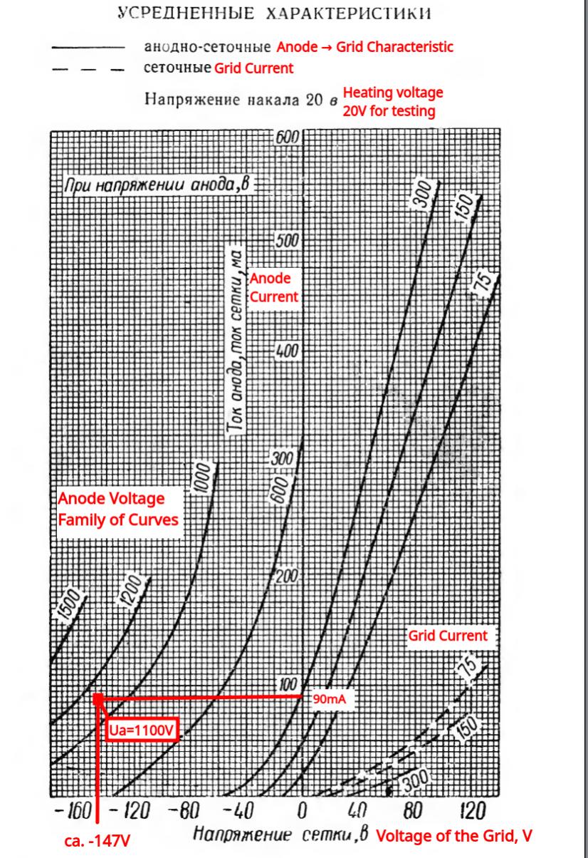

We should probably decide on how high to set the bias voltage limit.
At 1100V on the anode, the grid bias range is probably around -140V; but we should allow for a margin, given the variability of the various Ulyanov and other branded GM70s known to exist, as well as the Copper versus Graphite versions.
If we (arbitrarily) set the limit to -180V, it should suffice.
-180V at the grid means that a DC-coupled source follower must swing more than double this in magnitude: say, -380V to +20V (if we entertain the idea of a little A2). This suggests that the supply voltage for the follower should be (say) -400V and +50V. The bias regulator could (in theory) run from -400V and give -185V to -110V output. But such a high input-to-output difference is unnecessarily stressful, and would degrade the performance. It is far better to use a centre-tapped transformer and generate -200V and -400V with one bridge rectifier, and stacked output capacitors. The +50 (50-70V) could be had from another winding on the same transformer.

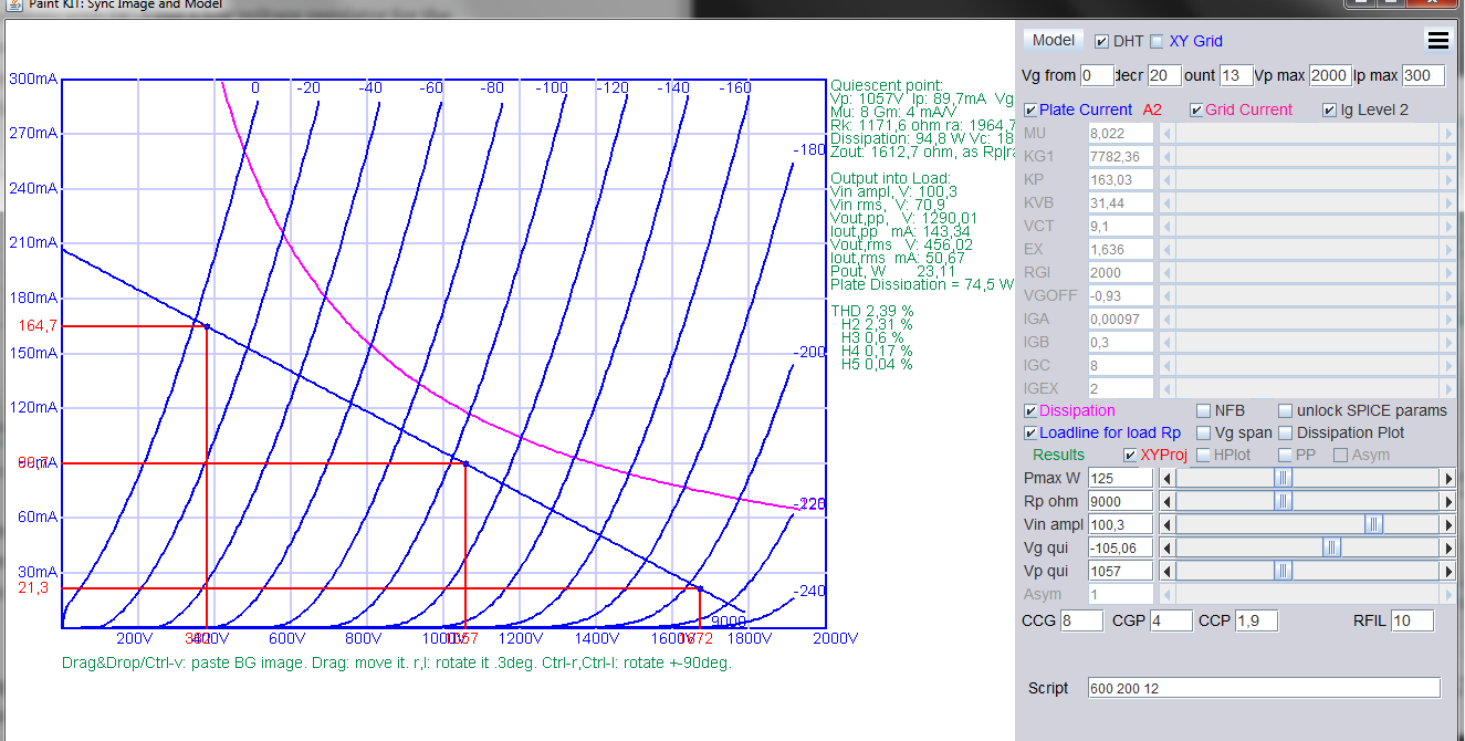

So, i was in mood to play....
i found this LTspice GM70 model:
Code:

Let's suppose the model is good.
I loaded Vincent static points (1057 plate V, 90mA current) to discover the bias is around -105V.
Seems that to remain in A1 class we need 200Vpp (140V RMS), at 23W output.
Perhaps a little tight, but even the D3A in triode mode should output this voltage (fig.2) Am i wrong?
Even better should be th E186F, but all we want is to reduce the impedance that the driver output sees.
Please tell me if these numbers make sense to you, i'm new to this paint-kit tool.

> why has to swing more than double?
We need the driver stage to swing to the cut-off (Ia=0) and then to zero... But not just to zero, but a little higher, to allow for some A2 drive. Also, we don't want the driver to suddenly stop at 0V or the distortion at clipping will be more audible.
If the bias is really 105V or near to it, that would make it easier. But the data sheet curves show more grid voltage than that, and it's worth having some extra voltage because Ulyanov and Reflektor tubes are in general subject to wide sample to sample variation.
This is the Data sheet figure that I had assessed the nominal grid voltage from.
At 1100V and 90mA it indicates about -147V.
In reality, it might be somewhat different - perhaps the data sheet is from another manufacturer, or the internal geometry changed across the many years the GM-70 was in production.
It would be very helpful if anyone whose main amp has GM70s to comment on the range of real settings for the bias voltage.
Otherwise, using a nominal Raw DC voltage of -250V for the follower + bias will be one option - and since Vincent's schematic is marked with this value, it is likely to be safe.

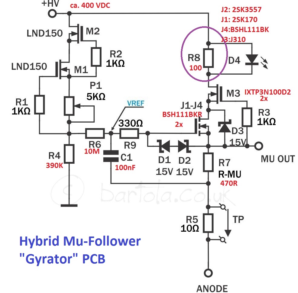

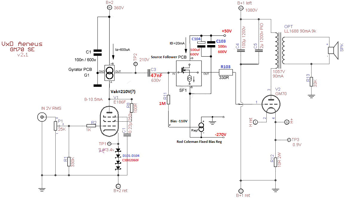

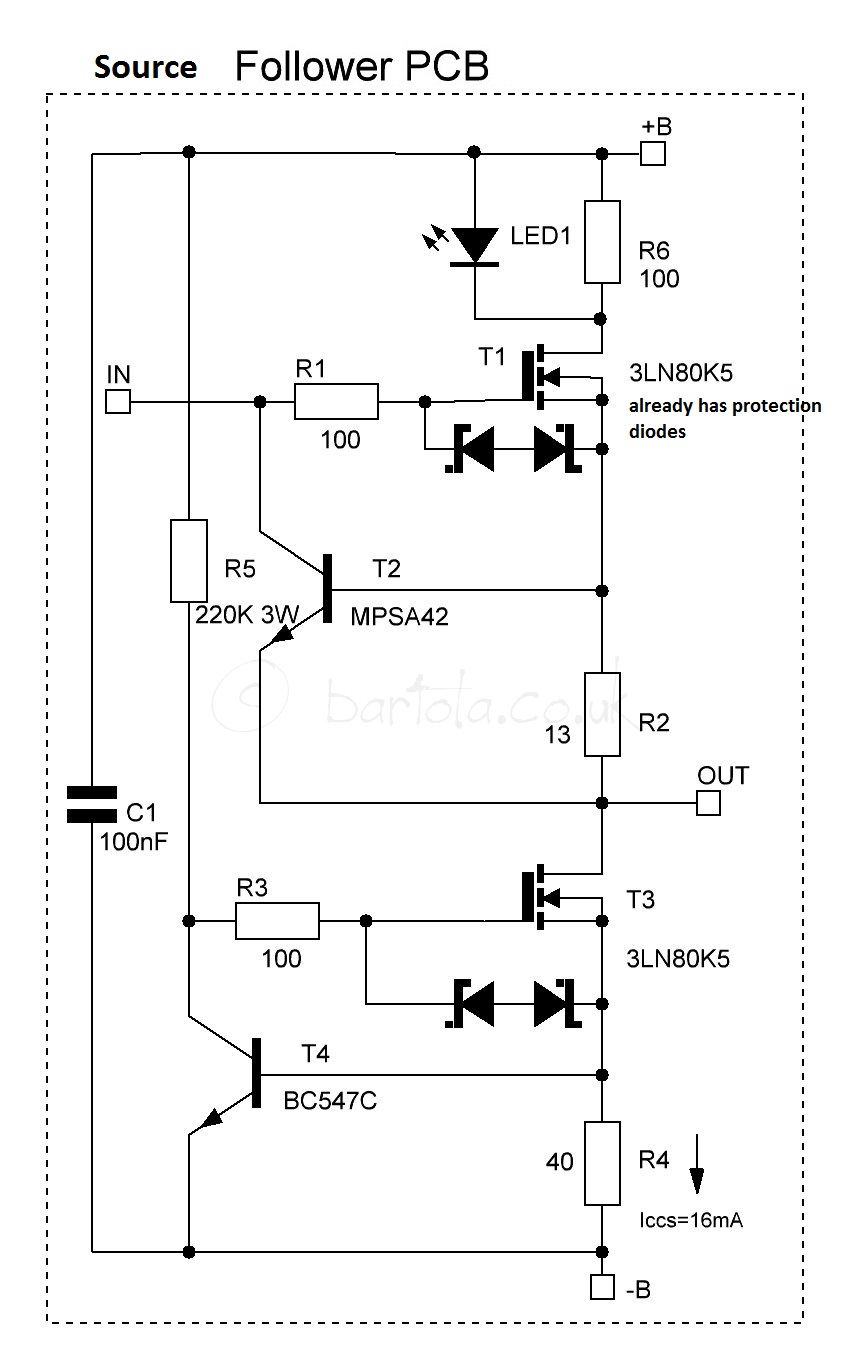

So friends, I elaborated the schematic, this should be my "freeze" result.
I ask you please to put en eye on that, you know electronics better than me for sure.
I wish to keep neg bias at -110V, as per Vincent's design, and many other designs I found on the web. Looks convenient.
Let the source follower then swing -110V +- 160V, resulting in -270V/+50V;
driver tube is biased with three Schottkyes C3D02060F, 0.85V each at 10mA.
Gyrator and SF schematics as follow, I would keep the drivers' B+ at 360V.
What do you think?
Now please, I need your help in designing a raw DC bias power supply for the given values (-270V, +50V, Rod's 110V out), with transformers' secondaries shared with the drivers' filaments (the 8VAC 3A = 24Va leg in Vincent's schematic.).
Hi Michelangelo
On the gyrator circuit, the LED (D4) isn't needed unless you want some visual indicator. If so, you will need R8 to be 220R for the idle current in your driver. Otherwise R8 serves as a protection to the MOSFETs in case you short the output of it. Best combination of cascoded FETs in my opinion is BSH111BK (or BSN20BK) and IXTP08N100D. Not sure why you added "x2" in the diagram as there is only one needed.
Source follower is ok, you will need a good set of heatsinks or mount them under the PCB to a chassis. The SF MOSFETs are plastic TO220 so their insulation is very handy. You will dissipate about 5W across the 2 MOSFETs.
For the raw PSU you can check the example on my 300B design here, albeit you will need to increase your secondary voltage if you want 270V raw. Do you know how to work with PSUD2?
300B SE Amplifier – Bartola(R) Valves
cheers

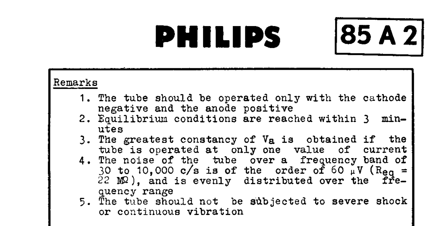

If you sink the Follower CCS current into the Unregulated supply (Which hardly matters for noise cause the CCS is high impedance), you can get away with a shunt out of two 85A2 set by a DN2540 cascode CCS for the grid bias. Simple and practically impossible to beat.
Philips Specifies a 60uV MAX noise figure per tube, if the supply feeding it is relatively low noise and the cascode impedance is >=100K total noise on the bias supply is never going to be above 170uV for -170V out, which to my knowledge is sub 1PPM.
See an excerpt from the Philips datasheet, its damm near impossible to beat. And is on par with the noise figure of one of the quitest references i know of: LT1021
