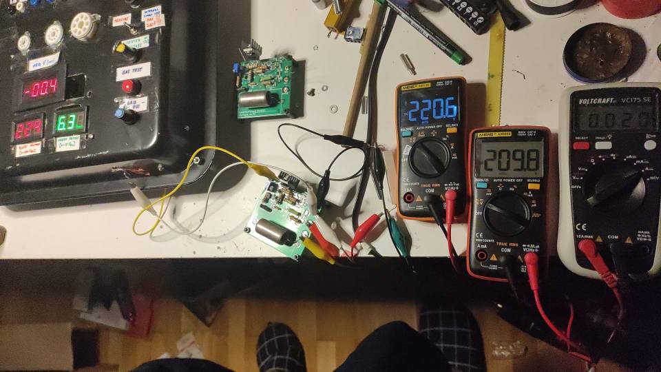

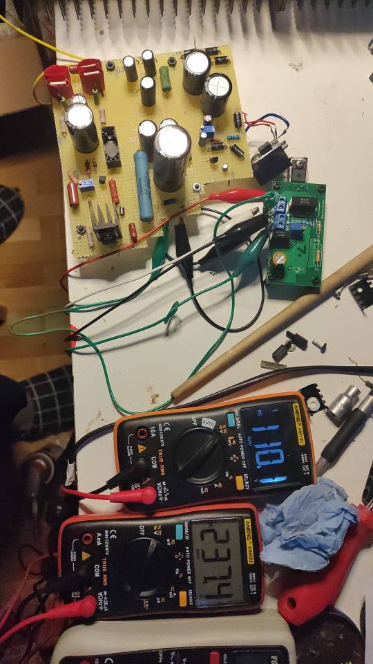

To measure the 1100v PSU, I used 4x 220K 1% resistors in series. Measure between one resistor and ground and multiply the measured voltage by 4.
Be careful and isolate well everything. Make sure the solder joints are rounded, without sharp spikes. Keep a good distance between HV parts and ground to avoid arcs.

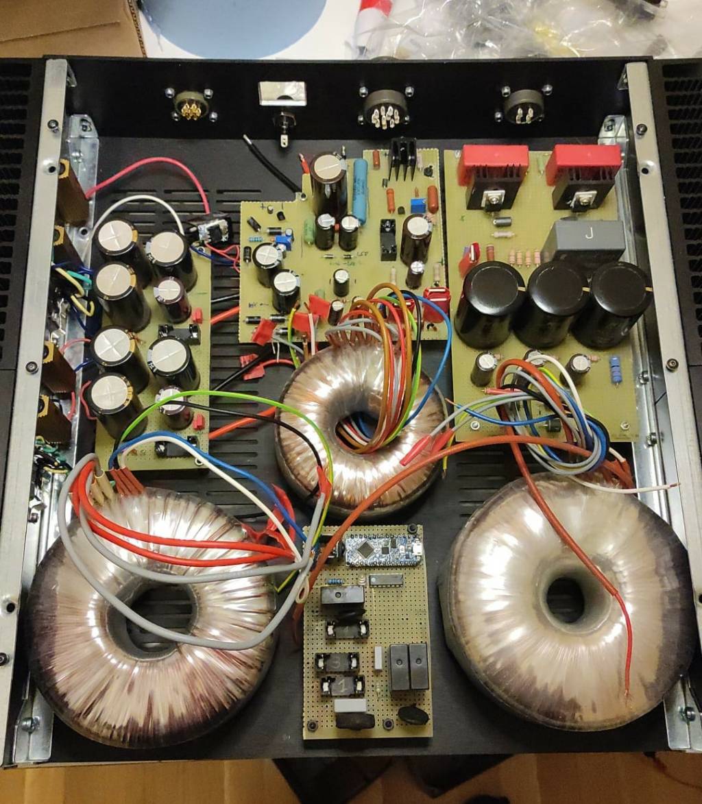

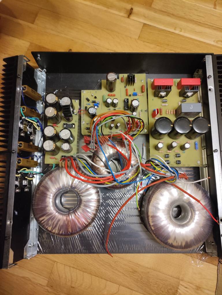

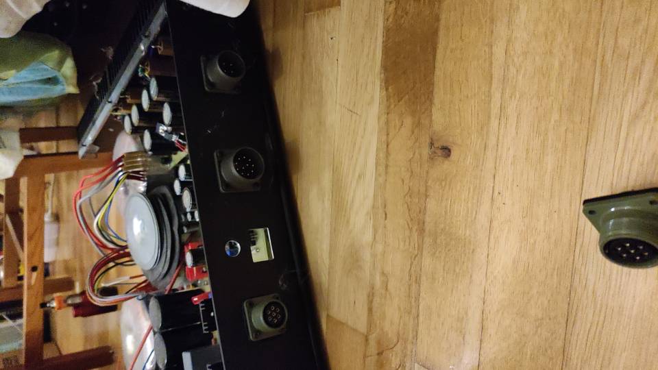

I will be using 2.5 cm spacers for b+ board... Screwed on the chassis, as you did
And when b1+ working, I'll cover the rear part with some epoxy resin

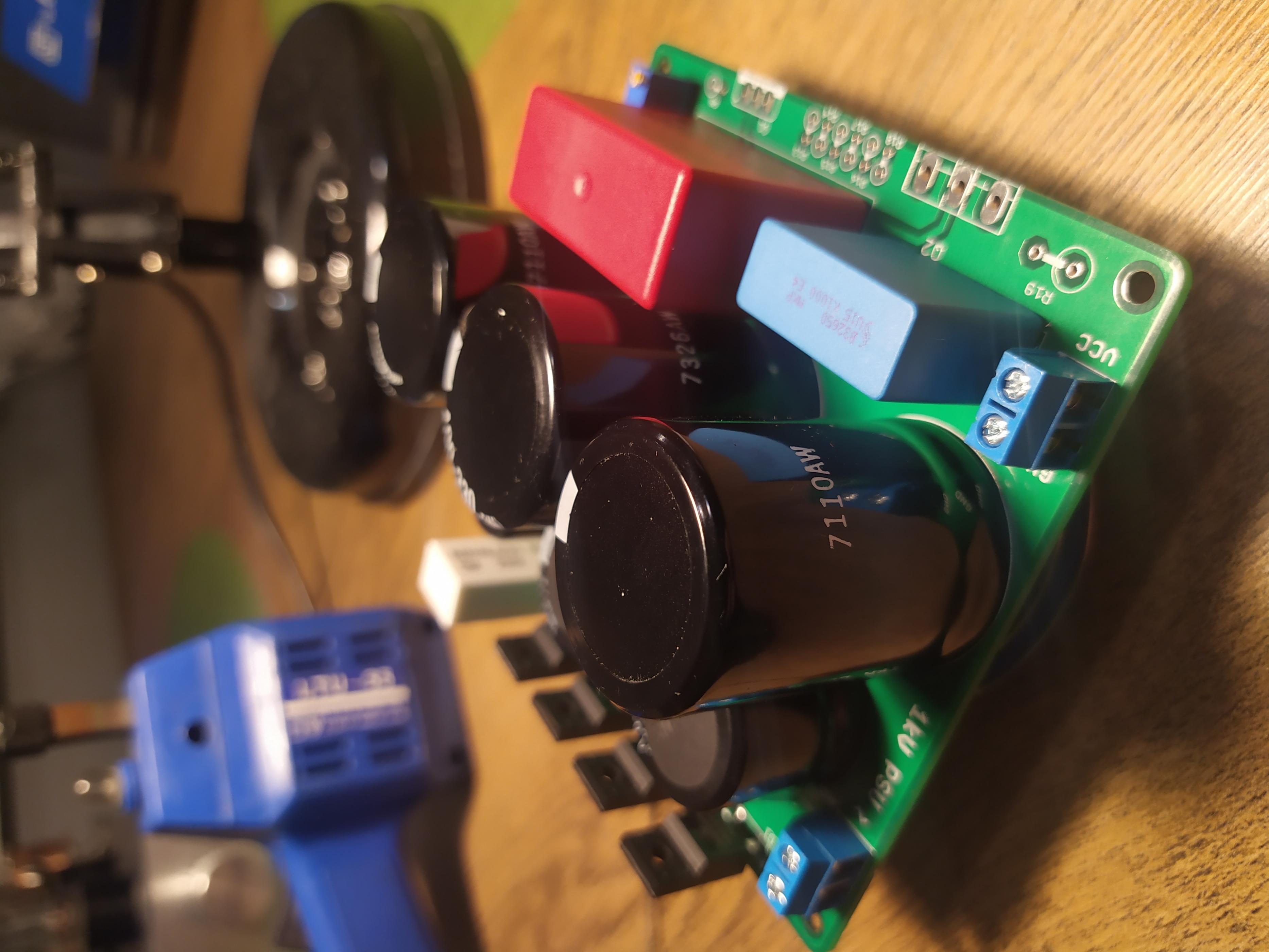

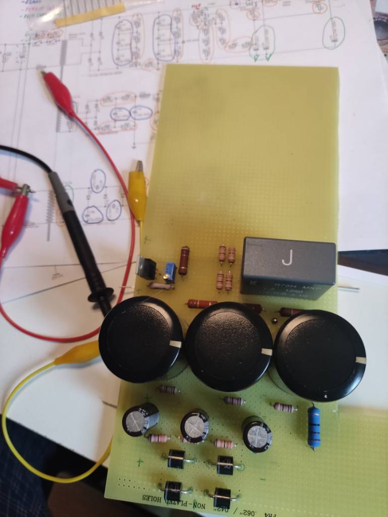

Hello friends, for those of you who didn't forget this project, the works go on. 😀
Built and tested psu boards, we got nice 1100V B+.
Next step is adding cable receptacles (Amphenol) and building cables of a suitable length.
Still awaiting that Rod ultimates his testing on bias regulator, while Ale Moglia's boards are populated.
Then will be time to start with the audio case, and displace the massive russian caps...

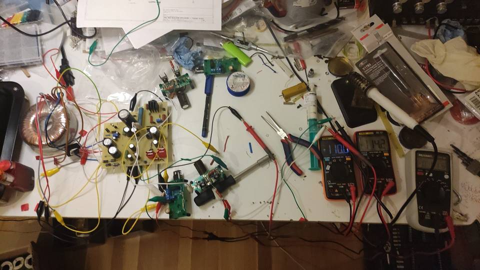

To measure B+ had to put in series 10x 100k resistors, tried with 4x330k and 4x220k, but voltage readings with my 2 multimeters didn't agree... Discovered that one dmm has an input impedance of 1Meg (measuring significantly lower voltage), the other one with 10Meg i.i. made more sense.
However gave it a current measurement to solve any doubt.

If any builder ever manages to blow the high voltage regulation fet, here is a good alternative : IXTK8N150L it is theoretically capable of surviving a dead short, giving enough time for the primary fuses to pop. The drawback being the large parasitics on the device which may matter in some circumstances.
