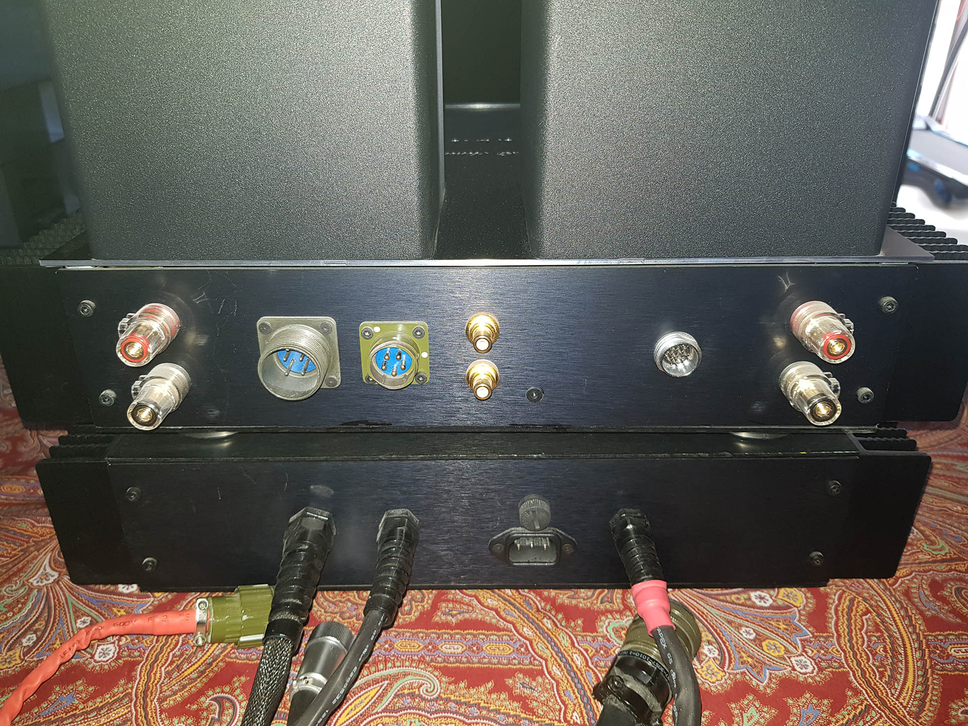

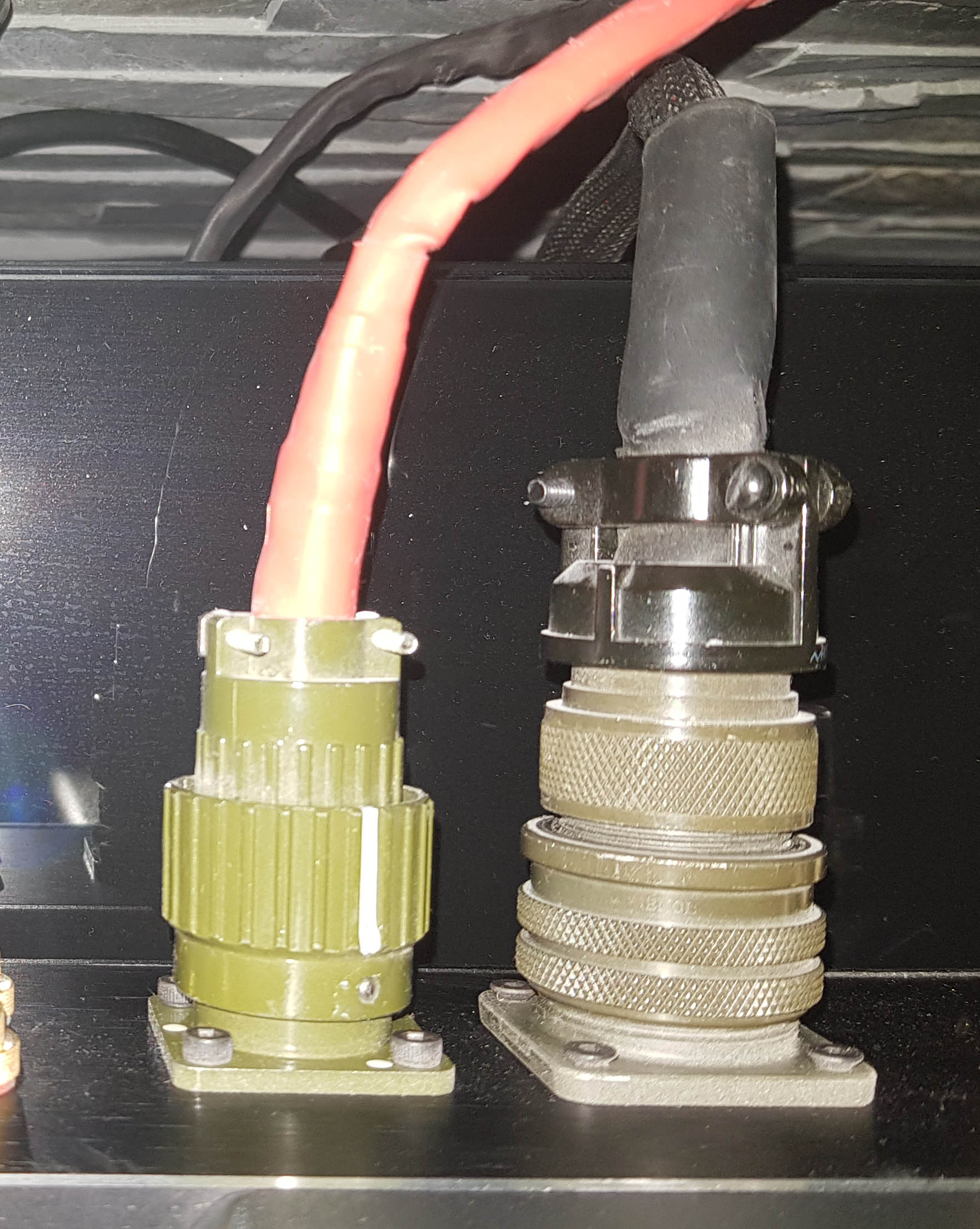

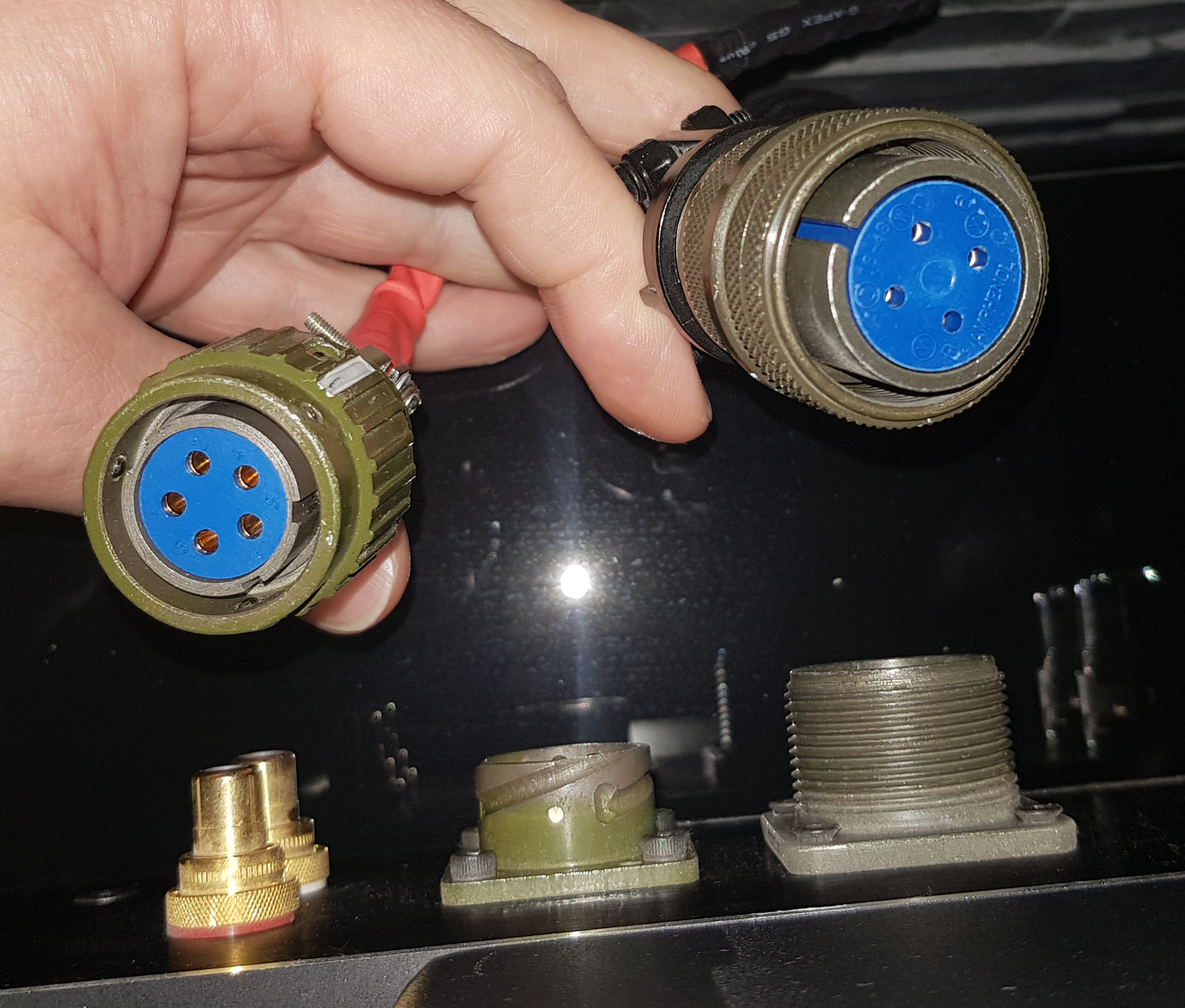

But those connectors are the defacto ones on most high voltage powersupplies we have in the labs. Safe for a few amps of current and very high potentials, beyond what is reasonable for an amplifier. One piece of warning though, they can be disconnected quite easily by design and I would not trust them unsupervised with children around as curious fingers could disconnect them and get a shock. One in a million freak accident but still worth to keep in mind
I used Amphenol MILspec locking connectors from Mouser for the 1100v B+ (I can't find the exact reference) and 5kV rated silicon isolated wire.
For the 350v and bias supply I used some locking militay-style Chinese connector off eBay. Good enough quality.
Photos:

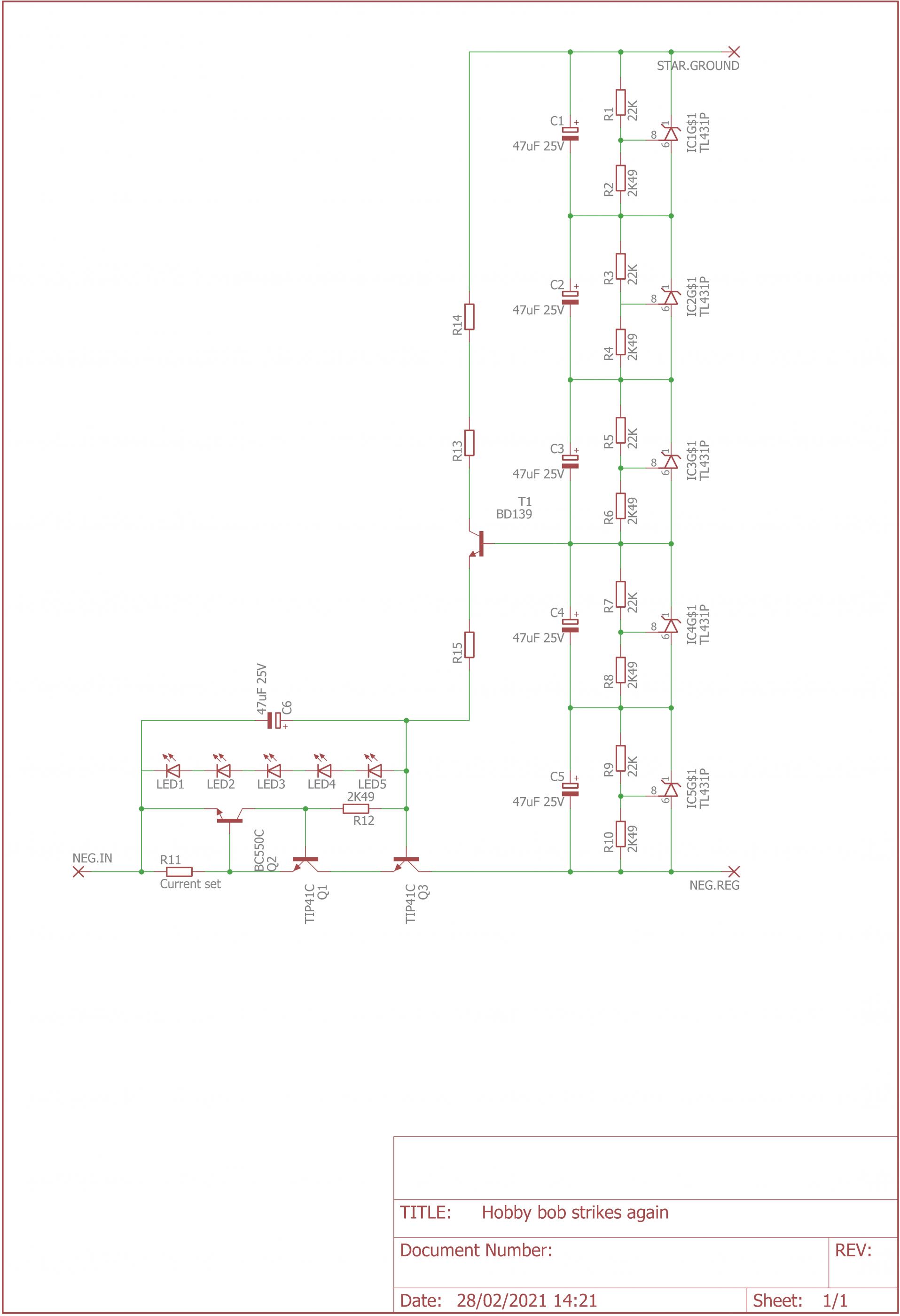

Shunt idea.
I had some stupid idea to do a shunt regulator with some cheap run of the mill components. Nothing special in here:
The most expensive part is the TIP50 transistor at about 50 cents. If you want better performance the toshiba TTA006B may do the trick.
Those shunt blocks are just plain TL431 shunt regulators in shunt configuration. And they are dead quiet like this.. depending on the grade they produce about 10-25uV RMS noise.
