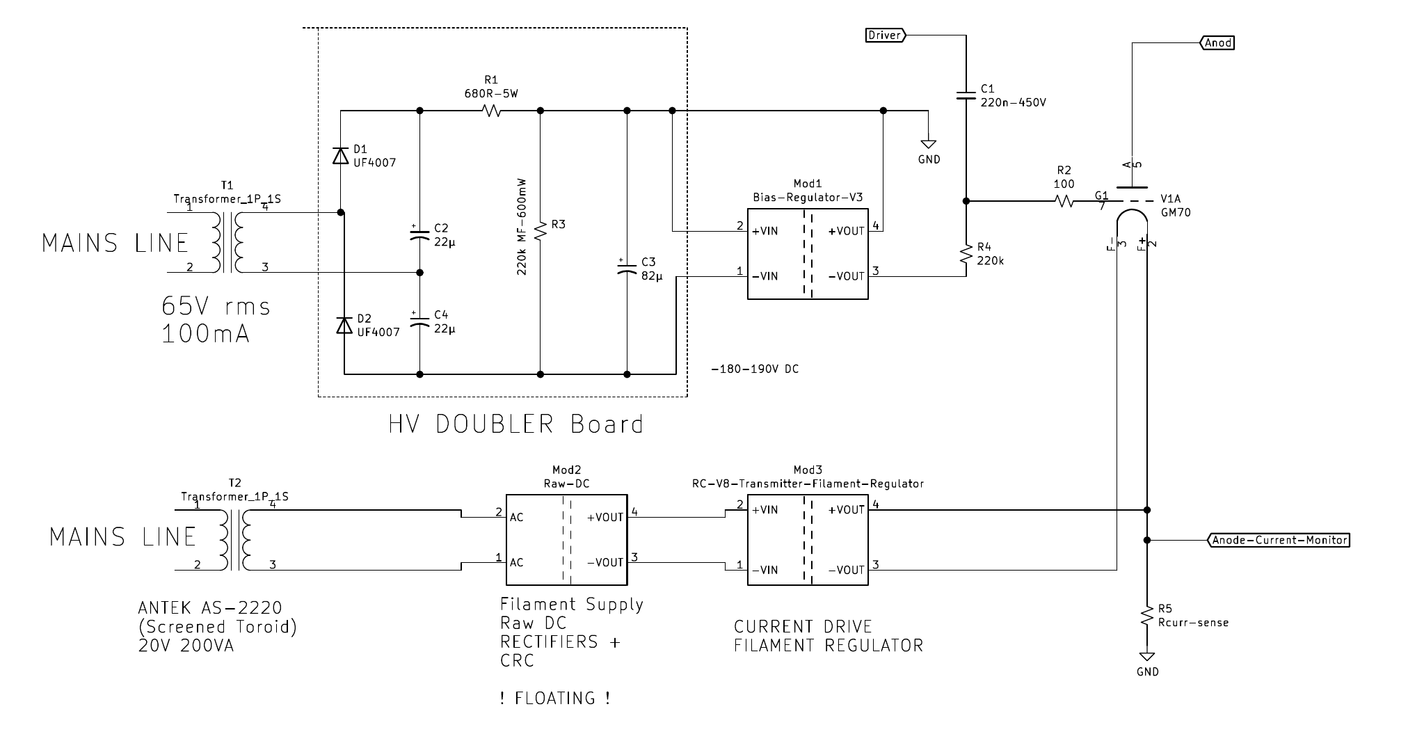

Interesting GM70 scheme... Some questions on the PSU, who helps me please?
Hello Michelangelo - Here is a schematic of the Power stage, incorporating the mods discussed. This is the version without a source follower; I suspect that the follower would improve it further though.

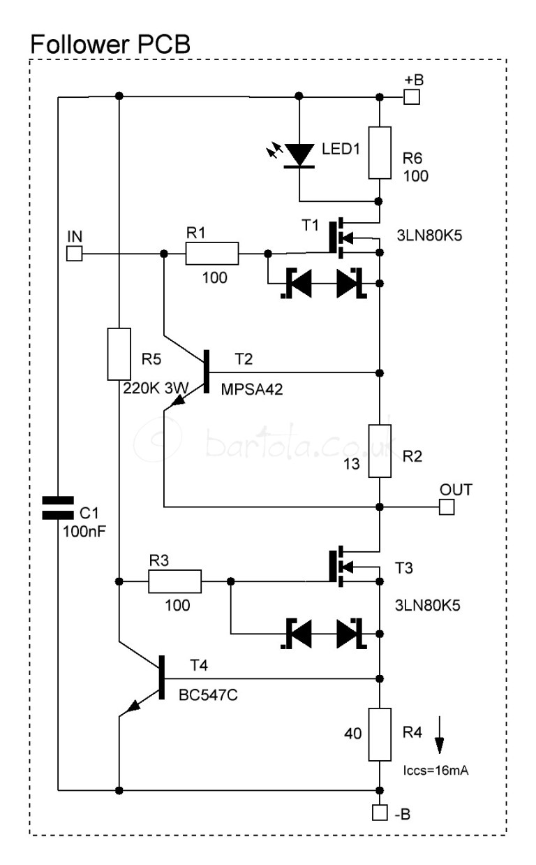

Hi rod,
Some questions about the source follower...
-i guess I'll have to apply negative bias to the drain, with enough current (10mA), right? So what are modifications needed, only a transformer with bigger power?
-do you think that driver stage doesn't have enough voltage swing? So what I've figured out is that would be the main function for the source follower (i was thinking of a E186F as well, or the russian equivalent of D3A)
-will the amp remain in pure A class?
Now things are getting difficult, it's the first time I play with source follower and mu follower schemes...
Thank you

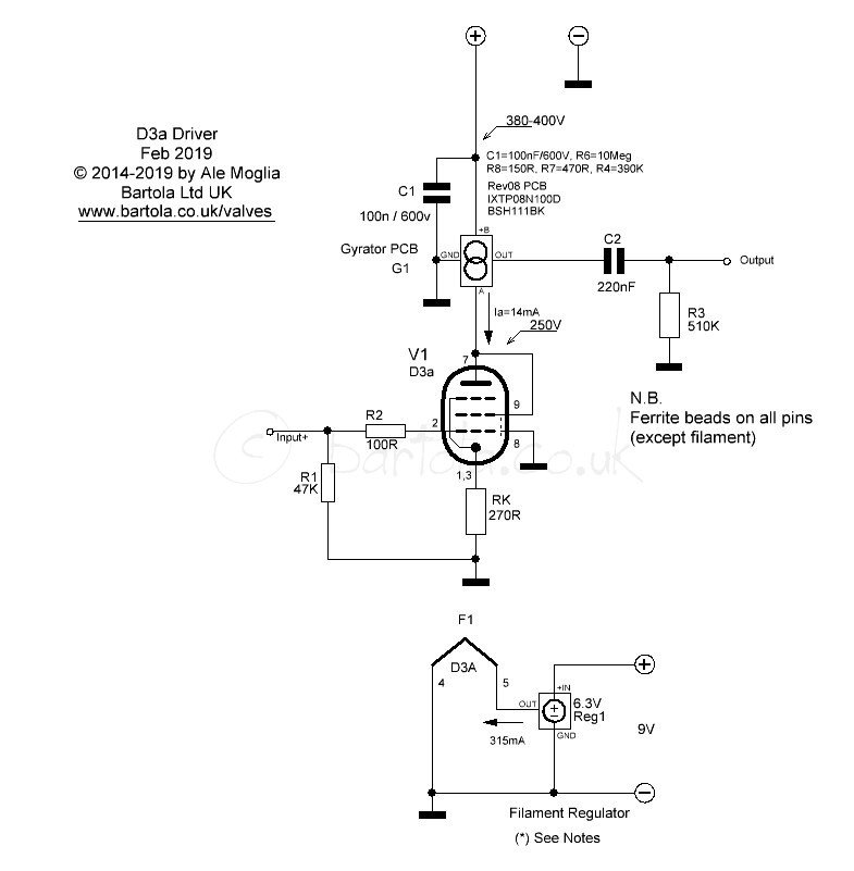

I have been corresponding with Ale and have ordred the SiC boards from him, as well as the latest gyrator iteration with presoldred FET and a pair of the source follower boards, though that is a more recent development in this thread.
I need to sit and do some calculations, but, in the meantime I am attaching a few of the relevant schematics from Ale's site, he implemented the D3a as the driver in his lastest 300B SE design - as well as a source follower there. IIRC Vincent mentioned that the D3a would be a suitable candidate despite his preference for the E186F SQ - but nonetheless we have two options there and some information.

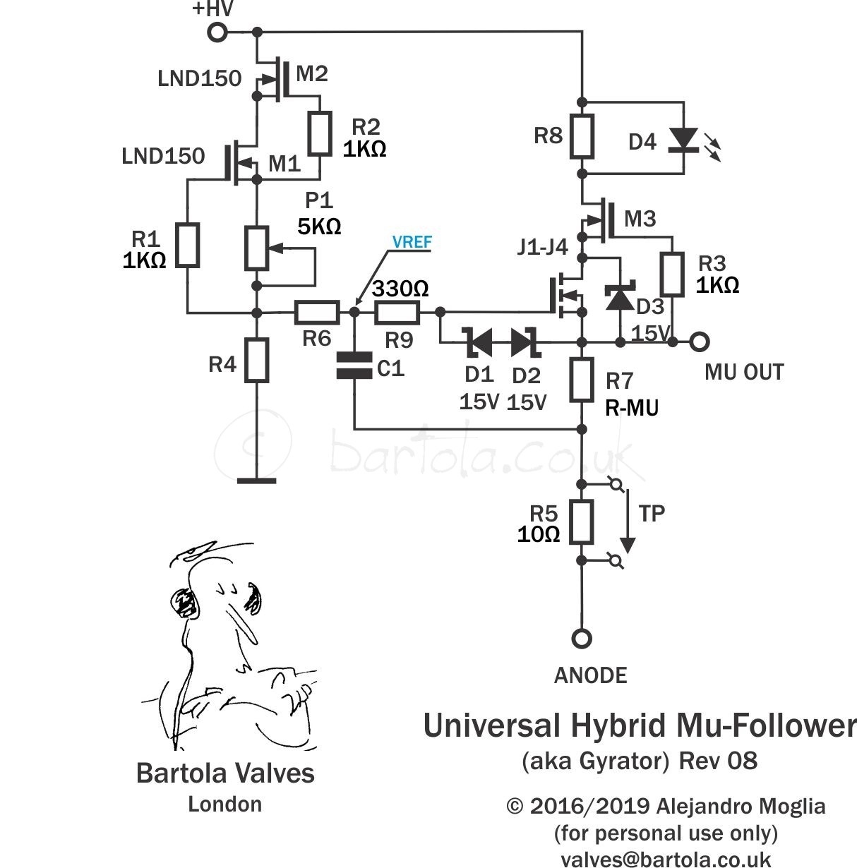

gyrator boards, we need to calculate te load impedance R7 (1/gfs) and the capacitor C1, then understand if the scheme you posted can keep its values (though it states "universal hybrid mu follower).

The follower adds some more power supply voltages to the design:
The B- input needs a negative supply of a little more than 2x the bias voltage;
the B+ input needs a positive supply of 50-70V
allow about 20mA DC for these. The two negative supplies could be generated by a (example) 240V rms winding with a centre-tap and bridge rectifier.
The bias regulator feeds the follower's IN terminal - the coupling resistor can be around 470-560kΩ.
If you are using the µ-follower then you already get some of the benefit of a low-impedance drive output - so whether the added complexity required is attractive is a matter of judgement. But having a DC-coupled grid has definite advantages.
In terms of Performance, DC-coupled grid is all advantage. The disadvantage is only in the complexity and extra power supplies.
The Follower FETs should be heatsinked, either with little clip-on types, or chassis mounting (use chassis as heatsink). The FETs should be isolated all-plastic TO-220-FP, so no insulator or shoulder washer is needed; TO-220FP packages are resilient to 2500V.
If you have room in the chassis, it would be worth trying, IMHO.

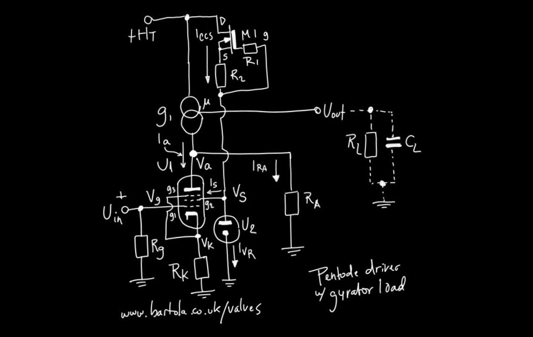

If you want to understand more how to implement a source follower, please read this: 300B SE Amplifier – Bartola(R) Valves
Of course you can run it without a source follower, however performance and distortion at higher output levels would be better with one. It can be a cathode follower, but is more complicated. The source follower can be as simple as a resistor loaded or CCS loaded as I use. Either way will work well.
You can use Rod's regulators, which are great for this job however you have different options to manage the bias. Where is key to use Rod's regulators is on the DHT filaments, that makes a big big difference, but won't dwell on that as is a well discussed subject.
For the "gyrator" load (aka hybrid mu-follower) you need to set R7 to 470R, R4 to 390K and you're good to operate well at 200-250V levels in the anode. You use P1 to adjust. R6 = 10Meg and C1 = 100nF. You're done that way and will get the best performance of the E186F driver in triode mode.
Benefit is that the output impedance won't be impacted (significantly) by having the 330R cathode resistor unbypassed (as it's a mu-follower) whereas in your diagram is suboptimal as you're taking the output from the anode, not from the mu of the CCS.
The +B of the mu follower should be no greater than 400-450V given the LND150 CCS, unless you want to implement your own board and use higher voltage depletion FET to replace LND150. I wouldn't waste that amount of power in the gyrator IMHO and rather implement a separate HV tap for the driver to provide a sensible 400V. I think you need 350V minimum to provide good headroom for the FETs to operate when swinging 200Vpeak to peak.

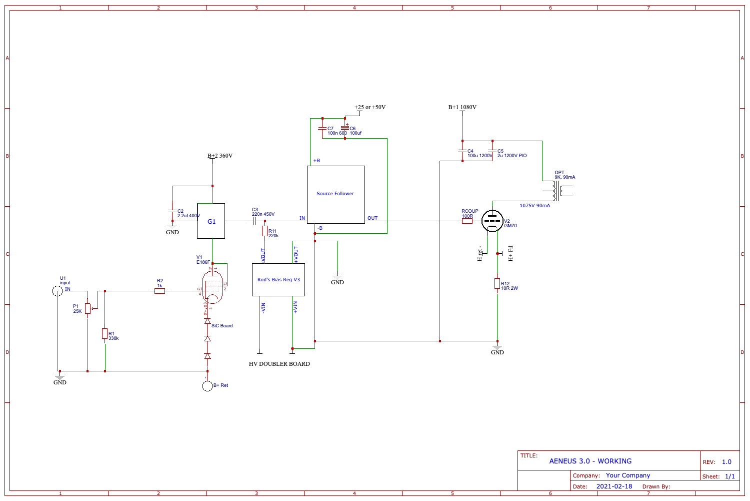

I started to roughly consolidate all of the newer implementations into this rough schematic.
As it looks to complete PSU will need:
1. Existing HV with 800V and 280V Secondaries - feeds output tubes and B2 for Driver (through gyrator)
2. New Bias secondary 65V RMS @ 100mA, and the 80V to feed driver filaments. Rod's HV Doubler does the job here, though come to think of it maybe these get split into two - dual 65V secondaries for the bias, and dual 8V for the filaments. That's 3 donuts so far.
3. Finally, the Raw DC supply, feeding the filament regulators for OP. Rod recommends the Antek Toroid here, 2 to boot. 5 Donuts total.
I need to dig into the values - on all of the components and work through them. Of note, is how G3 is handled in the driver tube. I've run it as pictured - but the other possibility which is actually probably a better play is to anode.
Values for Gyrator - Ale cut us some work there, thankfully, and it seems that C1 and R6 are sensitive components to the ears. Ale mentions using Dale NOS resistors here and I'd imagine quality PIO is welcome for the cap.
I'd appreciate a set of eyes on this, of course, been task switching quite a bit, so surely something I missed.

I think you have reversed the SiC diodes of the driver. Probably you copied that from my diagram which was wrong. Thanks as didn't realise they were the other way round.
Also would be better to have smaller coupling cap and increased gate bias resistor (R11).
Also you shouldn't ground the -B of the Source Follower. This should be connected to the -B of your raw negative DC (e.g. -250V). See below my diagram as an example:
