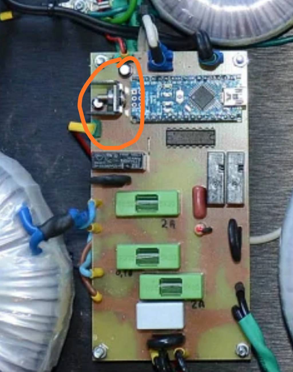

But what's this? (See picture)

The power is cut by the delay relay (named "tempo" in the schematic), not the inrush ones. Only B+ is cut, not the heaters.

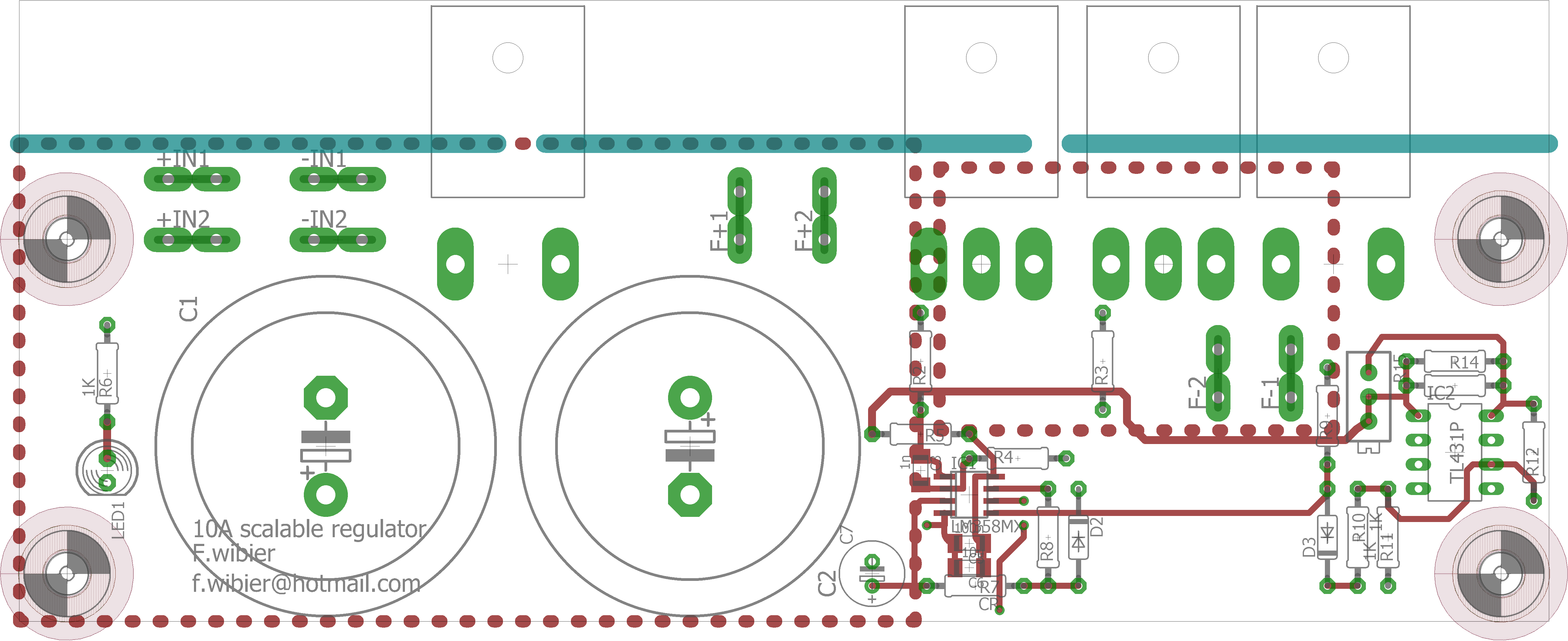

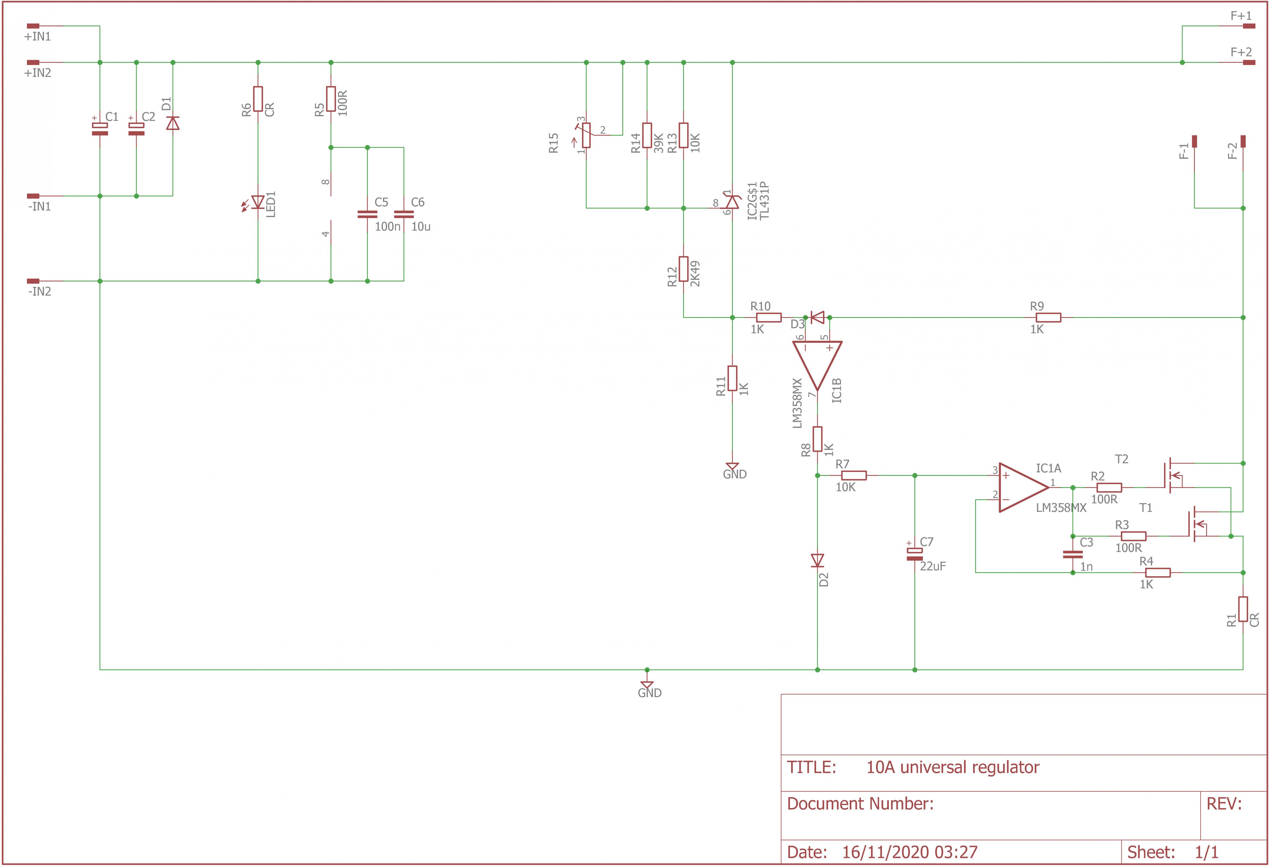

Heres a design for the heater regulators for GM70
Ive designed this to heat GM70's and 833's for that matter. its completely configurable with two resistor swaps.
I want to add a optocoupler to a new version, to interface these regulators with digital control logic, in that way you can shut down the amplifiers should either the regulators fail internally or the heater breaks.
If anyone wants to try some, i have boards available at cost.
Telegram support group for the regulator can be found on the DIYAUDIO landing page on :
