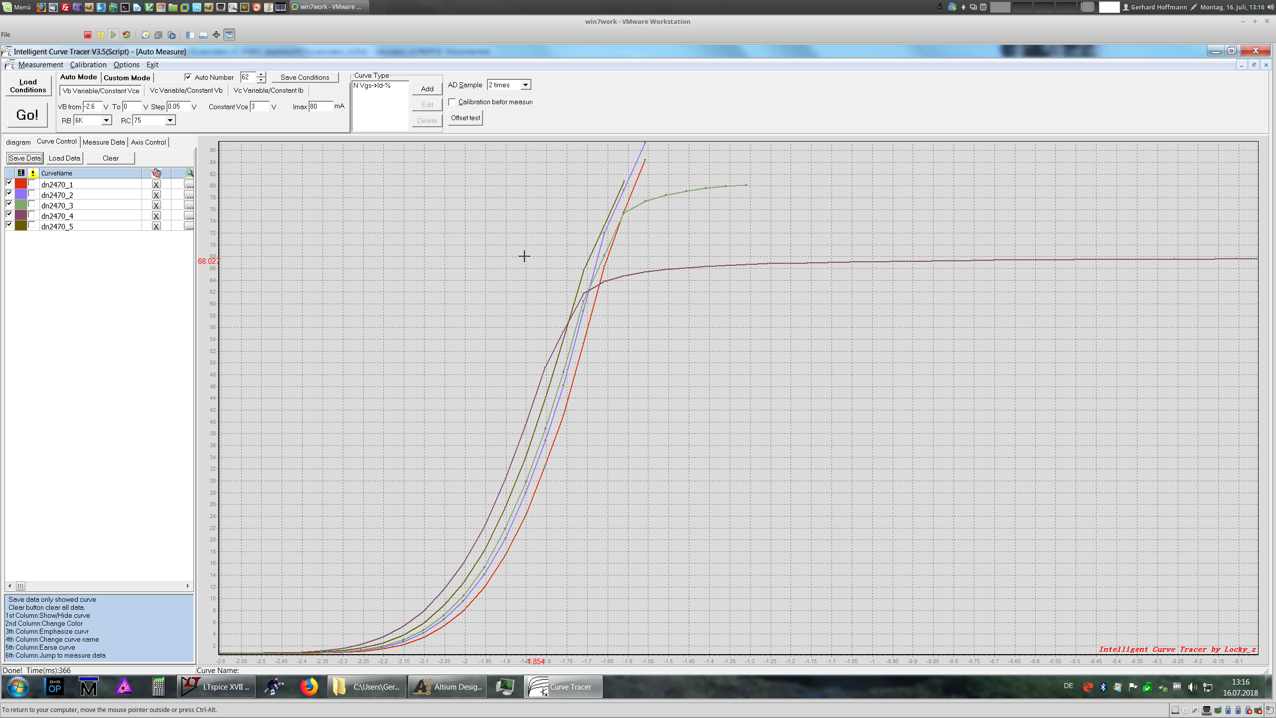

I never got meaningful results from bipolar transistors. Methinks the DUT then just
oscillates and you get random numbers. I did not investigate this because I happened
to get somewhat usable results for the FETs I was interested in, and that removed the
pressure. Absolutely no interest to debug someone else's hardware. Simply using
base stoppers would distort the results.
FETs are also not free from hickups, see the current limit effect on some DUTs in
the picture. Measured again, preferably with a different moon phase, these FETs behaved
normally.
