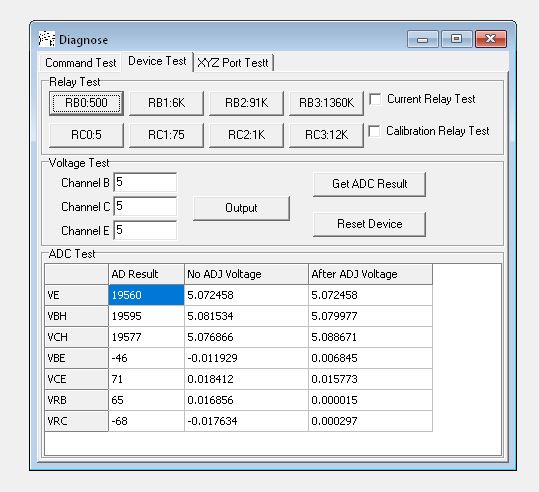

finally got a curve tracer rev3.5.
With the CH430 chip under WIN10 seemed no problem.
Device was recognized and the relay test passed.
But measurements don´t run as expected.
I followed the steps as in the manual, but always got only a single sample/measurement and no sweep.
Tried a second computer with WIN 7 but couldn´t install the drivers due to missing administrator rights.
Tried a third computer running WIN XP where it installed but again only single samples instead of sweeps.
What´s missing or wrong?
Thanks guys
jauu
Calvin
now that´s weird. 😕
Started the tracer today again and it worked!
Iirc the only difference I remember could have been that I started the ´ADS8771_v3.exe´ from the folder I downloaded from gerhard (#194) instead of the original ´Locky_z Curve Tracer Software - v3.5.zip´.
Got some nice curves and some very distorted which I think is due to some unfortunate settings of Vb et al.
So I closed the app and restarted it .... guess what ... no sweep but just a single measurement. 🙁
Closed and restarted the App again and it worked again 😕

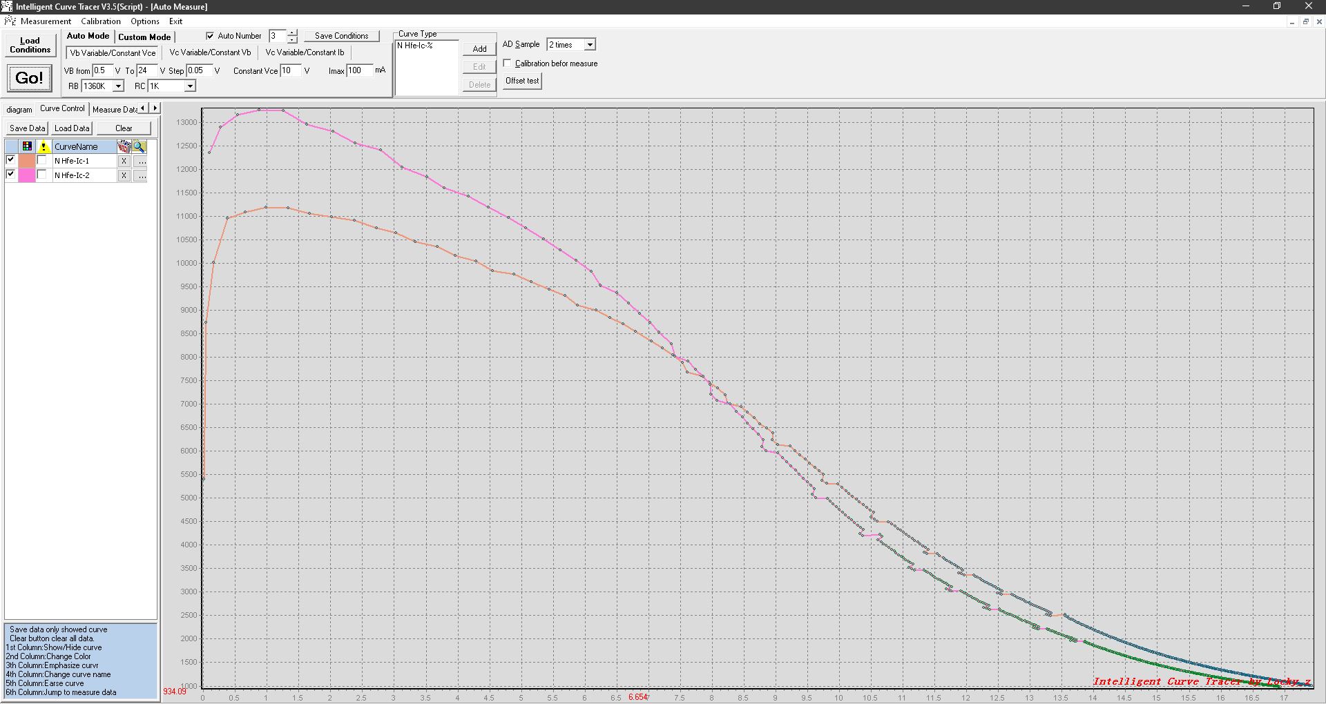

Well, so far I´m not too familiar with all the settings .... so I get results which sometimes appear reasonable and sometimes odd (especially the Hfe-Ic curves didn´t show sensible values ... a BC547C with a Hfe of >10.000 or <50??)

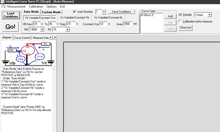

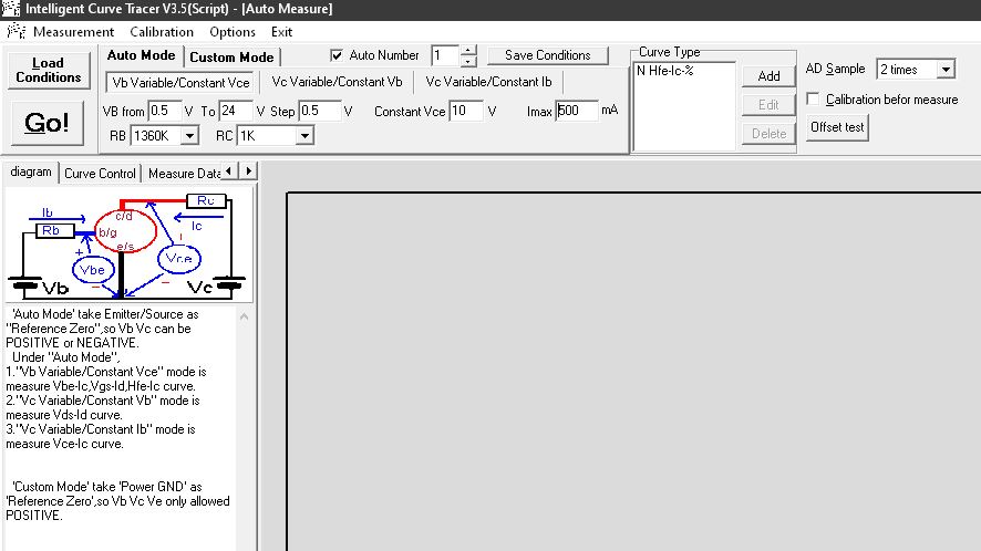

Here are the screen shots (btw. what and where is that ´save-file´?
1st: Options/System | 2nd: Diagnose/Device Test | 3rd: Measurement/Load Conditions/NPN-Hfe-Ic default | 4th: same, but parameters adjusted for BC547C | 5th: Go!, with and without Calibration
