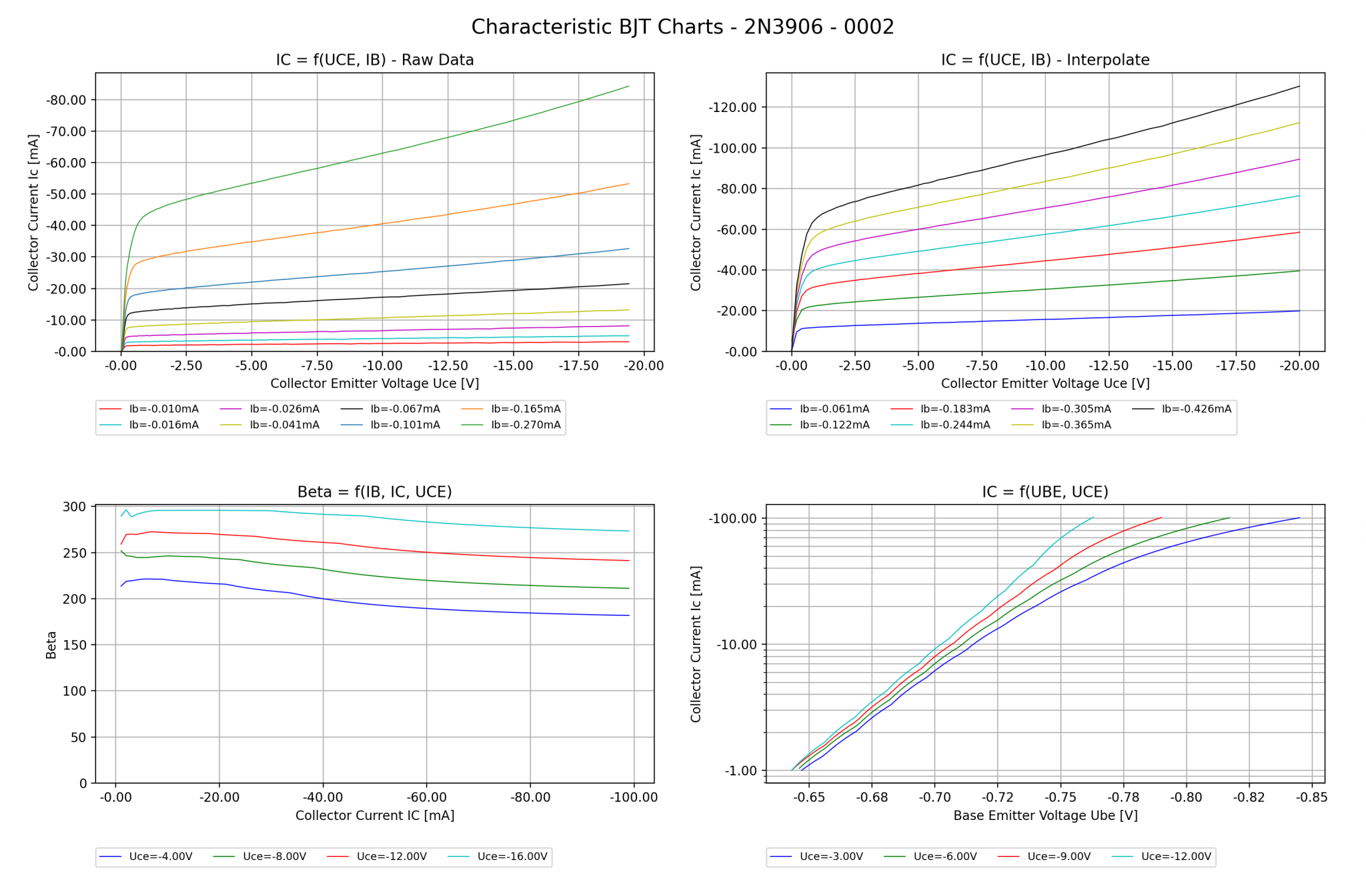

P.s. I do Beta curves…
The hFE of a transistor, often called the DC current gain or simply the beta (β) of the transistor, is a measure of how much the transistor amplifies the current from the base to the collector in a bipolar junction transistor (BJT). The hFE is given by the ratio of the collector current (Ic) to the base current (Ib)
@tubekiddo Graphs look good; are the 16-bit DACs and ADCs a material limitation on resolution?

I was thinking about how precisely Dr Borgmann's curve tracer can measure voltages and currents, and whether it matters.
16-bit ADCs allocate measurements into 2^16 buckets, so the minimum difference between analogue measurements in adjacent buckets is almost 0, and at the maximum, twice the size of the bucket. Hence my rough calculation of 0.15mV at 5V, or 0.075mV at 2.5V

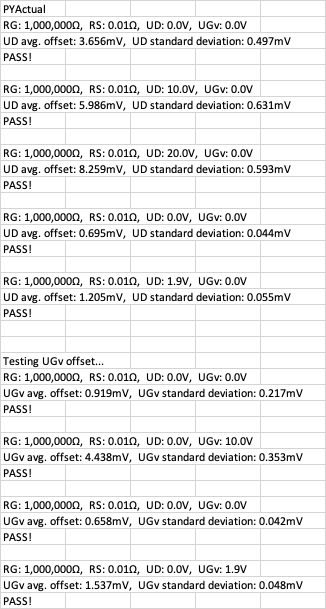

Looking at @tubekiddo's numbers, to get 90% confidence in a ±10% range means a standard deviation of ±10%/1.65 = 6% of the reading. 95% confidence interval is 2sds so 5% for standard deviation.
A quick calculation gives SD/value:
PYActual
7.3%
10.5%
7.2%
6.3%
4.6%
UGv
23.6%
8.0%
6.4%
3.1%
It looks like it gives fairly reliable results sometimes.
Given care over external sources of noise, what else can lower the variance?
And does it matter - how precisely do we need to characterise the curves?
