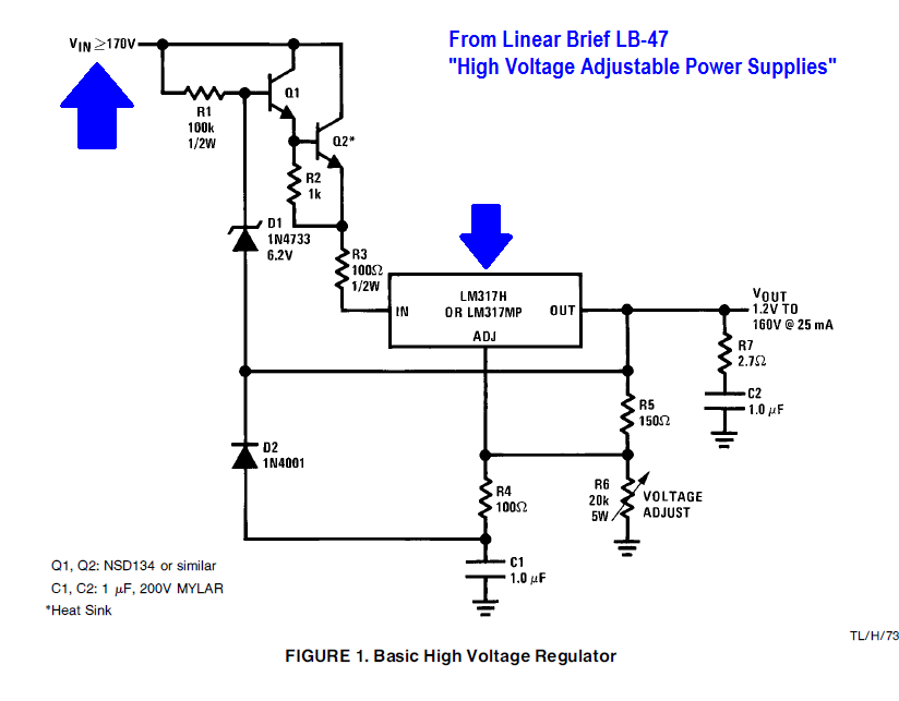

LM317 regulated 36-40V to 24V, Its voltage drop is only 16V, the LM317 can be used here without any problem.
The maximum supply voltage is determined by the op amps, which use the supply voltage directly.
Sorry to go further but I find this product interesting 😉 Datasheet state 40V is maximum rating. Not normal operational condition.
Changing chip for more SOA, will invalid garantee ?
You should check the LM317 data sheet again, it says that the Input reference differential voltage should not exceed 40V, not that the maximum input voltage should not be greater than 40V. There is even a small formula Vi-Vo, that means that the difference between the input and the output should not exceed 40V, meaning that you can input say 100V, as long as the output is no lower than 60V. So yeah, locky_z was right by suggesting that the standard LM317 is a good choice since there is only a 16V input to output differential in the circuit. The HV version that you mention has a 57V input reference differential voltage spec, which is of course not needed here.
An interesting schematic

The curve tracer maximum supply voltage is determined by the op amps, which use the supply voltage directly.
In curve tracer, there two type op amp, one type is follower, one type is single power supply op amp.
The follower opamp need low Vos(<2mV) and low Ibias(<10nA), and unit gain stability, and Vicomm(or Input Voltage Range) between Vee+2V ~ Vcc-2V.
The single power supply op amp must single power supply op amp, and output voltage is from 1 to Vcc-2V.
:checked::checked::checked:. Thanks fellows for correcting me. I always considered 317 as standard regulator with Vin fixed. Learnng all times in life.😉
