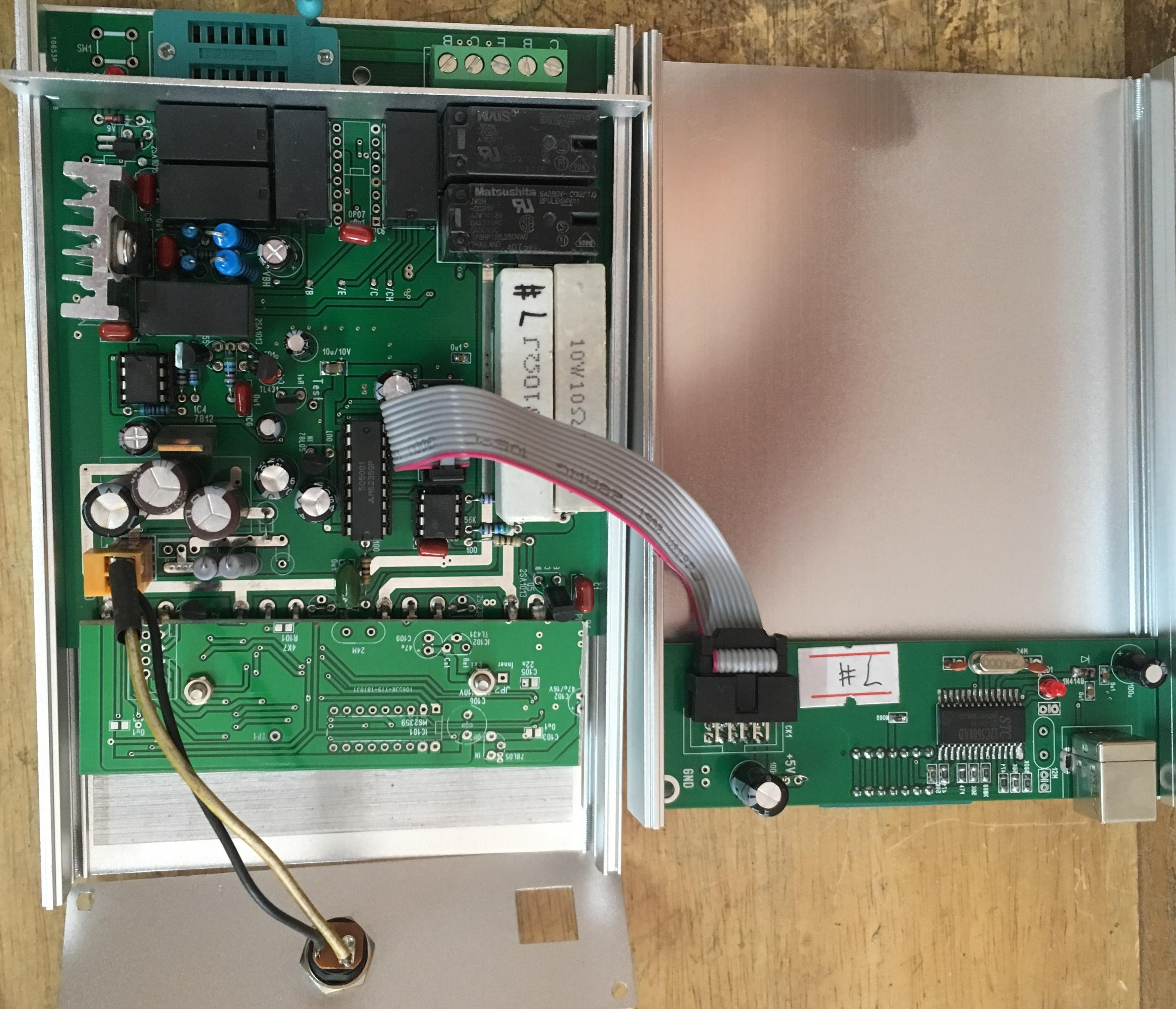

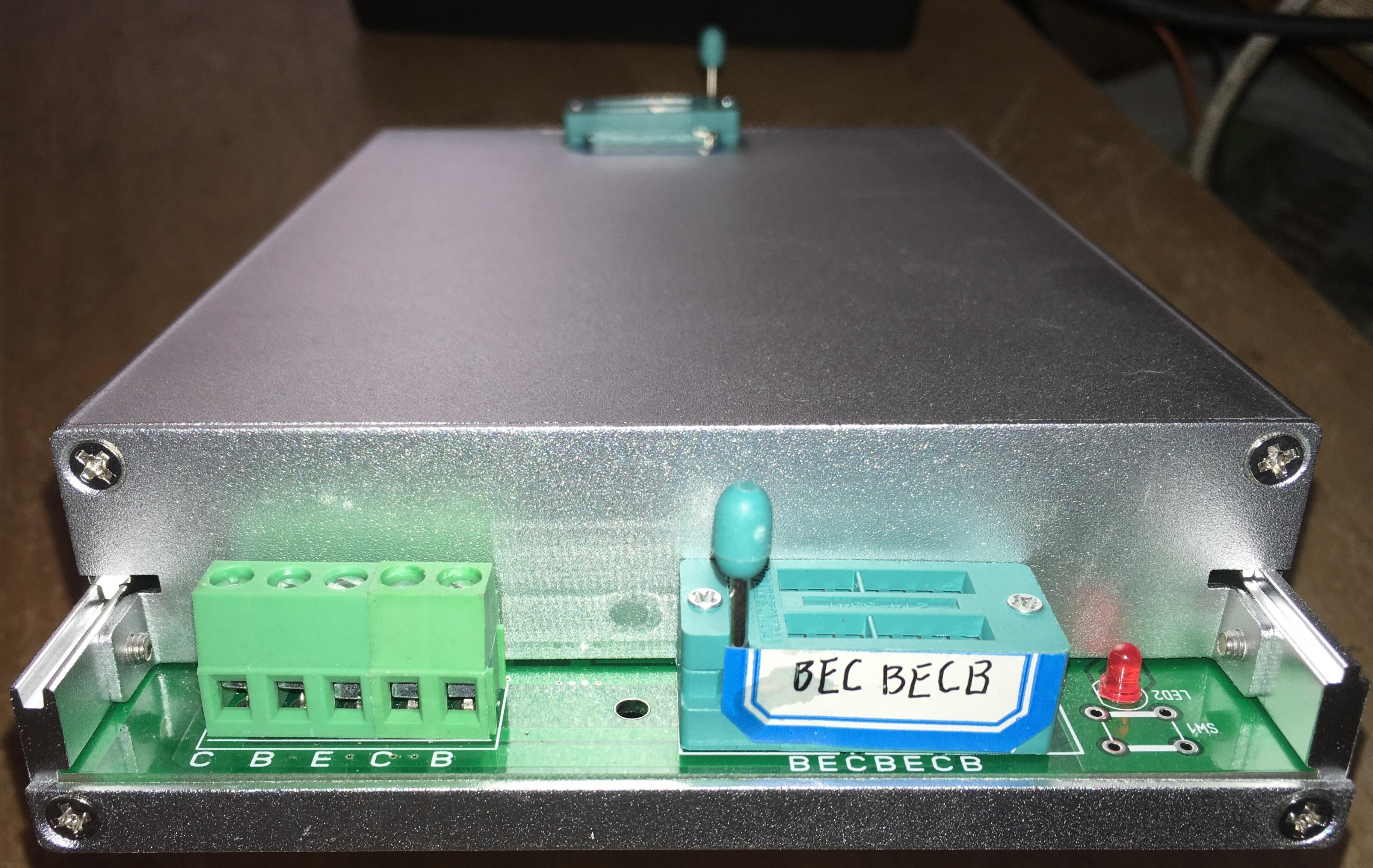

Could it be for sale?My locky-z is sitting on the shelf collecting dust.
Gerhard
No, as long as I don't have a better solution.

I've been pondering on the subject of an open sourced project, maybe hosted on github or whatever collaborating platform.
I've been wanting to make such a gizmo for a long time and locky-z's project came fairly close to being what I'd be looking for, however it does have shortcomings and there are things I'd like done a bit differently.
I've had this project on my to-do list long enough and I'm not in a condition to tackle everything all by myself, I can't keep up with it all.
But I have never done any open source stuff and have no idea how to properly do it, with zero experience with the sharing/collaborating platforms.
With enough participants in the project's development, this could become feasible.
One thing would have to be done first: define all of the features and how to implement them.
From my point of view, being entirely a DIY project and not being able to handle any SMT, it would have to be all done through-hole, with off-the-shelf stuff (not obsolete).
And I think something based on some kind of FPGA (cheap ones) would allow further improvements to be made after the hardware has been frozen and made.
Obviously, software wise, open source and multi-platform is a must.
My only usage for such a device would be to match parts, so although tracing curves may be a part of it, the curves themselves aren't that important, the data is what's important and the software feature really required would be to make best use of the data gathered to match sets of parts.

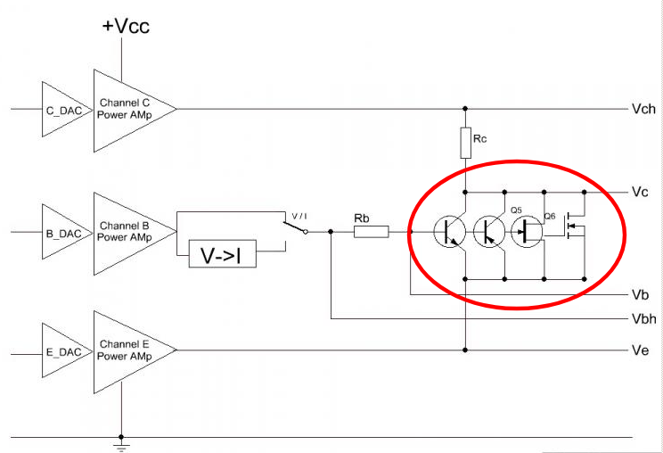

locky-z's device has to be used keeping in mind the thermal issues. It's not a matter of reliability really, just that the way it does things isn't as optimal as it could be.
And I find the shortcoming of being windows only to be a big one, and a show stopper for myself.
Plus it's doing curves but not the crunching required with the data to find part matches.

All the above comments on Locky_Z's tracer might be more or less justified, and some of its shortcomings can be dealed with. Using a large mass heatsink with quick-clamps, with a dozen DUTs (or so) clamped on for a minute or so before testing (so that they are all at near same temperature) would yield already better results. I managed to select nice matching pairs for differential input stages for amps without DC offset adjustment that had less than 2mV offset. Which is good enough.
Then for many instances, for example JFET substitution, or VAS or cascode transistor evaluation, then it's rather a matter of comparing values/curves and not a matter of absolute values. Understood that some users might need it for different purposes where absolute values count, but it's perfect for the vintage hifi rebuild and upgrade works that I am into.
Although this curve tracer is not perfect, and as such easy to shoot on, he was at least a person who pushed through an entire hardware + software project. It's for years that I hear folks on various fora talking about wanting to do such project, but so far nobody did. I'll be a front line buyer if anybody puts out the device that they claim about.

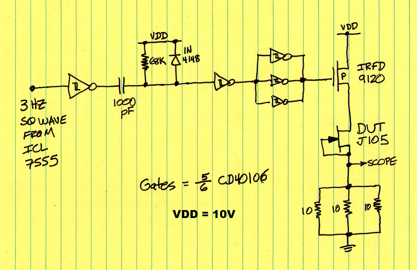

I measured Idss=1.1 amperes on the humble J105, using pulse techniques: (link to diyA post). Duty cycle of measurement pulses was 0.02%: 68us / 333ms. Schematic below.

There is not much to that pulse measurement technique. You
bring the DUT into a state where it dissipates nothing. For a BJT
