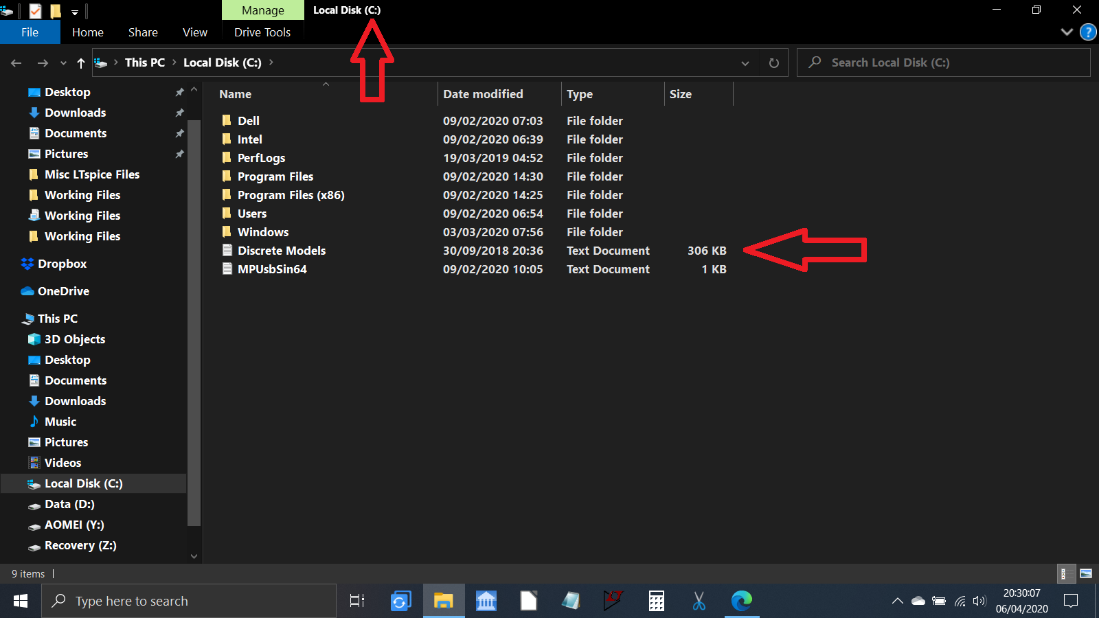

I used to have a copy of the file in each folder that had simulations in it. So dozens and dozens. Each sim had the .include xyz.txt line.
Now I just have one file pasted into the root of the C drive and a line on each sim saying saying .include C:\discrete models.txt
I find it works really well for what I want.

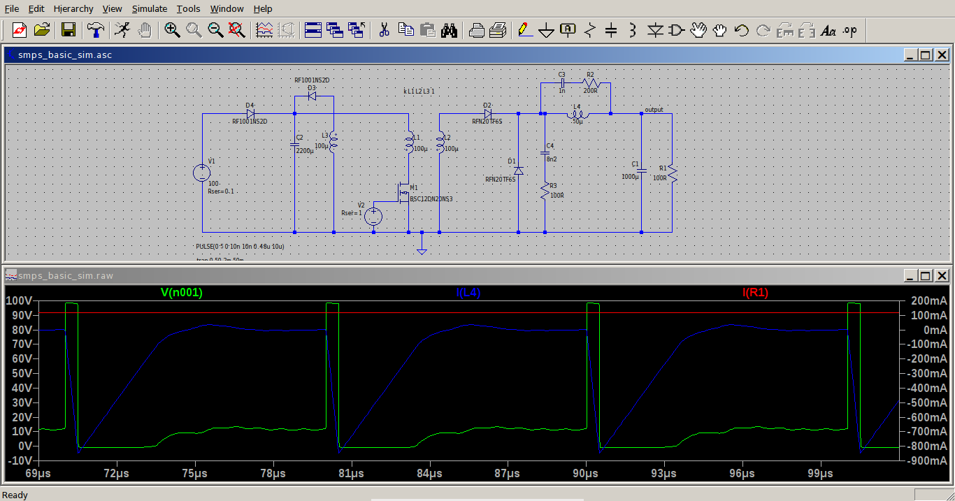

Regarding Post 1955:
Parameter declarions with the .param directive seemingly do not support what I wanted in the above mentioned post.
To workaround the limitation I changed the duty cycle from 48% to 10%. This simulates active pulse width modulation to achieve a voltage that is lower than what the secondary is supplying. Please, note I added an output inductor and a flyback recirculation diode.
The circuit shown is a forward converter power stage and output stage.
V(n001) is the junction connecting D1's and D2's cathodes.
V(n006) output voltage of L2.

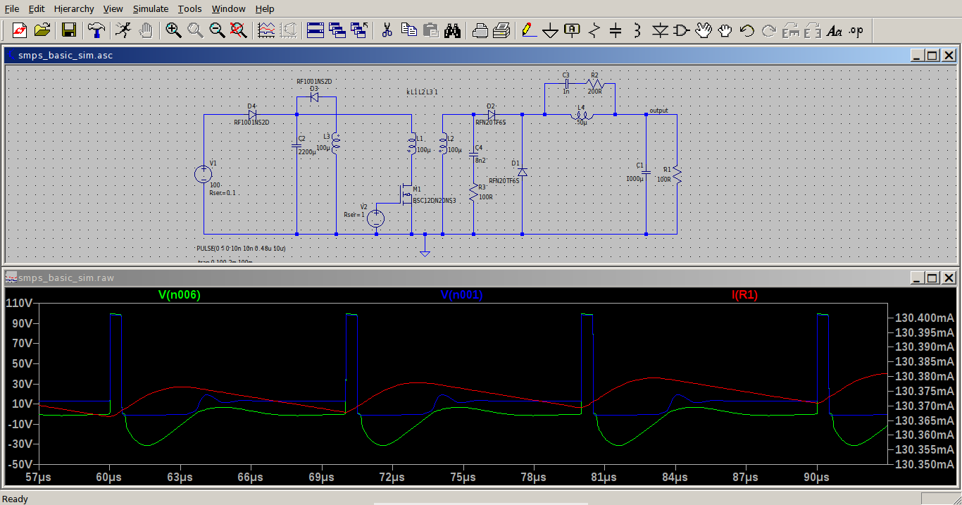

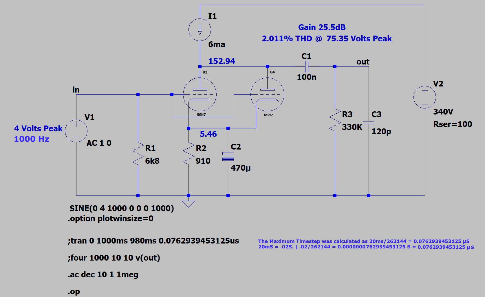

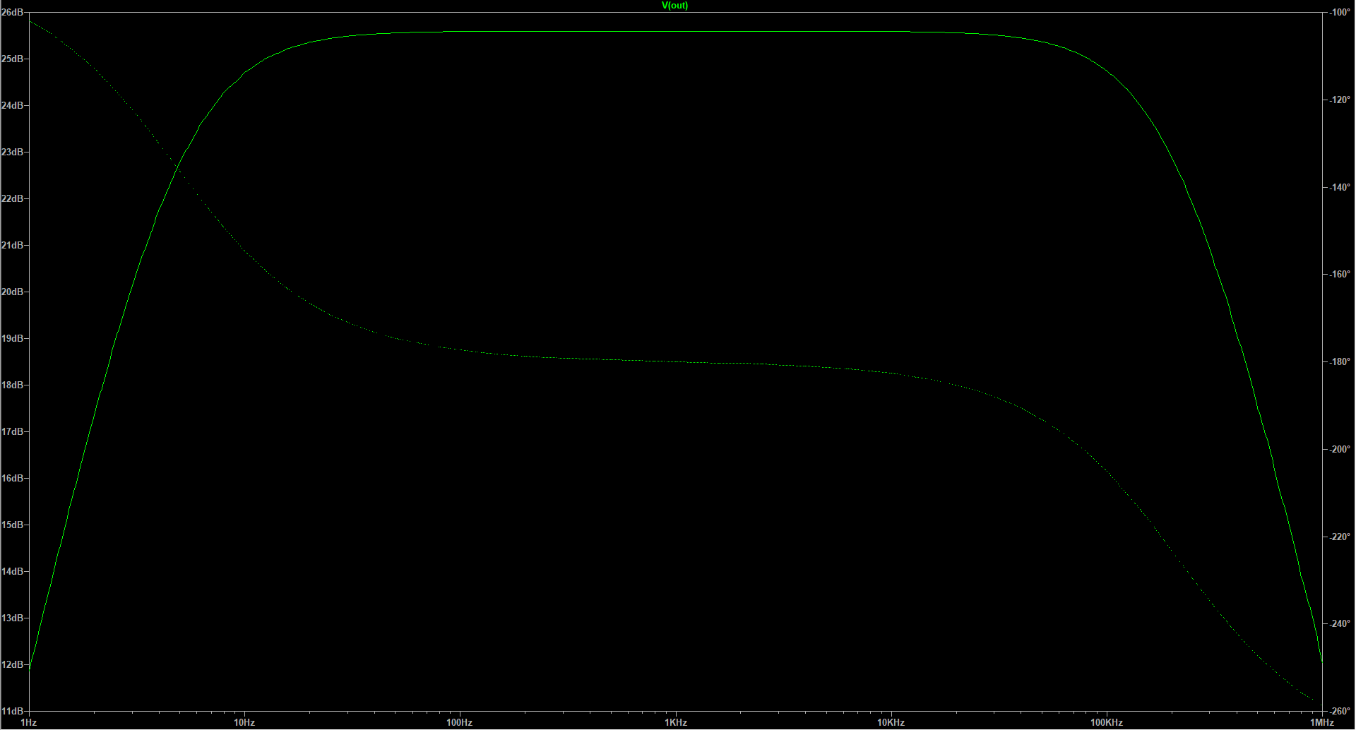

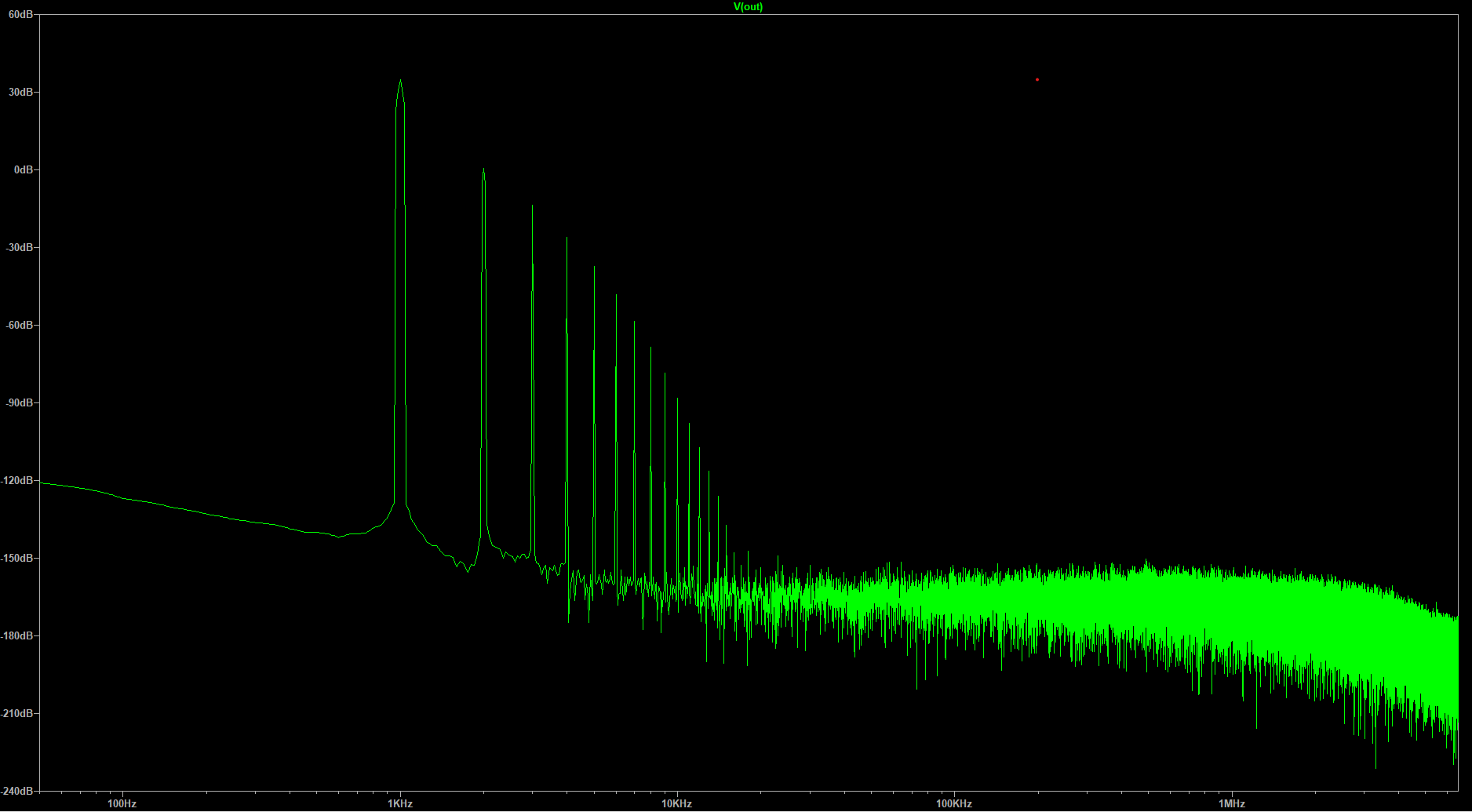

I think I've got the hang of the application now. I did a week of intense study, which stretched the grey matter to the limit, but that's the kind of challenge I relish. Anyway, I did my own simulation of the paralleled 6SN7 driver stage of the 300B SET. An interesting observation is that the three methods which I employed for FFT and distortion gave the same results with a convergence of better than 0.1%. The longhand calculation became second nature after a while with lots of practice.
I did all this study just to be able to finally perfect my 300B design. but now I can use it for other tube projects. I hope the few screen-grabs make sense. Thanks to all who helped me, especially Mooly. I'm at the beginning of course, and no doubt will need help again.

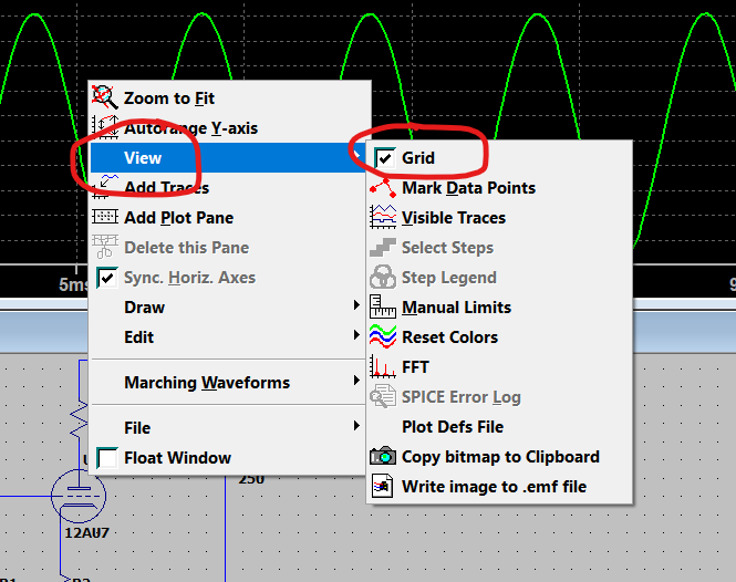

You had me fooled for a while. In my innocence, I thought you meant the grids of the triodes, seriously. . It never occurred to me to investigate the other view options.Hey, that looks great, well done
Have you found this setting for adding the grid to the display? Just right click the display graph to find it.
