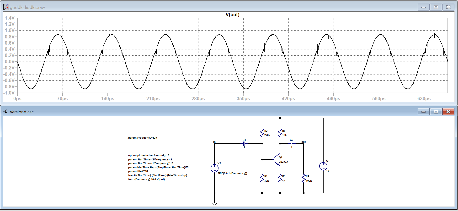

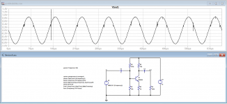

Last shot shows the glitches at 12k. Why ?

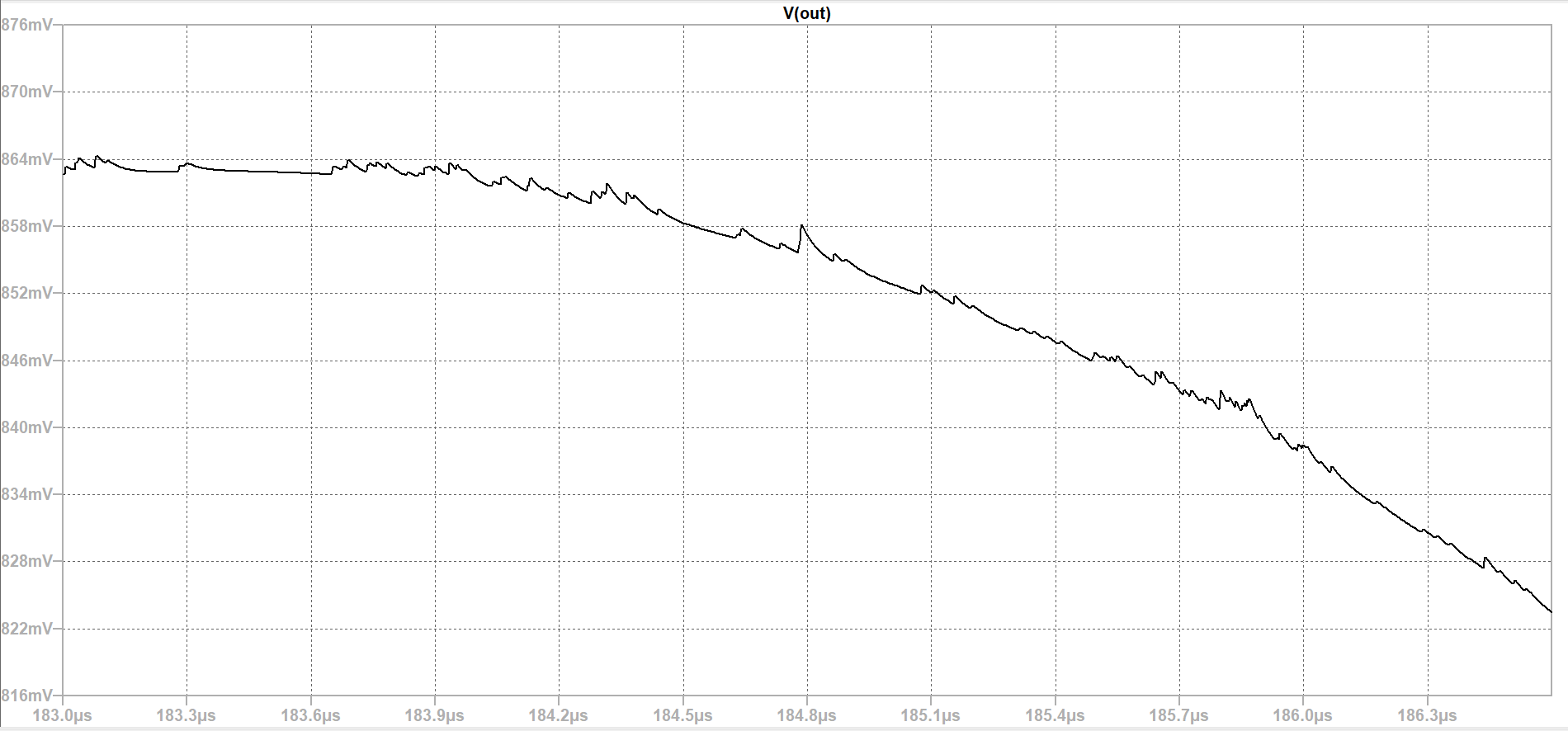

I've been looking into this. Using the attached VersionA.asc, in which both capacitors have been changed to a value of 1, the glitches certainly appear at 12kHz, see Fig1.png. At first sight the glitches do not appear at 10kHz or 15kHz, but in fact if you zoom in it is possible to see that the waveforms are pretty rough, see Fig2.png, (15kHz zoomed in).
Things improve if either C1 or C2 is made 1uF, but zooming in still shows anomalies - look at the currents in the capacitors.
Having experimented with "longhand" versions, "automatic" versions, and various time steps and capacitor values, I think the reason for the glitches is that we are asking too much from the maths engine of LTspice. If the parameter fft is reduced from 2**18 to 2**12, everything snaps into place - the glitches at 12kHz disappear, and the FFT plot looks fine. See VersionB.asc. Because the time step is now larger (don't forget that parameter fft is in the denominator of the time step) the simulation runs much more quickly, too.
Because increasing the value of parameter fft decreases the maximum time step, one would expect that larger values of fft would increase the resolution and accuracy of LTspice. However, there is clearly a limit to how far we can push the programme.
And to answer your question: why are the glitches worse at 12kHz that at 10kHz? I think the answer may lie in the fact that 1/12k is an irrational number. So when we define the start time and stop time in terms of the frequency, they too are irrational numbers. Compare this to 10kHz, when a start time of (say) 2/10000 becomes almost trivial. It seems LTspice can work more cleanly with, for example, a start time of 0.0002 than it can with 1.6666666666666666666666666666667e-4.

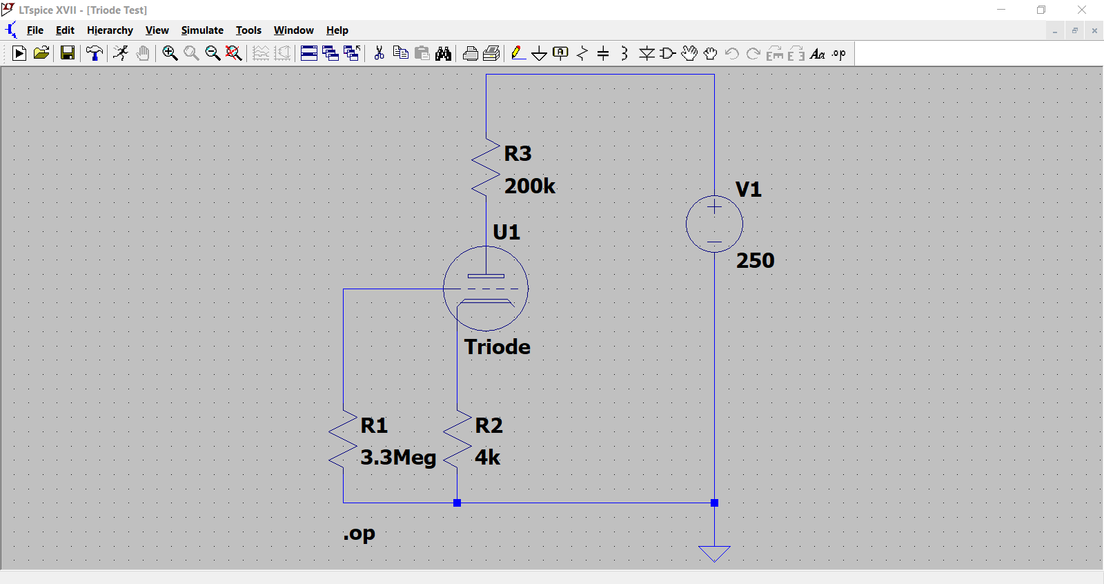

Lets start with a sim called 'Triode Test'.
LT already includes symbols for triodes and pentodes and tetrodes and so lets place the triode symbol on the workspace. They are found under [Misc] in the component selector.
Now what... lets take a really simple circuit and I'm having to think valve now and not solid state 😉. This looks in the right ballpark value wise. I'm making it up as I go along.
Lets set a .op command and run it... and of course it reports an error because the triode is just a symbol with nothing attached to it to specify how it behaves.

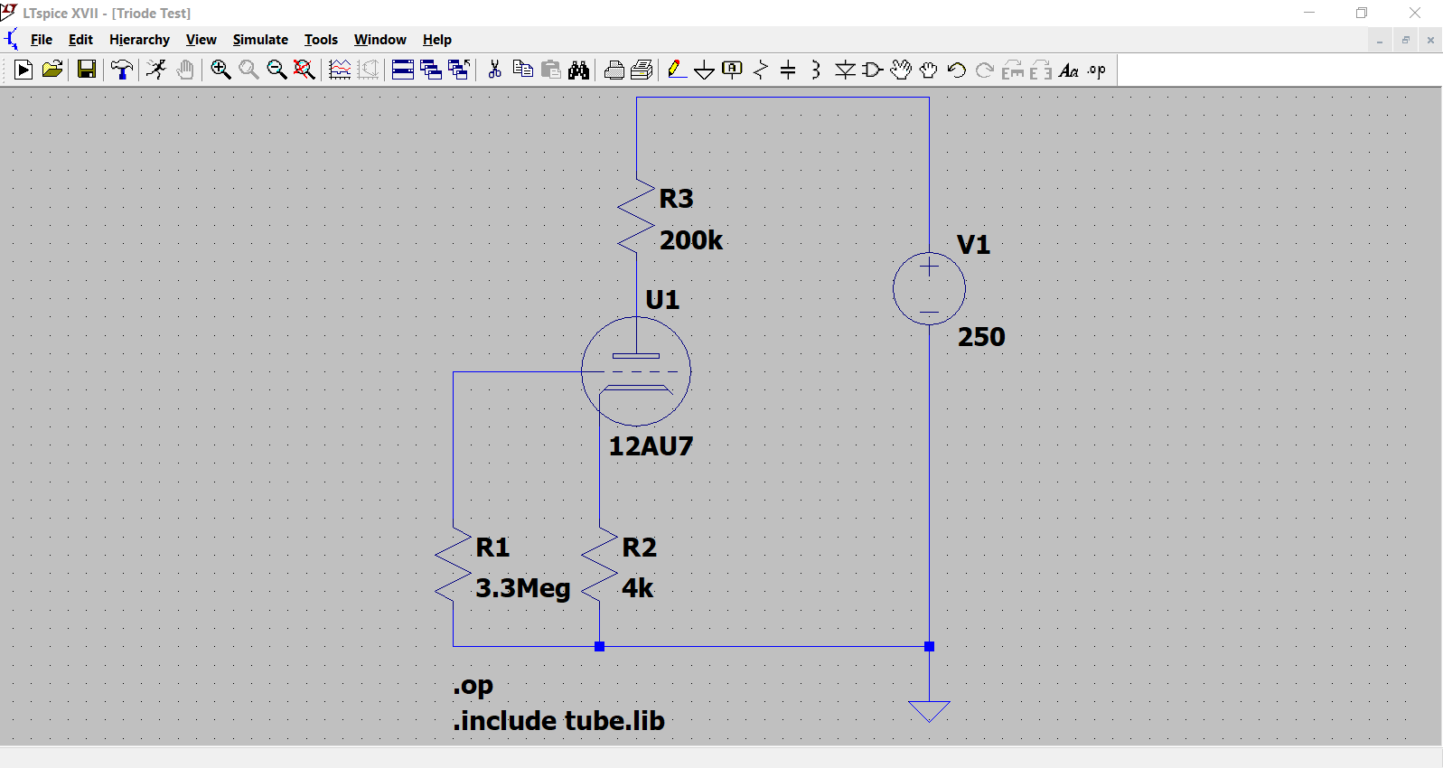

Now add the directive 'include tube.lib to the simulation.
Now we pick a triode to test... 12AU7 maybe... and see what happens.
All looks good, the sim runs and the DC conditions look about right.

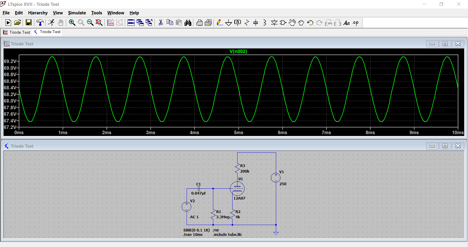

Lets try an AC sim and add a signal source. How 😎 is that, it works. I just made a valve amp.
LTSpice Triode "Unknown subcircuit"

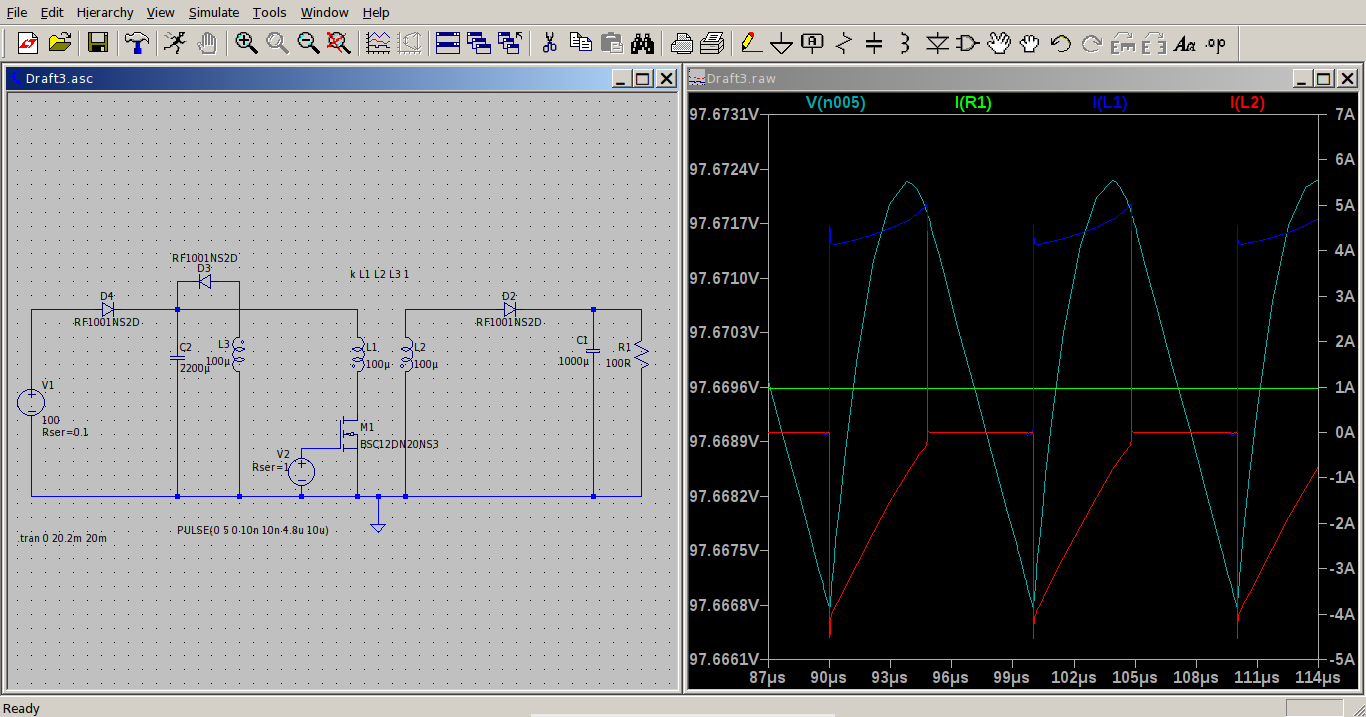

I am 'trying' to simulate a very basic switching power supply without regulation. The attached image is what I am getting. I am also attaching the .asc schematic. Please, note the schematic is not a real power supply, but a ficticious one.
I am posting for possible suggestions.
V(n005) is the voltage across the 100R resistor.
Ed,
Did you choose the L2 dot orientation on purpose? It looks like a flyback at first glance but L2 would have to be reversed.
If you do that you get what you would expect with a 1:1:1 transformer driven with a 50% duty cycle: Vout = approx Vin.

I chose the configuration on purchase. This is a forward 'converter' without active voltage regulation.tommost said:Ed,

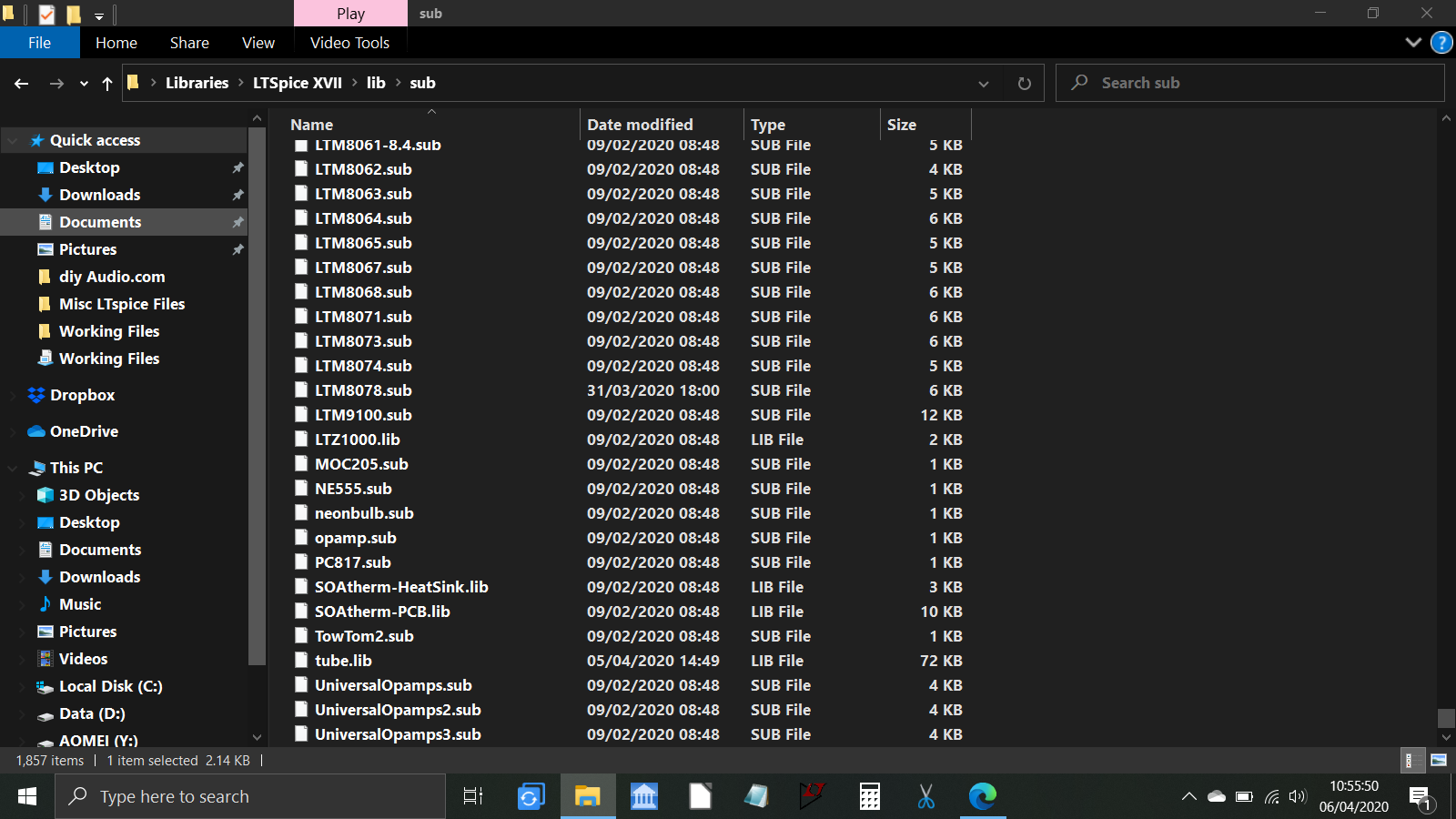

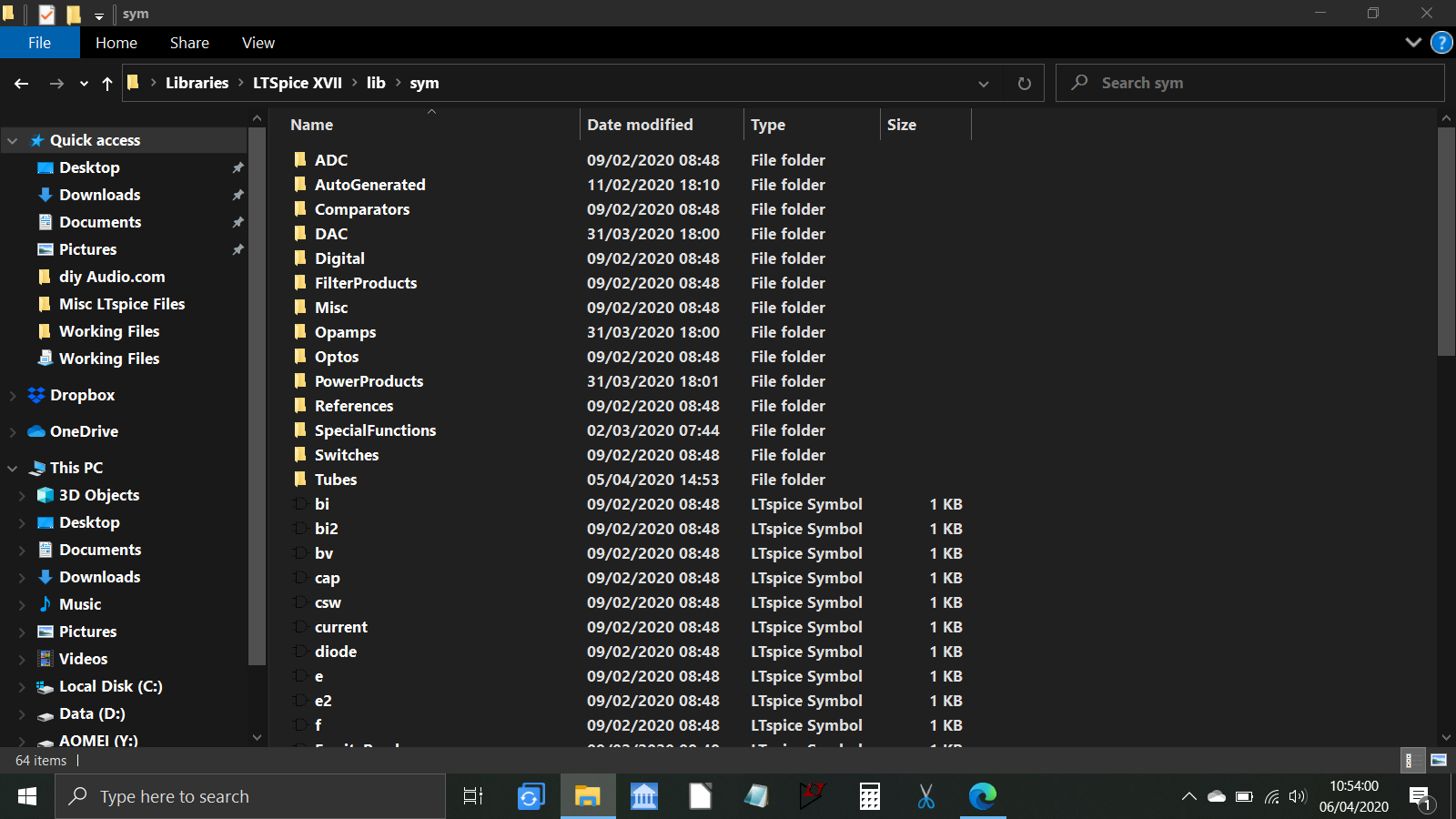

OK, so then...
1/ The extracted folder marked Tube_sim contains a single folder called 'Tubes'. You stop at that point and right click and copy 'Tubes'. Don't open it any further to the individual files.
2/ Now navigate to Documents and locate the LTspice folder.
3/ Click the 'lib' folder to open it.
4/ Click the 'sym' folder to open it.
5/ Right click a blank spot and paste 'Tubes' into that 'sym' folder.
That is that one done.
It should look like this (attached images)
6/ Now click the extracted Tube_Lib folder and you should find a single file within.
7/ Right click that file and copy it.
8/ Navigate to Documents and LTspice again.
9/ Again navigate to 'lib' and open it.
10/ Click 'sub' to open it.
11/ Paste the .lib file into the folder. See attached image.
All done 🙂
Now (optional).
1/ Go to the original extracted .lib file in your Downloads folder and right click it and rename it to tube.txt
In other words you are changing the extension to .txt
You will get a warning that the file will become unusable but it doesn't matter because you have already pasted the correct version into place.
Now if you click the renamed .txt file you will see all it contains.
In fact I'll attach the .txt file here and then you can see it anyway.
Nope. I followed your instructions to the letter, and no luck. Your screen-grabs are exactly what I was seeing. I'll head back to Windows 10 and try it again there. At least, I saw the magic word "Tubes" in the component selector, and successfully added one to the schematic. So now that I have the definitive set of instructions, I'll get it right by hook or by crook.OK, so then...
OK, it's working now in Windows 10. So, I have a problem with my Windows 7. 10 is behaving at the moment, so I'll plough on. Thanks for all that.Nope.
