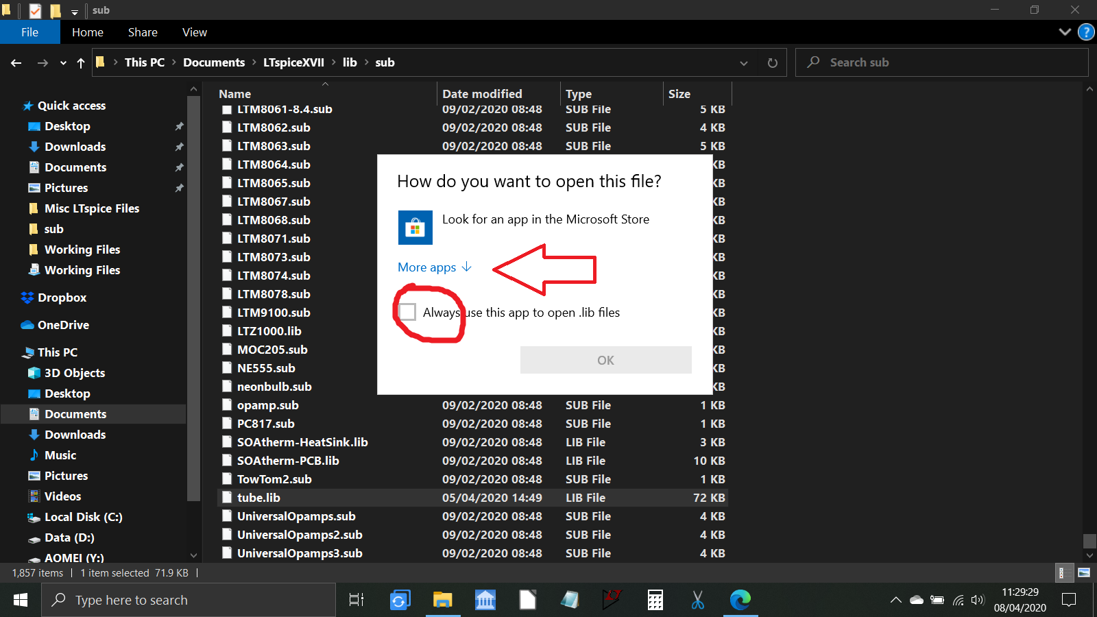

That's something I've never done but I would guess... all untried, but this is how I would begin.
Go to the LT folder and find the tube.lib file you pasted at the beginning of all this.
1/ Right click the file and select 'Open With'
2. UNTICK the box marked always use this app to open .lib
3/ Then click 'More apps' which I have arrowed and scroll down and select 'Notepad' and OK.
That will open the file.
4/ Look at the structure and how models are separated.
5/ Paste your lines of new code in at the end maintaining the same kind of structure.
6/ Save the file using 'File' up at the top left corner and then close it.
Check that the file is still a .lib when you look. This is why unticking that box was important.

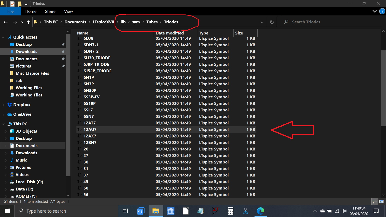

7 Now look at the folder you pasted into the Sym folder that contains the models.
I would guess that as long as the models used conform to the same pinouts then you could resave a model file as a new name (valve number) that exactly matches how it appears in the text file of models. If you click a model it will open in LT. You can then save it by giving it a new name and specifying the correct location (which is where it is now)
I'd have to do all this for real but that would be my first guess how to do it.

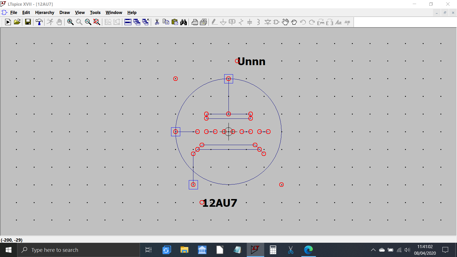

By 'models' above in the last paragraph I mean the symbols of the models that are in the SYM folder under Tubes.
So I open a symbol for a triode I know and I would think you could then resave that symbol with a new name to match your text model file. Same for other varieties such as diodes and pentodes. Pick a similar outline and resave it in the correct folder with an appropriate name match to the model.
But... I would need test all this for real 😀

That worked perfectly, thanks. I edited the valve name part of the character string immediately following ".subckt" in the "tube.lib" file to read "Ayumi6SN7". I then copied out the existing 6SN7 ".asy" symbol file onto the desktop and renamed it "Ayumi6SN7", and plonked it into the same folder. So the Ayumi version of the 6SN7 is unambiguously invoked when I need it.
And - I went one further. To my surprise, .asy files open in LTSpice's symbol editor, and with that, I was able to change the name string to AY6SN7 for further affirmation of the correct choice of valve. And - and I even increased the text size as it would appear on the simulation, because the original was far too small. Looks like you can do quite a lot in that symbol editor, including making your own symbols. I hope I got everything right in this long-winded explanation.
