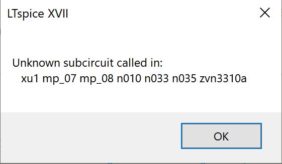

Thanks Ray,
I dropped your symbol in the sym folder and found it in the Components area, added it into the circuit and changed the "value " to ZVN3310A
I also added the zvn3310 model ".sub file" into the "sub" folder.
But when I ran it it did not work and reported: "unknown subcircuit called in . . . . ( see attachment )
So then as the model says :
SUBCKT ZVN3310A 3 4 5
* NODES: DRAIN GATE SOURCE
I opened up the symbol and renumbered the pins:
Drain 3 Gate 4 Source 5
But this still gave the same error message
What am I doing wrong ?
p.s. I have also tried pasting the entire subckt into the circuit and tried adding A SPICE DIRECTIVE ".SUBCKT ZVN3310A" without success . . . and also tried using ".inc ZVN3310a.mod" as Mooly mentions but with this method I could not find where I have to place the actual model so that the directive can find the it.
I just tried this model in one of my own circuits, in place of the NMOS device I used originally, and the simulation ran OK. Can you post your .asc file so that we can take a look? That may help us spot what might be wrong. One thing to check is the complete file name for the subcircuit file. You mentioned that it has a .sub extension; if so, using ".inc ZVN3310a.mod" will give an error. Try ".inc ZVN3310a.sub" instead.

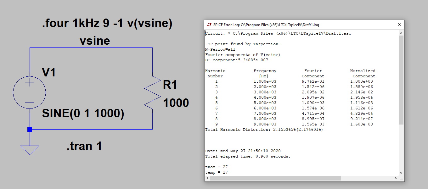

unknown source of distortion
Not sure this problem was already discussed here, but I just found a pretty curious bug, please check attached circuit which is an ideal source into an ideal resistor, giving me 2.1% harmonic distortion.....
what am I missing here, any ideas? This is puzzling me to say the least, many thanks in advance!
If I were you I would explore the use of a small number of periods in the analysis, rather than 1000 periods. Which is what your "-1" does when you run 1 second of 1 kHz sinewaves.
I would also explore the creative use of ".OPTIONS" commands, and discover whether some of them are beneficial or detrimental in this case.
