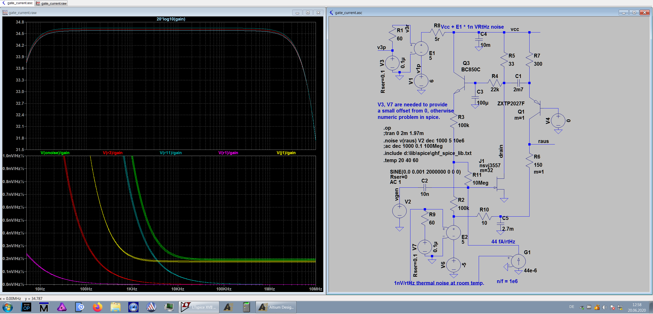

You can make it this way, a circuit I just happen to have on the screen.
On the left side, lower half:
green is the noise performance overall, scaled to the input.
blue is the influence of the gate resistor, it is horrible. That would go
away when we increase the input capacitor from 10n to 10u. Then the
noise voltage of R11 would be shorted for 3 more decades through the
low impedance DUT. Note that we do not need a larger capacitor for
bandwidth reasons. It is really bad for the settling time.
yellow is the contribution of the 32 parallel FETs.
purple is the influence of voltage noise on VCC. R1 = 60 Ohm generates
1nV/rtHz. The 0.1uV dc offset avoids a divide by 0 disaster in Spice or
sth. like that. the voltage controlled voltage source scales that to 5nV/rtHz
and that is added to the otherwise clean Vcc. When we remove the 10 mF
capacitor C, we can see that 5nV/rt Hz do matter.
The same is done to Vee, there the noise has less influence.
G1 scales the 1nV/rt Hz of the Vee noise generator to 44 fA to simulate
a noise current from the JFET gate.
There are always 3 traces because of the 3 temperatures.

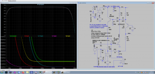

Does anybody here know how to fix the nV/rt Hz scale to the values chosen?
I'm sick of undoing the auto scale after each simulation.
cheers, Gerhard

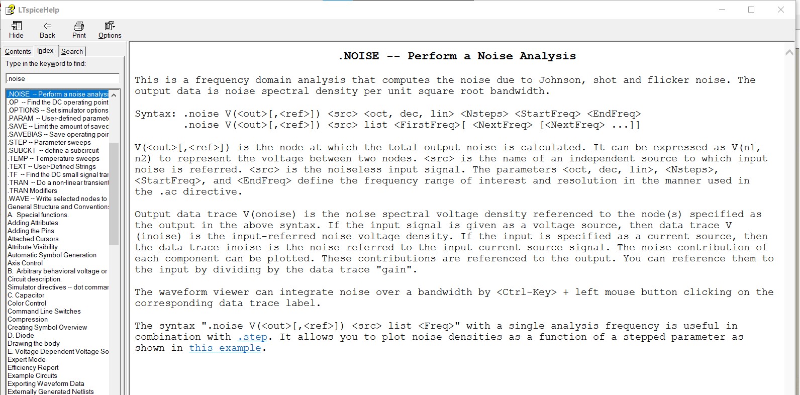

Actually my question was to the method to measure noise in LTspice ...
I now understand that you can click on a part and the noise contribution to that part is shown, right?
So what is then the purpose of the .noise command, what does that do? Like .noise V(bout) V3 oct 25 100 100k where bout is a circuit node?

Ahem ... I did now, and I think I got it.
What the Help doesn't discuss is that you can plot a part's noise contribution by clicking on it.
(It says you can do it but not how). I guess that is then output-referred, unless divided by gain?

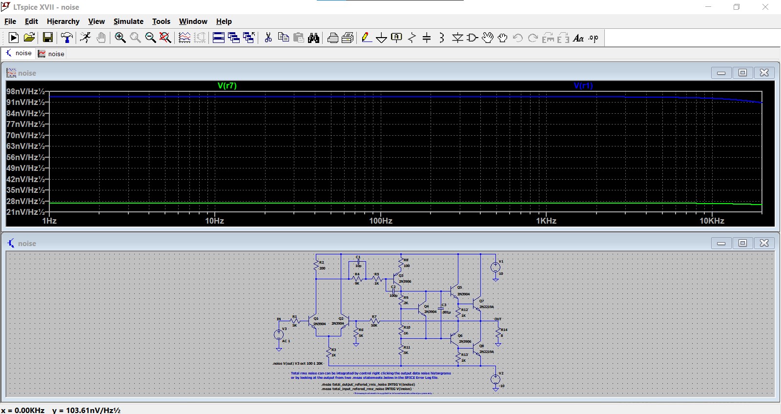

I really don't know on that one Jan. The example seems to have all the resistors 'clickable' in that a noise plot comes up for them all but I'm not sure how its interpreted because the 50k feedback resistor comes back as 27nV/Hz vs 94 for the 5k.
The files say it is referenced to the output... that'll keep you busy 😉

IME when you click on a part its that parts contribution to the total noise. In some cases it may not be clear but for a feedback network the lower resistance will contribute more because the feedback resistors contribution is reduced by the attenuation. You can scale that back to the input like Gerhard has (nice trick). You pretty quickly determine which parts are not significant. You do need good models that will show real noise contribution. Not all opamp models are good (surprise).
That makes sense. The reason I got into this is I have a circuit with a JFET with a large drain load resistor >50k which dominates the noise, and I want to see how that changes when I replace that resistor with a CCS (~0.6mA).

After having your sim completed and adjusted the scales in your image, click on the Image, then click "Plot Setting" in the command line, click on "Save Plot Settings" with the proposed name or with your own selected name and finish by clicking on "Save".Does anybody here know how to fix the nV/rt Hz scale to the values chosen?
cheers, Gerhard
Next time you run a sim, click on the image, click "Plot Settings" and "Reload Plot Settings", and there you are with all the scales adjusted as in the previous image that you saved.
