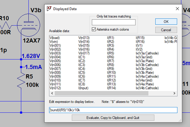

Try this to place the current or voltage value next to a component on the schematic:
Right click on the schemetic, go draft, then .op data label.
Place the field next to the component on the schematic.
Right click on the field and then select the component eg I(R1) or V(R1) from the list and make sure to delete the $ from the field.

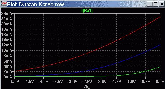

I'm looking for an asc file that will allow me to plot curves from tube models. Does anyone know where to find one?
Thanks, Marty

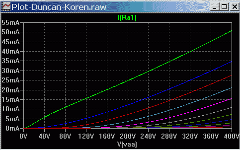

I have used this one to compare the Duncan and Koren triode models.
It's set to plot Koren ECC81 (a.k.a 12AT7). Click I(Ra2) for Duncan NH12AT7 plot (eg to compare the models). V1 can trim slight grid differences between two models due to different data sets. Click with the cursor over the grid to plot grid current.
Enter different model names as required. Notice the .Step param Vg List ... is set up and selected to suit the tubes Vg range (eg as per datasheet).
To plot Ia vs Vg stepping Va see the second demo for the changes.
Adding d(I(Ra1)) can plot transconductance.
Add more subcircuits as required.
Thanks, I've been looking for a way to find the derivatives, didn't know it's built-in.
