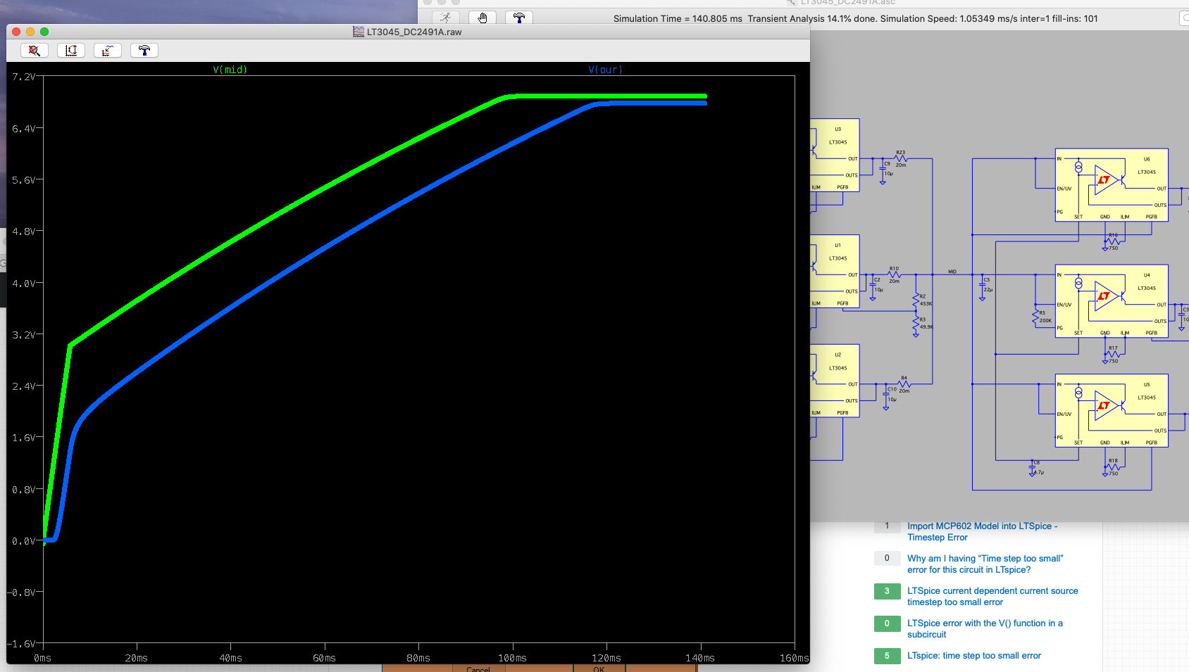

For any OSX beginners - LTSPice will use up to 12 threads for simulation. Running a small time step multiple regulator model is using ~890% CPU on a 2018 Mac mini 6 core (+HT so let's call that 12 cores)! The Process application only seems to take about 182MB out of 32GB (it gets used for AI and quantum MCMC simulation).

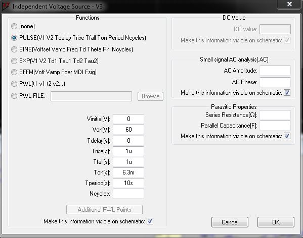

I am busy with a hotstart and antistick schematic simulation, however I need to start without load and after 1 second or such the load need to connect. It is a resistor who does simulate the electrode, a inverter does start always with open loop voltage and as such need to do that also in ltspice.
Without that I can not sim because it does not load the timer circuit cap.
Maybe a voltage source is usable in seconds setup, who does give 60 volts for 1 second and stops, that works also.

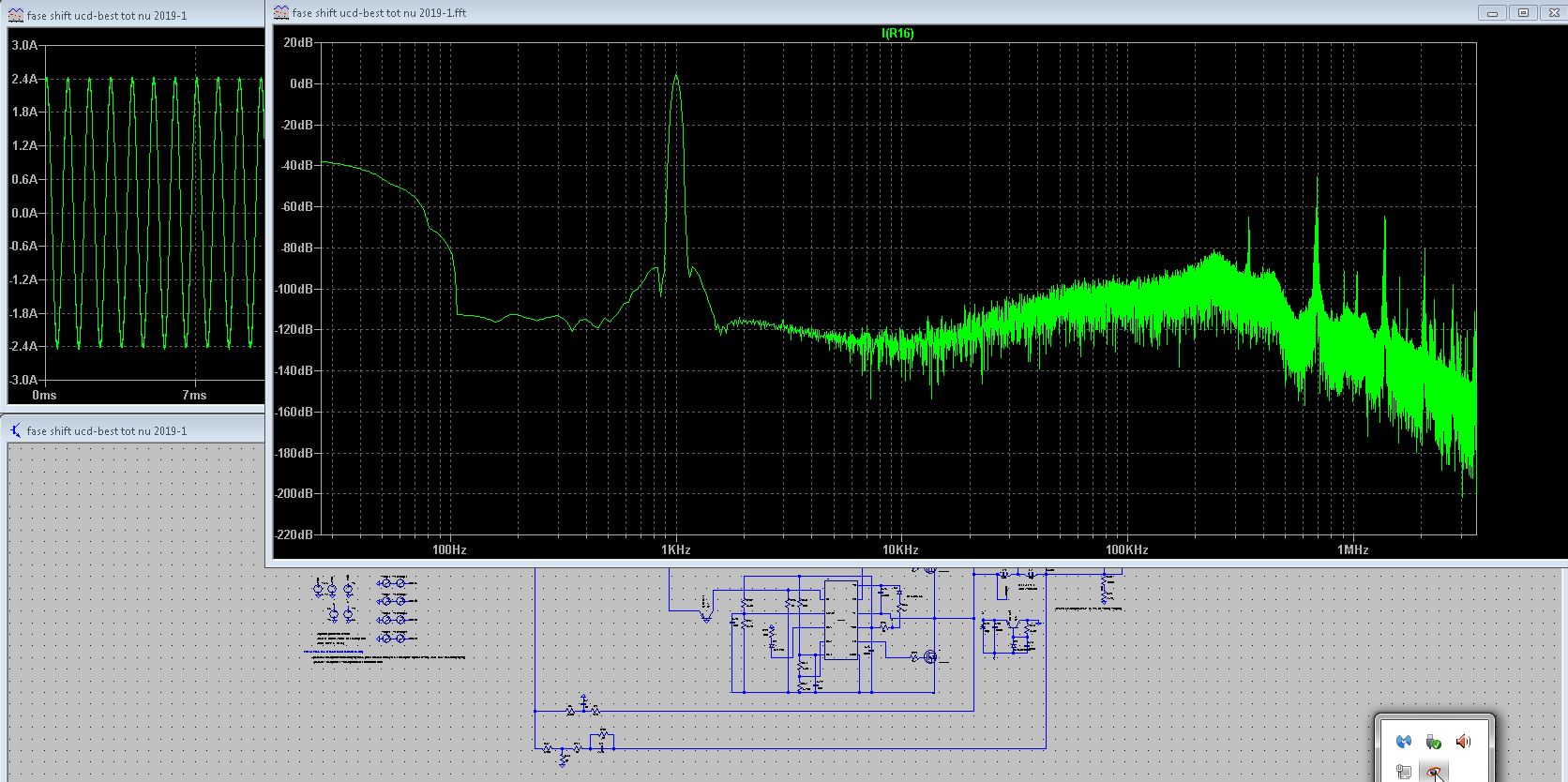

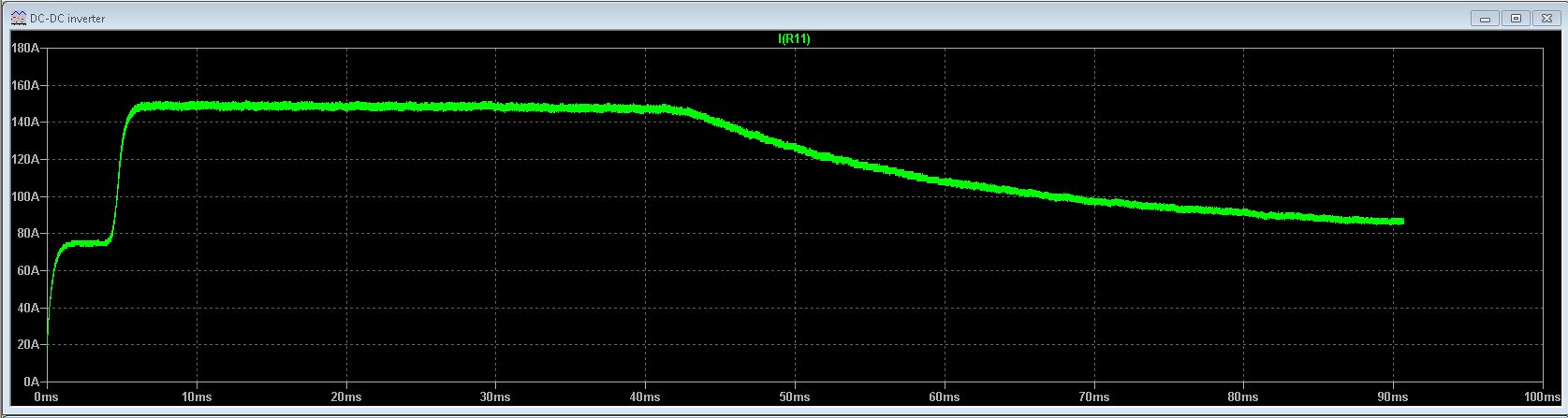

I have done it this way, a voltage source as pulse and set it on some seconds, or what I did now 6.3 seconds.
on pic two I see that is what I want a hotstart for the welding inverter I have, now I can go built it into the machine. Do forget the first 10 mS because thisd happen only in si,
real world start always with loaded capacitor 330u because of open output if I not weld..
This way it works fine, Thanks for the help.

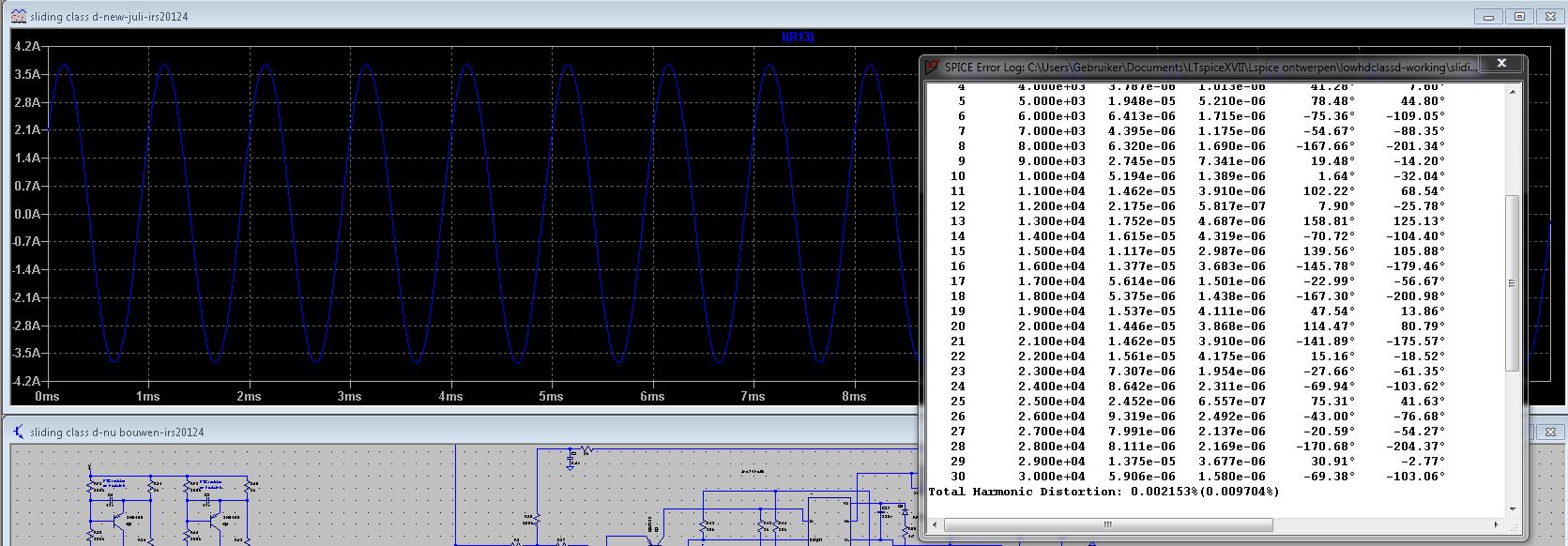

Hi all
I have get the question about distortion of the amplifier, and then special the second between brackets figures, Someone say that is because of the higher harmonic content, like the switching frequentie present.
Is there a way to do it better and then let it stop around 100Khz or such so that the switching harmonics getting out of the simulation, that way I think it will be better to manage.
If someone now, I like to hear.
Thanks in advance.

Is there a way to do it better and then let it stop around 100Khz or such so that the switching harmonics getting out of the simulation...
Kees
Look at the structure of the .four command in the LTspice help file.
You can control the bandwidth of the measurement by stipulating the number of harmonics in the .four command. For example, if the frequency of the applied sine wave is 1kHz, and you want to measure THD up to 100kHz, then your command might be:
.four 1kHz 100 I(R12)
the number 100 stipulating that the calculation should be based on the first 100 harmonics. (Normally this would be 8-10 harmonics.)
It helps to get accurate results by forcing the Fourier analysis to be performed over a number of cycles greater than the default one cycle. Additionally, as long the simulation is performed over an exact number of cycles, then stipulating -1 as the number of cycles is a good idea, as it forces LTspice to perform the analysis over the entire simulation data range.
The command would now be:
.four 1kHz 100 -1 I(R12)
I've incorporated these improvements into the circuit we had discussed in the Class D Design Issues thread and reposted it here. The THD at 1kHz calculated with a bandwidth of 100kHz is around the 0.1% mark.

Copy that. You have set to 100 harmonics? does stay that below the 100 Khz bandwidth? because I need only HD measurement below the swiching harmonics that is maybe the best not higher then 50 Khz. I have also multilevel class D who goes to 1.8 Mhz carrier.
The way you use LT spice is professional, I am unfortanely not that educated there, I use the slow approach most of the time, but I do use yours to see what to learn, what is done with dead time? because there is crossover between de transitions of the three level.
Thanks for your help..
I try to simulate a LM6172 but no single opamp out of that bibliotheek will work I get defcon error (no not a atomic attack) then timestep to small. I did afery setup to try but not one does work.
The distortion simulation now work oke see pic..
Hi Kees. The point about setting .four to operate with 100 harmonics is simply that the frequency of the 100th harmonic, with a 1 kHz fundamental, is 100 kHz, and you had asked how to do a Fourier analysis with a B/W of 100 kHz.
If you want a B/W of 50 kHz and your test frequency is 1 kHz, then clearly you should set the analysis to cover 50 harmonics.
I did also see I use current I measure on output, is Volt not better to do?.
A Fourier analysis of the voltage is certainly the usual way to do it. I had done it with current through the load because your original circuit did this and I assumed there was a reason for your doing it this way.
I've attached your file again with an additional Fourier analysis of the voltage across the load. Note that the current and voltage waveforms are exactly in phase, and that the results of the two .four analyses are identical, which is exactly what one would expect with a resistive load.
As an aside, it is interesting to see what happens if one substitutes a loudspeaker equivalent circuit for the resistive load in the simulation, and I have done this in the zipped folder. The two analyses now have different results, the current and voltage waveforms are not aligned in time, and the question arises: which result more accurately reflects what we actually hear?
The results are: THD_voltage = 0.068%; THD_current = 0.26%.
