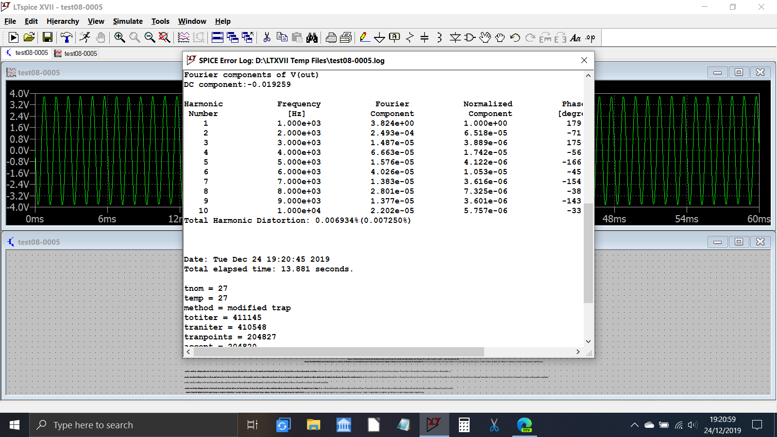

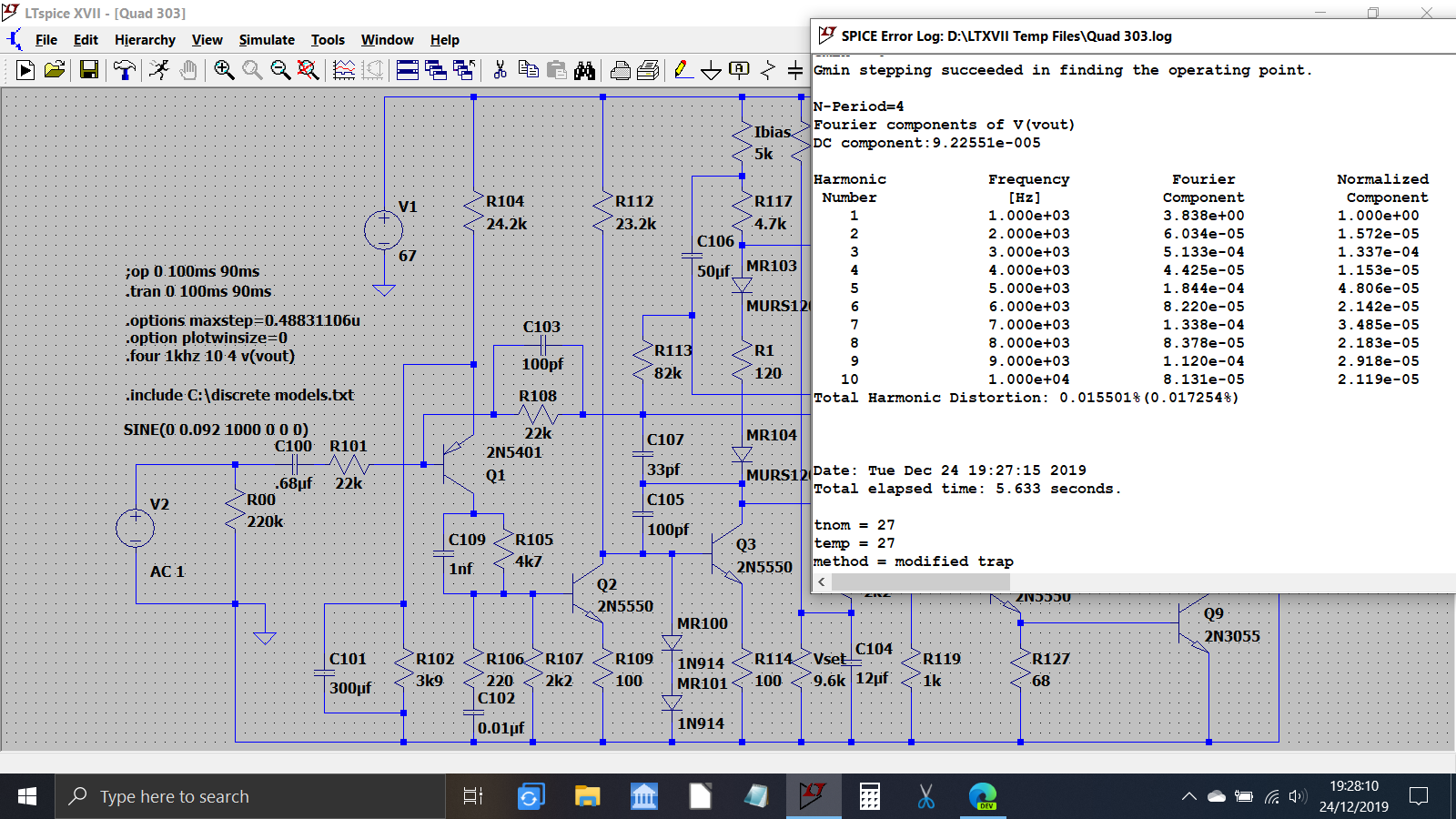

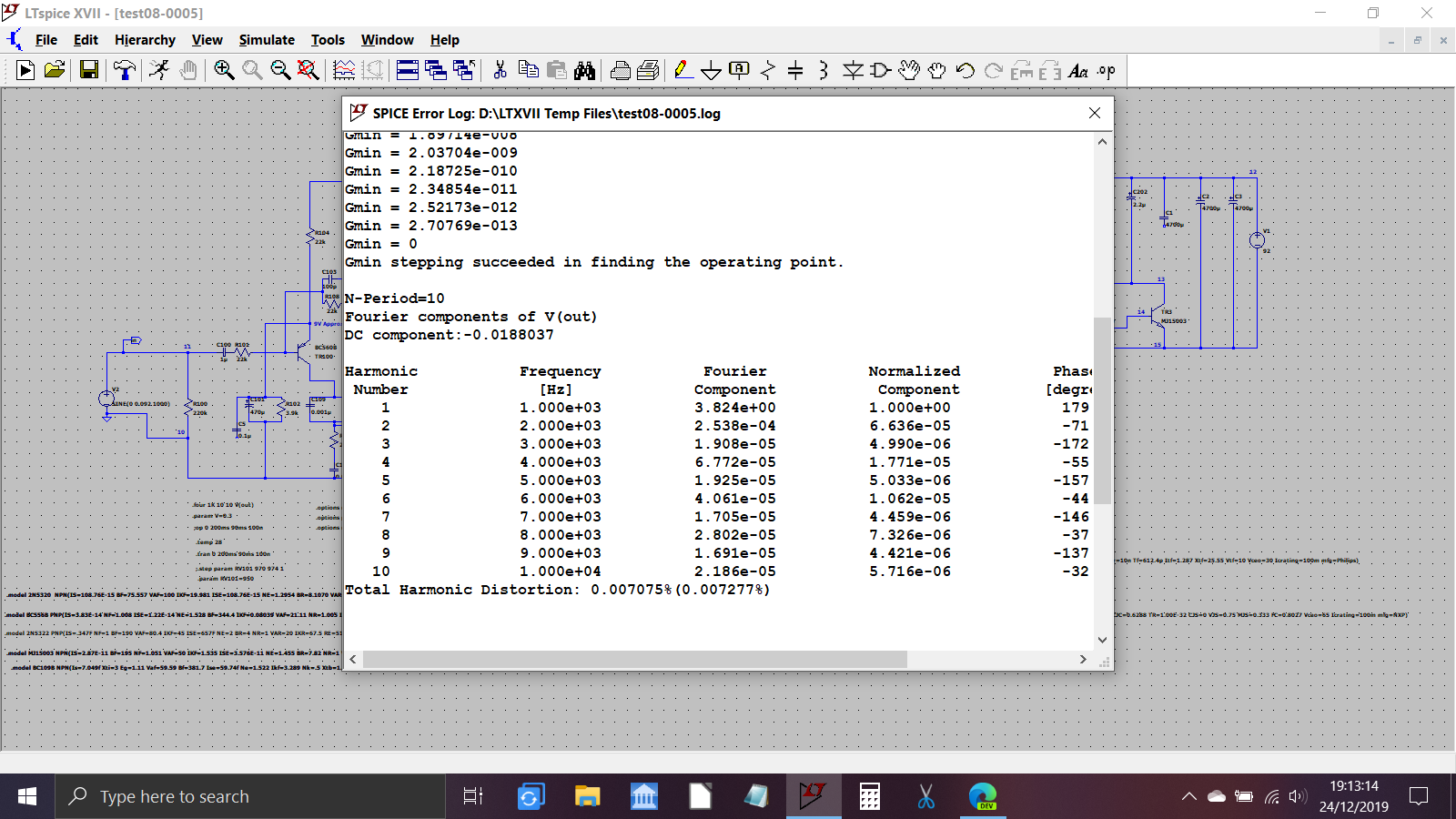

I haven't got some of those models so can't check this exactly, however I would see what quiescent bias current you are running the sim at. If it is high then you are in Class A.
You also have a couple of errors. That 2.2 ohm in the ground means the output stage is seeing that resistance in series with it because you have ground referenced the input as the sims reference point.
You have missed the u (micro) off the step time .options maxstep=0.488331106 although you are actually running 10ns in the options window.
My error on the 2.2
I'm getting consistent distortion results for your sim but the figures are very low. I've run the sim lots of different ways and the results are similar. The difference between first and second image is down to me removing the .temp directive and the bias altering slightly.
My 303 sim has distortion much higher but I can see differences in your circuit and mine... you would have to go through them in detail. For example C107 in yours is 3.3pF, in mine it is 33pF.
I can't see anything obvious though without spending lots of time on it
You mean to match it with a real 303? That could be difficult because the sim is 'perfect' with regard to layout and so on.
The challenge is making a real build come close to the sim.

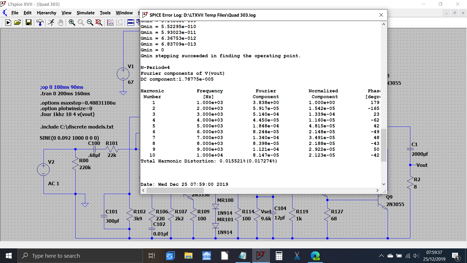

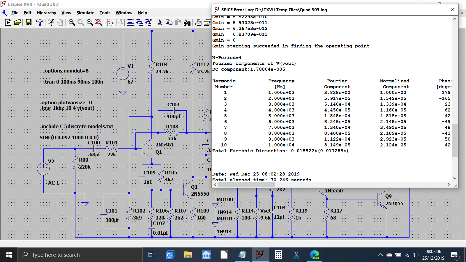

Edit... comparison of my sim using your FFT settings and then using my preferred settings. The last digit is different by '1' but the big difference is how slow the 10ns timestep and double digit precision you use makes your sim run.

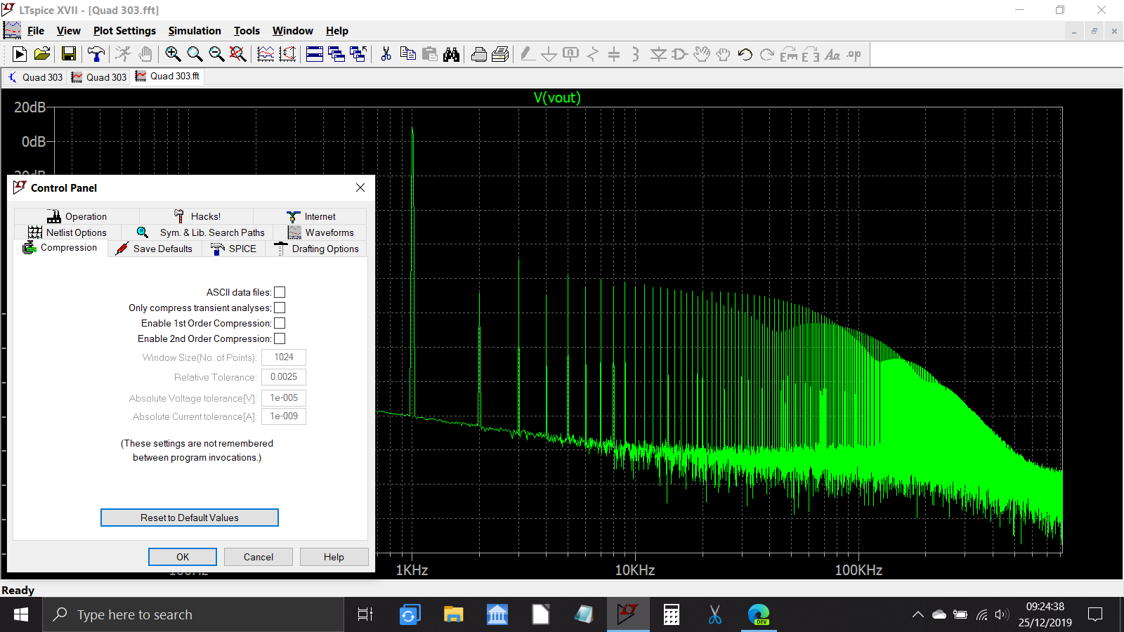

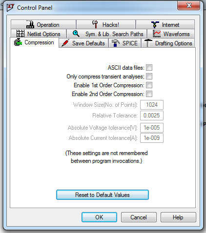

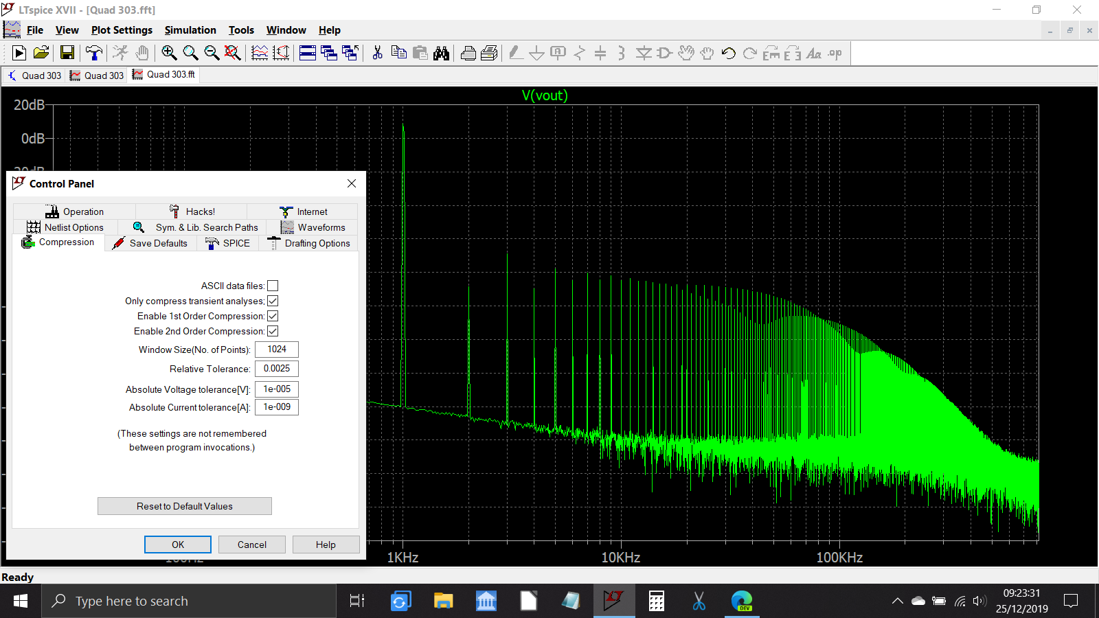

you will get better result if you uncheck on the Control panel TAB COMPRESSION all boxes as the picture.....all the best
Better in what way? I just tried the FFT with and without those options checked and there is no apparent difference. If the plots are compared side by side they look the same.
I just use this 10n step size to get a higher resolution FFT graph of Vout.

Not just component parasitics, the big performance killer is all the interactions on the PCB due to print resistance/inductance/capacitance which causes lots of tiny interactions, particularly current flows in print and wiring creating signal related volt drops that then degrade the performance.

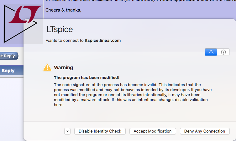

For the past few years LTspice updates on my Macbook Pro failed but not being a big user, I just carried on with what I had. Last night while in the window for other reasons, I hit update , just in case. It was apparently able to do the model update (8000 files were downloaded) but then part way into the following software update I got the attached warning.
Checking "About LTspice" it seems that model update has already changed the version to XVII , dated Nov 7 ,2019.
The need to heed warnings like these or not seems to depend on the site. I'm wondering what others here would advise.

That is a message we don't see in Windows, however in Windows launching an update check does request Administrator privileges... as if to say beware, this program is being modified and it's up to you to accept the risk.
Your options look like you can accept on a one off basis or perhaps set to always override from the dropdown.
Edit... I seem to remember LTIV left it up to the user to always remember to run the program with elevated privileges before updating. If you didn't it would fail. LTXVII now automatically closes LT and reopens it in Admin mode (after asking first).

Yes , you're right about the Edit . . .
Thanks for the reassurance. I allowed it to run but as often happens with these things (in my world anyway) it turns out it had already gone ahead and installed it without the OK.
One thing about the software is that there doesn't seem to be a version check before downloading the update. I tested this by hitting "software update" after it had already shown to be installed. It went through the entire download process. Just to be sure, I tried it again and same thing. I guess once you're that big, wasted bandwidth is not a concern.
