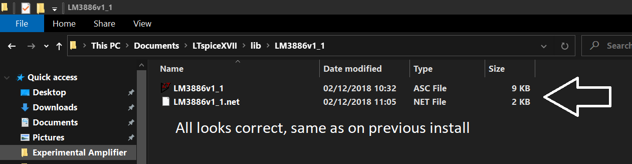

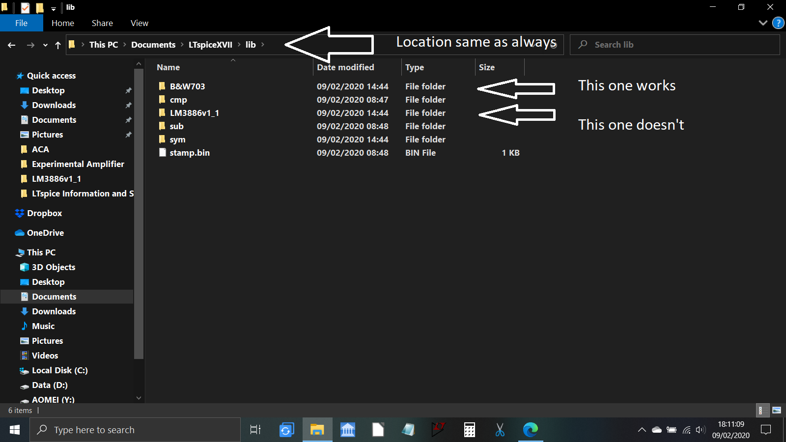

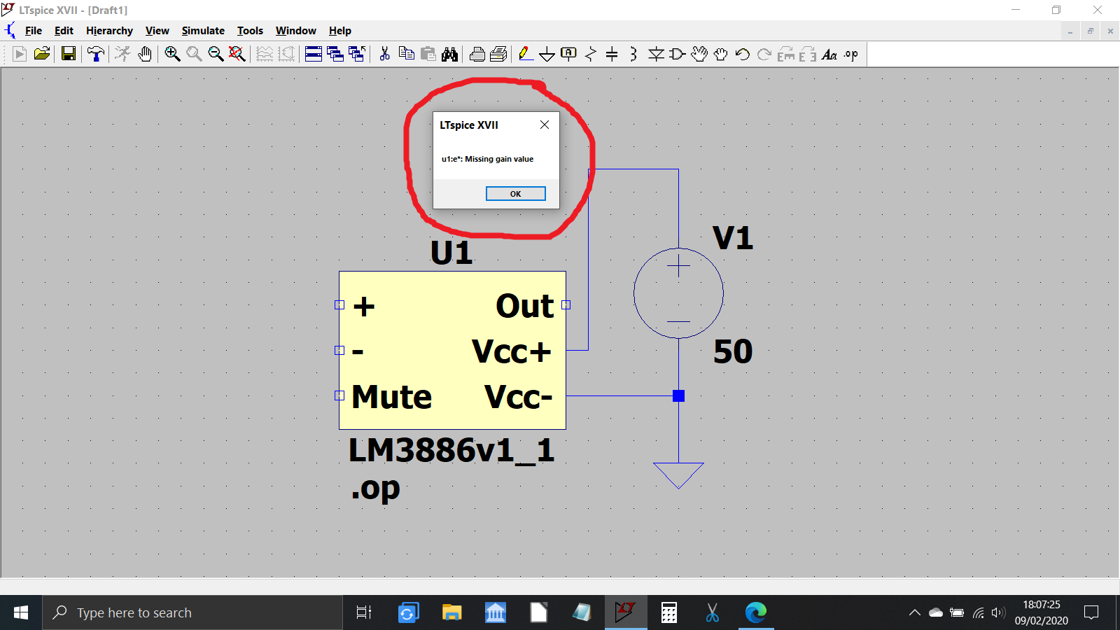

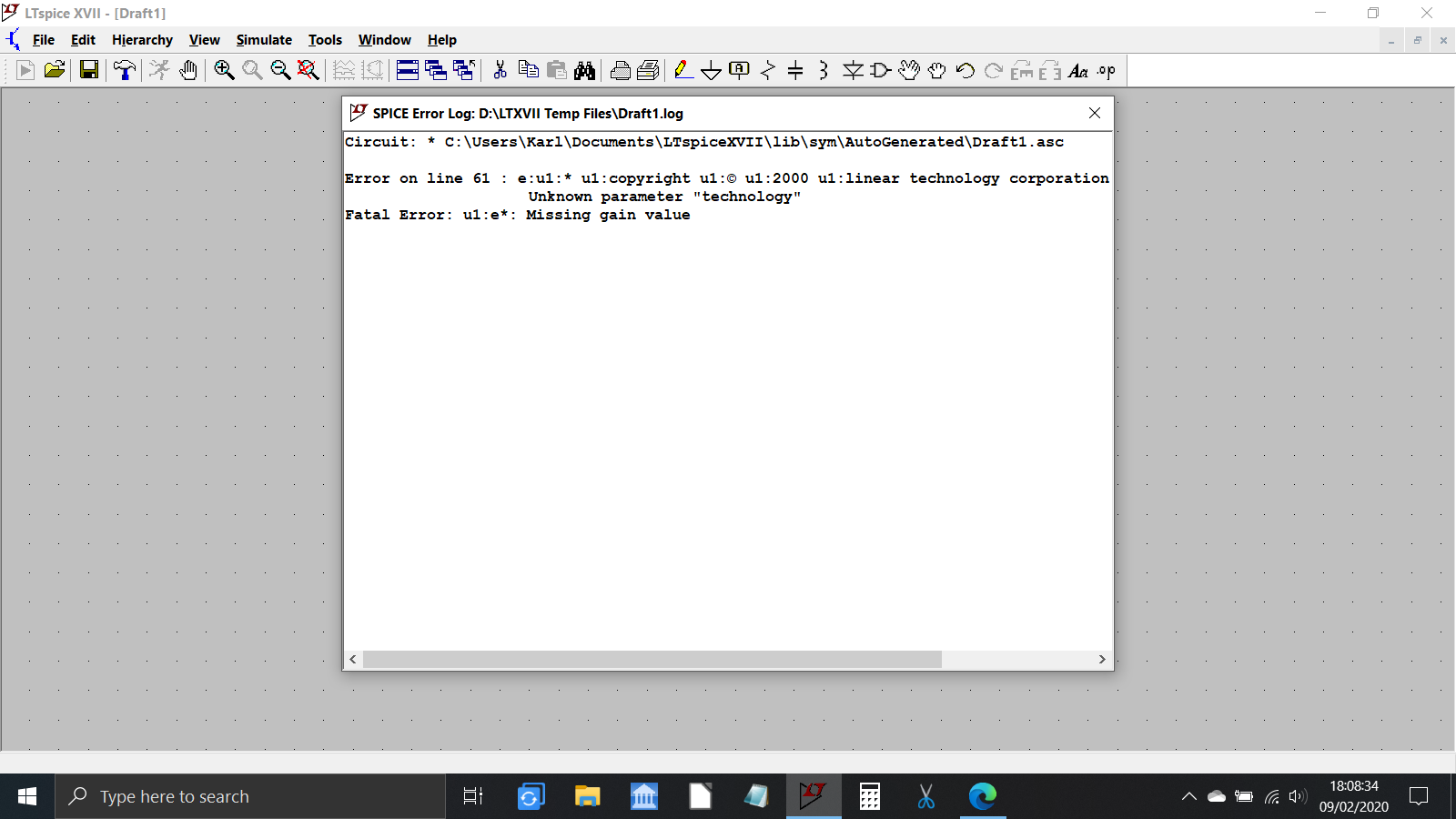

I've run into a problem transferring a model over and onto a clean install of LT. I can't understand what is going wrong as I get the same error coming up each time.
The model is one I put together (for an LM3886) ages ago and it has always worked fine when called upon.

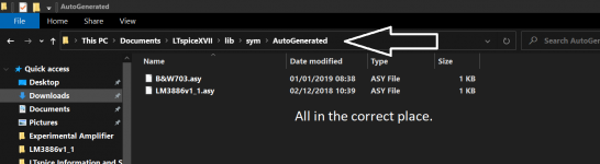

So all I have done is copy the model details from the appropriate folders on the working installation and onto the new. Another speaker model that I created and copied in exactly the same way works perfectly, just not the LM3886. What makes it worse is that I'm sure I've done this before without issue.
The error is always the same and looks like this. It says 'fatal error missing gain'. I've no idea what all the other stuff is.
The model details all look correct and in the correct place and the B&W703 model that I also copied over in the same way works perfectly.

Sure looks like LTSPICE thinks it has found a voltage controlled voltage source (an "E" element) in the netlist. BUT the sixth lexeme on the line, was not a valid entry for the gain of the VCVS
lexeme 1: Ename -- tells LTSPICE this is an E element whose name is name
lexeme 2: nodeOP -- tells LTSPICE the name of the node to which the output (controlled) voltage source's positive terminal is attached
lexeme 3: nodeON -- tells LTSPICE the name of the node to which the output (controlled) voltage source's negative terminal is attached
lexeme 4: nodeCP -- tells LTSPICE the node name of the input (controlling) voltage's positive terminal
lexeme 5: nodeCN -- tells LTSPICE the node name of the input (controlling) voltage's negative terminal
lexeme 6: gain -- tells LTSPICE how much gain you want this element to have. V(nodeOP) - V(nodeON) = gain * [ V(nodeCP) - V(nodeCN) ]

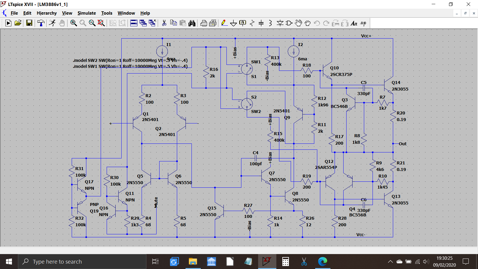

can you share the .asc file for the LM3886? Maybe we'll see something in there???
Here you go... but remember these are simply copied from what was a working installation, I haven't altered anything.
The .asc called 'LM3886v1 plus mute' is a working simulation that the subcircuit was ultimately created from.
The Zipped folders are a copy of he contents of the LM3886v1_1 folder in the earlier post together. The 'Autogenerated' folder contains the .asy files.
Edit... please see post #1851 for details of an error in my base LT model file.

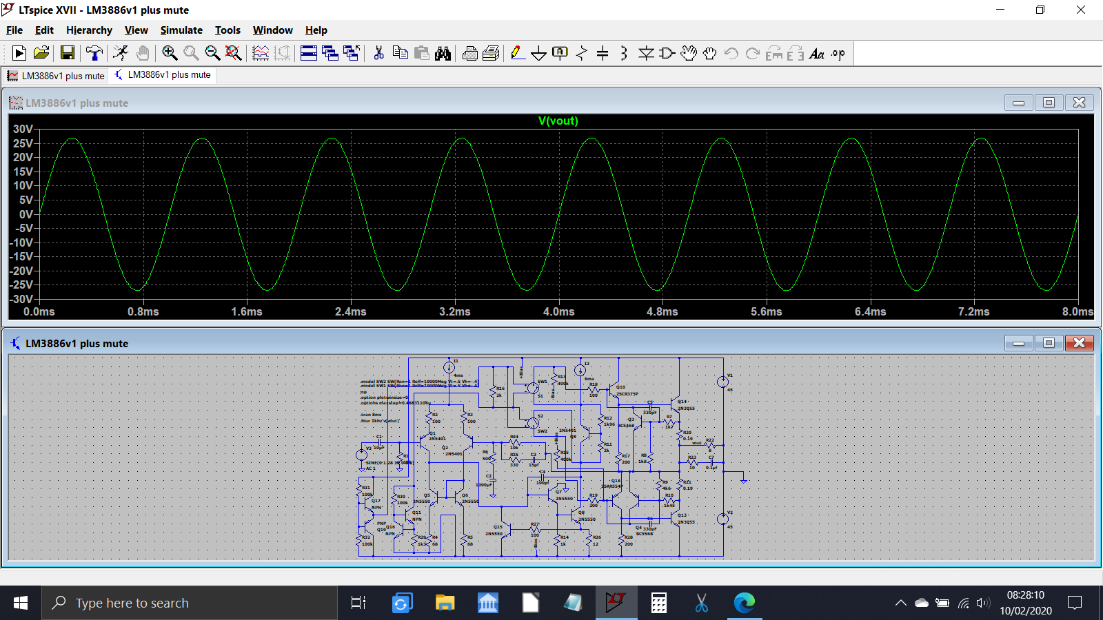

I still haven't figured this out.
This morning I ran the base model of the sim (that works) and is the file labelled LM3886v1 plus mute in the earlier post.
From here I re saved it under a new file name and deleted all the gubbins around it to create a new subcircuit and symbol... and that to gives the same error when I try and use it.
This shows the base circuit does actually work.

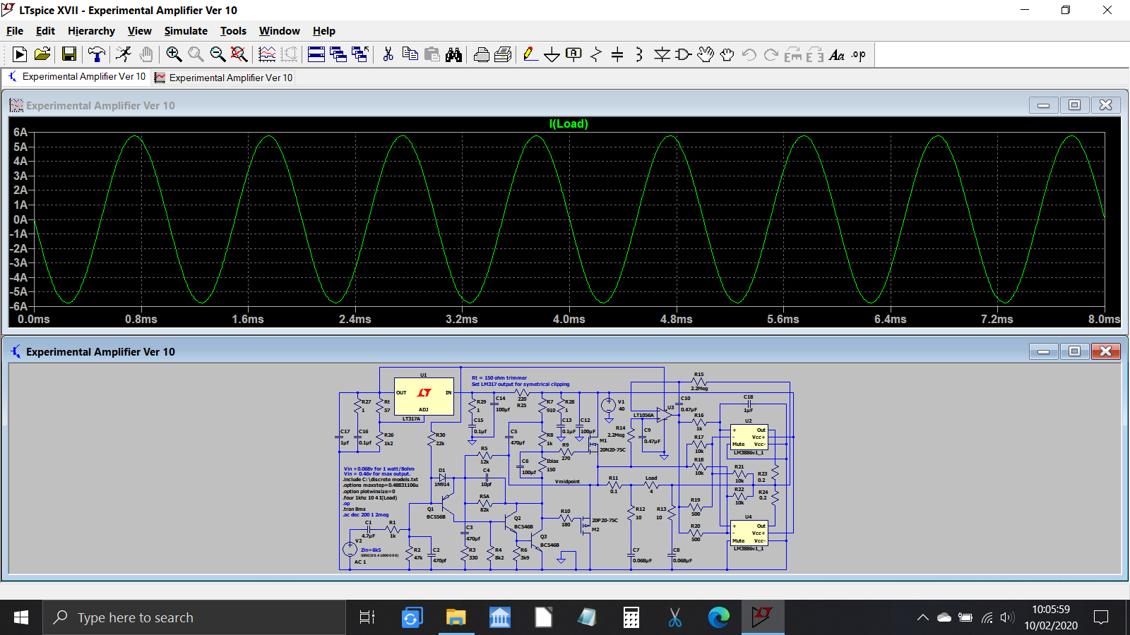

Thank goodness for Disk imaging...
I have just uninstalled LTspice and reinstalled a version from around June last year. All my files now work correctly. This is a circuit with two LM3886's running in parallel.
I have no idea why or what is going on here. The LM3886 model and symbol files are the same ones, I didn't touch anything in the documents folder part of LT.
Fixed 🙂
It seems there are issues (my opinion) with the latest versions of LT. I commented a week or two back in this thread about issues over updating... anyhow the fix was simple.
First I proved that an old version installed onto this Windows installation worked :checked:
Now I uninstall the old version and reinstall the latest direct from Analog.com. This fails with the same error as the initial clean install.
All I had to do was run the field update which completed in seconds but it did 'something' because now everything works.

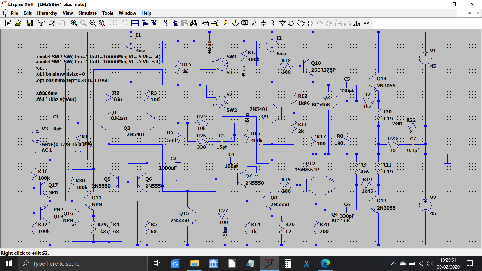

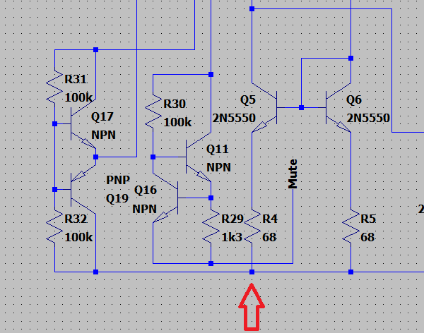

All this and my using the model in another design led me to find an error in the base circuit I used.
I've 'blobbed' a node onto the wrong trace and this error meant the circuit worked OK only as long as the mute pin was tied to the negative rail.
The correct configuration is detailed here. The error (the incorrect file exists in this thread only) has R4 connected to the Mute line and not the rail below it.
