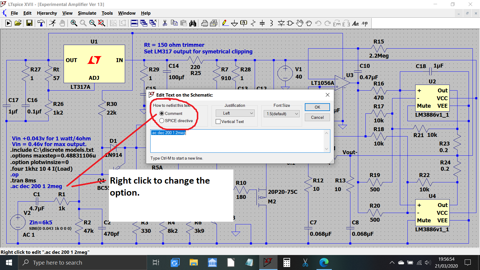

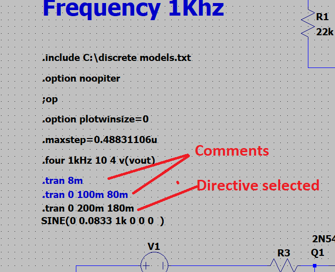

I'm so used to switching the simulation commands between Spice Directive and Comment and making the required edits in the text rather than the dialog that I don't even notice it any more.
Certainly not a deal breaker for me. I'm also just grateful for having such a powerful tool. And all for free!

Thanks Mooly. I've been editing between "." and ";" to enable/disable a Simulation Command. Changing from comment to directive sure looks easier!
It took me ages to try and make sense of it all when I first started using this version and all Mike Englehardt would say was that it was 'by design' and that it would make using it easier in the long run... and actually once you get how it works it does.
So you can set up loads of different simulation directives all on the same workspace and then call any up as required.

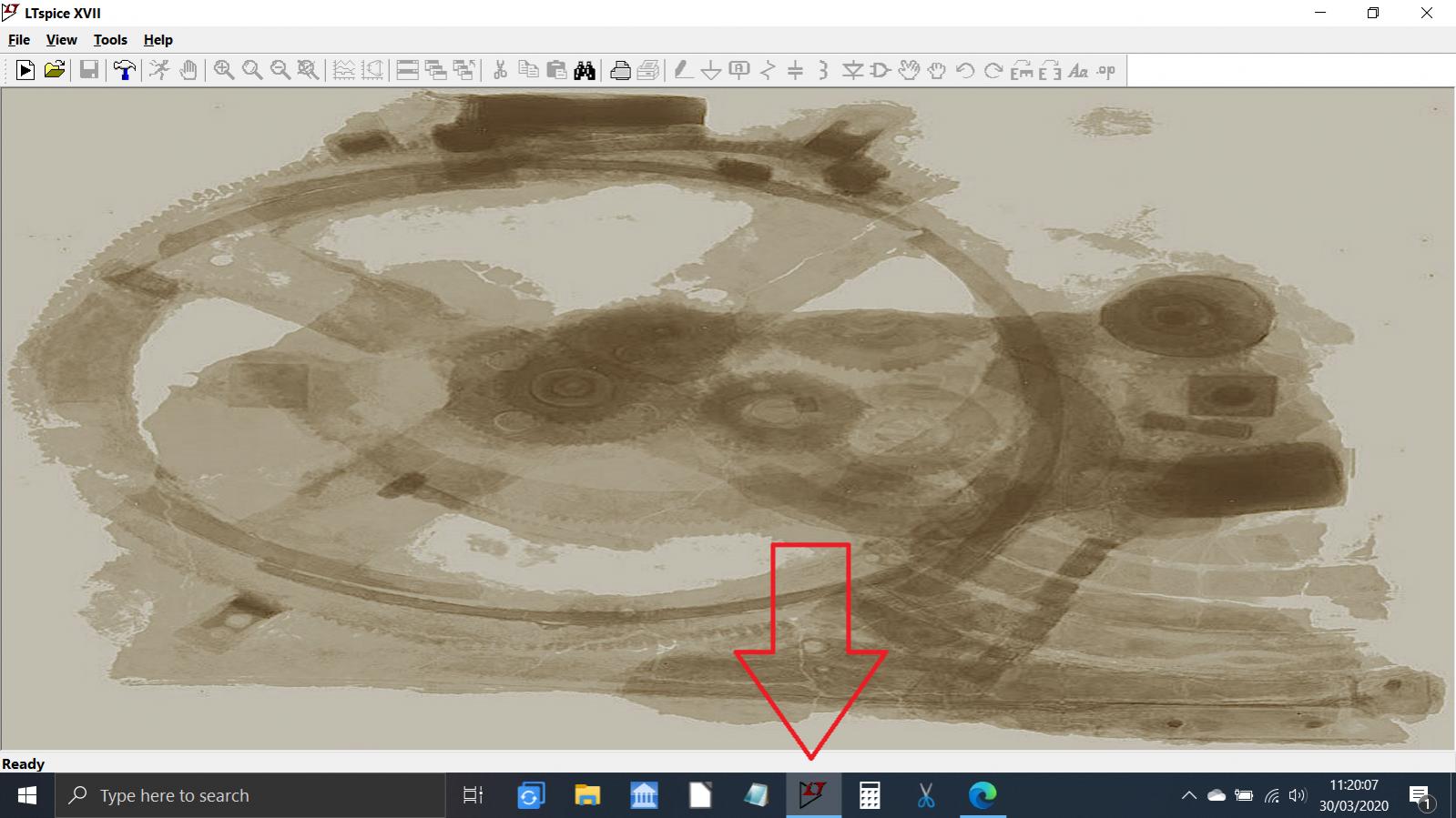

Yes, I have it installed now and I'm seeing the icon in the taskbar when I open it. Thanks.Have you actually got it installed now and with an Icon you can click to open it.
You should see this. I have the Icon pinned to the taskbar:
