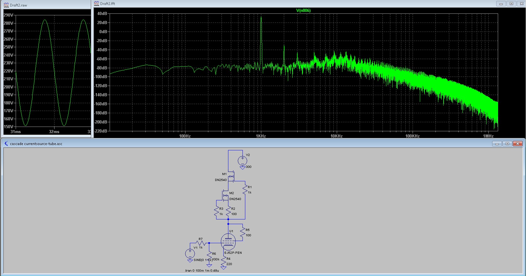

The model works fine for the DN2540 see pic test schematic.
first put a standard nmos richt click it and change the name who is in the cmd file, included mine in previous post with more parts included like zvp series..
  • cascade currentsource-tube.zip

Unknown parameter "dn2540"
I had no problem with your test schematic once I replaced your 6J52P with a tetrode I had and added a couple of includes.
However, when I use the DN2540 in my model with the same .inc file, after running the simulation I get:
Error on line 5 : m§ic1 n020 n022 n024 n024 dn2540 dn2540
Error on line 27 : m§ic2 n021 n023 n025 n025 dn2540 dn2540
Direct Newton iteration for .op point skipped.
Otherwise the simulation seems to be working fine.
Any ideas why I'm getting this? My use of the DN2540 seems no different from yours.
Thanks.
