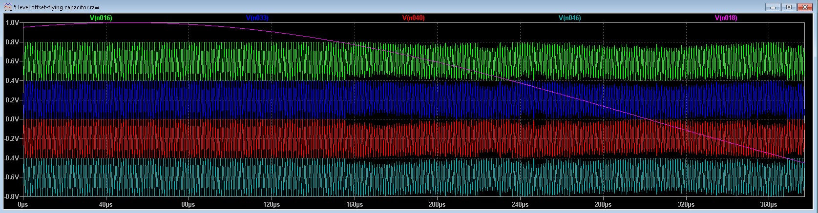

Vey strange behavior LTspice 64 bit, sometimes just no sim on the output stages even no voltages on voltage source, just nothing, this happens more, and sometimes is suddenly does again.
Kees, a method that is often effective to isolate the issue is to progressively delete parts of your circuit until the issue goes away. That may indicate whether it is caused by some specific circuit or sim command.
Are you sure it is not just taking a lot of time for the sim?

I am now shure the new LTspice 64 bit has a lot of flaws, it does crash while sim, and give strange outcomes like 1 Kv on the voltage source output while it is 1 volt etc, or measure output get 12 mV on 8 ohms but 20 amps current.
here you see the triangels get messed up, the only way to get it right is shut down and restart the pc.
with the old version I have never trouble.
regards

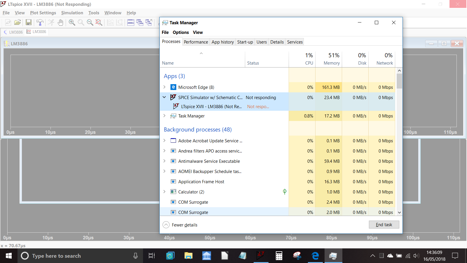

I've started experiencing a lot of crashes on LTXVII x64 following a clean install of the latest version of W10. Mine crashes when running a transient analysis, and typically at the instant the window should split into the two screens. Occasionally it appears OK but crashes when you probe anything.
I haven't found any reason for this although I suspected a graphics issue, however a lot of testing with different drivers and settings, and even using just the basic MS video driver have all shown the problem at some point.
I contacted Mike Engelhardt just after posting this and received a reply within the hour. Apparently he has received complaints about this and asked was I running the latest update that came out just 3 days ago. I wasn't, but I am now. So fingers crossed. Its been OK in three or four sims run in quick succession.
