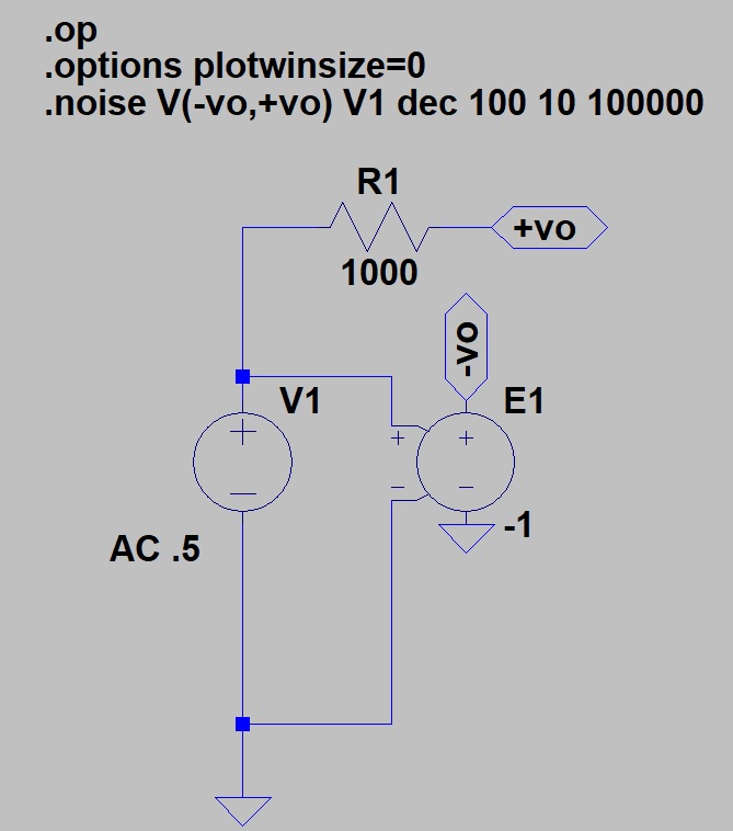

Another IMO LTSPICE bug
My second one this month, though I consider this one more serious. The .noise card ignores the AC gain of the referred to input source causing wrong answers or at least ambiguous answers. The circuit below will yield a 0dB gain to the differential output voltage in an .ac analysis but the referred to input noise of the 1k resistor is 2nV in the .noise analysis. Since the noise analysis uses an ac analysis to compute all the contributions I consider this a problem.

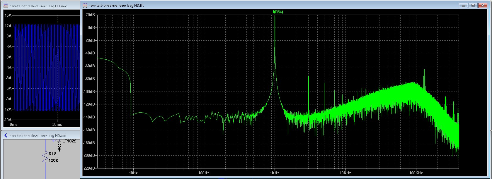

I've done this and found something interesting. The trapezoidal integration methods generate odd harmonics of the fundamental, whereas the gear method generates a bit less harmonics, but it does cause much more intermodulation with the samplerate or 1/timestep.
If the simulation length is locked to the FFT size, both methods have the same noise floor (although gear will have more intermodulation). But if the simulation length is different from the FFT size, gear will have a lower noise floor due to less intermodulation (at the penalty of some harmonics at very low level).
For some reason I get a high noise floor when I use a sine V-source with the default integration method. The output of the V-source is perfect, but the output of the allpass is noisy. Using gear fixes this, but again at the cost of more harmonics.
In all these cases the intermodulation and harmonics are because the sine frequency wasn't locked to the simulation length and timestep. When all 3 are locked, I get no harmonics and no intermodulation, just a bit of fuzz at the highest BW of the FFT.
Furthermore the distortions decrease the more datapoints there are per cycle. I rarely use more than 10 cycles for a simulation.
If you run say 100 cycles instead of just 10 cycles you start to get into integrator errors if you don't use frequencies that aren't multiples of your 1/timestep. But if you just use 10 cycles like I always do, there's almost no difference between gear or trapezoidal, or if your test frequency isn't aligned with your 1/timestep. This works well even if your simulation length isn't the same as your FFT size.
So if you're just doing THD simuations, don't run much more than 10 cycles.
If you're doing long simulations with many cycles maybe method=gear is better for you.

Don't be afraid to build an amp because it has low distortion. I never found low distortion to be a bad thing unless there was something particularly unpleasant about my speakers I needed to mask.
Here is the simulation I used. I run the simulation and then do an FFT of the result. LTSpice's own sine generator is better than the .wav file, so I stopped using it eventually.
I always use the Blackman window for the FFT, it has a very good combination of merits.

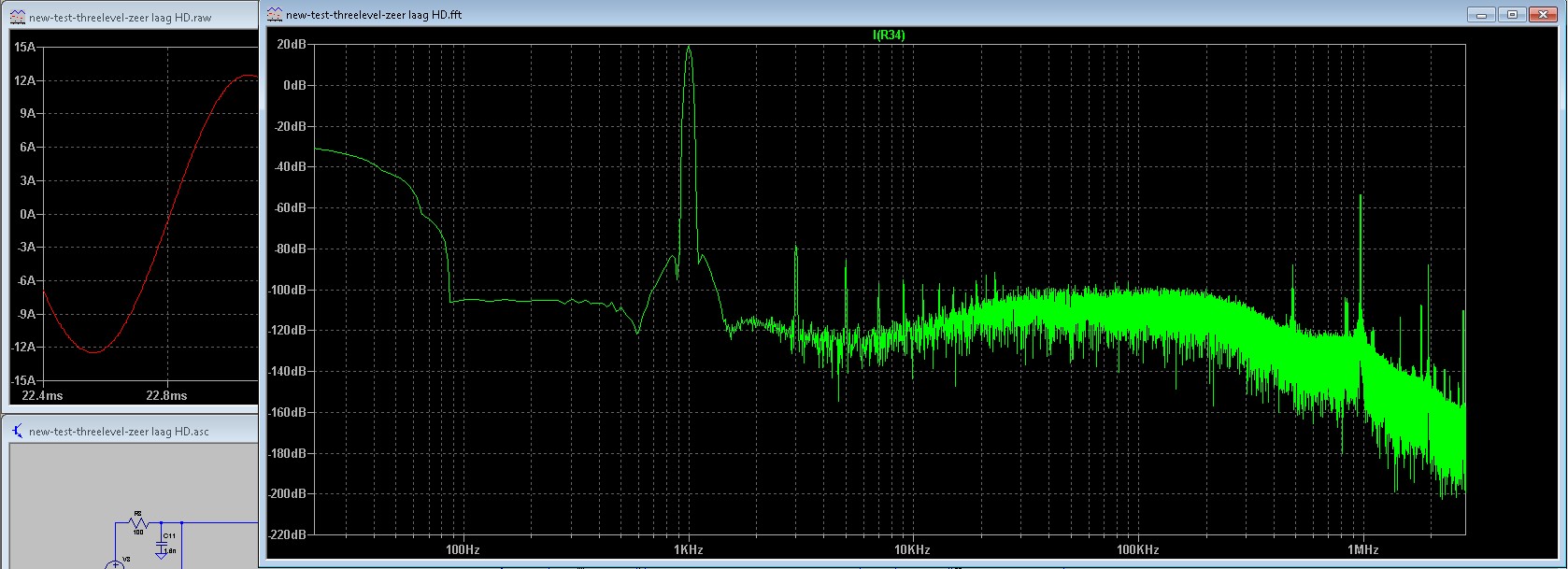

Hmm little english errors above, oke, the cycles, do I put 10 cycles in the voltage source to get what you advice? and extent it with audicy. in your ltspice file where to probe it, and do I need to connect the source who read the wav and disconnect the other one.

That's not what I meant. I usually simulate power amps for 10 cycles of the sine wave to get an FFT. The sine wave file I included in the .zip is 10 seconds long.
Your usage with class D is different from what I normally do. I'm curious, if you could provide a simulation file I would like to see how the simulator acts, maybe I can help.

Ahh oke, I give you the file, I am not so good in LT spice knowledge, what make it a little confusing. I have included a very long simulation, so you see what happens all the way. LTspice is quite advanced so help is always welcome.

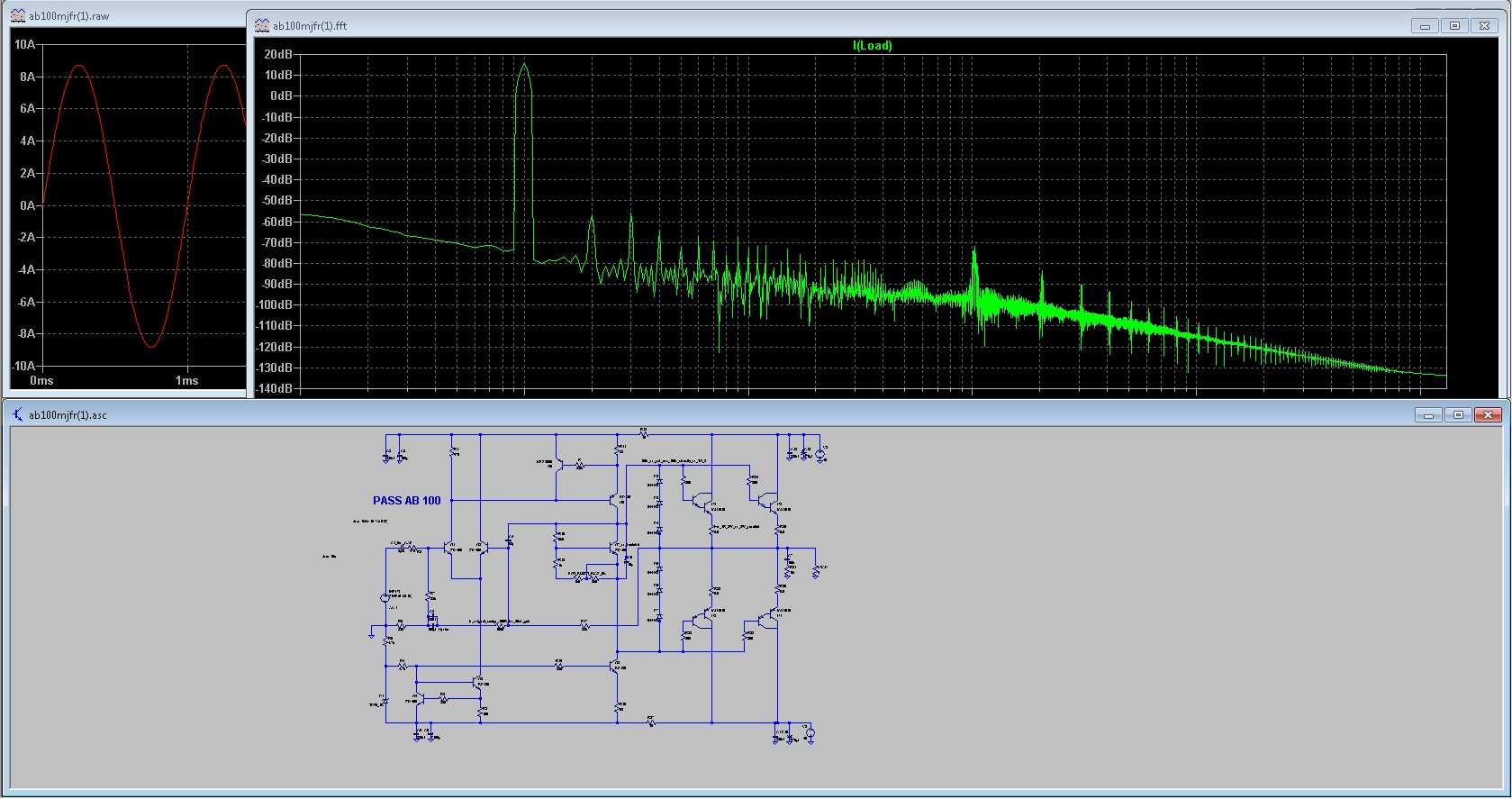

Here is a model of the Pass AB100 from user osscar that I cannot get to run due to lack of symbols and models.
Can someone assist tell me how to make this portable for everyone in the AB100 thread?
The circuit
Here I have the stuff, put the models in darlington under C:\Users\Administrator\Documents\LTspiceXVII\lib\sym\Darlington folder.
Or rename it for your own, contains the MJ transistors.. MJE15024 15025 are also big transistors from motorola withstand 250volts but are 16 amp and no darlington however there is a nice super emittor follower for that..
and the cmp file you have to relace in C:\Users\Administrator\Documents\LTspiceXVII\lib\cmp
regards
This is using TIP121/127 models. The 2SC4102 is included with LTXVII, if its not present in LTIV then you'll have to choose something else.
Should click and run, just keep everything in the same folder. Set the bias to the recommended for the amp.
Mooly, truly awesome. Loads and runs! Sweet! Thanks
