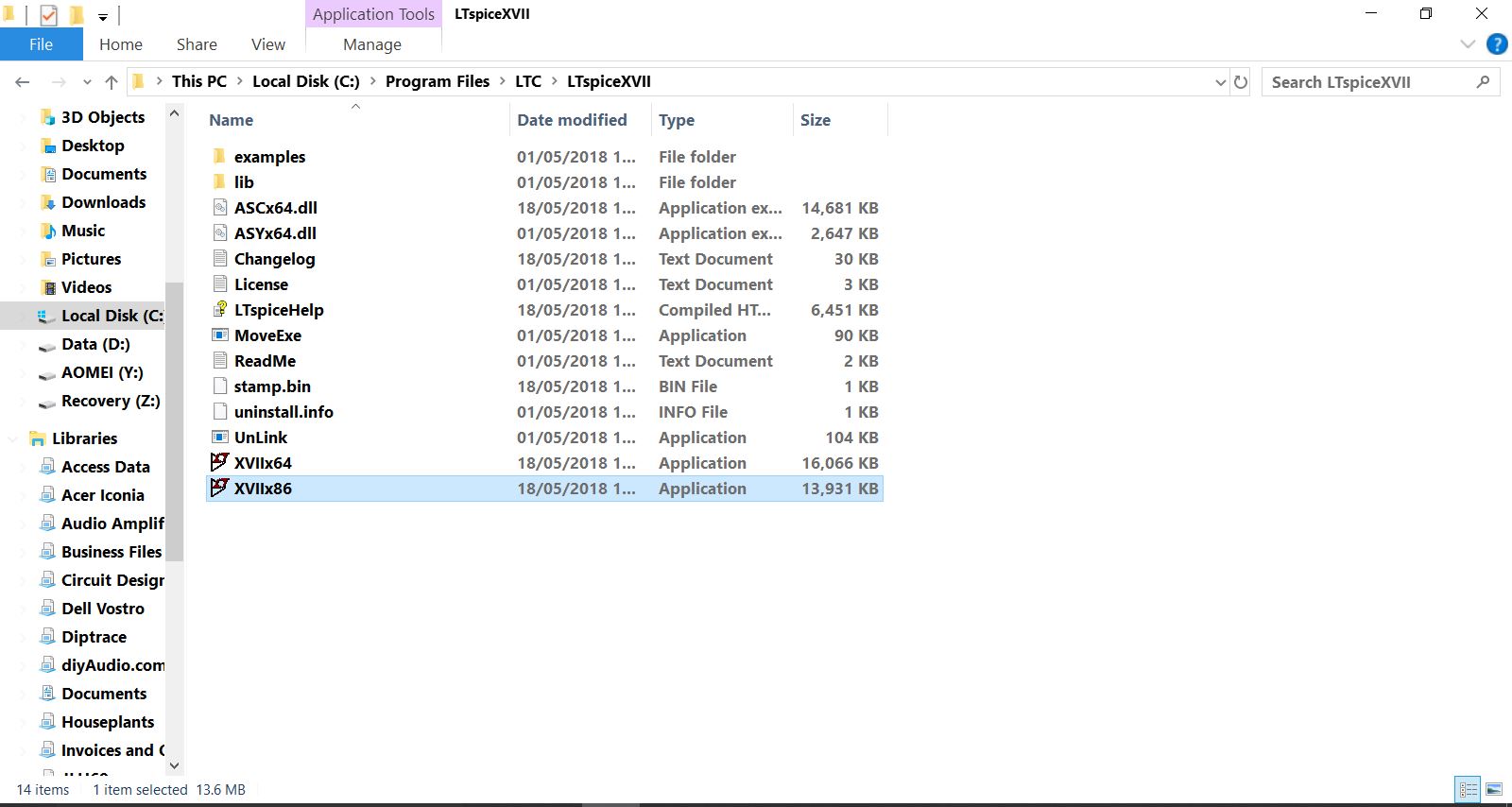

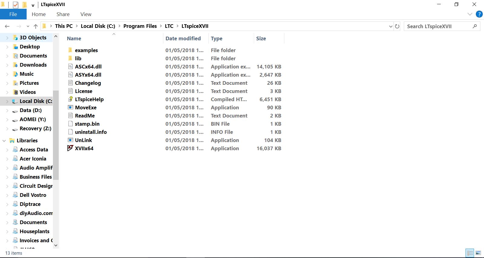

Unfortunately I have to report that the issues are not fully fixed, at least for me. Today and it has crashed out 50% of the time.
As I use disk imaging software I can take things back to a clean starting point which I have done again. I can see that updating my clean x64 installation as advised by Mike now seems to add the x86 executable and required files. I declined the x86 version from the original install file but the updates seem to now include it whether you want it or not. The two images show my clean W10 starting point (x64 executable only) and then after running LT's update.
The x86 version seems much less prone to problems for me at least. I'll let Mike know the score as it definitely 'aint right as it is. I've tried such things as changing the scaling and DPI settings but it still crashes.

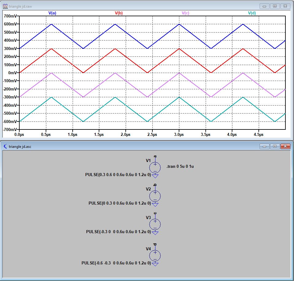

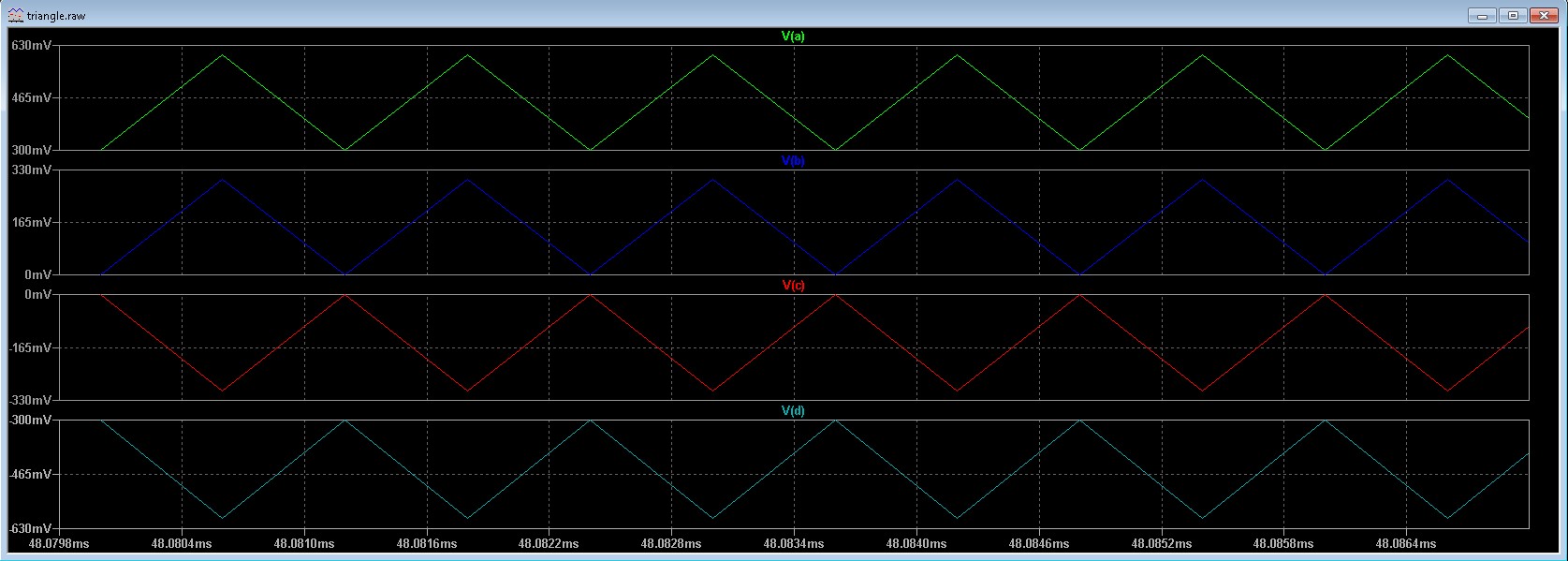

here I get something I can not get right, 4 triangles in fase, it does two below zero out of fase.
somewhone now?.

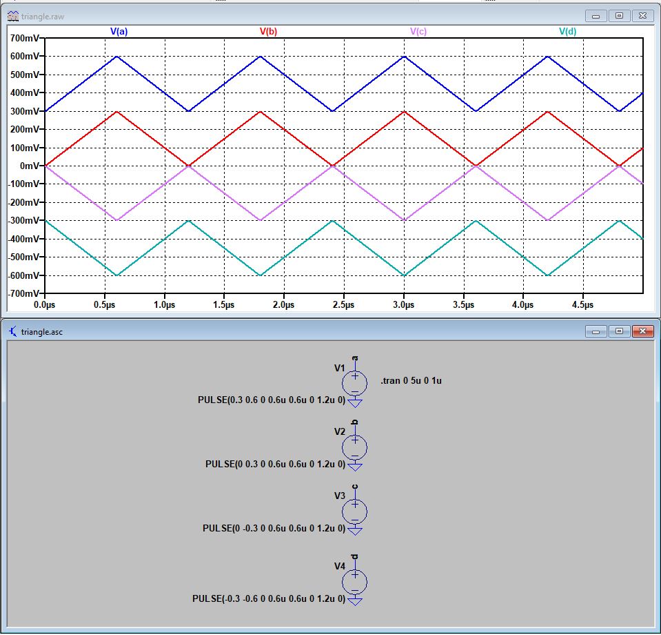

Kees I see nothing wrong here. How does it look at your side?
Edit: LTspice draws it exactly as you specified it. If you want them all to be in-phase, you need to specify the points in the correct order, see 2nd pic.
Jan

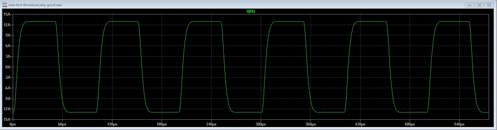

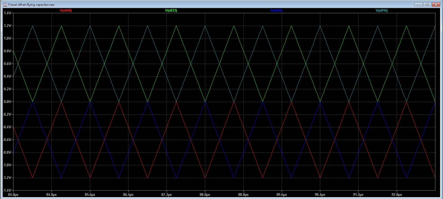

I do see no differences in your second pic. I do get nice output from the multilevel class d, fast respons.

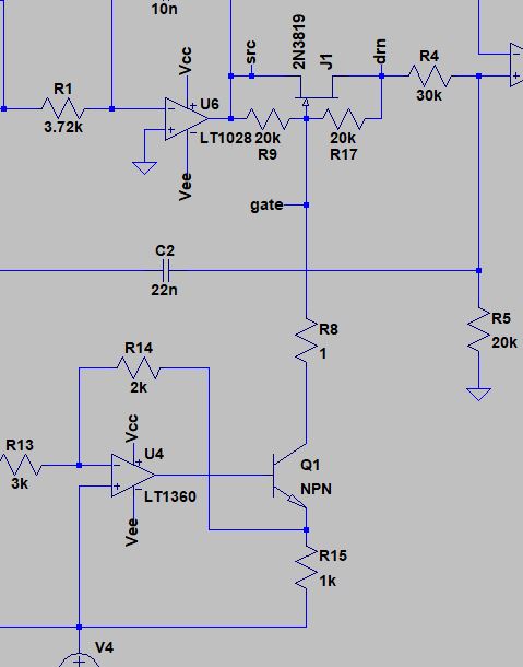

Hi Kean,
I did run it in stand-alone mode with no issues, but then got sidetracked with another idea.
I realized you can also drive a floating FET by driving a current from a current source through a resistor between G and S, as a CS has ideally infinite Zout and will float up and down to whatever the Vgs happens to be. Especially when the S is hung off a low impedance point.
See attached.
Jan
Yes, I've tried that in an amp feedback loop to make a circuit to reduce gain in order to prevent clipping. The OptoFET would still be nice to eliminate Q1 as a source of distortion or noise.
Good point. But in my circuit, the control current is DC, and I probably will need to insert a common emitter stage in the control current line to eliminate miller C. Not sure that is an issue, maybe not.
I am still in proof-of-concept mode 😎
Jan

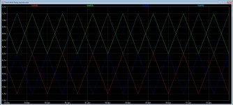

THanks Jan for explaining the way to make triangles, here I did play a little, it is quite simple.
En nu voorbereiden op de rechtszaak, de woningbouw wil mijn houtkachel er uit laten halen, telkens last van hun, en de buur, zo kan ik niet echt iets maken, door de stress. Kachel is reukloze (wanneer warm) hoog rendement.
Picture is uncluded about the triangles, now I can do all different tryings for multilevel.
regards
