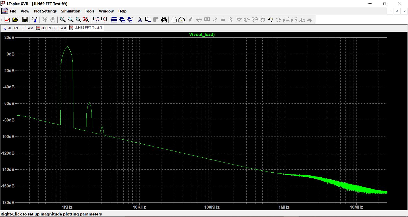

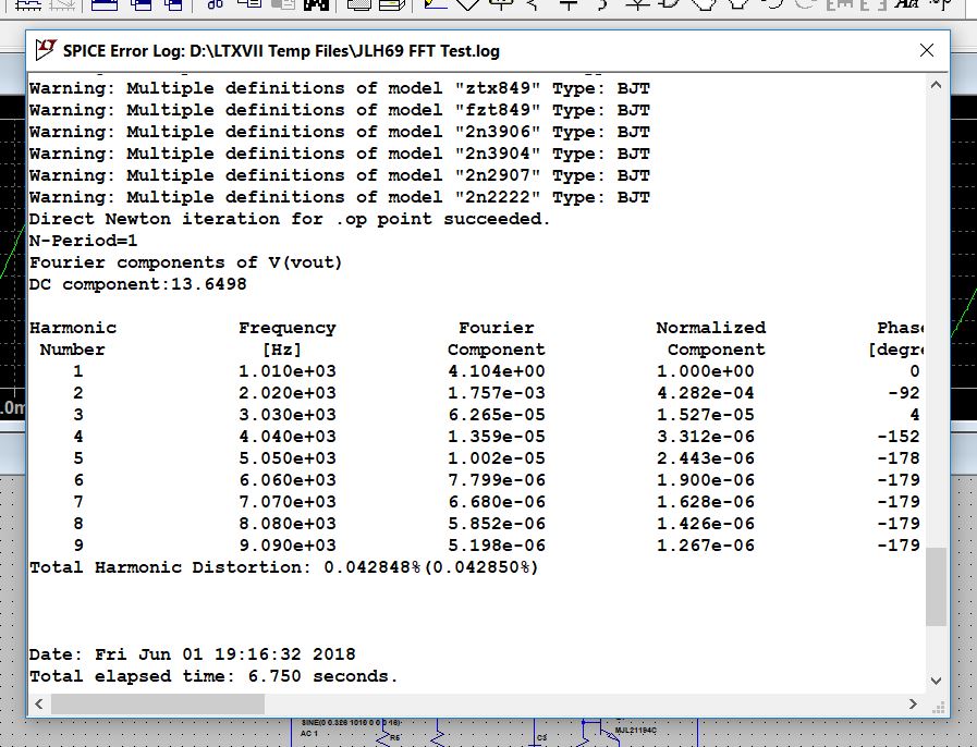

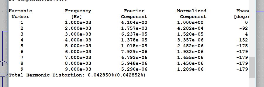

That's a good question Jan.
I quickly tried this on the JLH69 amp running a 1kHz input and 5ms sim time. The timestep is 0.019073uS
That gives us the first FFT. Distortion is 0.042%

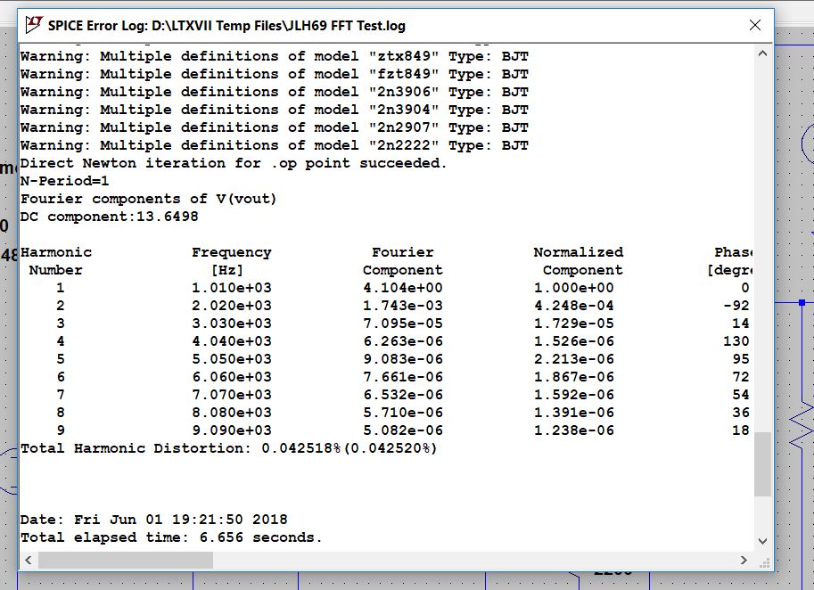

Now change the input to 1010Hz and yes, we have to alter the sim run time to fit. To keep at showing 5 cycles on the screen means we have to run the sim for 0.00495 seconds or 4.95ms.
The time step is now 4.950495ms divided by 262144 which is 1.888463E-8 which is 0.019uS.
The second FFT shows this. Distortion is essentially the same as well within rounding limits of entering the timesteps manually.
So yes, it all seems to work as it should but you have to do a bit of mental juggling to do it this way. Setting the sim run time to exactly fit a known number of cycles seems to be the key. Keeping the run time at 5ms produces massive errors for the FFT of the 1010Hz run.

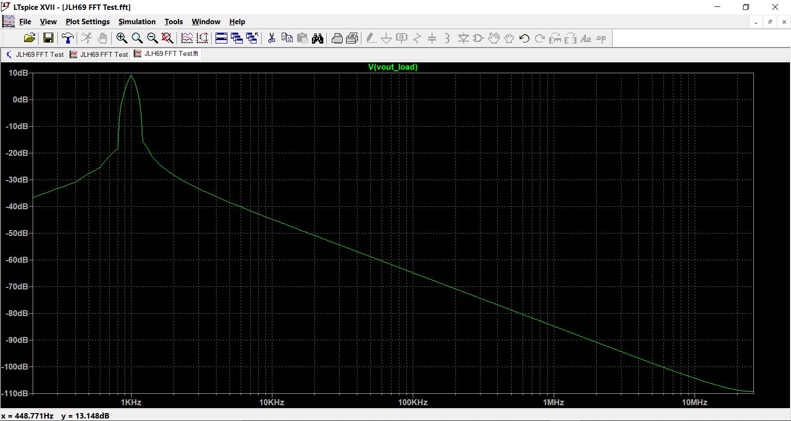

Last two images are of doing just that. The FFT is non sensical, the distortion seems pretty much unaffected.

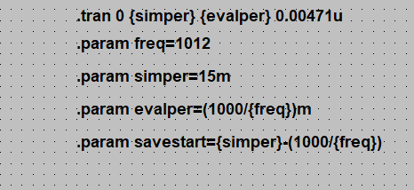

Anthony, I tried to set up this string of .param expressions but hit a wall. Apparently I cannot uses expressions within a .param statement, see attached. I get an error on the '-' in the expression.
(There's other errors but its more a test of the concept).
Would you share your method?
Jan
Got it to work thanks to Ian Hegglun:
He send me this:
.options plotwinsize=0 numdgt=7 method=gear numdgt=15 ptrantau=0
.param FFT=2**16 dlycyc=1 numcyc=5 ;<-change
.param simtime=numcyc/Freq+dlytime
.param dlytime=dlycyc/Freq ;needs somewhere .param Freq= 50
.param timestep=(simtime-dlytime)/FFT
; .option reltol=1e-6 ;only if lower floor needed
.four {Freq} V(Vout) V(Vin)
.tran 0 {simtime} {dlytime} {timestep} ;For High Precision FFT
;Simulate>Control>SPICE>Solver=Alternate Alt.Solver gives 60dB lower floor (-260dB)
Works like a charm, Vin is now -250dB. Always a good test - if Vin shows distortion, you're not doing it right!
Jan
You do not need the 'curlies' in a .param statement.
You do need the 'curlies' when substituting a [.param] value in most commands/directives.
P.s. evalper has an error, it is the 'extra' 'm' that follows the expression.
P.s. the macro[param etc] evaluation-engine is of the type 'merge-first-then-evaluate' when an error happens the evaluator will report the statement in which it occurred, not where it originated (this can be puzzling at times )
P.p.s.
Like in:
.param a = error
.param b = 6
.param c = a + b
May (but not surely) report an error in the '.param c...' statement and may never report an error in the '.param a...' statement, this gets real complicated [to solve] when many statements are 'mixed' spread over a large solution, it would be nice if the evaluator was a bit 'modernized'.
Yes we are at the same sheet. Of course the problem with windowing is that it gives spurious components in the spectrum and lowers resolution. The nice thing with LTspice is that you can precisely specify the various parameters and not need a window.
With the numbers I posted before I get about -250dB on the voltage source. So anything above that is from the circuit. That's a low enough measurement floor for most of my amps ;-)
Jan
Jan
